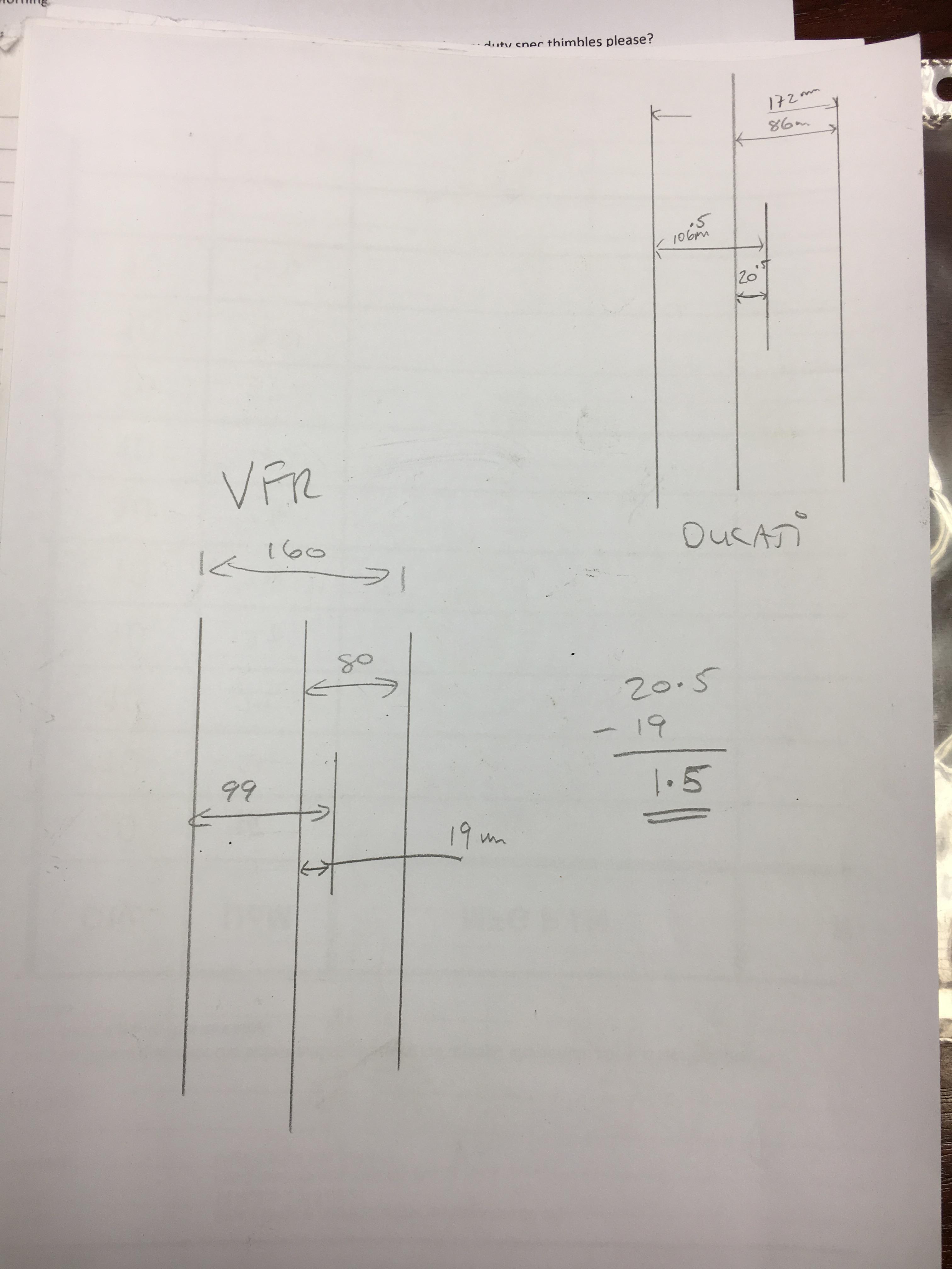

Stuartm Posted May 4, 2018 Posted May 4, 2018 On 5/2/2018 at 10:34 AM, BiKenG said: In that case, the goal is the wheel, but I won't be using Ducati axles and stuff. Goes against the grain on a Honda (apart from the wheel of course 🙂 ) Anyone got an accurate Ducati wheel offset? Hard to measure exactly. Is it 23mm or 7/8"? Hi Ken, here’s the details of the Ducati wheel i used and the original vfr wheel Quote
BiKenG Posted May 4, 2018 Posted May 4, 2018 So you got a 20.5mm offset? Is that for the 1098/1198 wheel for the larger axle? I measured 23mm on my 916 wheel and that concurs with what I have seen reported elsewhere. Which means Ducati used a different offset on their different axle sizes. Quote

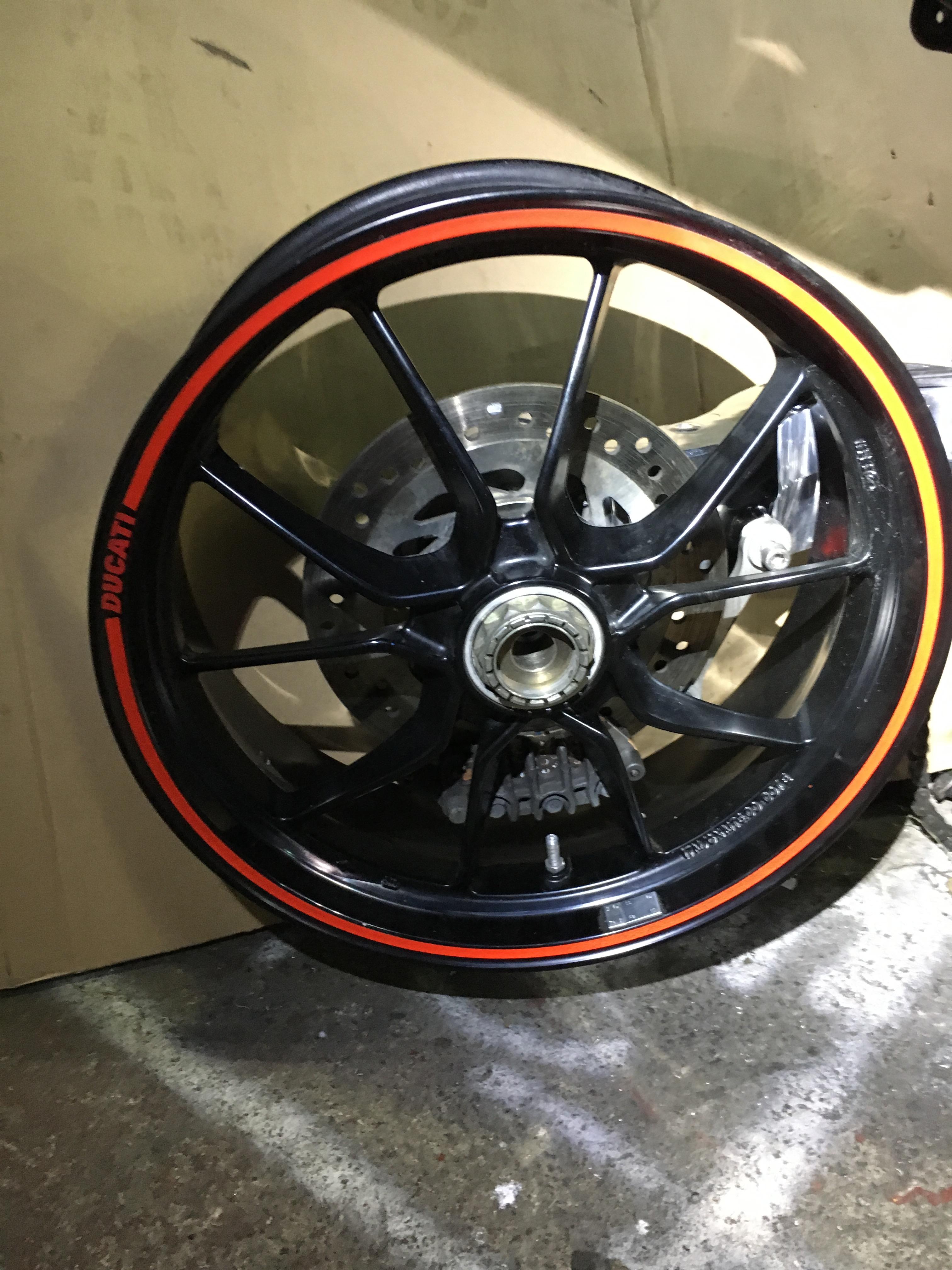

Stuartm Posted May 4, 2018 Posted May 4, 2018 I used an 1198 wheel with the large axle here’s a pic of the wheel the larger the offset the easier it is to fit Quote

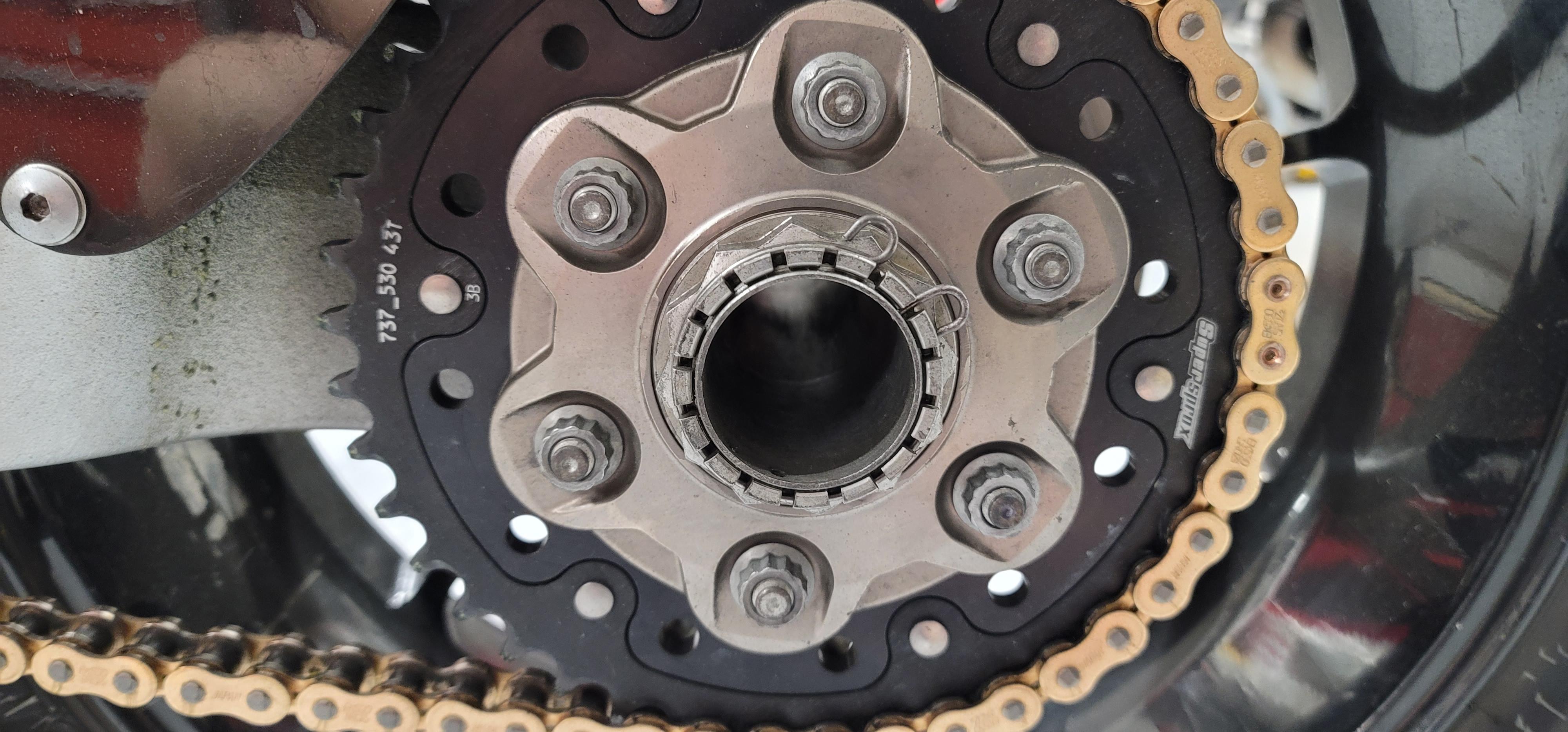

Ap10046 Posted September 24, 2021 Posted September 24, 2021 Hi All. What sprockets are you'll using please? The CB1KR/VFR uses a 530 44/45T, the 848/1098/1198 use 520 or 525 38/39T. Having a hard time finding a rear sprocket, I think only Supersprox makes a black one? Quote
Member Contributer vfrcapn Posted September 25, 2021 Member Contributer Posted September 25, 2021 Supersprox has a 43t sprocket, I paired that with a 16t Honda oem front on my '99. I'd like to find a 45t rear though. 1 Quote

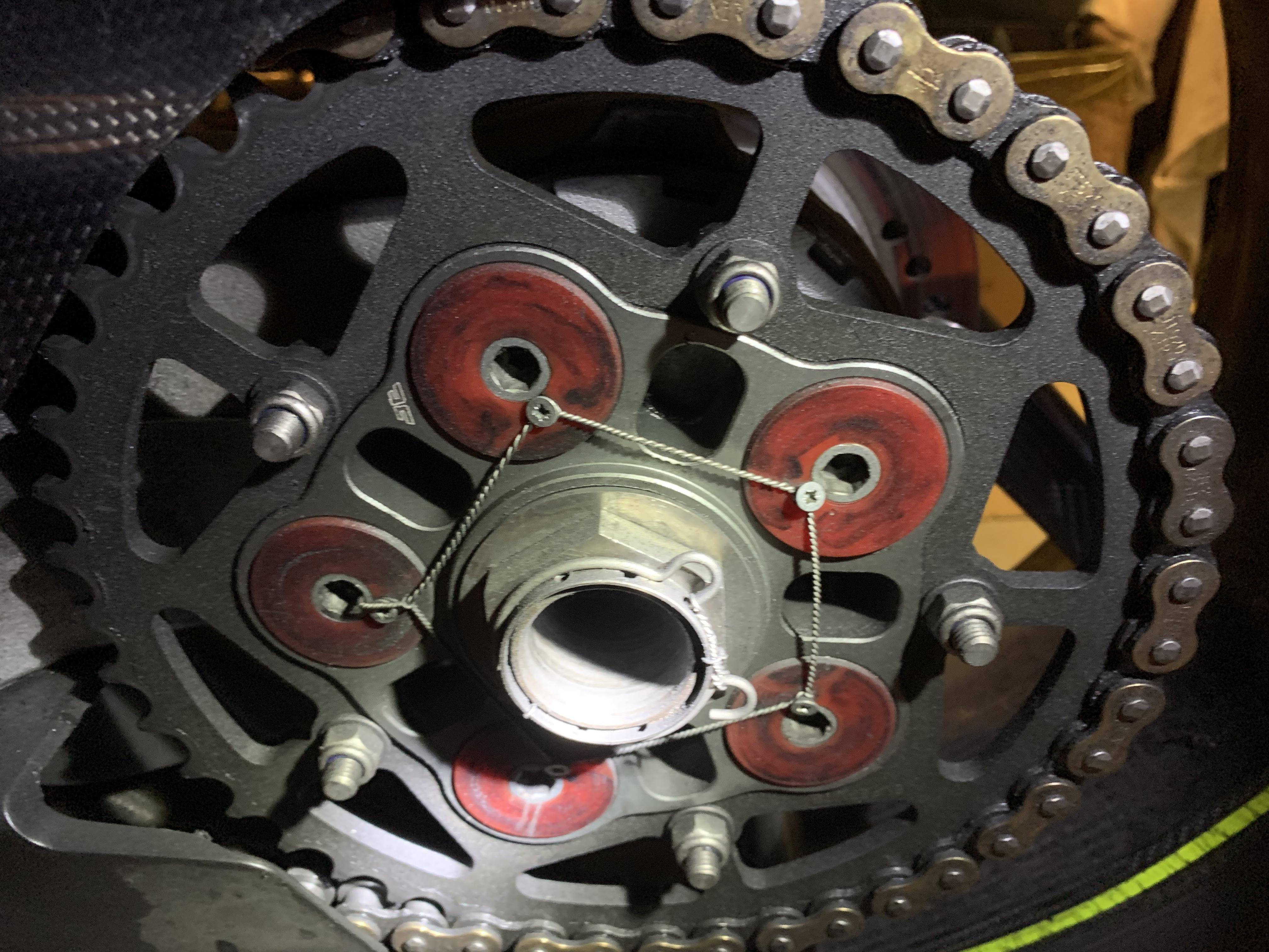

Member Contributer Mohawk Posted September 25, 2021 Member Contributer Posted September 25, 2021 If you replace the ducati carrier with an Afam, JT or Renthal 5 bobbin Quick Change carrier, then Afam do a 520 45 tooth light weight steel sprocket for the 916, which I have paired with a 16T Yamaha R1 (15-16) 520 Rental light weight sprocket (309V-520-16P). They use the same output shaft splines as VFR800 ! Who knew 🤔 They may well do same for 6 bobbin carriers for 848/1098/1099 panigale etc 1 Quote
Member Contributer sfdownhill Posted September 29, 2021 Member Contributer Posted September 29, 2021 On 9/25/2021 at 4:45 AM, Mohawk said: If you replace the ducati carrier with an Afam, JT or Renthal 5 bobbin Quick Change carrier Mohawk, that looks like about the lightest sprocket carrier/cush drive I've ever seen. It looks like there's a JT logo on your carrier - is this correct? I'm used to seeing Ducati drive assemblies with an outer flange covering the cush bobbins, with bolts from the bobbins coming through the outer flange and nuts on the bolts holding the outer flange [see vfrcapn's post/photo above yours]. I love your safety wire loop [very tidy] and it appears that the cush bobbins on your assembly have female hex fittings, so I assume they thread into something that transfers drive forces to the carrier, yes? It would be very interesting if you could shed some light. Thanks! Quote
