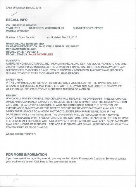

BLIGHT Posted January 1, 2016 Posted January 1, 2016 (edited) Just got wind of this recall... went to the Honda corporate website and input my VIN.... bike #572 produced in 2010. One of the first batch made! It says I need the inspection and repair. Mine's a 2010 manual shift with just over 9K miles. I filled out a service request form from a local dealer online, mentioning I need the recall service/repair done. I also asked if they had a loaner bike (so I could get home and then back the next day) I also purchased the bike out of state last year... not so unusual, right? Got back this rather pert reply from the service manager: Hello Brian, This is in response to your email sent to us regarding the drive shaft recall on your VFR. I do not show that you purchased said motorcycle from this dealership, nor do I have any record of any service work performed here. Thus, I will need your VIN to contact Honda and order the needed parts kit. There is currently no release date as to when we would receive said kit, so I cannot book you an appointment at this time. The proper procedure is as follows. 1) send me your VFRs VIN number. I will contact Honda and order the kit for your unit. Once we receive the kit, I will contact you and set up an appointment.The work will take one day. Drop off the unit on the morning of your appointment and we would have it done that afternoon. Unfortunately, we do not have "loaner" motorcycles. Thank you for your inquiry, <Dealer Name Here> Is it just me or does the letter above seem a bit rude? BLIGHT Here's the specifics regarding the recall: Edited January 2, 2016 by BLIGHT Quote
750 Posted January 1, 2016 Posted January 1, 2016 Dunno, seems ok to me. Just a robotic response to an enquiry. I wouldn't take it personally! Quote
BLIGHT Posted January 1, 2016 Posted January 1, 2016 Dunno, seems ok to me. Just a robotic response to an enquiry. I wouldn't take it personally! OK, I'll let it go... it's not like I have a lot of options anyway! Bummed I can't ride it for several weeks with some peace of mind though. Think I'll do the suggested visual check inside the rubber boot and see if anything looks weird or loose. My 40 year old GL1000 never had any driveshaft issues... you'd think Honda would have had plenty of time to make it 'bulletproof' BLIGHT 1 Quote
Member Contributer swimmer Posted January 1, 2016 Member Contributer Posted January 1, 2016 Dunno, seems ok to me. Just a robotic response to ary. I wouldn't take it personally! +1. Seems very reasonable. Honda loaner bikes in the US is almost unheard of, especially if your bike is out of warranty. Quote

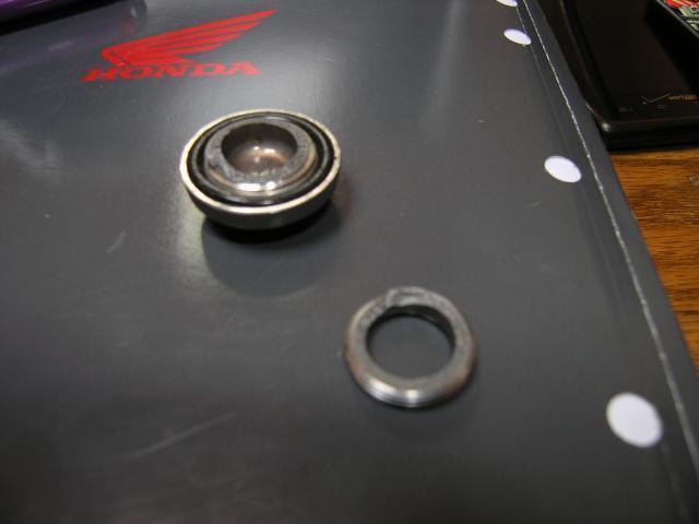

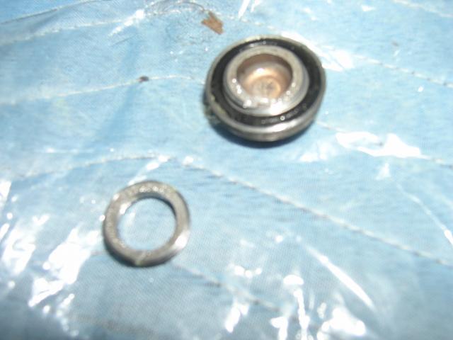

lshark Posted January 4, 2016 Posted January 4, 2016 i sheared off the filler cap on the final drive case rather easily last year....that part is the valve tappet cover from the old CB750 and SL/XL singles from the 60's and 70's...CB 350 too i think.....they were known to break your final drive oil will get changed during the recall service Quote

lshark Posted January 4, 2016 Posted January 4, 2016 I have a Snap-on torque wrench, mine broke removing it after it was properly torqued Quote

Tamworth Posted January 4, 2016 Posted January 4, 2016 I have a set of torque wrenches... but as I'm putting stuff back together, I always have to turn it just a little more... then a little bit more for good measure. My dad is the same way and I will probably pass on that same nasty trait to my son (circle of life and all). Torque wrench will just give trouble on this cap. Proper tool for this particular cap is a socket drive with a screwdriver handle, or holding the socket wrench at the head and not the handle Quote

Member Contributer alleyoop Posted January 5, 2016 Member Contributer Posted January 5, 2016 I think the message is professional, informative, and helpful. The service staff are likely very busy. And the service person went to the trouble to search their purchase or repair records for your motorcycle then write you a through letter, showing what they need from you and how they would proceed. I'm no fan of dealers. But I'd be happy to get that message from my local Honda dealer. Cheers Just got wind of this recall... went to the Honda corporate website and input my VIN.... bike #572 produced in 2010. One of the first batch made! It says I need the inspection and repair. Mine's a 2010 manual shift with just over 9K miles. I filled out a service request form from a local dealer online, mentioning I need the recall service/repair done. I also asked if they had a loaner bike (so I could get home and then back the next day) I also purchased the bike out of state last year... not so unusual, right? Got back this rather pert reply from the service manager: Hello Brian, This is in response to your email sent to us regarding the drive shaft recall on your VFR. I do not show that you purchased said motorcycle from this dealership, nor do I have any record of any service work performed here. Thus, I will need your VIN to contact Honda and order the needed parts kit. There is currently no release date as to when we would receive said kit, so I cannot book you an appointment at this time. The proper procedure is as follows. 1) send me your VFRs VIN number. I will contact Honda and order the kit for your unit. Once we receive the kit, I will contact you and set up an appointment.The work will take one day. Drop off the unit on the morning of your appointment and we would have it done that afternoon. Unfortunately, we do not have "loaner" motorcycles. Thank you for your inquiry, <Dealer Name Here> Is it just me or does the letter above seem a bit rude? BLIGHT Here's the specifics regarding the recall: Scan0002.jpg Quote

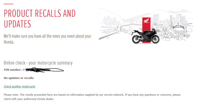

750 Posted January 6, 2016 Posted January 6, 2016 So this is odd, looks as though Honda don't want to caress my bike with new parts! Anyone shed any light on it? Quote
steveb77 Posted January 6, 2016 Posted January 6, 2016 I get the same when I check my bike details. The recall still hasn't been made official in the uk. Hopefully they are just waiting for the parts to be available before they anounce it. But it is definitely going to be in the uk. Quote
