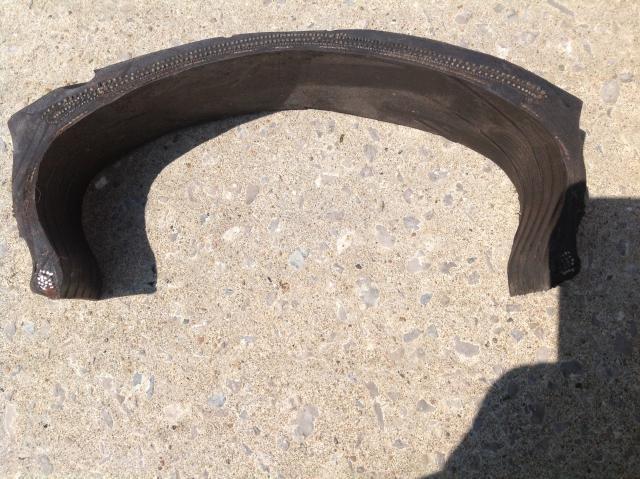

Member Contributer 5232eagle Posted June 1, 2014 Member Contributer Posted June 1, 2014 I cant remember what brand of tire i cut this out of But for those wondering how much tire thickness they may have when the cord shows , this can give an idea. This tire has 3/32 of an inch for about 2 1/2 inches either side of center. Quote
V4 Rosso Posted June 1, 2014 Posted June 1, 2014 That looks quite beefy compared to e.g. a Michelin PR. Quote
VFR4Lee Posted June 1, 2014 Posted June 1, 2014 I figured they were thin just based on the drumlike sound when tapping a finger on it. Quote
Member Contributer The mailman Posted June 1, 2014 Member Contributer Posted June 1, 2014 I'm definitely surprised at how much is left beyond the cords. I have been surprised on a full day ride when cords appeared at my lunch stop and I was 200 miles from home. Maybe my worry level would have been lowered had I known how much was really left. I would still replace them right away and keep my speed in check until then. Quote
Member Contributer 5232eagle Posted June 4, 2014 Author Member Contributer Posted June 4, 2014 my mistake thats 3/16 not 3/32. Quote

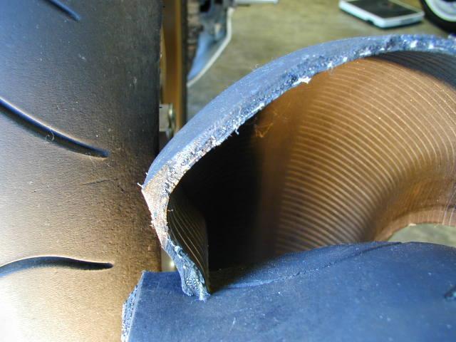

Member Contributer BusyLittleShop Posted June 11, 2014 Member Contributer Posted June 11, 2014 This a cut away of my Metzler Rennsport after 6K miles... Quote
Member Contributer Switchblade Posted June 11, 2014 Member Contributer Posted June 11, 2014 That's paper thin ... Quote
