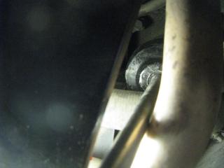

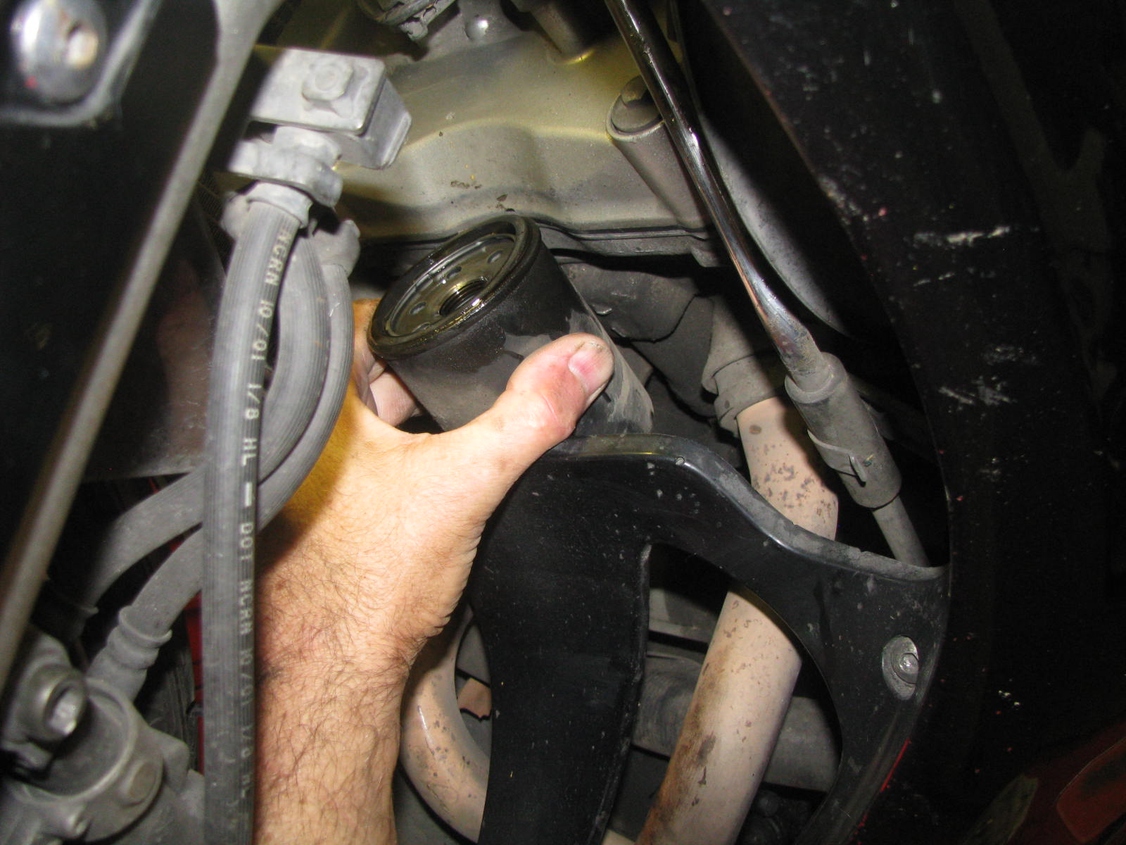

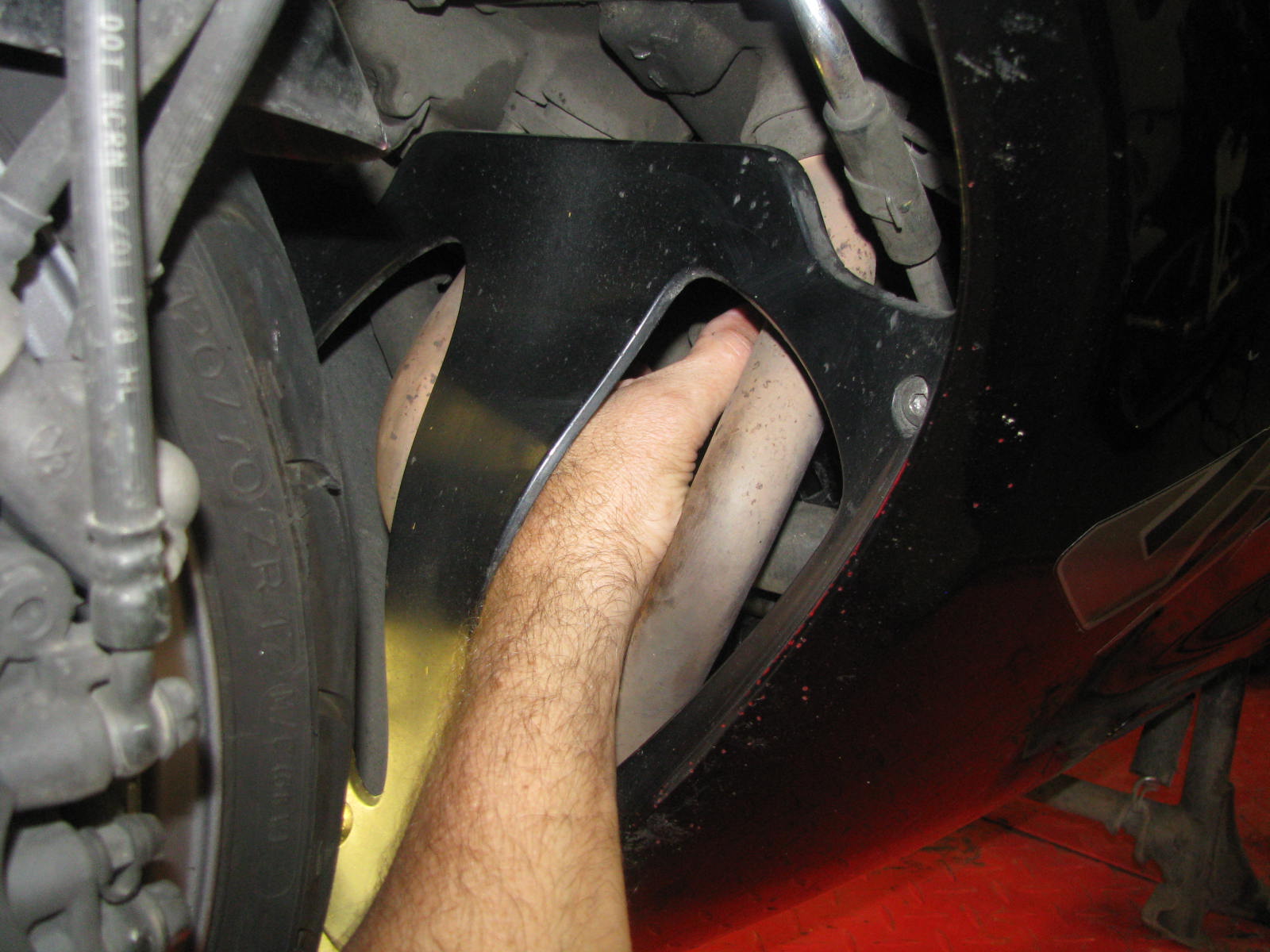

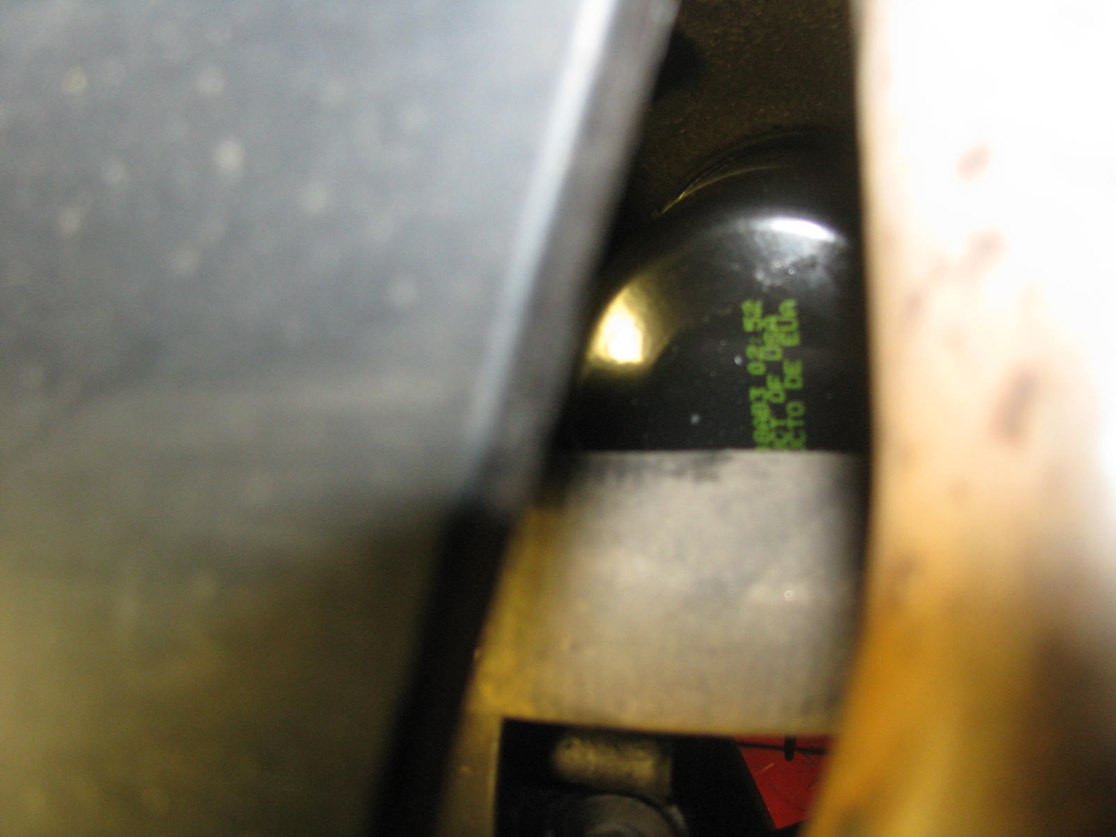

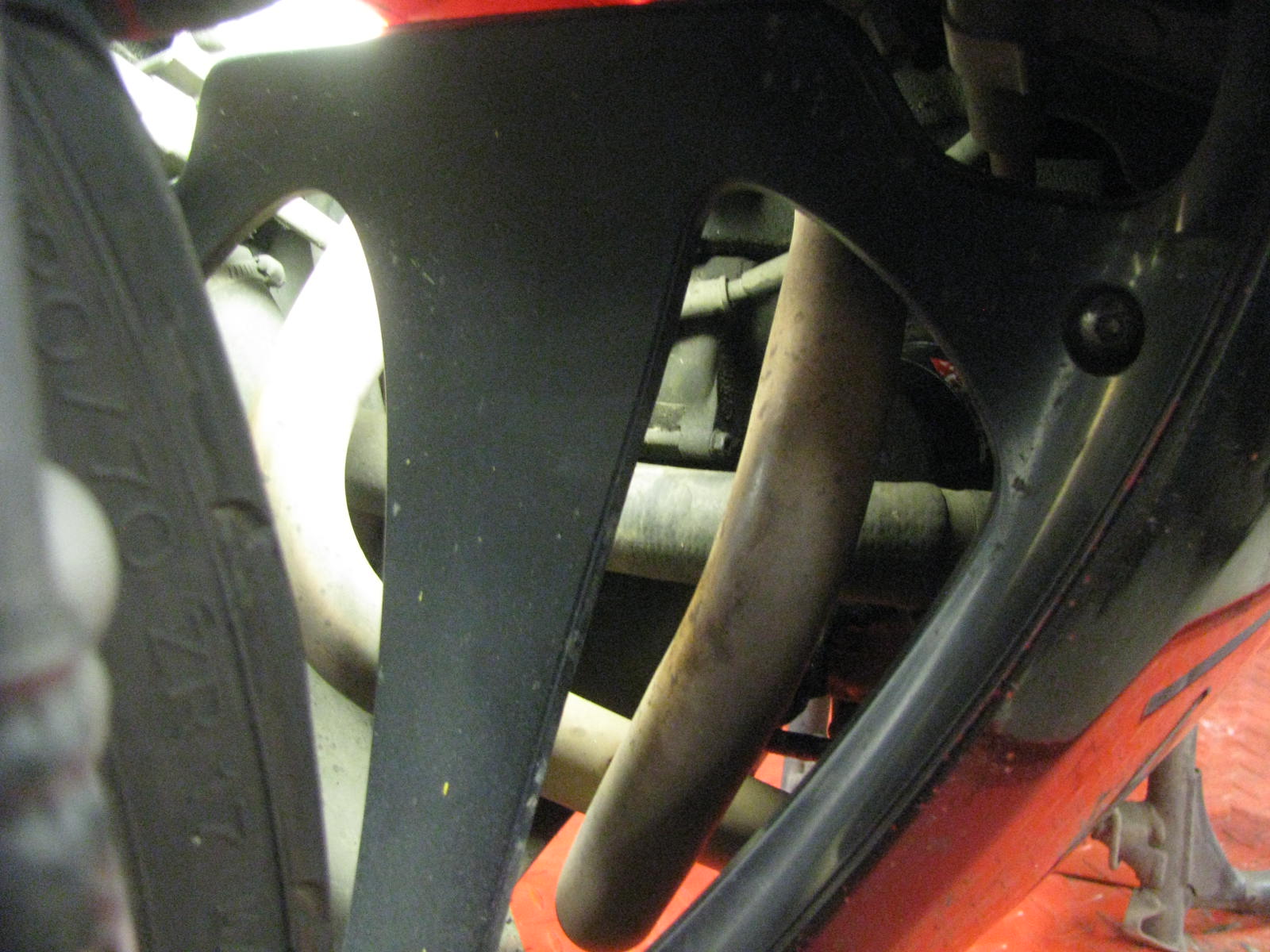

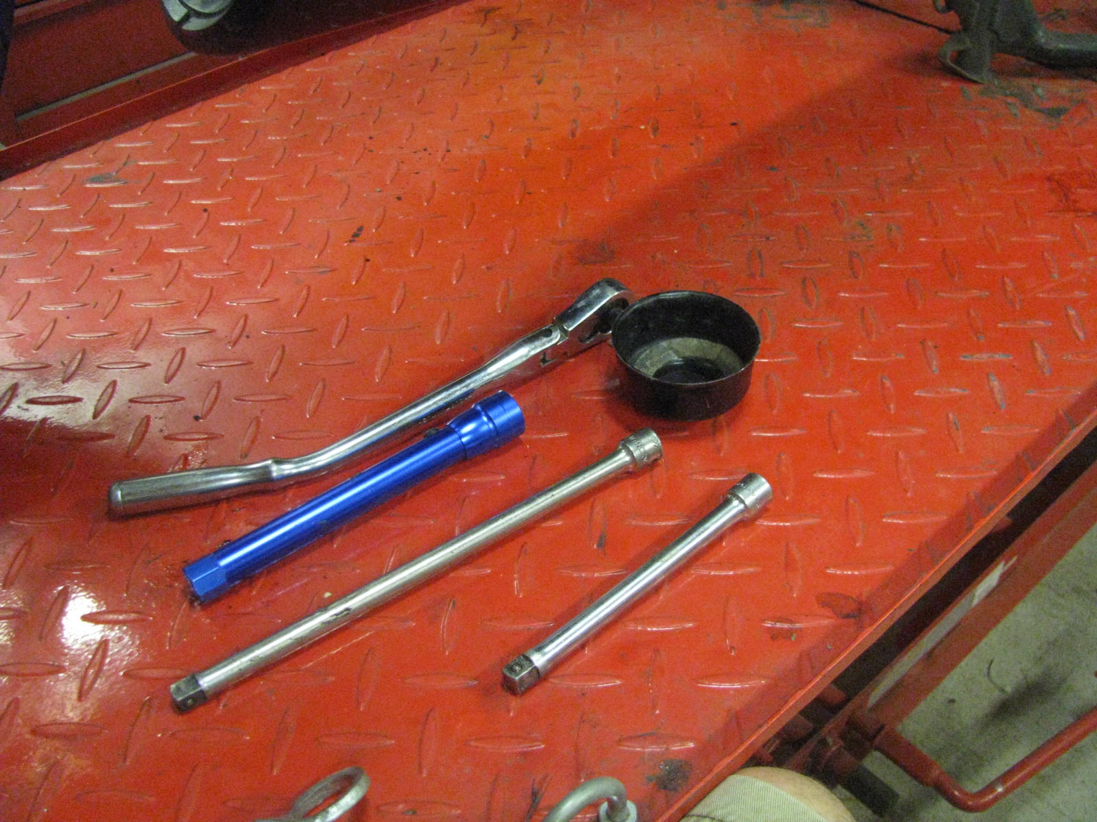

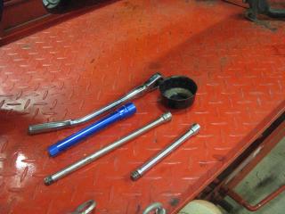

Baileyrock Posted October 26, 2010 Posted October 26, 2010 I have been doing oil changes on my vtec by simply removing the lower mounting bolts on the left lower fairing and sliding my hand in there to remove the oil filter, but while I was looking around I came to the conclusion that it looked like an oil change could be done w/o removing anything except the drain plug and oil filter. Here is what I did. The tools needed were a filter wrench(socket type) and several length extensions, 3/8" ratchet and drain plug socket & drain pan. After draining the oil, I fished the filter socket in place through the opening in the front V-fairing. Once on the filter I tapped it on with the extension and placed the extension in the filter wrench. I simply unscrewed the filter, reached in(pulling/bending PVC cowl as needed) and pulled the filter out the front. now I just reversed the operation and installed a new filter used brake parts cleaner to spray off headers, added oil and I was done! :fing02: BR's method 355 :biggrin: Quote
