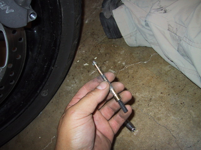

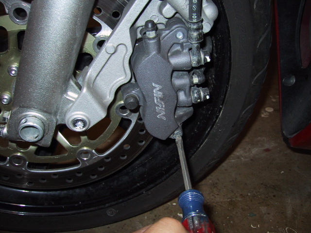

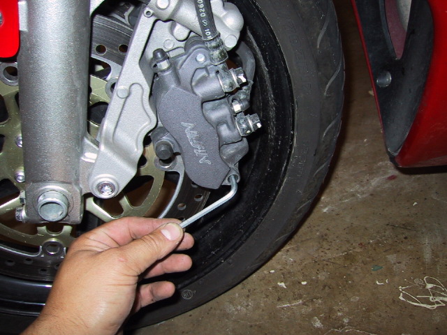

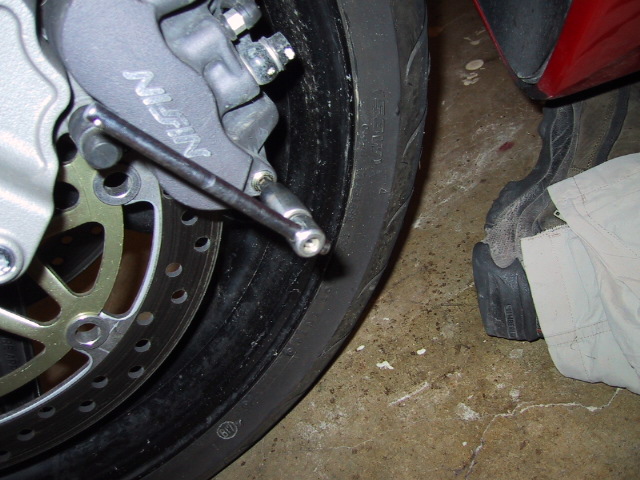

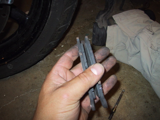

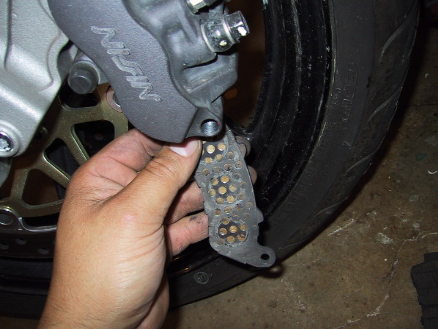

Forum CEO HispanicSlammer Posted July 22, 2002 Forum CEO Posted July 22, 2002 VFR owners delight in the ease of changing your own brake pads, 20 min job and very simple! No need to remove the calipers. Step 1 Remove the pad pin cap with flat head screwdriver Remove the pad pin with the hex key in your tool kit Of coarse this one was frozen and I stripped the key I had to get a harder key Step 2 once the pad pin is out the old pads practically fall out The caliper only has pistons on one side, they are opposed by a flat plate not an opposing piston so one side might not wear like the other To put in the new pads you must retract the pistons by pushing the caliper into the wheel first, if the brake pistons are not retracted you will not have room for the new thicker pads, there is a retaining clip at the top of the caliper where the pads sort of clip into to hold them in, slide them in the same way the old ones came out, then thread the pad pin thru the pad holes and tighten the pin, replace the cap, then pump the front brake to get the brakes to engage. DO NOT PUMP THE BRAKES UNTIL THE PADS ARE INSTALLED FIRST. Note, when pushing on the caliper to get the brake piston to retract you must monitor the fluid level in the brake fluid resiviour so that it does not over fill. 1 Quote
Guest Gamecock94 Posted January 8, 2012 Posted January 8, 2012 (edited) They need to take the cover off the Master Cylinder and suck out a little fluid when pushing on the caliper (so you can retract the pistons AND it doesn't overflow). Put a rag around the MC just in case of overflow.....brake fluid on paint is BAD. Once pads are in fill MC back up as necessary, put cover back on, THEN pump brakes. NEVER pump brakes with cover off, especially with low MC fluid level or you are sucking air into the system and will have to bleed the whole thing. I know it seems obvious to a seasoned biker, but a newbie might not follow what you were saying and you didn't mention until the last line. Edited January 8, 2012 by Gamecock94 Quote

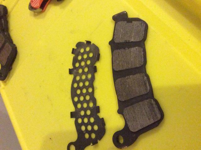

VifferSwiffer Posted June 7, 2014 Posted June 7, 2014 So question about changing the brake pads. My stock pads came with a metal bracket attached to the inner pad on each side. I didn't realize this until I was cleaning up. What is this, how important is it, and should I dive back in and attach it to the new pads? Quote
Member Contributer Switchblade Posted June 7, 2014 Member Contributer Posted June 7, 2014 So question about changing the brake pads. My stock pads came with a metal bracket attached to the inner pad on each side. I didn't realize this until I was cleaning up. What is this, how important is it, and should I dive back in and attach it to the new pads? image.jpg Which pads did you install? EBC pads have them . Quote
