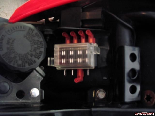

Tightwad Posted October 28, 2008 Posted October 28, 2008 My own design, I love how small it is, and how easy it is to get to: Quote
