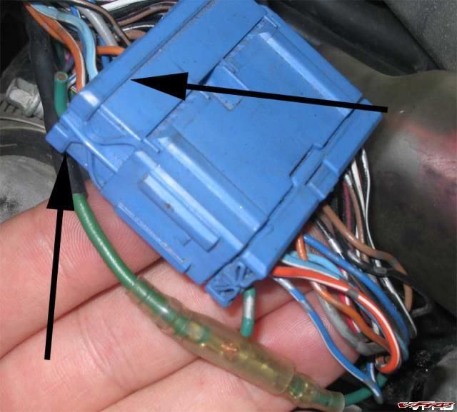

Bruckner Posted June 15, 2007 Posted June 15, 2007 OK guys, something of interest for those who bypassed the ground green wire around the blue connector because the latter can't be opened (fused plastic inner bits), you may be uncomfortable (as I was) knowing that any routine maintenance that requires this blue connector to be opened will require dealing with this stuck connector. The local Honda tech here in Montreal found a clever way to undo the blue box halves: there are 2 clips on the front side of the connection (towards the front of the bike) held in place by flexible plastic bits (in 'S' shape on picture, provided by a member here, thanks!), open these up and the individual connections will be exposed, undo the ground wire connection and a few others, use a flat screwdriver to push the terminal out of the socket (may require a bit of force) and voila. Put in generous amounts of grease, use the bypass and enjoy the peace of mind of knowing all connectors can be opened, as they should be, should need be. pic blue box copy.jpg Interestingly, Honda acknowledges that this connection must be checked during any inspection (tech call) so they are aware of the problem. For any Montreal owners experiencing this problem, see Richard at Excel Honda, he's an ace. Regards, Bruckner 1 Quote

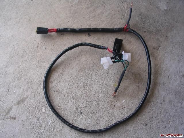

Tightwad Posted August 13, 2007 Posted August 13, 2007 My initial fix, prior to developing the harness currently being offered, was to run a fused, relayed wire from the battery to the sensor wire going to the RR. I simply removed it from the plug, using a jewelers screwdrive(any small thing screwdriver works of course) and then used a female terminal to connect. Taped over the terminal so it wouldn't short out on anything and I was good to go. I also replaced the short piece of wire in the 30 amp fuse assembly with a 12 gauge wire and soldered the connection. This steadied my voltage at 14.37 at 5k rpm, or 14.32 with high beams on. I was still worried about overloading the system, which is when I developed the harness. This brought the voltages to 14.45 at 5K rpm all the time. Quote
Guest Deathstar13 Posted August 13, 2007 Posted August 13, 2007 (edited) tightwad just dont answer my pm,it will save you from saying stuff 2x.i appoligise for the confusion as you answered this so fast i didnt even need to send the pm. jeremy- i take it i should pull the black wire out of its harness and tap it to the battery with a fuse and ill be good to go? i just cant leave it connected in the harness and splice into it without a relay. i seen the blue connector ground wire fix somewhere in all this reading so i know what your reffering too. i think its in this thread so ill backtrack and find it. found it: http://www.vfrdiscussion.com/forum/index.p...st&p=402525 this one? also any connectors i use should i dab dielectric grease on them? im guessing i should to stop corrosion. Edited August 13, 2007 by Deathstar13 Quote
Member Contributer jeremy556 Posted August 13, 2007 Member Contributer Posted August 13, 2007 Easiest way to the monitor wire fix is to remove the wire from the connector on the R/R side with a small screw driver, then use an insulated female quick disconnect to connect to your fused wire from the battery. Quote
Member Contributer jeremy556 Posted August 13, 2007 Member Contributer Posted August 13, 2007 i seen the blue connector ground wire fix somewhere in all this reading so i know what your reffering too.i think its in this thread so ill backtrack and find it. found it: http://www.vfrdiscussion.com/forum/index.p...st&p=402525 this one? Yep, that is it. I used some of those crimp on quick splices into the wire on each side of the connector and grounded it... Quote
Guest Deathstar13 Posted August 14, 2007 Posted August 14, 2007 (edited) wow,what a long day. i just finished up the bike and test rode it to check for issues. cost was $17 in parts alone so who ever buys the harness from TIGHTWAD is getting a great deal. it wasnt hard work,just nerve racking a bit knowing i could be screwing up a perfectly good running bike as mine was just starting to show issues on the wire turning brown but it ran perfect. i added all 12 guage wireing and 12 guage wired fuses. a 30a on the fuse replacement and a 10a mini fuse on the RR sensor wire. also i did the grounding mod,even tho im not even sure what it does but ive learned to not second guess people when it was so easy. can you tell me why it needs done? i could definetly seeing a shop charging $500 to do this work and mabey not even fix it correctly. again ty guys for all the help and advice. Edited August 14, 2007 by Deathstar13 Quote
