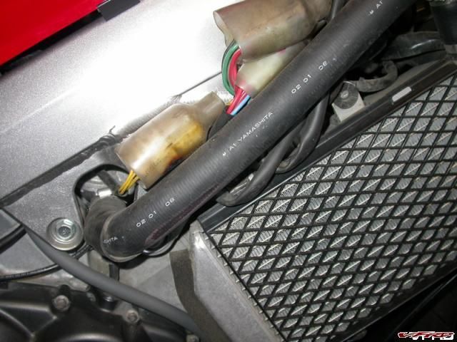

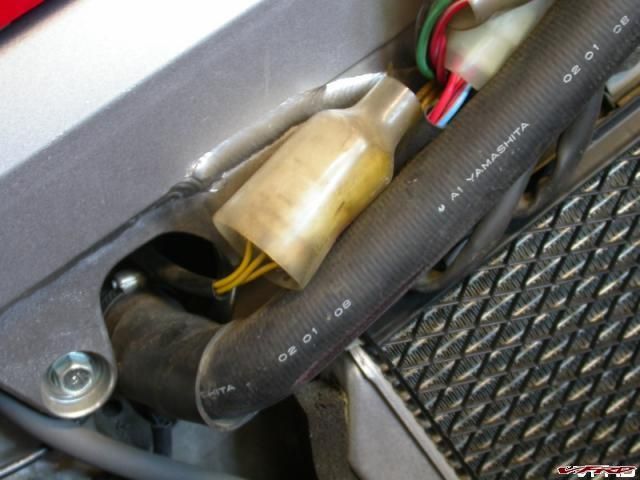

KanadianKen Posted August 13, 2006 Posted August 13, 2006 I pulled the "Blue" connector apart today (the one that is on the left side of the bike, above the left Rad). I was looking to see what kind of shape the internal connection was on the GREEN ground wire terminals. It was absolutely perfect. No buildup of any corrosion or crud, immaculate. My 02' had the beginnings of the 30 AMP main link wire burning up issue, but I snipped it and spliced in a serious duty 10 gauge wire and heavy duty fuselink about 18 months ago. I wonder if the preventive measure I took on the 30 AMP link, had something to do with the Green ground terminals inside the BLUE block being in such good shape? THe blue block is easy to seperate - just push the tab in, and using a small flat head screwdriver, gently split the connector in two. Piece of Cake to inspect, and worth your time - I did it cause I changed the oil and had the fairing off today. :thumbsup: Quote

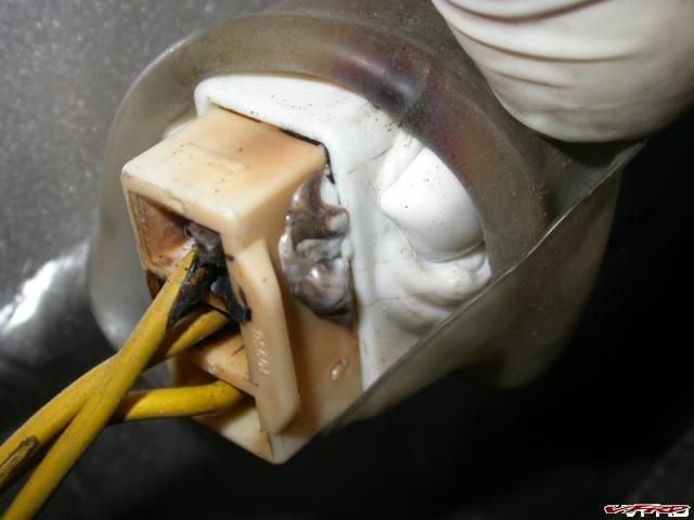

soichiro Posted October 24, 2006 Posted October 24, 2006 Well it looks like I am in the club. I have checked my 30 amp fuse and wiring since new. Bike is an 04 with 15k miles. I have never seen any discoloration, and they always look fine. I have not had any problems. I checked yesterday and the plastic at the fuse and the small wire connector are discolored slightly. The short wire is hard and brown. The short wire started getting so hot and melted some plastic in the battery tray and the red plastic sheath on the wire to the battery. Looks like I am going to radioshack. I do not see a good how-to on installing this fuse block. I am sure it is simple, but it is not clear to me exactly what I need for the wiring, except for the radio shack block with 10g wire. I also noticed some photos towards the beginning of the thread have been lost, as well as some important thread links. Quote

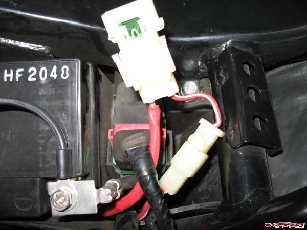

drb Posted October 24, 2006 Posted October 24, 2006 (edited) Fuse Stock 2002 fuse holder Please help me replace this bugger!! 1. Am I supposed to replace the larger red wire on the left of the photo with 10G wire? If so where does it lead to or terminate? 2.The other small connector that has red/white coming out of both ends does all of that wire get replaced with 10g wire and again where does the end that disappears lead to or terminate? 3.Do the metal clips inside the main fuse and the other smaller connector just pull out? 4.I am assuming that if I am replacing with 10g wire that I have to get new male or female connectors? 5.Does the new fuse holder from RadioShack support the use of 10g wire and connectors? 6.How much dielectric grease should be used, where does it go, and how is it applied? I would also like to know if the stock fuse holder is typically just kind of tucked away or is it supposed to mount some where or attach to something. Thanks Edited October 24, 2006 by drb Quote
Member Contributer jeremy556 Posted October 24, 2006 Member Contributer Posted October 24, 2006 Fuse Stock 2002 fuse holder Please help me replace this bugger!! 1. Am I supposed to replace the larger red wire on the left of the photo with 10G wire? If so where does it lead to or terminate? 2.The other small connector that has red/white coming out of both ends does all of that wire get replaced with 10g wire and again where does the end that disappears lead to or terminate? 3.Do the metal clips inside the main fuse and the other smaller connector just pull out? 4.I am assuming that if I am replacing with 10g wire that I have to get new male or female connectors? 5.Does the new fuse holder from RadioShack support the use of 10g wire and connectors? 6.How much dielectric grease should be used, where does it go, and how is it applied? I would also like to know if the stock fuse holder is typically just kind of tucked away or is it supposed to mount some where or attach to something. Thanks you are replacing the thick red wire, the fuse holder, anf the red/white wire. clip off the connector on the wire harness side on the red/white wire. remove the fuse holder and thick red wire which goes to the battery+. connect your new wire to battery+ terminal and run it to your new fuse holder. from the new fuse holder solder splice to where you cut off the connector on the wire harness side just tuck the new fuse in where the old one was Quote
Guest warp10 Posted October 24, 2006 Posted October 24, 2006 (edited) Thanks for the details too. Wouldn't clipping it between the harness and connector still leave a lot of thin gauge wiring throughout the harness? I'm sure doing this would help temps come down between the battery (through the fuse) and harness, but after saudering the 10gauge wire to the harness, heat can build up downstream. Are the harness wires able to handle 30amp? Sounds like its at the threshold of burning up. What if we did this mod and add in a 25amp fuse? What systems are in need of 30amp? I'm guess at least the low and high beam lights, which in turn may blow up the fuse So is there a way to limit the draw of current down to 25amps? I'm sure there's folks out there that use more than 25amps with grip heaters, high beams, GPS, etc.... Well I only have 2k on mine, seems like I'm going to have to check the power and ground wires like I check my underwear. Also decided to buy some of that "liquid insulation" think covering the ground wire on the blue connector should help. Man, VFRs remind me of the Star Trek Enterprise. Nice ship, love her, but remember how many electrical/plasma issues that ship has...when it gets jolted a little but..EPS conduits explodes out of no where and your control panels. Wouldnt it be great whenever your computer decided to crash or gets a virus your keyboard and monitor goes BOOM! Edited October 24, 2006 by warp10 Quote

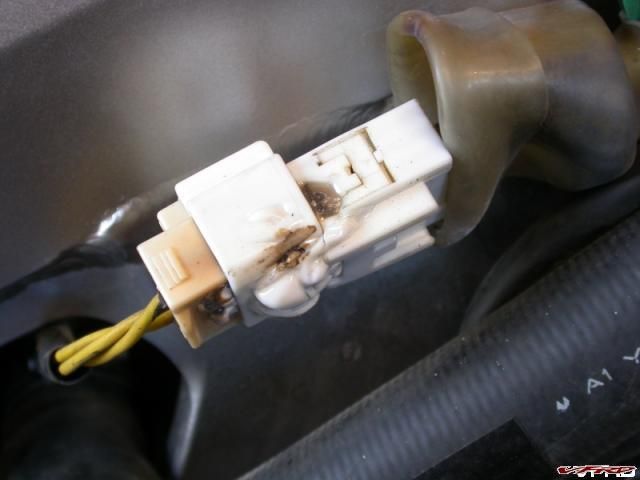

Member Contributer Rice Posted January 17, 2007 Member Contributer Posted January 17, 2007 Just want to add my 2c to this rather leangthy post. I checked my 30 AMP fuse wire and had to replace it as well. Just like all the rest, my wire, just the short 2in portion that leads from the fuse holder to the conector, was brittle and discolored from temperature. Unlike others that replaced the entire red wire all the way from the battery + terminal, I only replaced the fuse holder and the connector by cutting them off and splicing in a new fuse holder with a 12GA wire. In my opinion, the red/white wire that comes from the battery as well as the one that leads past the connector is not the problem and does not need to be replaced. The problem is the smaller guage 2in wire between the fuse holder and the connector. After making this change, I noticed an improvement in the way the bike starts. Apparently, the smaller guage wire had acted as a resistor and reduced the current available to starter. My starter would sometmes stumble during startup before. Each stumble was accompanied by a momentery loss of power, which would reset the clock and the trip meters. After the fix, this no longer happens, so I guess the fix worked fine. While I was "there", I also used dielectric grease on ALL terminals and connections that I could get to with ferrings off. Now, the electric system should be bulletproof :goofy: Quote
Baileyrock Posted February 12, 2007 Author Posted February 12, 2007 Just want to add my 2c to this rather leangthy post.I checked my 30 AMP fuse wire and had to replace it as well. Just like all the rest, my wire, just the short 2in portion that leads from the fuse holder to the conector, was brittle and discolored from temperature. Unlike others that replaced the entire red wire all the way from the battery + terminal, I only replaced the fuse holder and the connector by cutting them off and splicing in a new fuse holder with a 12GA wire. In my opinion, the red/white wire that comes from the battery as well as the one that leads past the connector is not the problem and does not need to be replaced. The problem is the smaller guage 2in wire between the fuse holder and the connector. After making this change, I noticed an improvement in the way the bike starts. Apparently, the smaller guage wire had acted as a resistor and reduced the current available to starter. My starter would sometmes stumble during startup before. Each stumble was accompanied by a momentery loss of power, which would reset the clock and the trip meters. After the fix, this no longer happens, so I guess the fix worked fine. While I was "there", I also used dielectric grease on ALL terminals and connections that I could get to with ferrings off. Now, the electric system should be bulletproof Not So, I did everything you mentioned and more and still had the Failure with the No Start, Buzzing behind dash, etc. which is typical of the Blue Connector failure but w/o the blue connector failing. Added the extra ground to frame like done when the blue connector fails and it fixed the problem. My Blue connector is still perfect(looking). :goofy: Quote

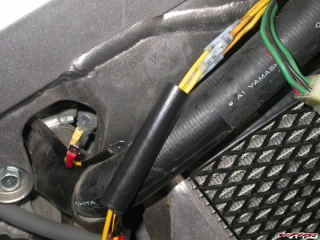

tinyminds Posted February 17, 2007 Posted February 17, 2007 Was asked to post this up from another How-To i made here: http://www.vfrdiscussion.com/forum/index.php?showtopic=29737 There was a writeup before, and a couple different people saying how they did things, but no pics. So we were replacing Teague's last night ( and mind even though mine wasn't shorted out, just for prevention ), and I decided to take a few pics of the process. Any questions let me know. 1 Quote

tinyminds Posted March 26, 2007 Posted March 26, 2007 Figured I would post this from a different thread since its pretty well related to this one: Got my bike ripped apart rewiring everything I can think of and decided to add the RR>Battery rewire to the list. Did mini writeup. Most of the stuff should have been covered through the rest of this post, but heres a couple pics of what I did. Haven't got the bike back together to test it but I'll let you know what my results are when I finished, hopefully by Sunday. It sits at 15.0 at just above idle (~1300 rpm), but if I rev it, it does not fluctuate much. The real test will be the riding test. I hit 16V between Rolla and KC yesterday, and that scared me. So relating to what you posted about running high voltage, I finally got my bike back together after doing the wiring mods, then hooked up multimeter, started her up, woooooooo 16.0vdc. Not cool. Well that wasn't right thats for sure. So, I got a different Multimeter because I have blown several Amp fuses in that meter and was thinking maybe somehow I damaged the meter, since I pretty much just use that meter for amperage testing. So, new meter, boom..... 16.0vdc. Well, I wasn't happy. So, I remember Jeremy mentioning to me that he had this problem and it was an issue with the R/R's Monitor Feed ( Black Wire > Ignition ). So pull that fairing off again, backprob the 'black wire from R/R with one multimeter, while leaving the other multimeter hooked directly up to the battery, ( Battery showing: 16.0vdc, Black wire showing: 12.3vdc ). Cha..ching! So, pulled the black wire out of the stator connector harness, hooked it separately ( out of the connector ) up to the battery direct to she if this helps the problem, plugging the harness back up which connects all the wires but the ' black > white / black '. So hooked this wire up, boom, voltage charge dropped instantly from 16.0vdc to 14.7vdc. So hook up a perminant wire from stator voltage monitor wire ' black wire ' to battery, still solid 14.7vdc. Slapped fairing back on, good as gold. Edit: if you run a new wire from black monitor wire to the battery, you have to, have to, have to disconnect the black wire to white/black wire from eachother in the harness. If you don't when you turn the key off, the bike will keep running because it wills end a reverse 12v feed to the ignition switch, tricking it to thinking the key is still on. Edit End: Come to find out, this high voltage problem has been going on for a while I suppose ( haven't checked voltage in about a month, was good then though ), but didn't test voltage before I started this project, so... lesson learned, but problem solved. So, back to what this thread is about. I ran the two new 12guage stator wires ( red/white ) from regulator to battery to lower resistance while keeping an additional 30amp fuse in each wire. So, pulled the fuses out of the new wires, tested voltage, 14.5 vdc, put fuses back in and tested voltage, 14.7vdc. Not a huge improvement in my case, but dropped resistance on the feeds for sure. Have been pretty constant on doing a lot of preventative stuff without any problems, excluding the new R/R monitor wire I stated above, which has been my first electric issue thus far. Some people get better results than others, but its a peace of mind and worth the time to prevent issues before they occur for me, instead of waiting for things to blow then figure out what happened. :thumbsup: So, does this wire need to be switched? My black lead into the R/R is not hot when the bike is turned off. I don't have me service manual on me, so I can't double check what wire is what, and verify that this is the voltage regulator monitor wire. You can run it constant w/ no problems, but you have to disconnect it from the 'White/Black' wire on the female side of the R/R Connector and cut it off or tape that wire off or it will send a 12 volt feed backwards to the ignition, causing the bike to keep running even when you turn the key off. You don't have power to that black wire when the key is off because its reading voltage from the ignition, but its just monitoring the voltage, not actually putting it to use. Running it constant instead or switching it the way it is factory, makes no difference, all the R/R cares about is how much power is at the battery, when the bike is off, voltage is still feeding to the monitor wire, but its just sitting there, no current draw from it at all. Next week I'm going to look at trying to track down exactly where and what is causing the resistance problem in that 'white/black' wire that seems to be a known issue. Not sure if its a short somewhere in the wire or a connector problem along the way. Its a tiny wire, so short could easily be a problem, but it appears to be a progressive problem, slowly getting worse and worse, which makes me think its heat related. Will keep you informed. If that doesn't make sense let me know, I'll draw up a diagram. Quote
Guest Oily Posted April 9, 2007 Posted April 9, 2007 Mine did this again at ~ 32K miles. Same BS, 30 amp fuse holder melted and wires. I still think it's a problem with the R&R, full wave, 3 phase SCR controlled rectifier, SCR = silicon controlled rectifier and they can lock on, must be reversed bias to turn off or commutate and if not you have a line to line short and high current. It's not the voltage at all. Energy or heat = current = I^2R. Checked mine with clamp on DC amp probe, high current > 30 amps and like before finally goes away. Fuse and wires hot to the touch. R&R hot to the touch. I still have my replacement R&R as I never ended up needing it as it did the samething, it just stopped doing it. 2 days later, current running about 12 amps, normal, low beams are 55watt over 12 vdc = 110/12 = 9 amps, add in running lites and you get about 12. So it's gone again. Rewired fuse and wires, carry on and just hope it doesn't do it again for another 4 years. But like all good Hondas I knew it was acting up, FI lite flashing, ABS lite flashing, haul butt home, smell burnt wires, dies in the driveway. Pull seat, wrap the 2 bare wires together, ride it to the barn. Fix it the next day. Quote

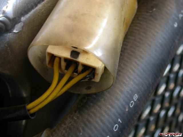

Guest jcarruth Posted April 15, 2007 Posted April 15, 2007 Three weeks ago I had the same problems associated with the blue molex plug on my 2002 ABS model. Buzzing relays, would not start without pulling the headlight fuse, etc. I had all of my buddies helping me figure out the problem, one was a VTEC owner - he called me and told me about the ground wire at the blue plug fix, I fixed it with a jumper, everything was cool, I thought. I then checked the main fuse, it was cooked so bad at he two inch 14ga wire that the wires had fused together, bypassing the fuse! I replaced the harness with a homemade heavy gauge one as described in previous posts. Everything was cool. However, I own two Acuras, one Civic, a ST1300, a Honda mower, and this VFR. All of this stuff, with the exception of the mower, is on the Honda owner link. The guys at Honda could tell instantly that I am and have been a dedicated Honda customer. I then called Pat at 1-866-784-1870 and reminded her of this. Both of these issues are a PITA, but more important - they are SAFETY issues. If you don't crash from a dead engine in traffic then you get to burn up! Pat was very nice, worked with my local dealer who is also very nice, and together they provided me with two new wiring harnesses #s HO32100-MCW-L10 (main) and HO32102-MCW-A00 (front) along with a new battery cable #HO32401-MCW-D00 and starter motor cable #H032410-MCW-D00. $360.00 worth of labor and $407.30 worth of parts, $767.30 total, all paid for by American Honda. Cool! I thought. I got the bike home it ran fine, etc. They had screwed up my accessory harness and horn wiring, but that was easily fixed. I then went for a ride. Once the bike got up to temperature, 171 degrees, the engine temp fluctuated from that to 240 degrees within minutes, then back and forth. The fans never came on. Also, the fuel gauge fluctuated from four bars to red , then back. I took the bike back to the dealer. They got on the phone with their tech guy and together they determined that my combination meter was bad due to the grounding problem that had just been fixed. Part # H037110-MCW-L11 and 1.2 hours labor later, I was good to go. $463.26 parts, $72.00 labor, all paid for again by our friends at American Honda. Total bill $1,302.56, Honda did me right on this one. Sometimes it just pays to raise a little hell. :D Quote
