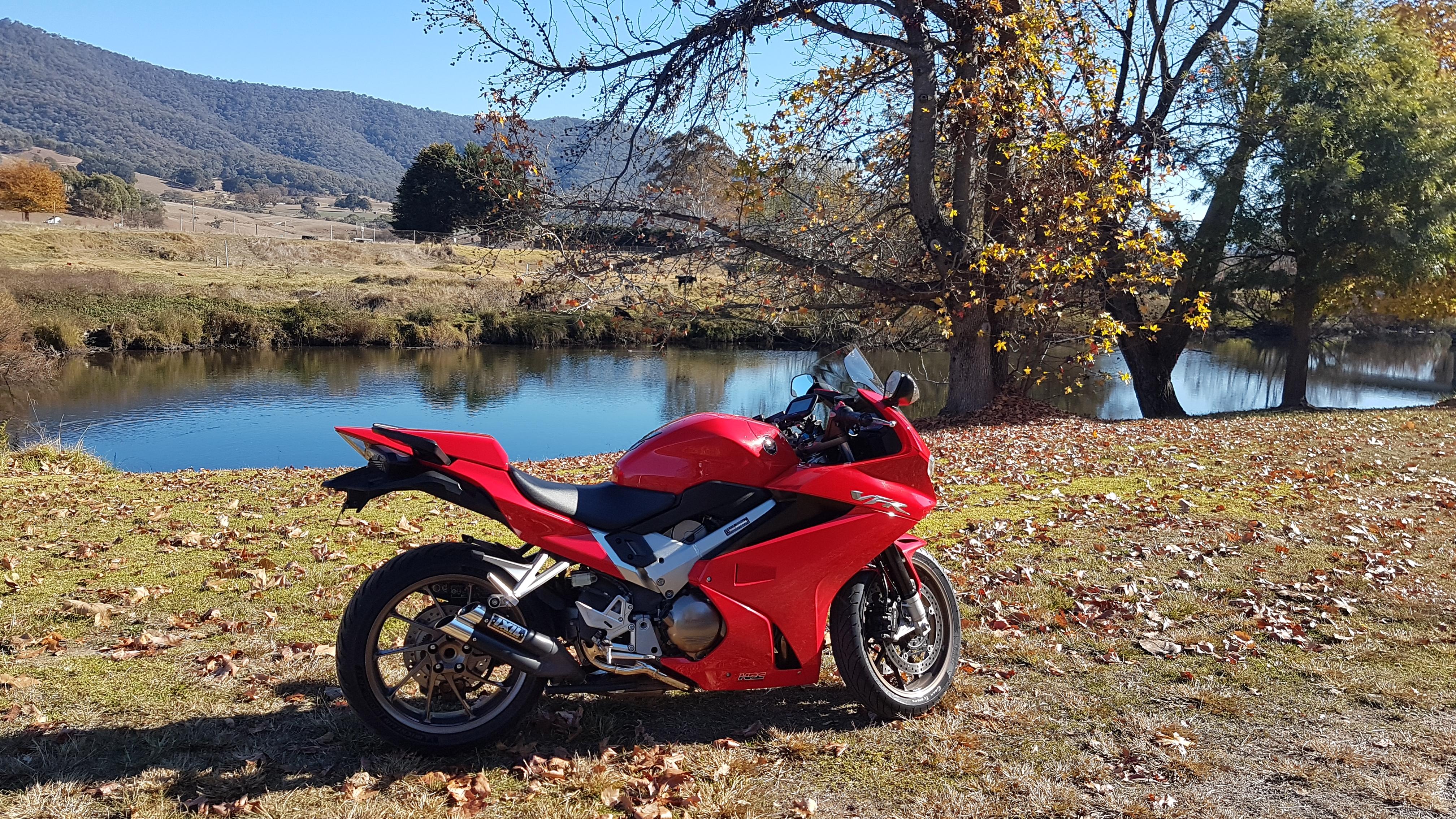

Member Contributer Grum Posted June 1, 2024 Member Contributer Posted June 1, 2024 30 minutes ago, Philois1984 said: Thanks Grum, I will try a different oil and flush the brake fluid, hopefully that will be all it is. If that doesn’t help then I will have to spend some money and let the experts? have a look at it (in case of confusion it is the VFR I’m having trouble with) Hope you are keeping well and the weather isn’t so cold you don’t want to get the bike out. Hi Phil. Just for info, my bike and gearbox seems to be very happy using Castrol Power1 Semi Synthetic 10W-40 oil. I've used this oil since the day I bought it along with previous 6gens. Flush both Clutch and Brake! Attached photo on Tuesday 28/5 in North Eastern Vic. Mornings got down to 1degC then warmed to beautiful late Autumn days. 2 Quote
