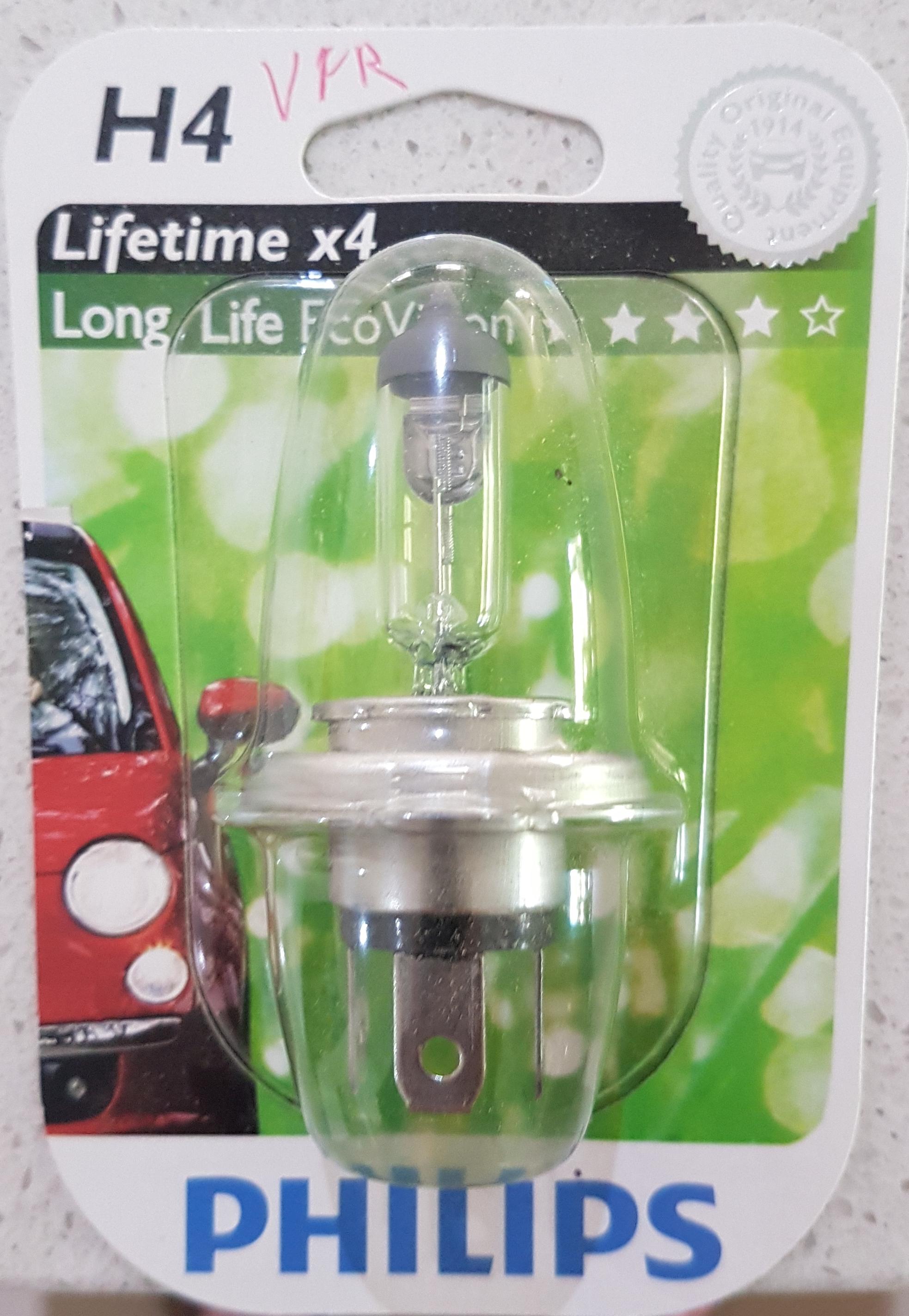

Andrew99VFR Posted December 14, 2021 Author Posted December 14, 2021 This is the globes they sold me. live just checked the voltage, with the key turned on it’s 12.56 volts, when running its 14.09 volts, and fluctuates slightly when reving is this to high? Quote
Member Contributer Grum Posted December 14, 2021 Member Contributer Posted December 14, 2021 Your charging voltage is fine, anything from 13.5v to 14.5v is good. These M.C.S. globes could be made anywhere, might be a Chinese cheapy who knows? As mentioned try a pair of good quality long life H4's. As a replacement of the OEM, I've previously used Philips Long Life Eco Vision H4's 60/55w on my 6gens, not had one of these blow. Use some tin snips to cut two tabs or bend them back to suite as suggested by bmart. Make sure the socket connectors are making good gripping contact to the globe contacts. Quote
Andrew99VFR Posted December 14, 2021 Author Posted December 14, 2021 3 hours ago, Grum said: Your charging voltage is fine, anything from 13.5v to 14.5v is good. These M.C.S. globes could be made anywhere, might be a Chinese cheapy who knows? As mentioned try a pair of good quality long life H4's. As a replacement of the OEM, I've previously used Philips Long Life Eco Vision H4's 60/55w on my 6gens, not had one of these blow. Use some tin snips to cut two tabs or bend them back to suite as suggested by bmart. Make sure the socket connectors are making good gripping contact to the globe contacts. Would the diff end wattage damage my headlight lens? Quote

Member Contributer DannoXYZ Posted December 14, 2021 Member Contributer Posted December 14, 2021 After seeing that packaging, it very well could be substandard globes. Only use top-quality bulbs in your bike such as Flösser, Narva, Osram, Philips, Toshiba, Vosla. Shame on Honda for creating proprietary H4 variation, this has probably created whole niche aftermarket for vendors selling "compatible" crap bulbs to unsuspecting owners who don't wish to pay Honda's prices. Best bet is to get high-quality H4 bulb and modify base to fit. 1 Quote
