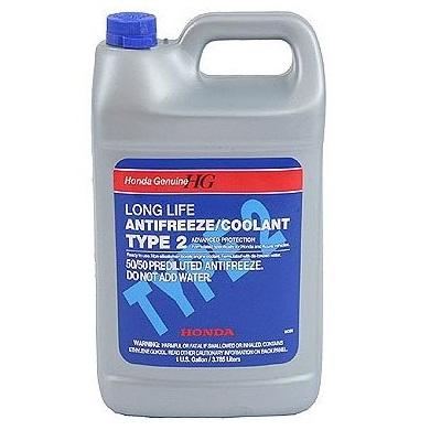

VFR80025th Posted October 18, 2021 Posted October 18, 2021 I plan on a coolant change in spring. On my 6th gen RWB I used Honda Coolant that I bought at the Honda motorcycle dealer. It was Blue. Can't remember if it was labelled type 2. I assume that is the same as the Honda Type 2 coolant you can get at any Honda car dealership. Correct? It needs to be silicates and borate free. Thxs Quote
mello dude Posted October 19, 2021 Posted October 19, 2021 The Type 2 coolant (Honda Blue) from the auto dealership is fine, I've used it for years.. 2 Quote
Member Contributer Grum Posted October 19, 2021 Member Contributer Posted October 19, 2021 22 minutes ago, mello dude said: The Type 2 coolant (Honda Blue) from the auto dealership is fine, I've used it for years.. +1 The only stuff I've used in VFR's premixed and ready to go. 1 Quote

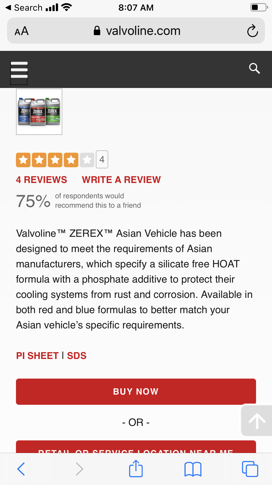

Member Contributer ducnut Posted October 19, 2021 Member Contributer Posted October 19, 2021 7 hours ago, Grum said: Are you sure about that ducnut? Can you be absolutely sure with a cheaper Asian blue automotive coolant that it has no silicates and borates, and that it also meets the Honda spec? For an important job you may do every 5 years or so, is it really worth the risk in saving a few bucks? Surely just having the confidence of using a known Honda spec coolant is well worth the extra? I personally wouldn't take the risk. As always YMMV. For Zerex (what I’m familiar with), it’s right in the first line of their product description. I’d think most modern coolants would conform to modern requirements, but, YMMV. Always best to read the label, with any product. https://www.valvoline.com/our-products/antifreeze-products/zerex-asian-vehicle-antifreeze-coolant Quote
VFR80025th Posted October 19, 2021 Author Posted October 19, 2021 Thanks everyone for your comments. I will stick with the Type 2 Coolant from Honda. (Blue) I think its even cheaper when you buy from an auto dealership or possibly online than a motorcycle dealer. Ride Safe. Quote
