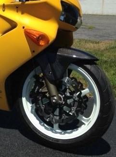

Member Contributer Tirso Posted October 13, 2021 Member Contributer Posted October 13, 2021 Sounds like you're doing similar to Terry: 1 Quote
Member Contributer Terry Posted October 13, 2021 Member Contributer Posted October 13, 2021 I put together: 6G triples and bars 5G ignition/steering lock CBR600F4i forks (uppers/lowers/innards) CBR600F4i guard 5G wheel, discs and axle CBR954 calipers CBR600RR master All fitted perfectly. I had to space the ignition down slightly with washers for the steering lock pin to mate with the frame socket. Quote
Member Contributer Terry Posted October 13, 2021 Member Contributer Posted October 13, 2021 4 minutes ago, Tirso said: Sounds like you're doing similar to Terry: Ha! beat me to it Tirso. 1 Quote
Member Contributer Ziffer Posted October 14, 2021 Author Member Contributer Posted October 14, 2021 On 10/12/2021 at 5:56 PM, Tirso said: Sounds like you're doing similar to Terry: Ah...that thread leads into a couple others. Plenty of reading to do. Thanks! Quote
Member Contributer Ziffer Posted October 14, 2021 Author Member Contributer Posted October 14, 2021 On 10/12/2021 at 6:00 PM, Terry said: I put together: 6G triples and bars 5G ignition/steering lock CBR600F4i forks (uppers/lowers/innards) CBR600F4i guard 5G wheel, discs and axle CBR954 calipers CBR600RR master All fitted perfectly. I had to space the ignition down slightly with washers for the steering lock pin to mate with the frame socket. This isn't *quite* what I'm trying to do... But this might be an option. If I'm understanding it right, the f4i tubes are only 5mm shorter than the 5th/6th gen tubes. That's pretty insignificant. On edit: I hadn't even considered the steering lock. I just figured I'd deal with stuff like this as it came up. Thanks for the heads up. Edit 2: So, based on my research, f4 forks have 587mm tubes. The VFR800 (5th and 6th) has 628mm tubes. This is much more than a 5mm difference. Is the fork length difference made up somewhere else? Quote
