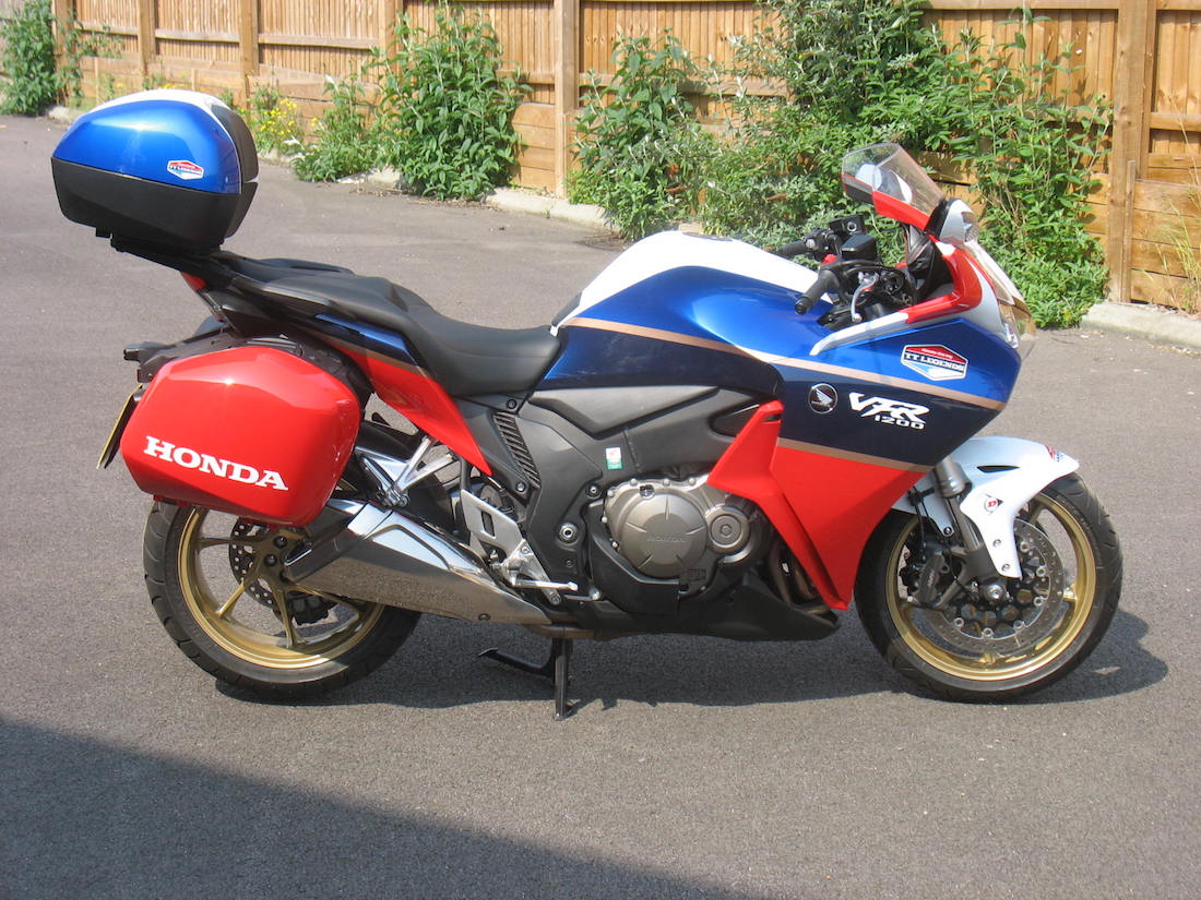

Now getting tempted to buy a VFR1200F and paint if up in TT Legends colour scheme.  Saw one the other day on a google search for some reviews and really liked the TT Legends paint scheme on the 1200..  funnily enough a friend of mine in Canberra used to own a VFR800 and he had it in the TT Legends colours, he ended up selling it to someone in Sydney and then went and bought himself one of the latest Kawasaki Ninja 1000SX.
Vfr1200 looking something like this.......awesome project.
Now I want to paint my VFR800!
