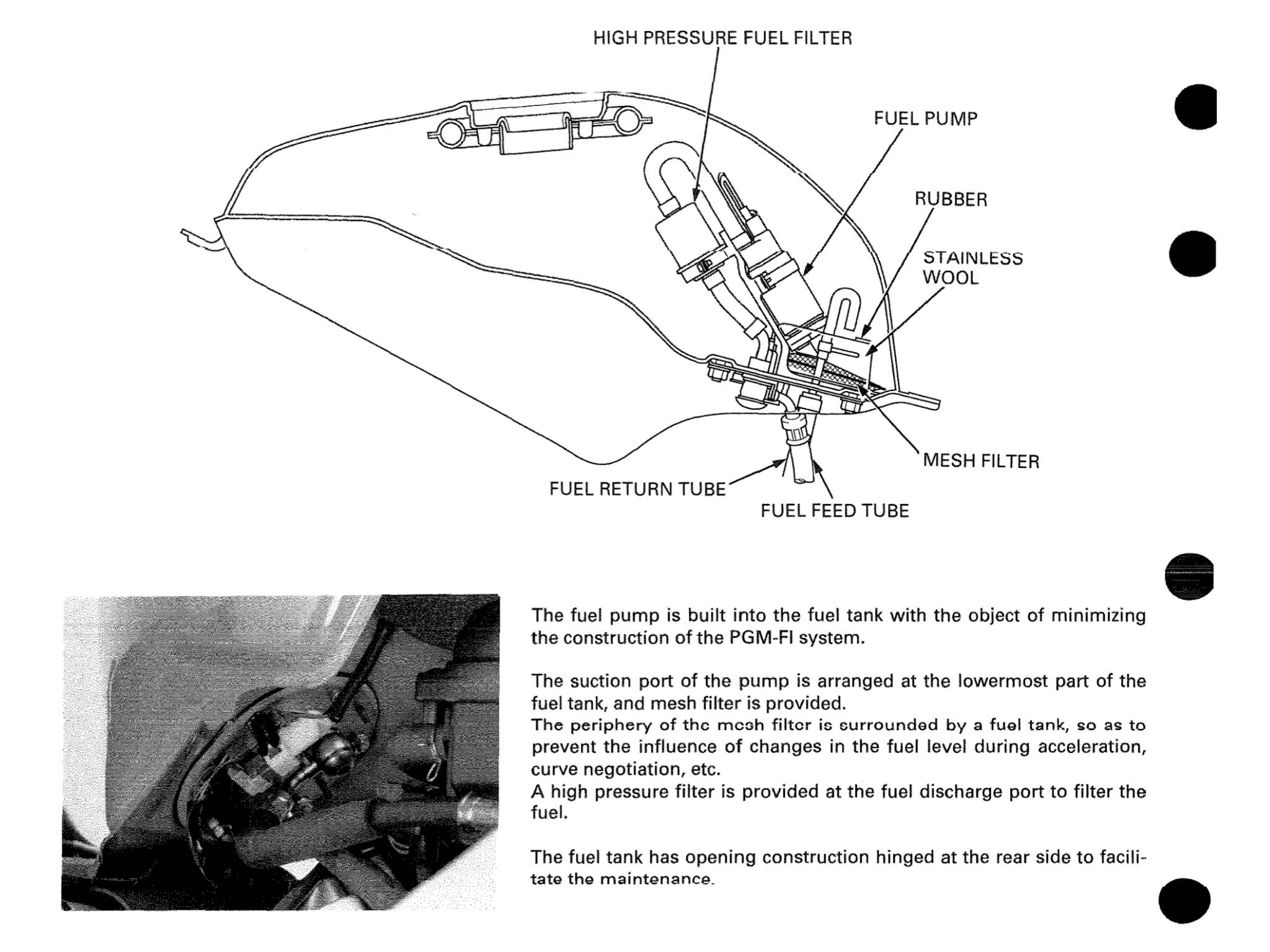

Member Contributer Grum Posted July 28, 2021 Member Contributer Posted July 28, 2021 12 hours ago, 4li3nVFR said: That is a possibility but I doubt it because I can continue riding for another 40 or 50 miles or so without running out. The problem may be the fact that this is a replacement non-OEM fuel pump. Maybe the fuel pickup mounts differently to it and is raised up a little too high? I have not personally laid eyes on this because my local Honda shop has done the work. I will ask them about it. Thanks for the info. Think you are onto it, especially as you have a non oem pump. I wonder if the whole assembly has been replaced or only the pump? Attached is the fuel pump description taken from the 5gen Service Manual, I'm sure the 6gen won't be too different. It specifically states the pickup is within its own tank to prevent the issues you've had. Perhaps this tank is missing around your mesh filter. Quote
4li3nVFR Posted July 29, 2021 Author Posted July 29, 2021 Awesome! Thank you Grum for the pic and text. That definitely helps me see what is going on in there. I'm gonna show it to the Honda guys in case they don't have it. Quote

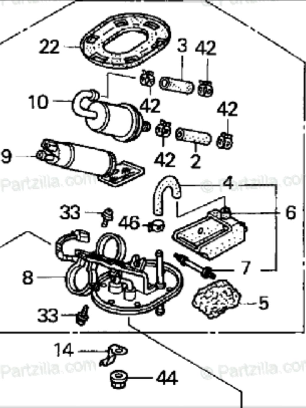

Member Contributer Grum Posted July 29, 2021 Member Contributer Posted July 29, 2021 12 hours ago, 4li3nVFR said: Awesome! Thank you Grum for the pic and text. That definitely helps me see what is going on in there. I'm gonna show it to the Honda guys in case they don't have it. Here's a view from the 2005 6gen parts list, item 6 shows the rubber tank arrangement for the fuel pickup. Quote
Member Contributer DannoXYZ Posted July 29, 2021 Member Contributer Posted July 29, 2021 surge tank swirl pot Quote
4li3nVFR Posted July 29, 2021 Author Posted July 29, 2021 7 hours ago, Grum said: Here's a view from the 2005 6gen parts list, item 6 shows the rubber tank arrangement for the fuel pickup. Grum, sir, you ARE the GOAT!👑🙏 1 Quote
