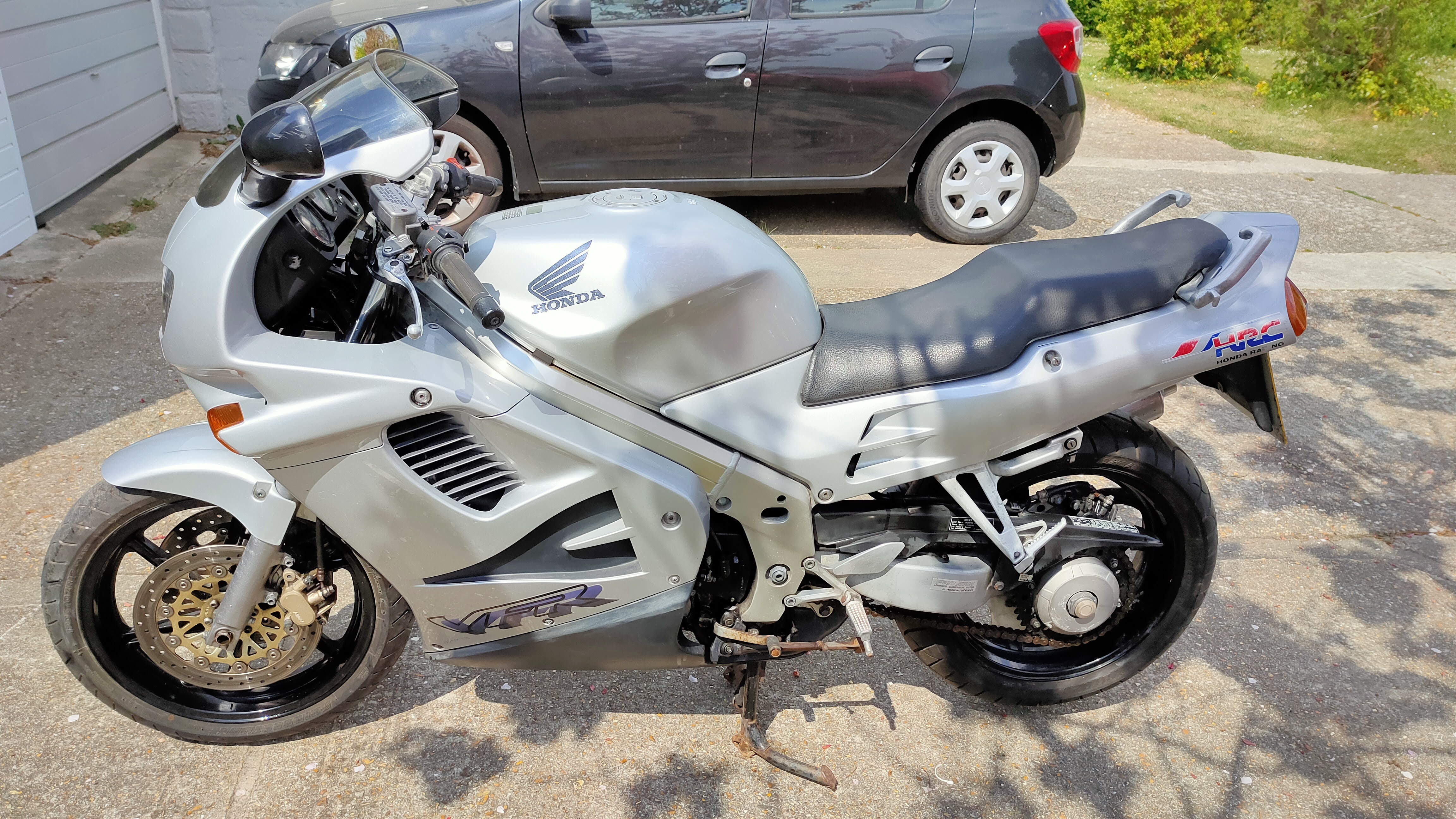

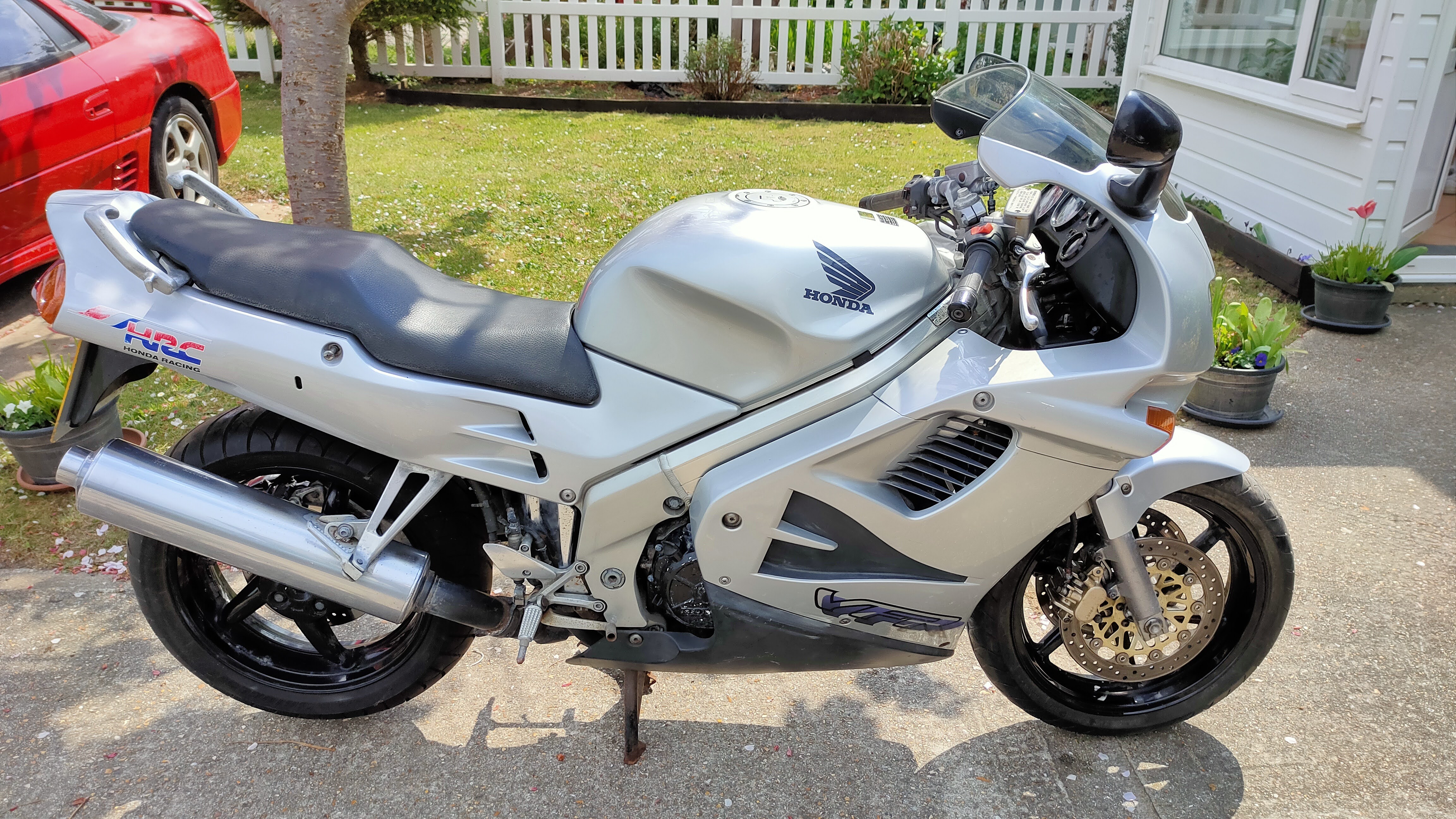

marco Posted May 5, 2021 Author Posted May 5, 2021 Hi got carbs off really easy after all... took pet cock off strainer looks ok ish cant get em anymore.. so hope its ok sucks and blows ok tank next to clean its dreadfull inside ive got another coming from ebay lovely clean inside but different colour as a back up also try fuel pump cheers for now.Herrs a couple pics of bike before i took apart hope one day when back together it runs and on the road! Got it for £550 so worth a chance. 2 Quote
