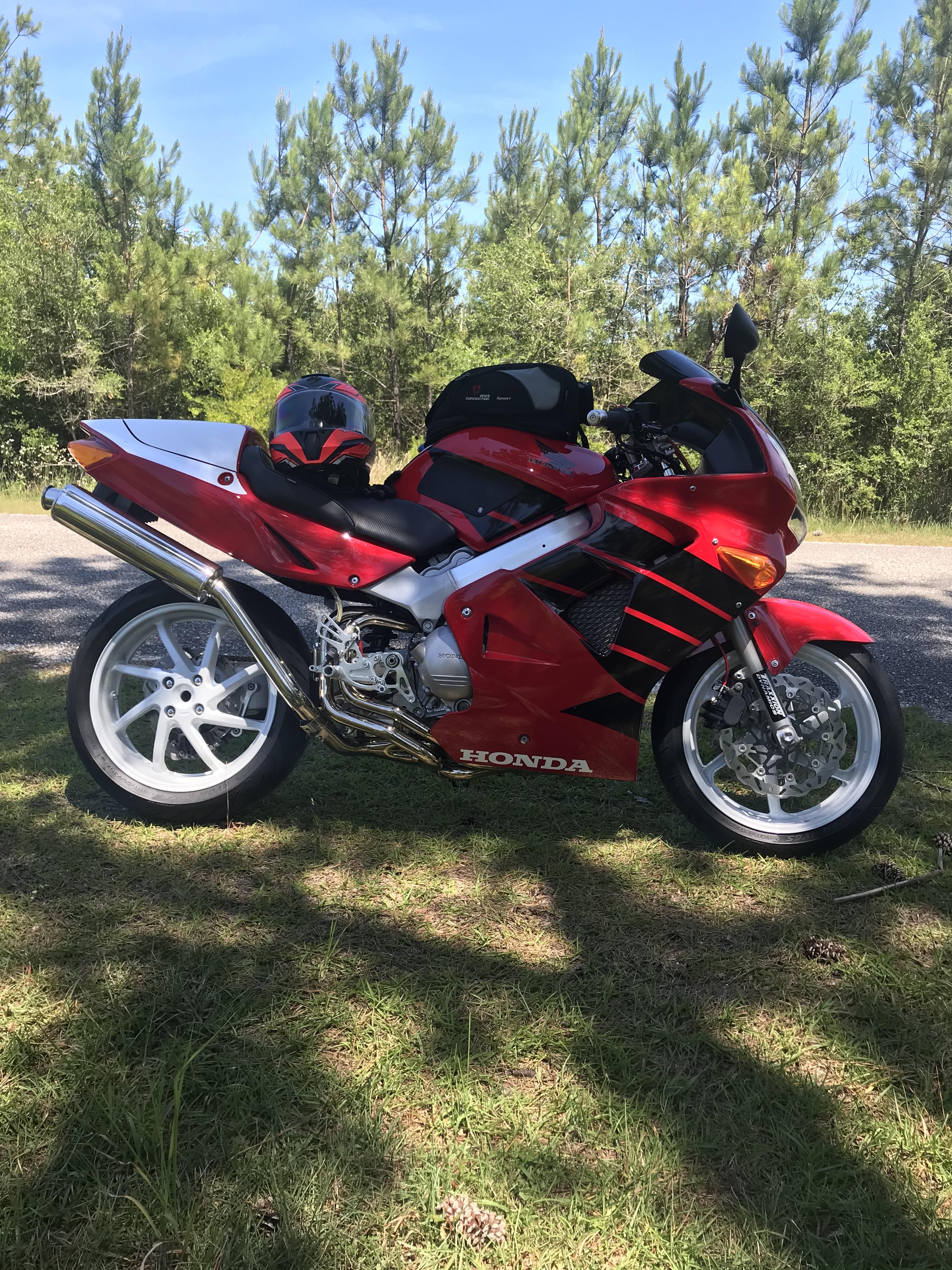

You want to powdercoat them, as it’s the most durable choice. I’d suggest 2 coats of clear, to really seal them and have a mirror finish. The smoother the finish, the harder it is for stuff to stick to them, and the easier to clean.
My 8-spoke (’90-’93 VFR) rear wheel is ink black powder coated.  The high gloss requires constant cleaning with swiffer duster and detailing in crevices with paint brushes.  If I wait too long and let the dust accumulate, the dust requires mild soap, small microfiber towel, and a bucker of water.  My wife keeps occasionally reminds me I should have done my wheels in white:-/
I guess most maintenance-free colour is flat dark brown!!!

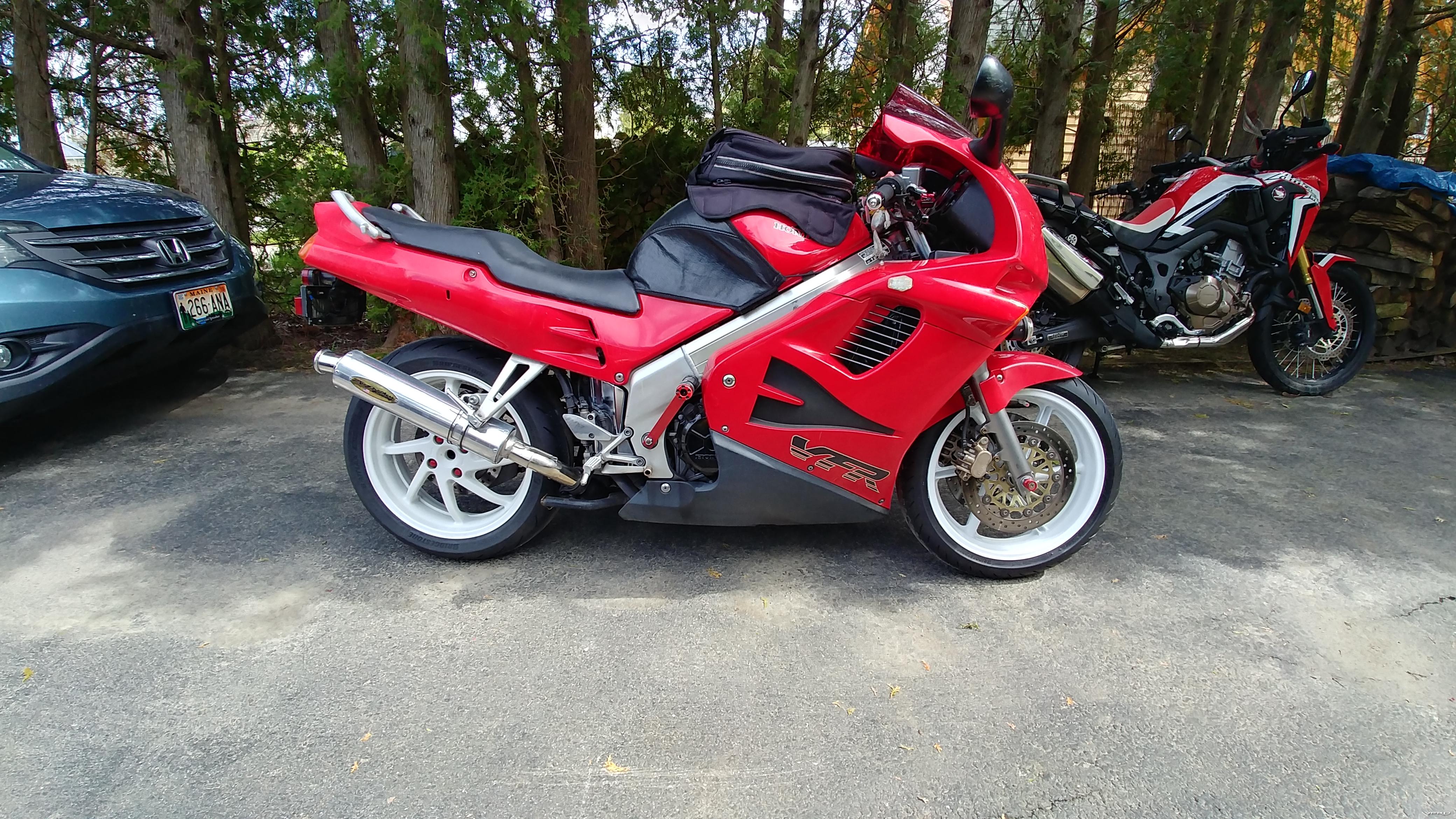

For the record, I went with a rattle can white enamel called interestingly enough, Appliance Epoxy by Rustoleum. A quick look at their product page shows its actually an enamel, which appears to be what Honda used on their rims.
I brought the rear wheel from my 91 back with me from the UK and looked into powder coating it as it needed attention. No one nearby, the cost of shipping from where I live is prohibitive, and the cost of having it done put it out of the family budget. I also reminded myself the marine industry, I work on ships, had pretty much given up on powder coating as its so hard to repair, and I live about a half mile from the Atlantic. So I had a go at sanding the rim, cleaning with alcohol and sanding the spots that needed it. Let it dry and put 3 coats on..  in stages as it dried. Let it sit for a few days and put the tire on. After 3 years and about 20K I had to touch it up a bit during a tire swap and decided to give it a sand and light coat in the end. The pic is how it looks 6 years on. The front is the original 4th Gen in Black that I painted the same way (had a third Gen rim but wanted the floating rotors). The oem paint was good so the white has lasted 3 years quite well. Not as much riding lately for obvious reasons but about 35K total since the experiment. For about $25 in paint, tape, sandpaper and alcohol, I'm OK with it.
Just a thought.
Forgot the link.
Specialty Appliance Epoxy Spray Product Page (rustoleum.com)
White wheels (or in my case polished) is like having a supermodel for a wife.  High maintenance, but worth it!!  :wub:
  • Haha 2
