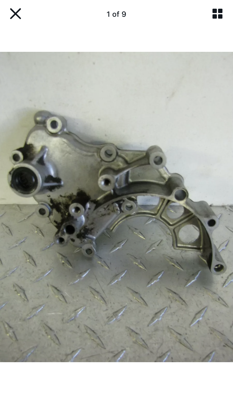

This is what I’d do if it were mine:
1. buy a new shifter cage thing (not sure what it’s called?) off eBay. Looks like this one from a 6th gen and very cheap...
2. Remove clutch slave, speedo and sprocket cover. Get everything off and out the way
3. Remove all bolts so only the broken bolt is left holding your “shifter cage thing” on
4. take a Dremel or angle grinder and CAREFULLY cut around the bolt hole where the broken bolt resides. The rest of the cage should just pull off as it’s only held with dowels. DON’T CUT INTO YOUR ENGINE!
5. if you’ve done it right the only thing left should be the broken bolt and the piece of cage it’s stuck in. Now just grab it with a pair of pliers and unscrew it off.
It’s very easy this way. Plus, you’ll have access to rethread the stripped hole properly with everything out the way.
If you don’t have a Dremel/grinder you could probably snap off pieces of the “shifter cage thingy” with a pair of stout pliers. These cast aluminium pieces are very brittle.
You may also want to buy a new bearing for the shifter shaft whilst you’re in there. Also very cheap.

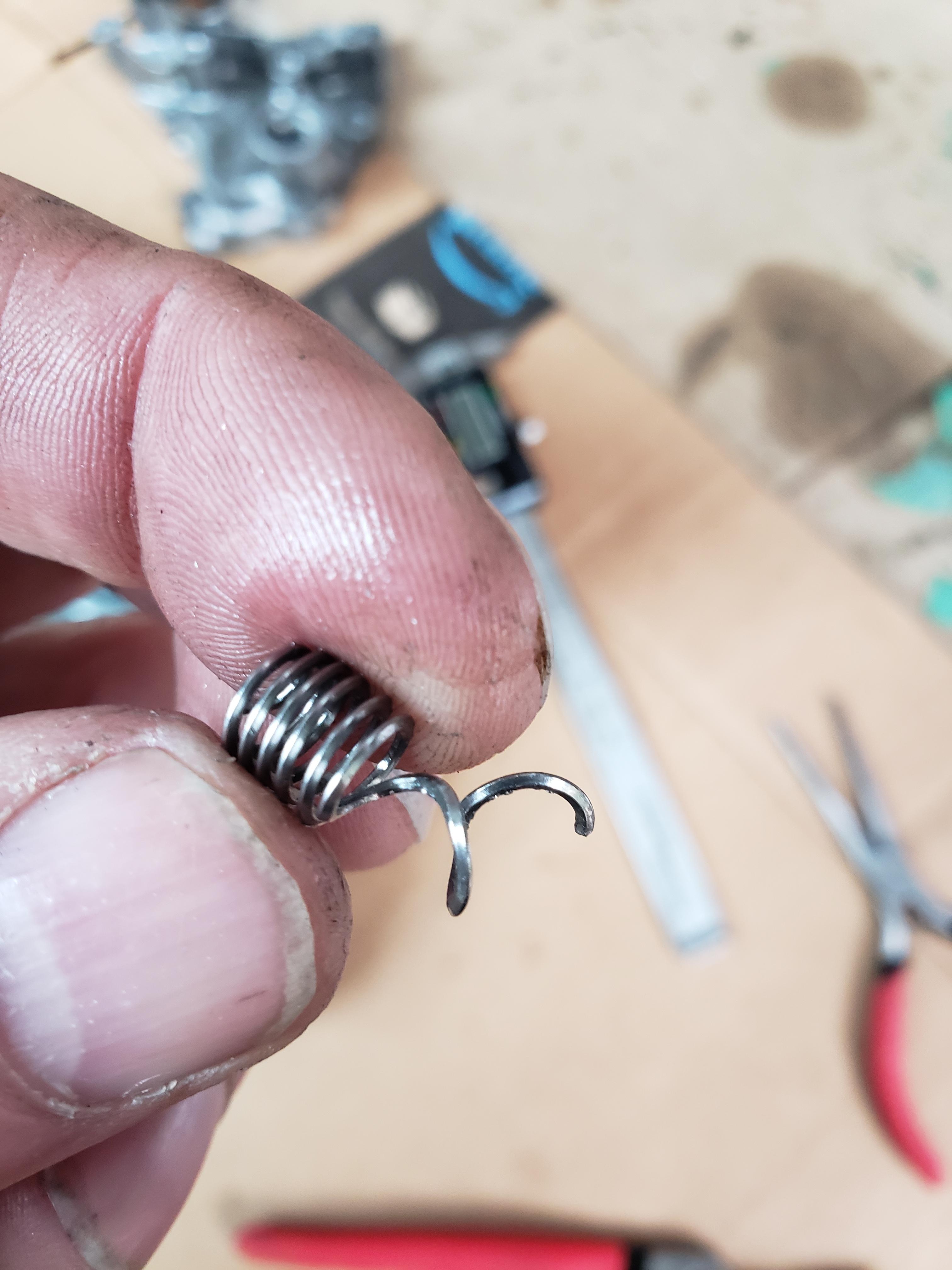

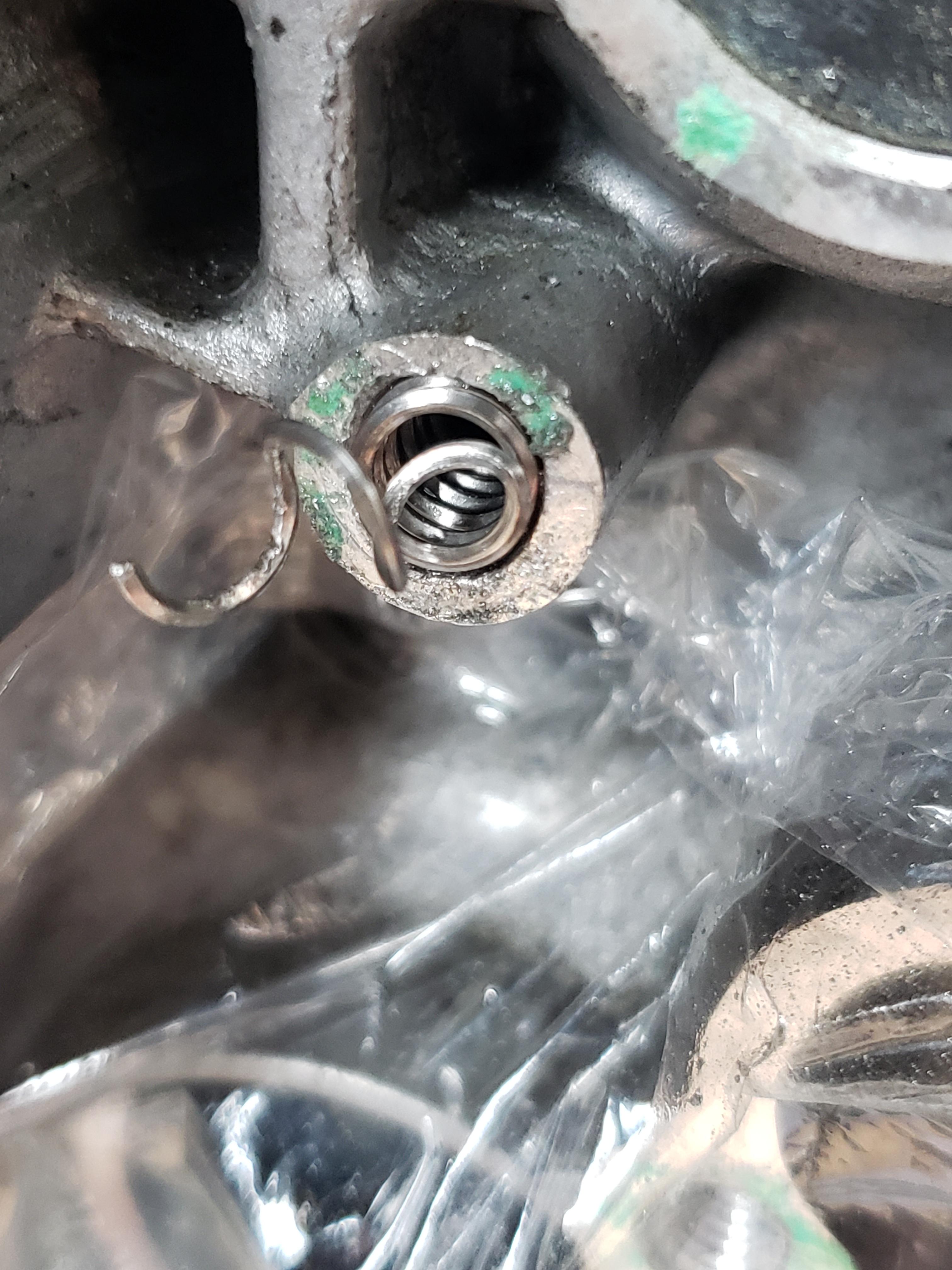

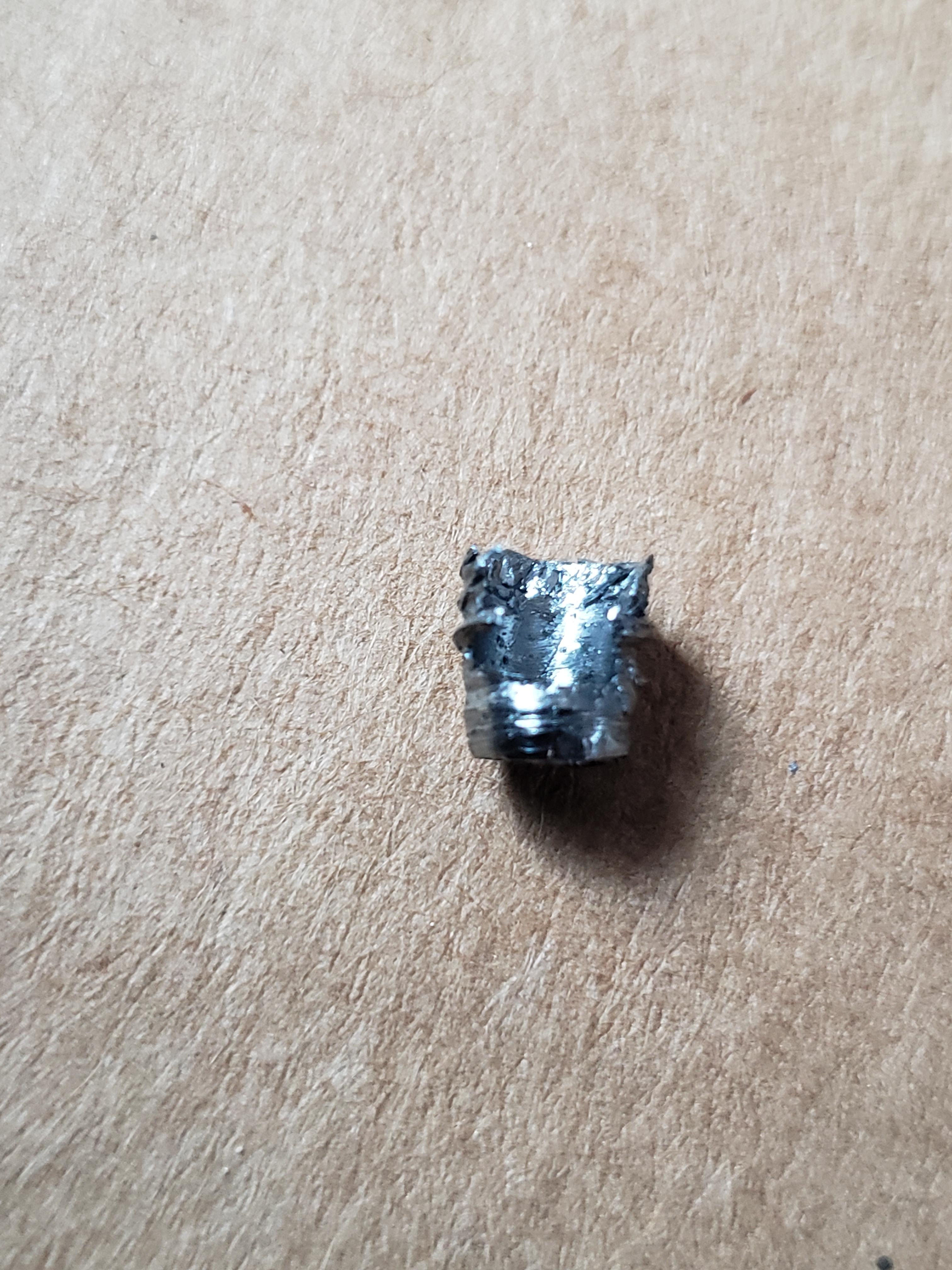

Drove up and met Styran this morning and helped him out. Very nice young man with great curiosity, and intuition for mechanical things. Great to see that, as it has become rare these days.
Turns out he had also snapped an extractor off in the bolt, trying to get it out, and those things are hardened. We were able to eventually get through that with some diamond dremel bits, and some patience. Then I was able to drill the remaining tip of the bolt and get it out with an extractor. Finally I was able to remove the old heli-coil. We cleaned, re-tapped, and cleaned the hole again. I had him order a longer heli-coil from McMaster Carr, so he will get full engagement. So far so good, and it looks like the repair should be solid.
I put the new coil in and it holds up great. Now I'm just praying I don't get any oil leaks.
