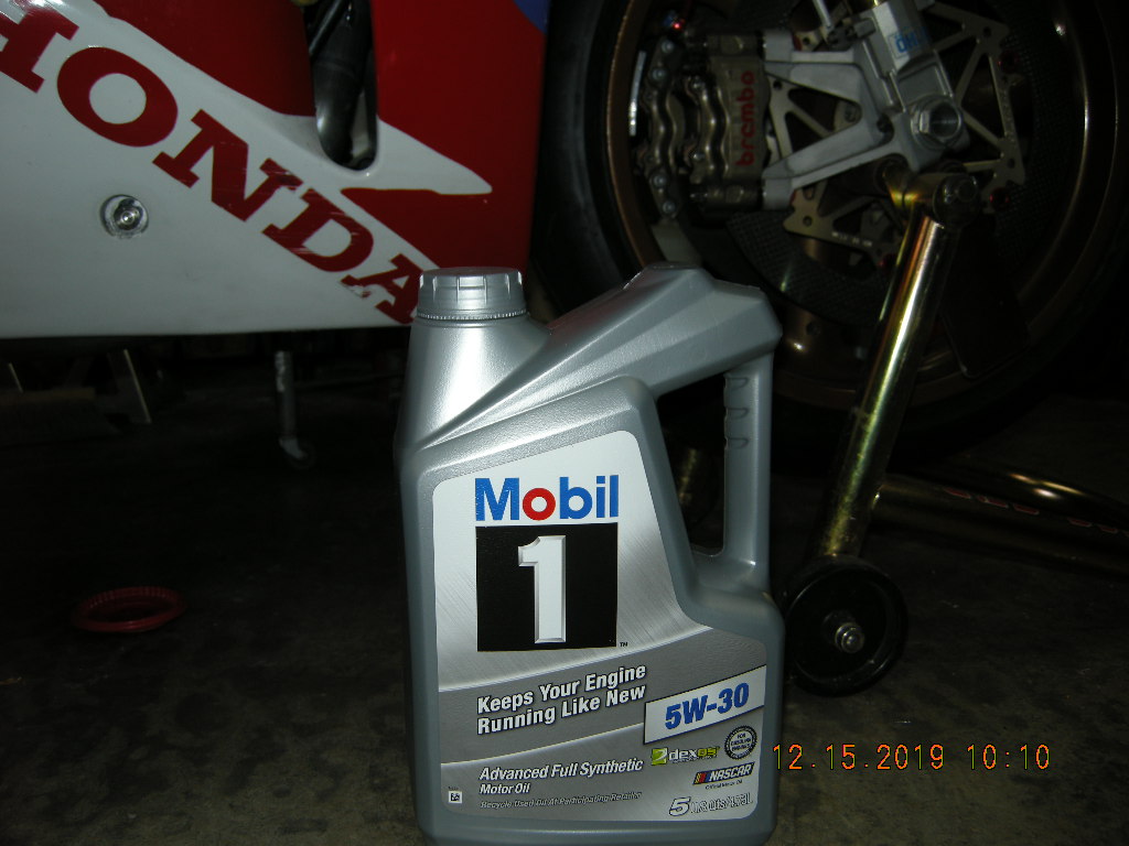

The choice is yours, but choosing a 30 grade over a 40/50 grade is smarter because it will:
1)increase 2 to 3 HP at the rear wheel
2)quicken the throttle response coming out of the corners...
3)decrease over all operating temps...
4)increase the oil flow at the critical bearings...
Either a 30 / 40 / 50 grade will reach your mileage expectations but only a full
synth 30 grade will lower your operating temp because it flows with
less drag than a 40 /50 grade... oil drag is real...
