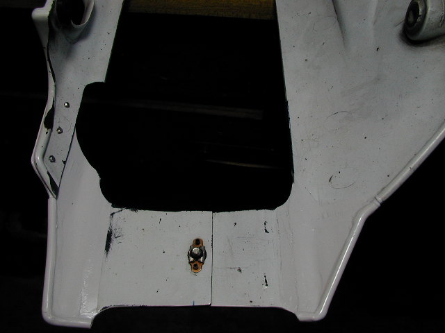

Member Contributer Thumbs 127 Posted December 21, 2020 Member Contributer Share Posted December 21, 2020 Acetone is the solvent for the styrene in ABS, as long as you remove the paint from the area you’re going to patch it’ll chemically weld the patch on Sheet ABS is cheap and available from eBay I’ve been using ABS pipe cement with considerable success, the stuff you get from builders merchants or eBay again Like this 1 Quote Link to post Share on other sites
