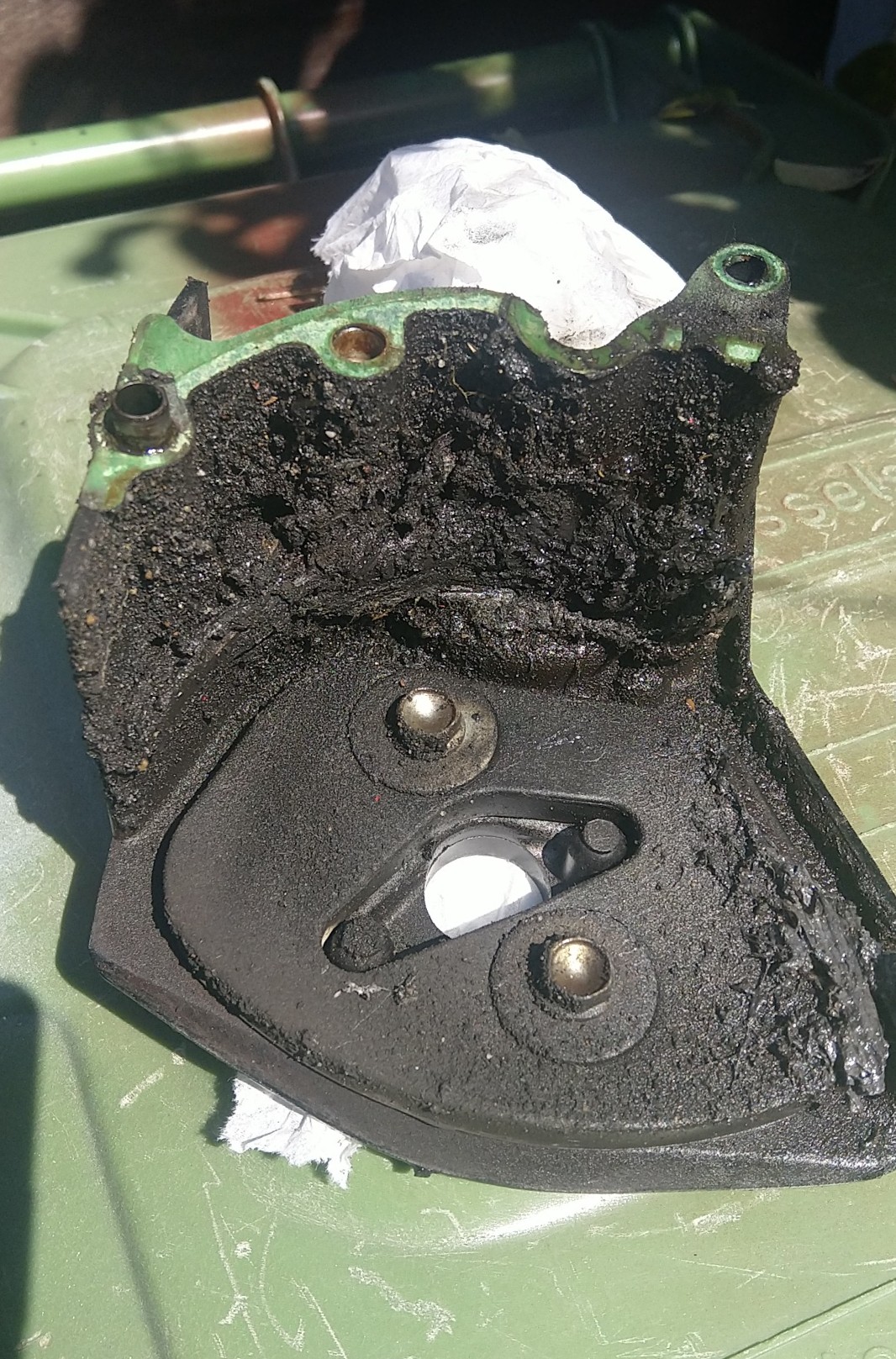

Member Contributer Dutchy Posted September 29, 2020 Member Contributer Posted September 29, 2020 Recommisioning a 4th gen, I removed 485 gramms of grease/grime from the front sprocket cover and area around the front sprocket. Wear Marigolds is my advise... 1 Quote
Member Contributer Terry Posted September 29, 2020 Member Contributer Posted September 29, 2020 3 hours ago, Dutchy said: Wear Marigolds is my advise... You Dutch people are just crazy...how's that going to help? 1 2 Quote
