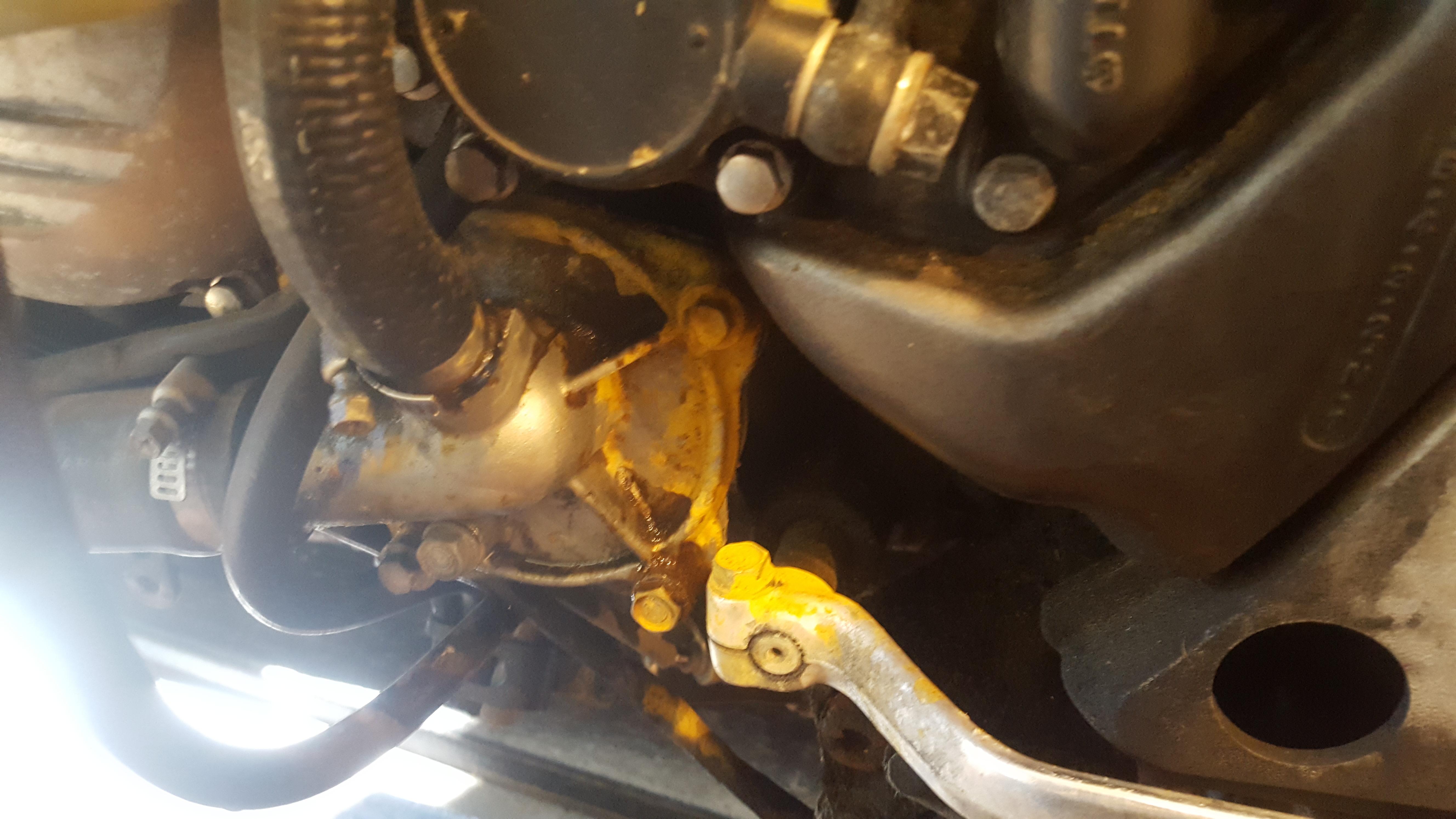

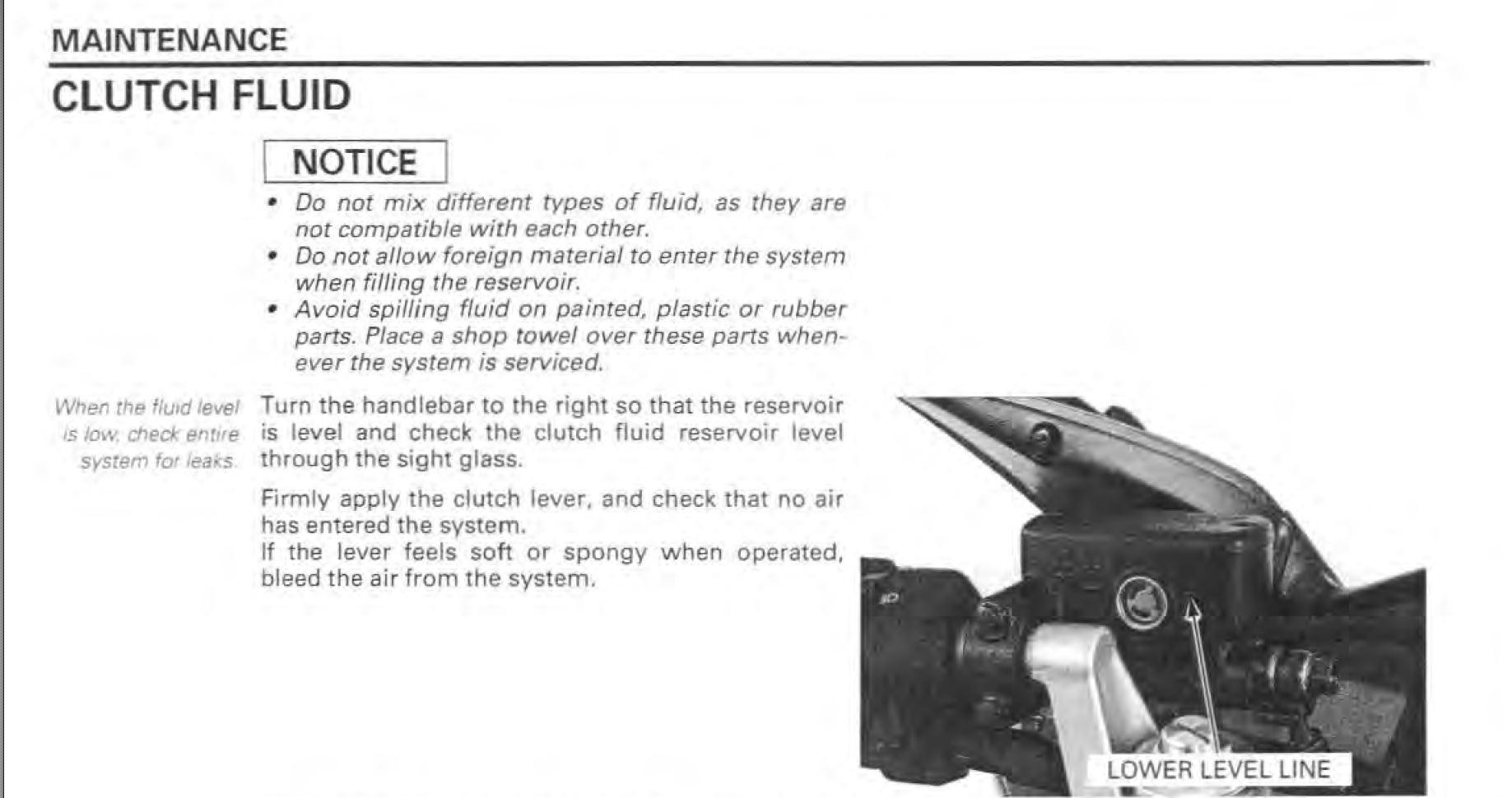

darkshad Posted September 6, 2020 Author Posted September 6, 2020 Alright....An update. I looked at the clutch fluid and it was a bit high, so I removed some. Per the manual, I tuned the handle bars to the right, made sure the master cylinder was level, and with plastics and top on, I see an air bubble at the top of the level. I also checked the small hole in the master cylinder - as far as I could tell, it looked good. I stuck an ice pick in the hole to check. Motorcycle still has the same problem, maybe even a bit worse. Could a failing water pump have anything to do with it? It appears that my water pump has seen better days. See picture below. May look at taking it in to the motorcycle shop for a diagnosis next week. Thanks. Quote
jstehman Posted September 6, 2020 Posted September 6, 2020 Did you rebuild the clutch slave and master cylinder when you replaced the parts? It looks like brake fluid may have been dripping down on the outside of the water pump housing.. Any seepage from the slave cylinder? And did you rebuild the clutch slave when you replaced it? Sent from my SM-N950U using Tapatalk Quote
darkshad Posted September 6, 2020 Author Posted September 6, 2020 36 minutes ago, jstehman said: Did you rebuild the clutch slave and master cylinder when you replaced the parts? No. Rather than rebuilding, I bought used parts off of ebay. 36 minutes ago, jstehman said: It looks like brake fluid may have been dripping down on the outside of the water pump housing.. Any seepage from the slave cylinder? And I don't think so. 36 minutes ago, jstehman said: did you rebuild the clutch slave when you replaced it? No. Rather than rebuilding, I bought the clutch slave off of ebay. The interesting thing is after I replaced both the master, slave, and added fluid, the motorcycle was running fine for one of my weekly rides. ie. Saturday weekend 1. The next weekend I took the motorcycle out and that's when this issue popped up. ie. weekend 2. Saturday weekend 2 was fine, but Sunday weekend 2 was when the issue cropped up. Since it was working properly for weekend 1 and first day of weekend 2, I'm not sure if the issue is a part I replaced, but I guess I could swap one of parts out (ie. slave cylinder) with the old slave cylinder and see if there is any effect. At least something to try. Thanks. Quote

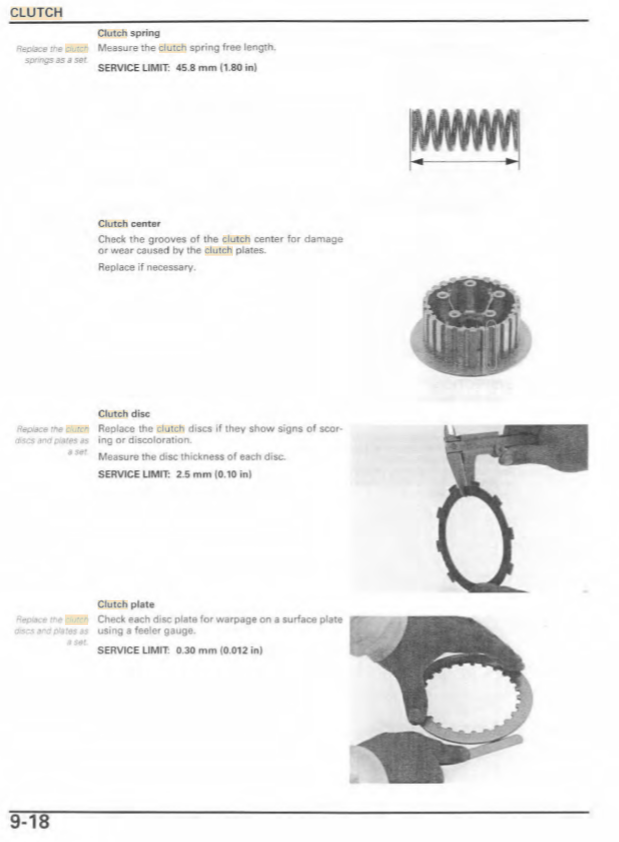

Member Contributer DannoXYZ Posted September 21, 2020 Member Contributer Posted September 21, 2020 Well, gasket would be needed to put stuff back together. For now, you can at least measure thickness of individual clutch discs and plates along with thickness of entire stack. Also measure clutch-springs if you have tension-measuring devices. Otherwise, free-height will do. I usually replace springs with stiffer Barnett ones while I'm there. Quote

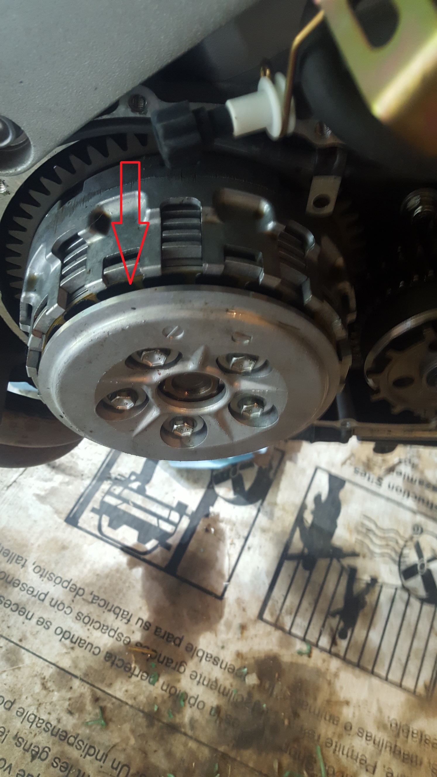

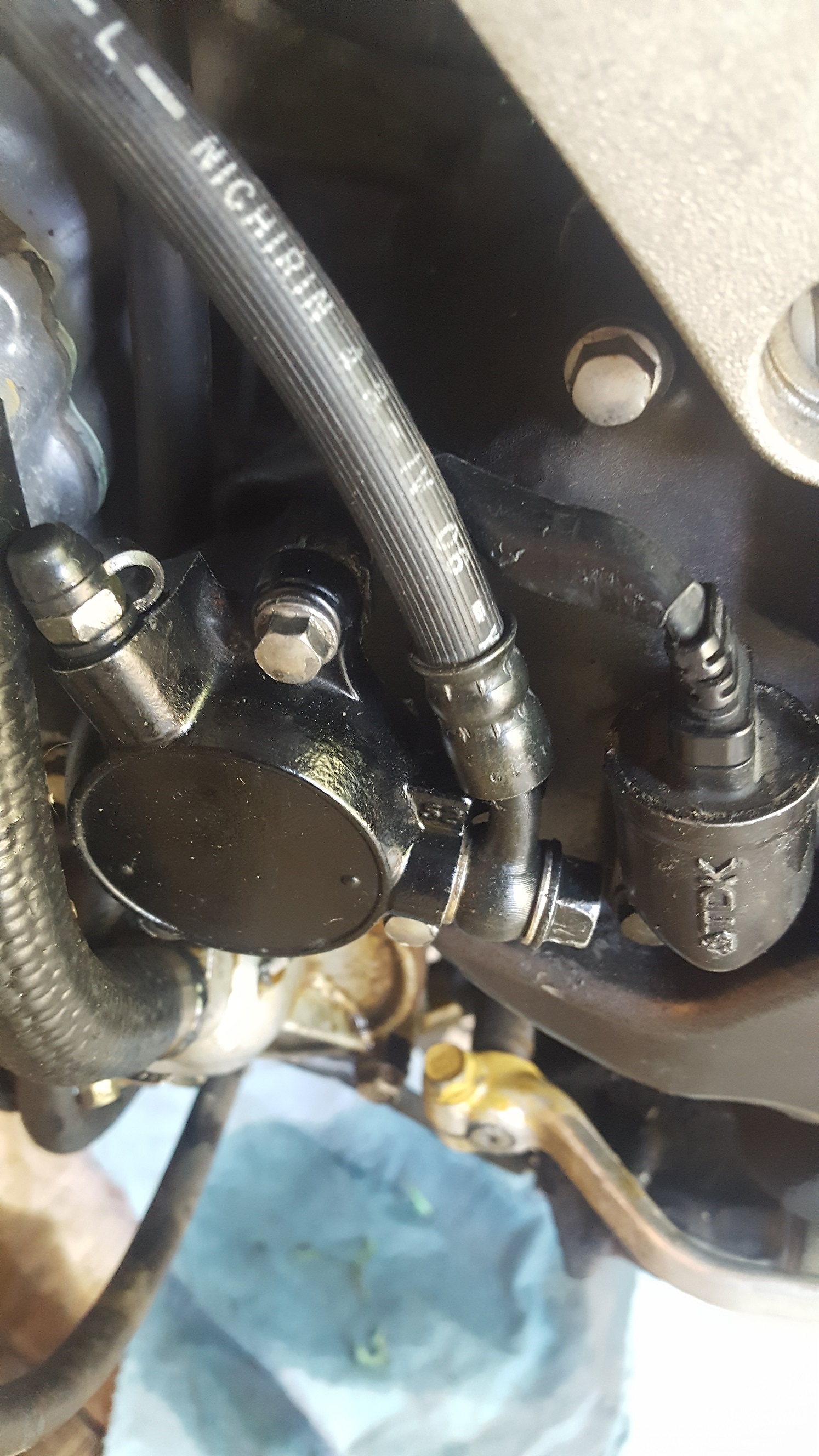

darkshad Posted September 25, 2020 Author Posted September 25, 2020 An update: I was able to get the new clutch plates put in. The one problem I have now is that if I put the slave cylinder back on, the plate where the springs are sticks out about 1/4 of an inch. If I tighten down the bolts and get the plate flush to where it should be, then the rod sticks out too much for the slave cylinder to be flush. It's almost as if the rod is a hair bit too big, but it's the same rod. See pictures - this with the slave cylinder bolted in, as you can see there is a gap between the clutch plates and the plate where the springs are. Appreciate any thoughts. Thanks. Quote
Member Contributer Cogswell Posted September 25, 2020 Member Contributer Posted September 25, 2020 With situations like that, it's usually best to double check the work, both on the slave and clutch. It's a lot of work to take it all back apart, but it's the only way to be sure it's assembled correctly. Quote
Member Contributer Grum Posted September 25, 2020 Member Contributer Posted September 25, 2020 Are you sure the push rod is not bent in any way? You need to make sure the pushrod is properly seated into both the slave piston and clutch lifter piece. Are you sure the slave piston is not jammed in the extended state? Quote

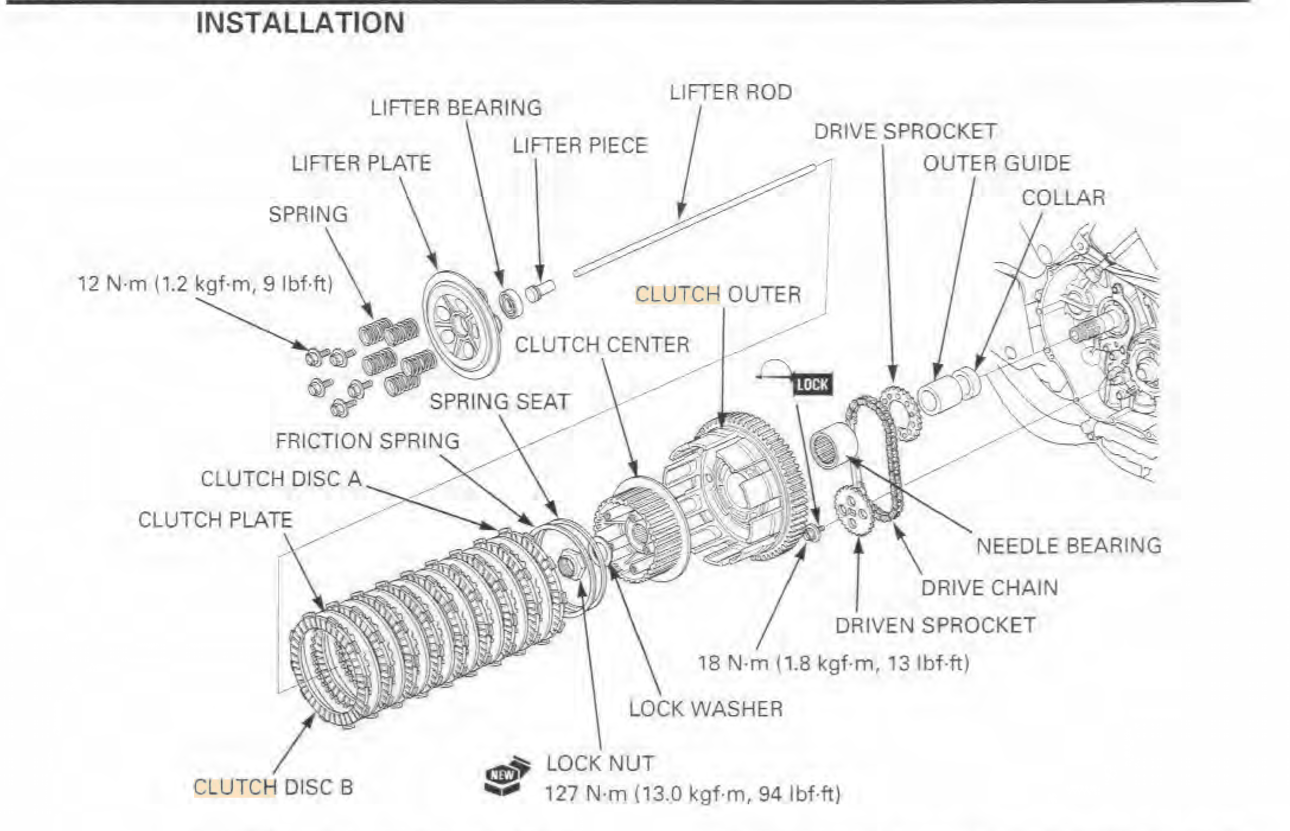

Member Contributer Marooncobra Posted September 25, 2020 Member Contributer Posted September 25, 2020 I would suggest there is something wrong in your clutch pack rebuild as even when built correctly I have never seen that much space between the end plate and friction plate even with a squeezed in clutch lever. Strip the clutch pack again and check your work. Are there any missing plates both friction and solid metal? Are the slots aligned correctly on the spring seats and where the bolt screws in? Is the central release bearing mounted in the end plate seated correctly? Good luck and let us know how you get on. 1 Quote
Chris800 Posted September 25, 2020 Posted September 25, 2020 What did the old plates look like? Did you measure them or take pictures, compare them to the old ones? The springs as well? If your springs were bad changing the clutch pack will not solve the problem as the new clutch plates will wear out quick due to low pressure and high friction. Just throwing new parts at it untill the problem gets solved is an expensive way of fixing it... Did you check the manual, it's pretty detailed for the clutch and it's a pretty easy pease job. Did you also check the lifter rod, it should have mooved freely with the master out. It's basically a stick that pushes the clutch pack from one side of the bike to the other with hydraulic pressure. This video might help you understand how it works: 1 Quote
darkshad Posted September 28, 2020 Author Posted September 28, 2020 On 9/24/2020 at 10:11 PM, Grum said: Are you sure the push rod is not bent in any way? You need to make sure the pushrod is properly seated into both the slave piston and clutch lifter piece. Are you sure the slave piston is not jammed in the extended state? The push rod doesn't look bent and the slave piston isn't jammed in the extended state. See youtube video at the end of this message. On 9/25/2020 at 1:08 AM, Marooncobra said: I would suggest there is something wrong in your clutch pack rebuild as even when built correctly I have never seen that much space between the end plate and friction plate even with a squeezed in clutch lever. Strip the clutch pack again and check your work. Are there any missing plates both friction and solid metal? Are the slots aligned correctly on the spring seats and where the bolt screws in? Is the central release bearing mounted in the end plate seated correctly? Yah. I removed the clutch pack rebuild and still have the same issue. It's not the clutch pack piece. The central bearing is mounted on the end plate and seated correctly. See youtube video. I checked the lifter piece, and the hole is clean. The rod properly seats in it. It's probably something simple, but I'm at a loss as to what it could be. There are only a handful of parts that actually connect directly to the lifter rod. Other thoughts/ideas to look at? Thanks. Quote

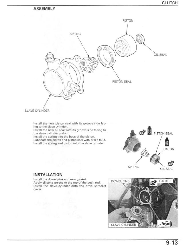

Member Contributer Grum Posted September 28, 2020 Member Contributer Posted September 28, 2020 Your Slave Cylinder assembly doesn't look correct! Are you showing the Slave with the spring removed for demonstration? The spring should be internal! Is the piston in the correct orientation? Can only suggest you check your disc pack for the correct number of steel discs and friction discs, along with the spring seat and friction spring. Whenever I've replaced a drive chain I've noticed a certain amount of pre-load tension with the Clutch Slave as I remount the sprocket cover and slave assembly. 1 Quote
Member Contributer Marooncobra Posted September 29, 2020 Member Contributer Posted September 29, 2020 I agree with Grum, your slave cylinder has been put together back to front. You need to disassemble and put the spring in first followed by the piston. Make sure you put the piston into the slave assembly seal first as well. From looking at your video the piston currently is round the wrong way hence having a large gap at the clutch plates. The spring will always try and push the piston out especially as you have removed the hydraulic supply from the clutch master cylinder. I would rebuild the slave cylinder correctly, refit on the bike and then rebuild your clutch pack ensuring the push rod is fitted. Quote
darkshad Posted September 29, 2020 Author Posted September 29, 2020 Ah hah. I knew it was something simple. I'll get the slave cylinder rebuilt correctly, and then everything should fit. Thanks! Quote
