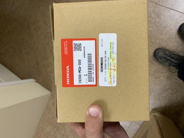

trmoyer Posted August 14, 2020 Author Posted August 14, 2020 Pump Is in hand!!!!! Time to get home and put her back together. Quote
