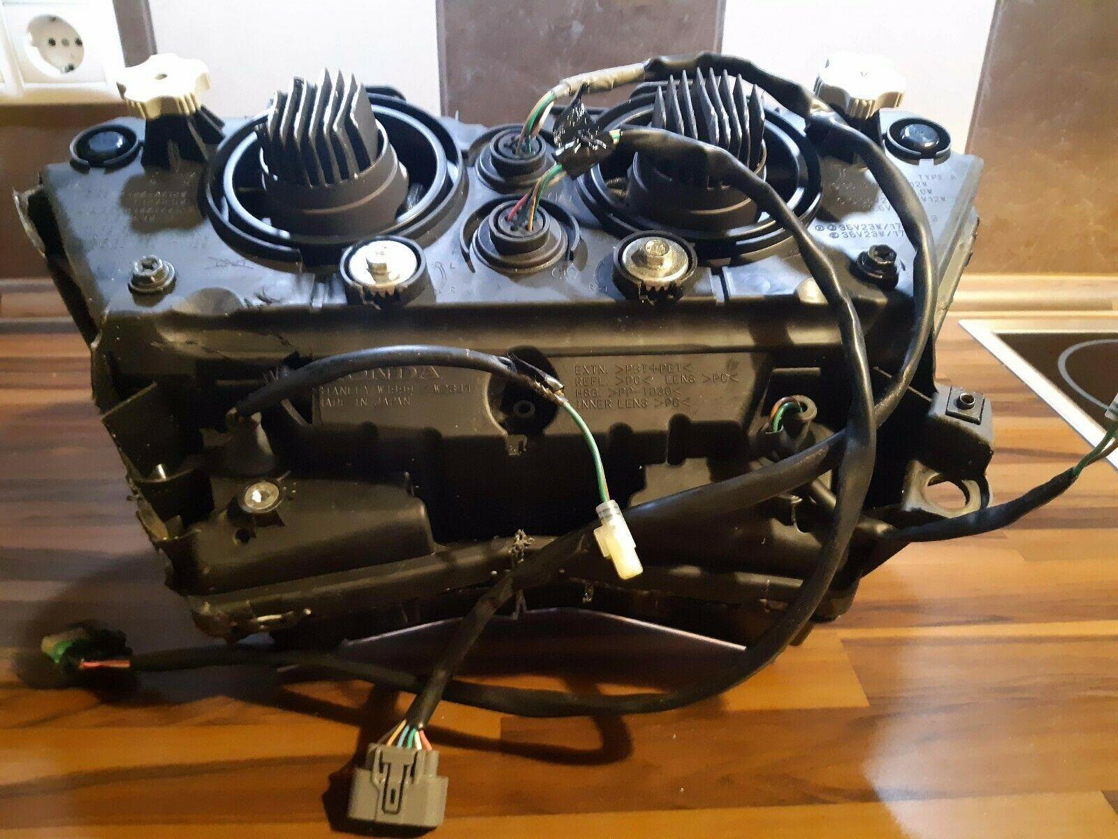

Member Contributer Grum Posted July 14, 2020 Member Contributer Posted July 14, 2020 51 minutes ago, fatshoutybloke said: Well it certainly feels like glass to me! I too have spent £20 on protectors, on the sites I've seen in UK they're over £1200 for the unit and it would only take one stone... The stuff they are made of has probably greater impact resistance than glass. Lot of automotive headlight assemblies are no longer made of glass. If you give the front section a tap it definetly has that plastic sound to it unlike a bit of a ring you get with glass. Also makes for good weight saving being plastic. Here's the back of an 8gen headlight assembly (From a crashed bike). If you zoom in you'll see it specifies the various plastics used for the assembly, External = PBT+PET Reflector = PC Lens = PC and Housing = PP-1030. Cheers. Quote

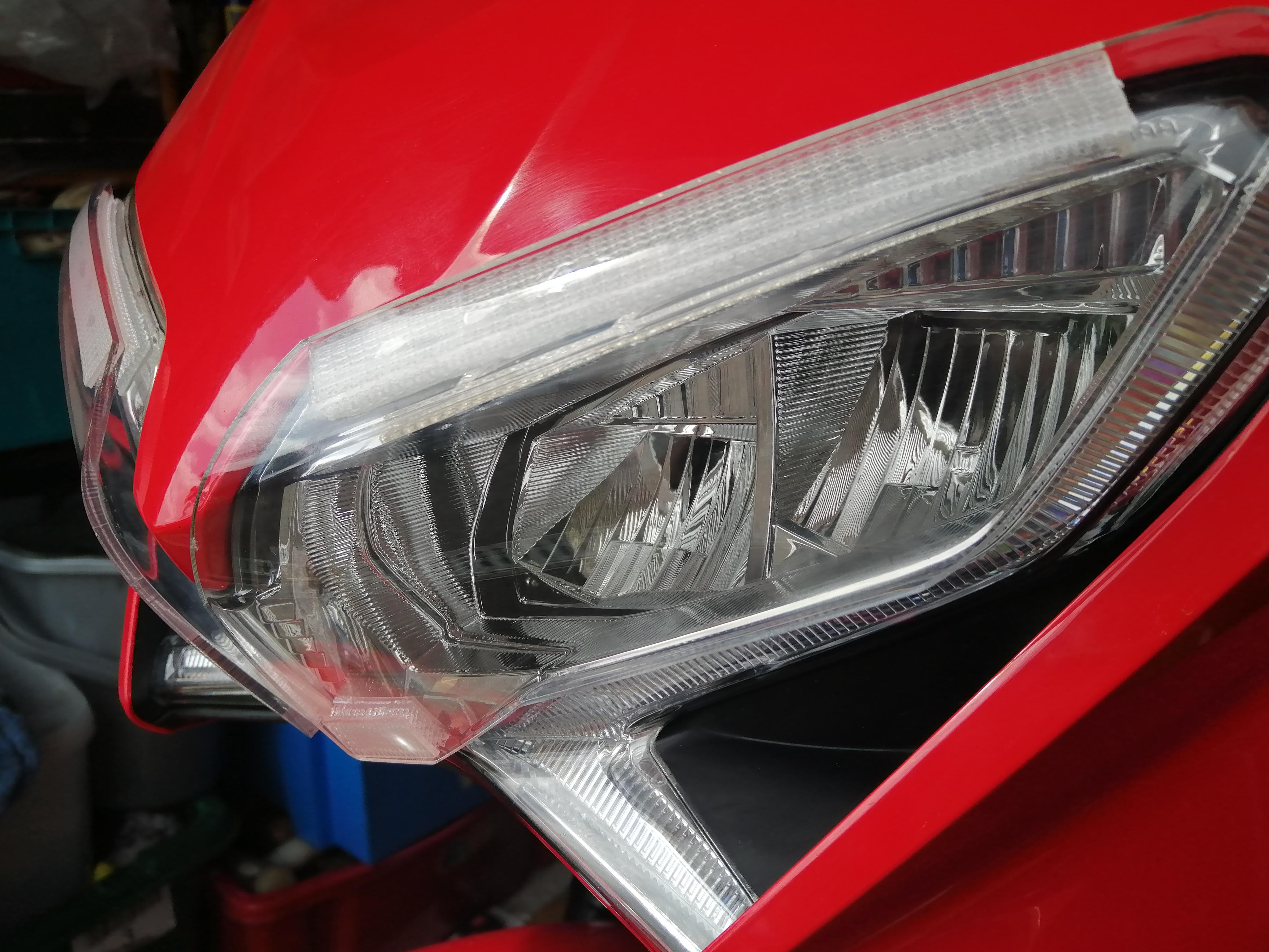

Member Contributer fink Posted July 18, 2020 Member Contributer Posted July 18, 2020 https://www.invisiblepatterns.co.uk/bikes/honda-vfr-800-f-2015 Have the full kit and panniers on mine. Not the best pic, you can’t even see it when in place. Quote

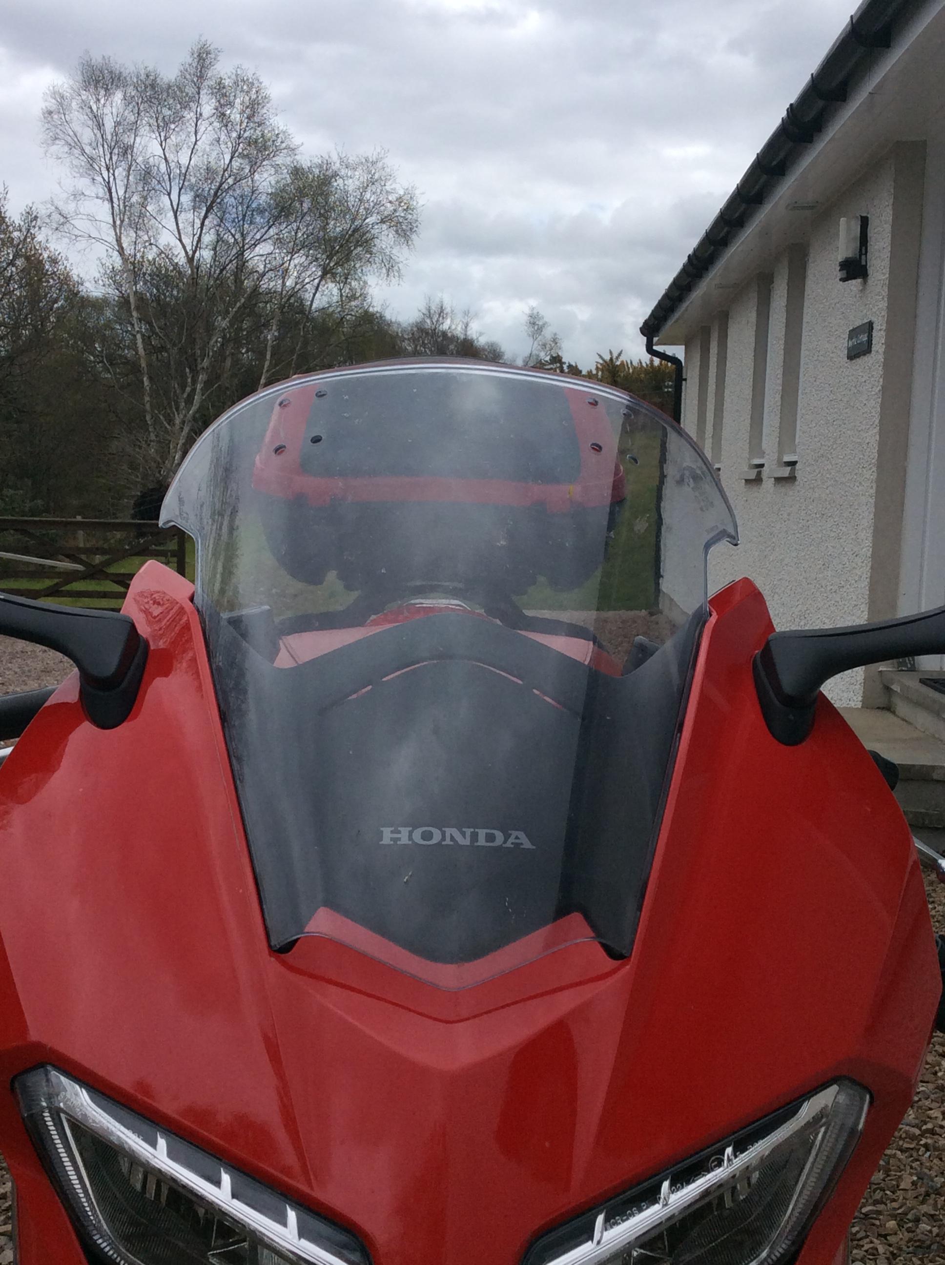

BeePee Posted August 6, 2020 Posted August 6, 2020 On 7/14/2020 at 2:17 PM, fatshoutybloke said: Well it certainly feels like glass to me! I too have spent £20 on protectors, on the sites I've seen in UK they're over £1200 for the unit and it would only take one stone... O.M.G you've ruined that bike ! That looks horrendous, sorry. How do these designers get away with thinking that will look ok ? Quote

Member Contributer MaxSwell Posted August 6, 2020 Member Contributer Posted August 6, 2020 I'd suggest the cover destroys the aerodynamics of the front end. Probably decreases the machines fuel mileage and add wind noise. My highest mileage fifth gen, at 105,000+ miles on her when KIA'd by a deer, had no visible damage until the deer turned it into bits and pieces. A big waste of money IMHO. 1 Quote

Member Contributer fink Posted August 6, 2020 Member Contributer Posted August 6, 2020 7 hours ago, Thumbs said: It looks like a film that goes over the headlight, is that correct? The protectors I’ve got are solid curve acrylic about 3mm thick Yes it’s a film, the same form that protects the bodywork. 1 Quote
superfunkomatic Posted August 6, 2020 Posted August 6, 2020 I'd go with 3M Scotchguard or XPEL film to cover the lenses. The XPEL is easier to apply and tends to yellow less. It does a remarkable job of protection as well. Unless you're constantly on gravel roads with your VFR it's unlikely you'll ever break the polycarbonate lenses on the bike. We have lots of spring gravel left over from the winter and I can't think of anyone I know that has had a broken lens. You could film over the whole bike (I've done that on my Africa Twin). https://thetankslapper.biz/film/ https://thetankslapper.biz/vfr800f-total-protection-kit/ Quote
