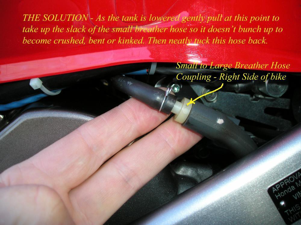

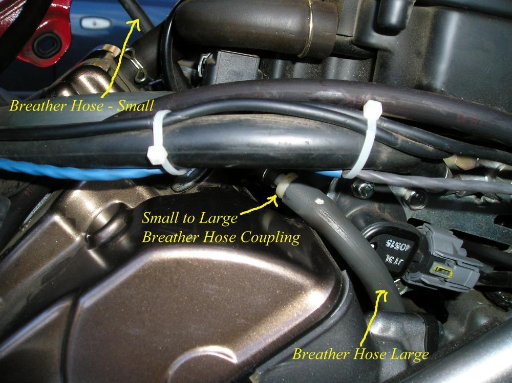

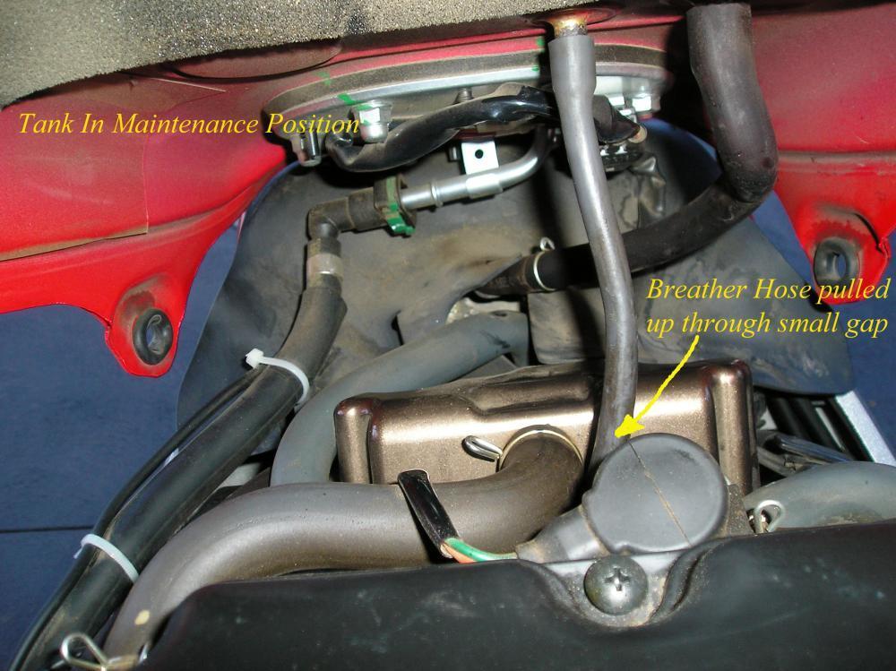

Member Contributer Grum Posted July 1, 2020 Member Contributer Posted July 1, 2020 Hi lazyeye. Sorry to here of your bike woes especially since it's a 2014 8gen. Nothing goes wrong with these bikes!! Your symptoms sound like it may be a blocking/dirty fuel filter. Also adding to that might be a kinked breather hose which is so easy to do after raising and lowering the fuel tank. After a bit of riding and you open your filler cap, are you sensing any strong vacuum holding the cap down? Assume you're not seeing the Fi Light coming ON or any flashing code? On the last service you had done do you suspect that tank may have been raised, possibly to replace the air filter or any other reason? As per the photos attached. Have a very good look at where the Breather Hose small to large adaptor is located. If it's hidden further inwards that could mean a kinked hose. It needs to be very visible on the R/H side. Good Luck hope this helps, keep us posted. 1 Quote

Member Contributer Grum Posted July 1, 2020 Member Contributer Posted July 1, 2020 8 hours ago, lazyeye said: The last maintenance was spark plugs, valve adjustment, air filter replacement... pretty much everything. The tank had to come off to do that work. I'll have a look and see if the breather hose is kinked. I don't detect any vacuum in the tank (its easy to open up just like usual) and there's no codes or warning lights showing up. I've heard that the charcoal filter can eventually get clogged up and cause running problems, is that real or is it an old biker story? Did this issue happen before Or after the last Service? Does your bike have the Evap canister? Can't imagine how this system could cause your issues anyway. If the canister became blocked it could possibly effect the breathing of your tank. Feel may you need to isolate the Fuel Filter, your issues are very much symptomatic of a dirty filter or fuel pressure issues. Maybe other members might have some ideas. Quote

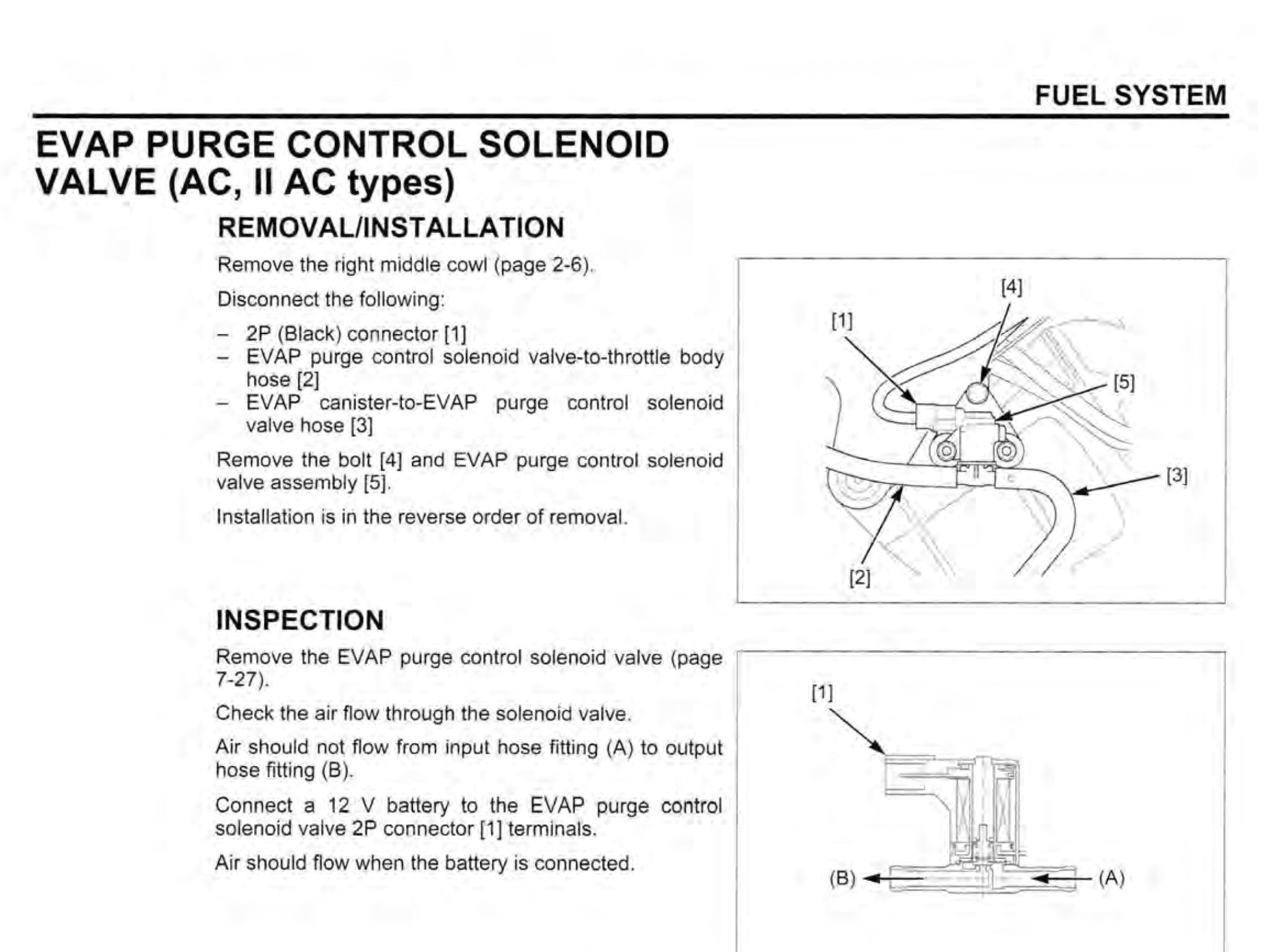

Member Contributer lazyeye Posted July 1, 2020 Author Member Contributer Posted July 1, 2020 The issue happened before I took it in for service and was independent of the last time I raised the tank. It was fine for about 3000 miles after the service, that's what really confuses me. My bike has the evap cannister, I've been too lazy to figure out how to properly eliminate it. Quote
Member Contributer Grum Posted July 1, 2020 Member Contributer Posted July 1, 2020 1 hour ago, lazyeye said: The issue happened before I took it in for service and was independent of the last time I raised the tank. It was fine for about 3000 miles after the service, that's what really confuses me. My bike has the evap cannister, I've been too lazy to figure out how to properly eliminate it. You can simply unplug the electrical connector to the Evap Control Valve Solenoid and give your bike a good run, see how it goes. Still thinking your Fuel Filter, may be an issue. You may have to try a fuel pressure and flow test as per the Service Manual. Perhaps this is something you could have done where you have your bike serviced, they should also have good ideas of what to check based on your symptoms. Is there anything strange going on with your Power Commander? How hard is it to disconnect, and have your bike running in a stock standard situation for trial? Quote
Member Contributer Grum Posted July 10, 2020 Member Contributer Posted July 10, 2020 On 7/1/2020 at 1:41 PM, lazyeye said: The issue happened before I took it in for service and was independent of the last time I raised the tank. It was fine for about 3000 miles after the service, that's what really confuses me. My bike has the evap cannister, I've been too lazy to figure out how to properly eliminate it. Any update on your bike? I'm still thinking it's a Fuel filter or pump issue. Maybe with all the country tripping you've done you may have picked up some dirty fuel along the way. Keep us posted. Cheers. Quote
