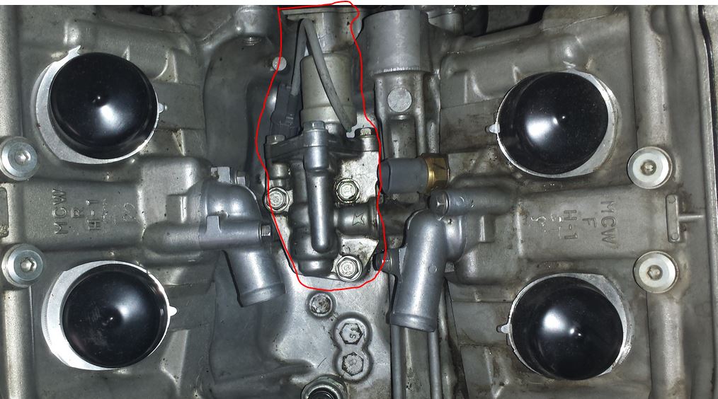

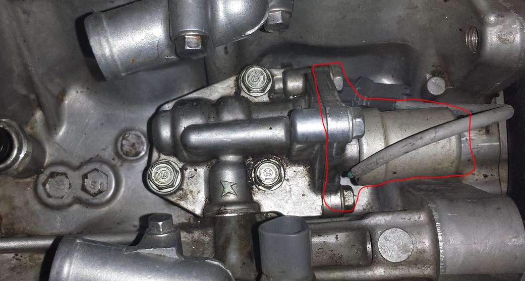

Since VTEC is oft-discussed and seemingly gets a bad rap, maybe it would be interesting to see where VTEC lives and see some of the components.  Most owners never see it or know where it is.  The top two photos, below show where it lays at the base of the "V" underneath the throttle body (circled in red and in the second photo only the electrical portion of it).  VTEC is an actually simple system (much simpler than variable valve timing on newer engines).  It is a solenoid controlled oil valve, that when actuated, allows pressurized oil to flow through a spider web of passages in the upper portion of the block in to the 4 pairs of VTEC valve buckets. The solenoid / valve in the photos is a plunger style - the solenoid moving a spring loaded small rod back and forth to open the passageway from pressurized oil in to the valve buckets.  There isn't much to go wrong with it.  I don't ever recall an owner reporting a VTEC solenoid / valve failing .  "The combination is referred to as "the spool valve".

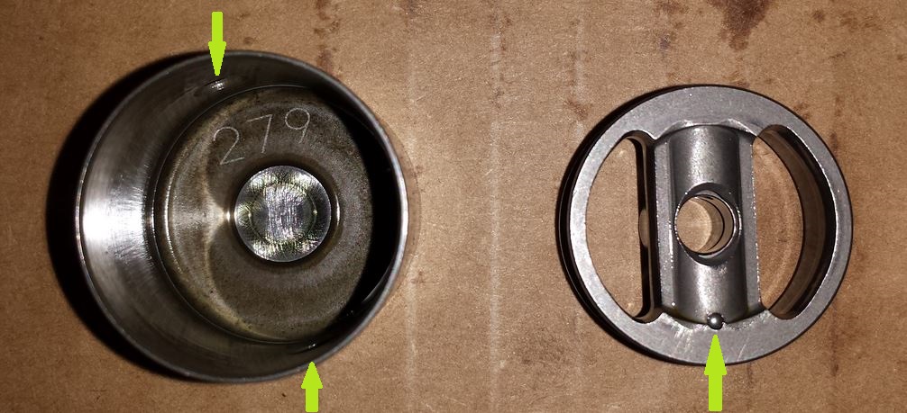

While conventional valve buckets have a shim that sits between the bucket and the valve stem, inside each of the 8 VTEC valve buckets is a hydraulic latch (last photo, right).  The latch has a spring loaded slide that when force closed, closes off the central opening.   When pressure is absent the valve stem can transit through the hole in the  latch and even though the bucket is rising and falling with the cam's rotation, the valve is not actuated and remains closed.  Hence VTEC valves have two springs - an inner spring to close the valve just like the non-VTEC ones, and a lighter, outer spring that keeps the VTEC bucket in contact with the cam at all time regardless of valve movement.  That action is what raises the latch off the valve stem on each cycle and allows the latch slide to move (direction arrow in the photo) to "close the hole over" and allow the latch to contact the valve stem.   When oil pressure hits the latch, it closes almost instantly after the cam lobe leaves the bucket thus contacting the top of the valve stem on the next cycle, operating the valve.  Hence the abrupt "hit" the rider feels as airflow through the engine nearly doubles (? maybe it's not that much - but is significant) almost instantly.  At VTEC engagement RPM, the valves are opening and closing around 50+ times per second.  In the photo, I placed arrows at the 2 holes in the bucket that allow pressurized oil in to close the latch (you have to look closely).
Note that inside the bucket is scribed "279".  That is the thickness of its shim.  The shim is not separate from the bucket - it's part of it.   That, is one of the Achilles heel of VTEC - if VTEC valves are out of spec you don't replace a shim, you replace the entire bucket.  They run in the range of $40 each +/-  and there are 8.  You get the idea . . .
So mechanically VTEC is pretty simple.  Complexity comes in both service and control of the nearly instant change in airflow.  If 6th gens did not have VTEC but still chain driven cams, I doubt there would have ever been much if any talk about the complexity of 6th gen motors.   What makes VTEC adjustments a PITA besides dealing with chains vs just setting gears back in place are the latches.  You can't check valve adjustment on one that has an open latch and does not contact the valve.  To do that the latch must be closed - and that's what the 1st "take the cams out and put them back" sequence is about.  Each VTEC bucket must be removed and a small pin placed in the slide of each latch to hold it closed (that's what's going on in the photo) - once the pin is in, the latch is replaced in the bucket and then back on the valve, latched closed).  Repeat X7 and then reassemble chains / cams to check clearance.  From there it's the same as any other shim / bucket check.  Remove the cams a 2nd time to replace needed shims/buckets. Reinstall with latches in place to check final clearance.    Finally, the latching pins must be removed so they'll operate normally so out the cams come once again to remove them and then final assembly.  So in and out with the cams at least 3 times.  Anyone that complains about the cost of a VTEC valve adjustment should give this a go and see if they would like to make a living at it.  I for one, would not . . .
