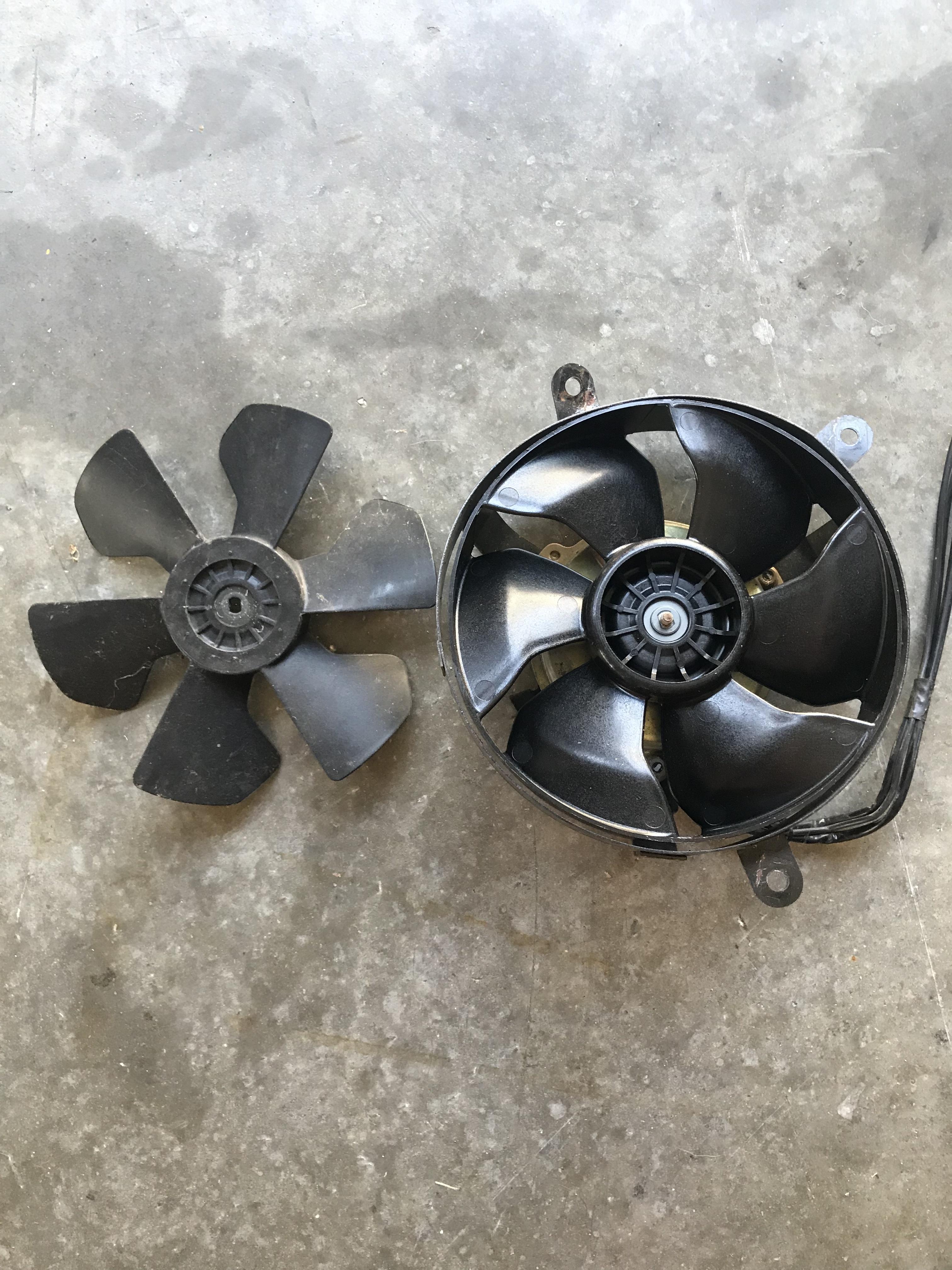

Member Contributer ducnut Posted December 22, 2019 Member Contributer Posted December 22, 2019 You need the pictured fan blade. It’s a direct-fit, outward blowing blade of a more efficient design. You won’t find inward sucking fans on a Honda, post class-action lawsuit threat from early GL1800 owners. As a result, a recall was issued by Honda and those early bikes were swapped to an outward blowing design, as was the subsequent production bikes, which fixed the constant overheating, in mixed traffic, of the GL1800. In addition to the blade change, I added a 4” fan to the inside of my right radiator, which is wired to constantly run and blows outward. The bike definitely runs much longer, before the main fan kicks on. Quote

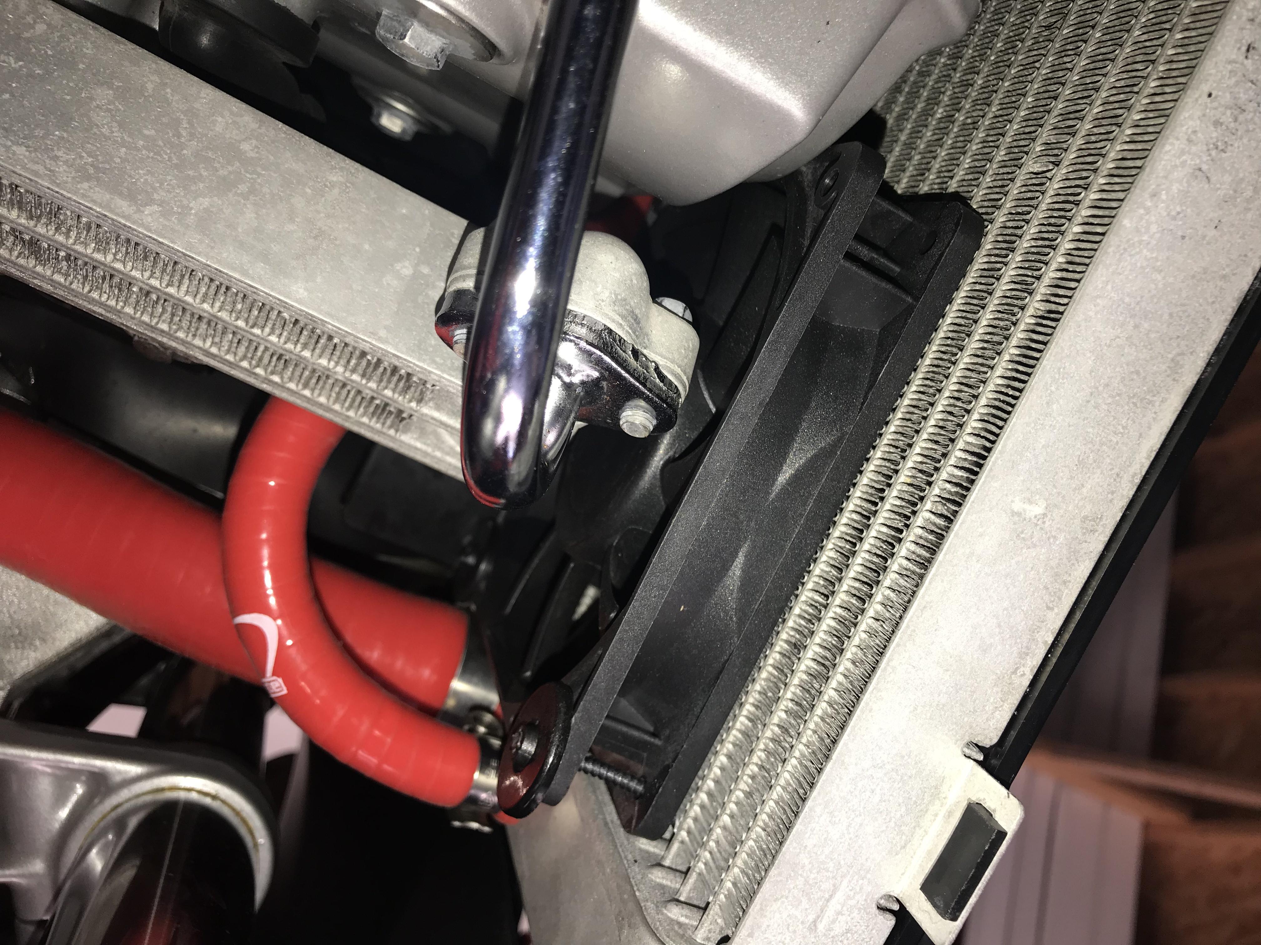

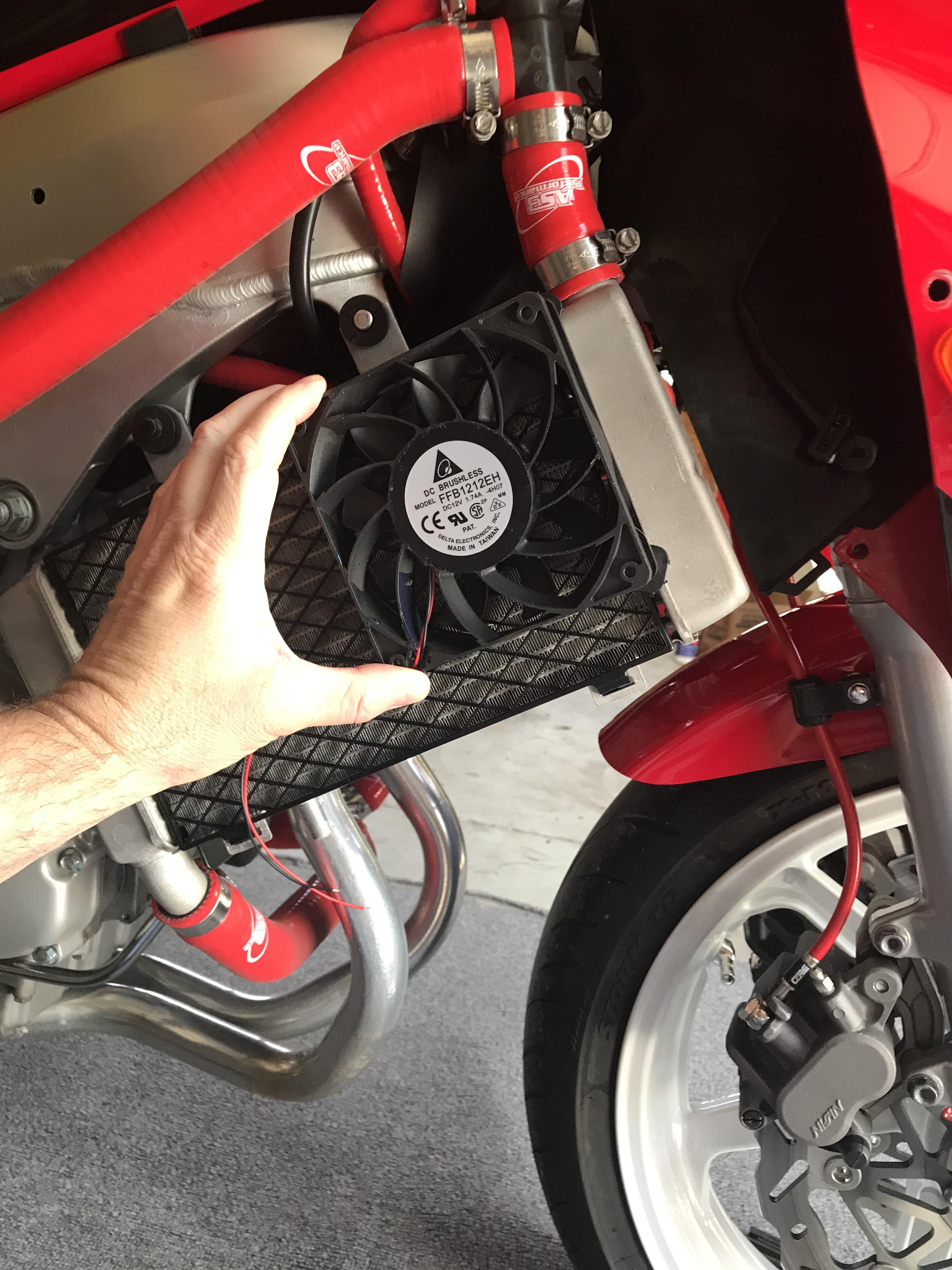

Member Contributer ducnut Posted December 24, 2019 Member Contributer Posted December 24, 2019 2 hours ago, windunderhawk said: Awesome, Thank you. Do yo happen to have a P/N and source for the 12v 4 inch fan you indicate? It’s just a high CFM, 12V, 100mm fan off eBay. I can’t remember the thickness, maybe 20mm or 25mm. For sure it’s all that’ll fit up in there. And, the seller no longer has them available, as I had previously checked for someone else. Pic of it below. I just used automotive, electric fan zipties to mount it. 1 hour ago, windunderhawk said: Also,what improvements did you notice in low speed cooling performance? As I said, the bike runs a lot longer, before the main fan comes on. 9 minutes ago, boOZZIE said: Dude, get off the eggnog, p/n above 1st picture😊 Dude! He was asking about the auxiliary fan I added. Eggnog much? 😁 1 Quote

Member Contributer ducnut Posted December 24, 2019 Member Contributer Posted December 24, 2019 30 minutes ago, windunderhawk said: Wow, no eggnog yet, ordering fan,gonna do flush and use engine ice. Thanks sooo much, Merry Christmas. I soaked the radiators in a de-scaling solution, installed new AS3 silicone hose and clamp kits, changed all the O-rings, new thermostat, new radiator cap, and filled with Engine Ice. I can’t say what improvements this all made, because I completely disassembled the bike right after buying it. But, it has never gotten hot in two summers in central IL, USA. Quote

Member Contributer ducnut Posted January 14, 2020 Member Contributer Posted January 14, 2020 Fan should kick on ~210°F, with the stock switch. I tried the commonly available ~185°F switch, but, my fan continuously stayed on, even on the highway. The coolant coming out of the engine is hotter than the fan switch parameters, so it should do that. I don’t believe my coolant temp ever got above ~185°F, unless I stopped in traffic. I ended up putting the stock switch back in and just supplementing the stock fan with the small, auxiliary fan. My thinking is, the small fan can get a head start on cooling what comes out of the engine, instead of the entire capacity of the radiators getting hot, then, the main fan having to pull the entire capacity back down. The bike definitely goes much longer before the main fan kicks on, which is what I was trying to achieve. Also, the auxiliary fan is disposable. If it can help conserve the NLA main fan, all the better. I DO have a spare fan, just in case this one ever fails. Quote
