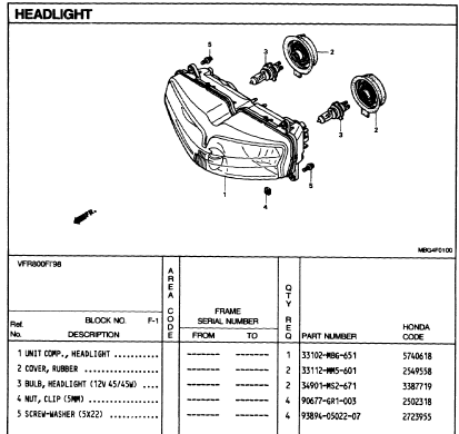

Member Contributer Fritzer Posted October 16, 2019 Member Contributer Posted October 16, 2019 Tip for Front Cowling/Gauge cover removal without having to remove side cowlings I recently had to replace the headlights in my 5th gen. After looking through the manual on the subject and visual inspection, it looked like the side cowlings needed to come off to access the headlight lamps in the front cowling. A hassle for such a minor issue. After looking at it for awhile, I came up with the following procedure that allowed me to get to the headlamps without side cowling removal. No doubt many others have come up with this before but others may benefit with this tidbit. Any other helpful tips out there? Gauge panel removal instructions.pdf Quote

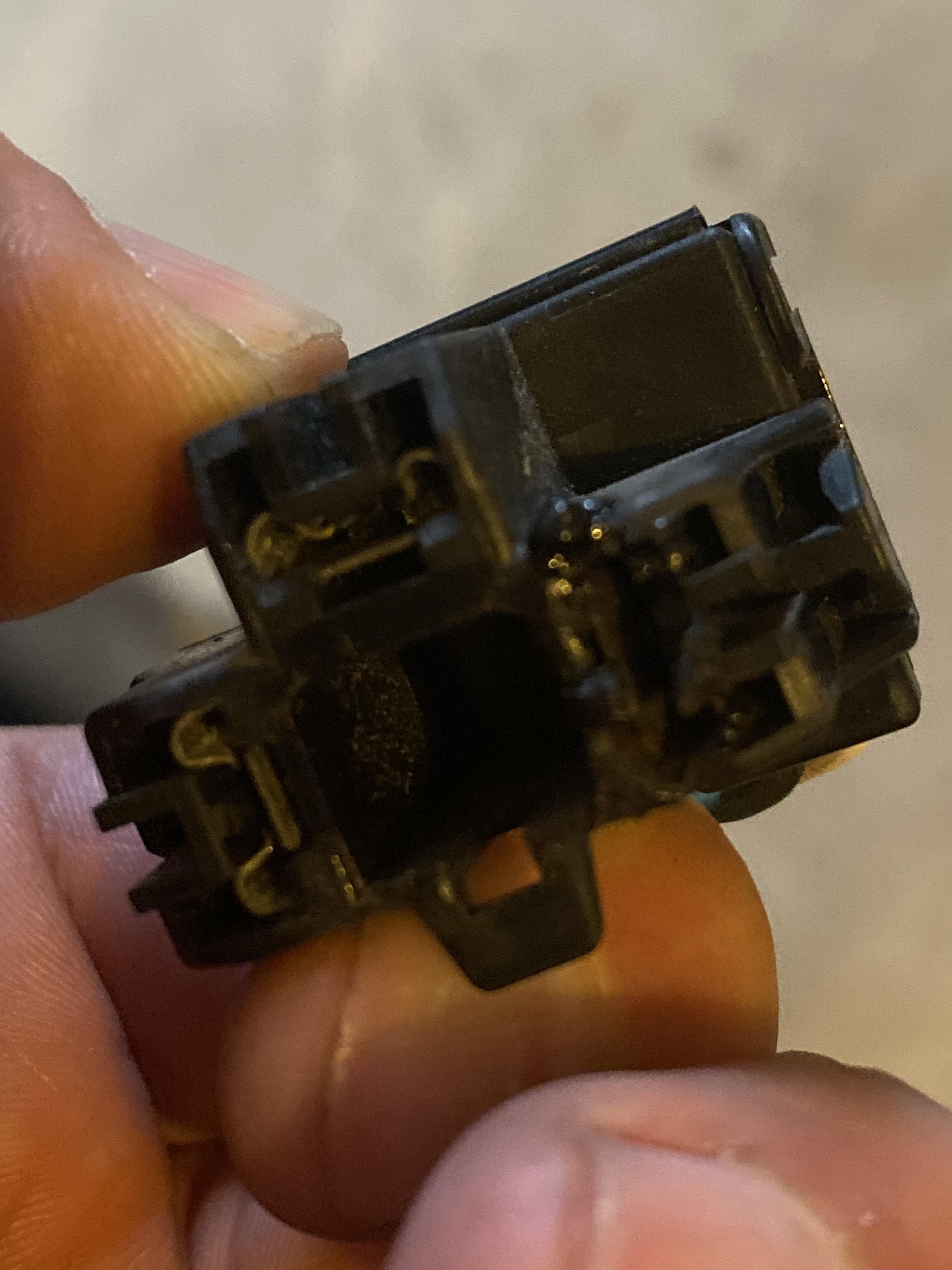

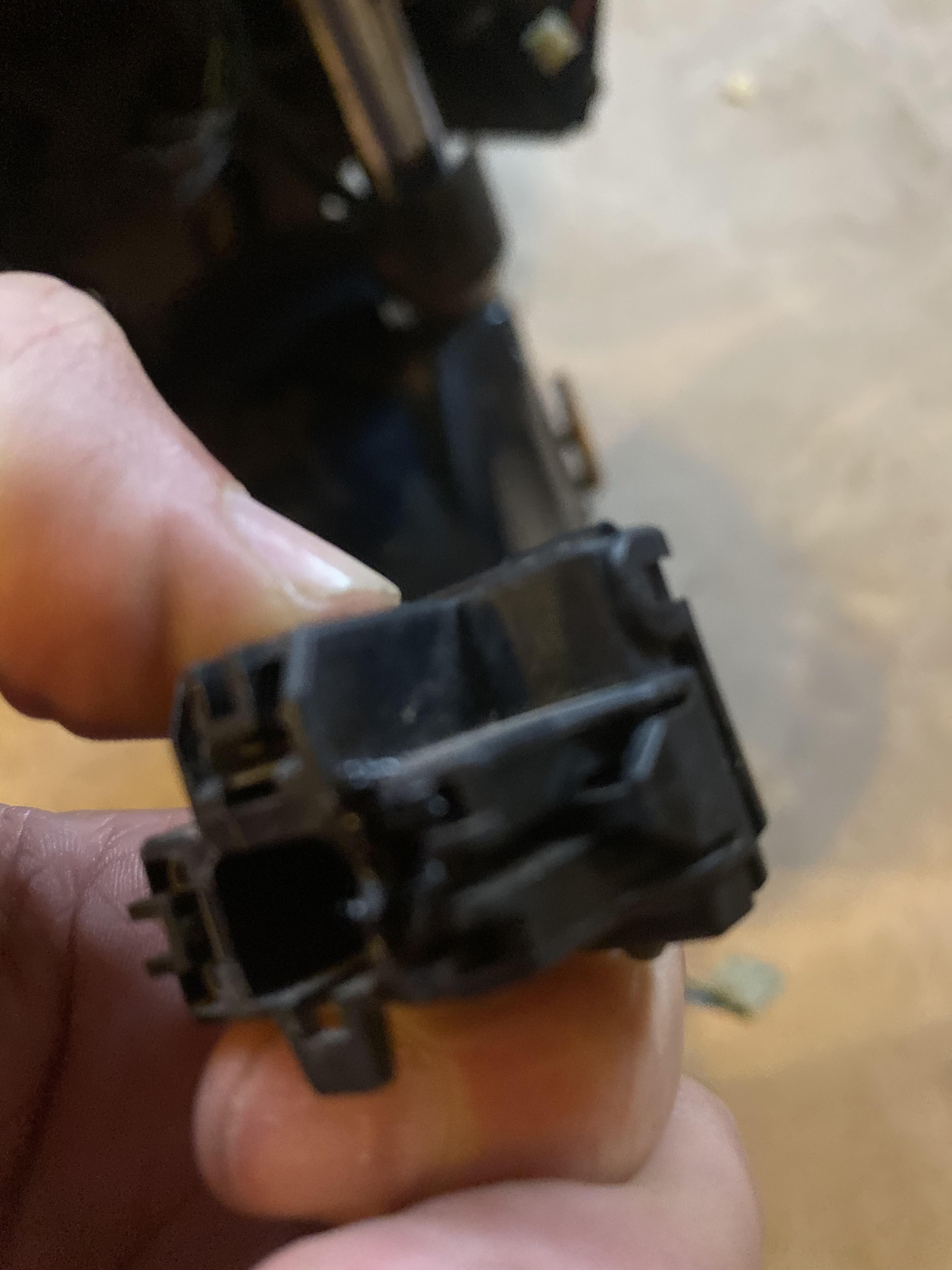

Suskwa29 Posted October 17, 2019 Posted October 17, 2019 Man I wish I read this two days ago. I tried to get in without removing everything - the one side would not come out. So, as is my usual last resort, i read the manual and deconstructed the front end. Turns out there was a reason I couldn't get the bulb out, and the bulb was fine....but. The Socket has gotten a bit melty. I looked online for a part number for this and my noob bike skills are combining with my lack of googlefoo. - Can any one help me figure out what I need to replace this? It looks like a socket for just about any automotive H2 bulb should work- should it not? Also - any idea what would cause this? I had the bike for about an hour and found the right headlight was dim in my safety inspection. So I really don't know the history. I do note that the manual calls for a 45/45 bulb and it had 60/55s - which I wouldn't think would cause the issue - would it? I cleaned the connections, threw two new bulbs in (although the old ones worked fine after the cleaning), and it is working fine - but I do want to make sure I don't have future issues. Thanks for any assistance you can provide. Quote
Member Contributer airwalk Posted October 17, 2019 Member Contributer Posted October 17, 2019 60-55 bulbs get too hot for the plastic sockets(parts no longer available new from Honda), but if the bulb prongs fit right any socket will work, as you say. Other sockets could even be made of plastic that’ll stand the heat better, who knows for sure. You can get away with 60-55 bulbs but are likely to eventually have issues, as Honda planned/designed housings & reflectors around the 45-45 bulbs Quote

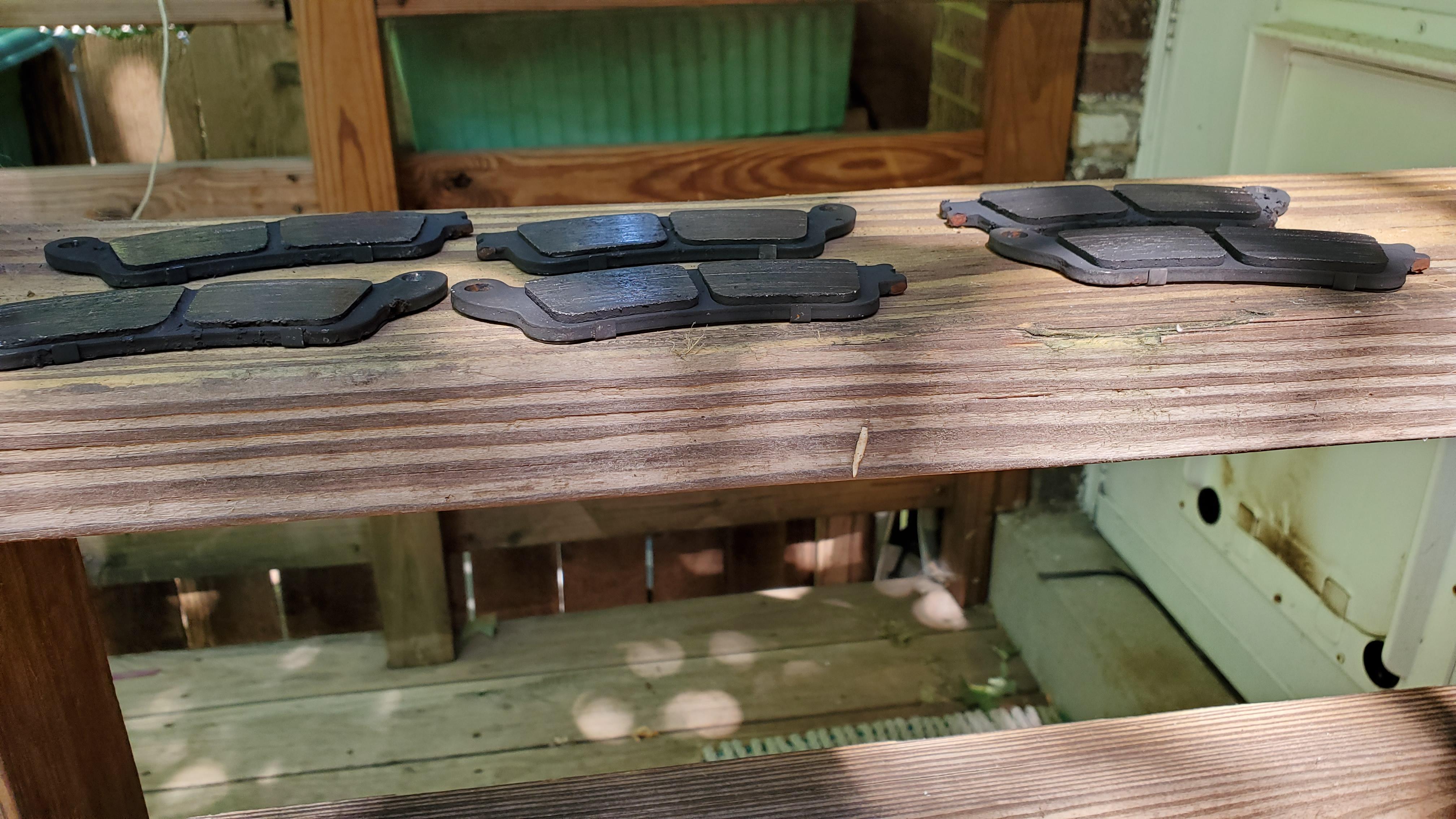

Member Contributer interceptor69 Posted June 15, 2020 Member Contributer Posted June 15, 2020 I finally took the plunge last week and replaced all the brake pads on my '98. It wasn't as difficult as I expected but it was tedious work and very dirty/greasy. I have a question: I used a large wrench to leverage the pistons back in and it worked well until I tried to push the center piston on the rear caliper-that one did not want to go in. I remember reading a recent thread of a fellow who was doing some work on his rear brake system and found a tiny opening in that (?) proportioning valve (not sure if that's what it's called) that tends to clog over time. I wonder if mine was clogged as well. I have noticed for years my rear wheel doesn't spin freely when out of gear and on the centerstand. I also have noticed my rear brake had almost no effect on braking unless the front was squeezed as well. Ii finally got the piston in and cleaned around them with brake cleaner. I've gone for 2 long rides since new pads and it's amazing how much stopping power I now get just when pressing the rear brake lever. I don't think that's just from the new pads so I wonder if that stuck piston was having a negative effect on braking. Thoughts? Quote
GreginDenver Posted June 15, 2020 Posted June 15, 2020 1 hour ago, interceptor69 said: I finally took the plunge last week and replaced all the brake pads on my '98. It wasn't as difficult as I expected but it was tedious work and very dirty/greasy. I have a question: I used a large wrench to leverage the pistons back in and it worked well until I tried to push the center piston on the rear caliper-that one did not want to go in. I remember reading a recent thread of a fellow who was doing some work on his rear brake system and found a tiny opening in that (?) proportioning valve (not sure if that's what it's called) that tends to clog over time. I wonder if mine was clogged as well. I have noticed for years my rear wheel doesn't spin freely when out of gear and on the centerstand. I also have noticed my rear brake had almost no effect on braking unless the front was squeezed as well. Ii finally got the piston in and cleaned around them with brake cleaner. I've gone for 2 long rides since new pads and it's amazing how much stopping power I now get just when pressing the rear brake lever. I don't think that's just from the new pads so I wonder if that stuck piston was having a negative effect on braking. Thoughts? there are two reasons for the resistance you felt in the center piston of the rear brake caliper. one of the two reasons is that your '98 is now 22 years old and I'm betting nobody has ever refurbished the braking system (22 year-old caliper piston seals, 22 year-old caliper piston wiper rings, 22 year-old brake line hoses, 22 year-old master cylinder seals, and, most probably, some really old brake fluid). let's be honest, some parts of a motorcycle are "consumables", like brake pads. but so is the brake fluid and the seals inside the brake master cylinders, the seal inside the secondary master cylinder, and all of those VFR800 rubber brake lines too. if you want to feel the Honda-goodness that Honda had in mind for the brake performance of your 22 year-old VFR800 it's gonna need a full refurbishment at some point. the other reason that the center piston on the rear brake caliper would put up a fight is that on this particular caliper piston there's a lot of mechanical resistance between you (trying to push it in by hand) and the Rear Brake Reservoir (which is where you're trying to make the fluid go with all of your pushing). there's resistance at the PCV, resistance at the SMC, and there's resistance at the Rear Brake Master Cylinder. remember that the brake fluid is incompressible, so it's looking for a space with air (that is compressible) to occupy. the best way to push in caliper pistons is to open the corresponding bleeder fitting on the caliper then push in the piston. if you have somebody handy to help you (one person presses the piston in while the other person carefully/gradually cracks open the bleeder fitting just a tiny bit) it's easy to control the situation and avoid admitting air into the system. yeah, it's a bit messy and if you're not careful you could admit air into the caliper, but it's really the easiest way to do it. and you should probably bleed the brake system every-so-often anyway, right? 1 Quote
