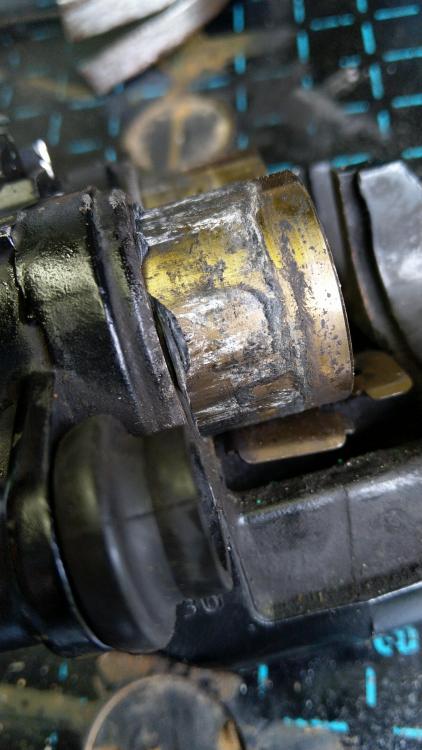

Member Contributer Thumbs Posted September 24, 2019 Member Contributer Posted September 24, 2019 14 hours ago, Skids said: Thanks m8. I have them ready to go, just need to find the time this winter to overhaul the calipers and fit them. Check the pistons for flaking, they’re the Achilles heel of the brakes, the rears should be Ok but the Tokico front are famously prone to rust/pitting Powerhouse do some very good quality stainless steel ones at a good price 1 Quote

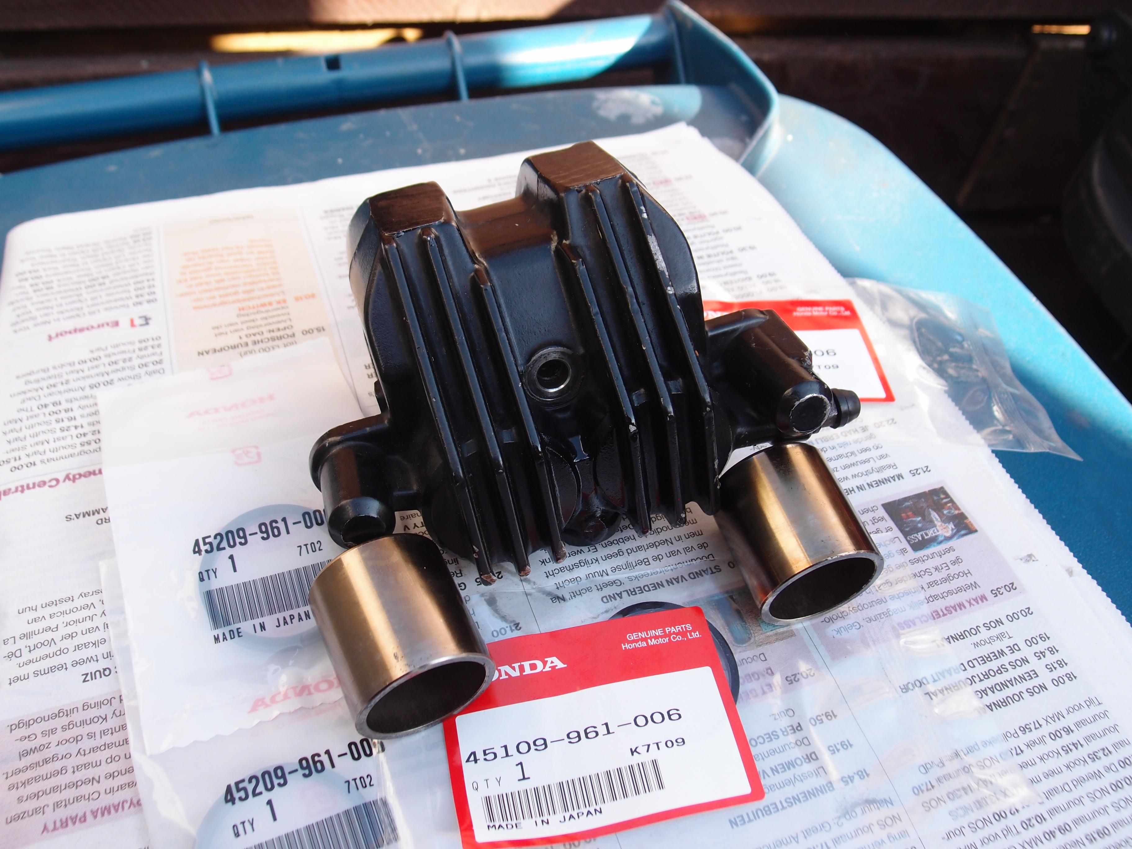

Member Contributer Dutchy Posted September 25, 2019 Member Contributer Posted September 25, 2019 They'll probably buff out.... 1982 pistons: After 1 Quote
