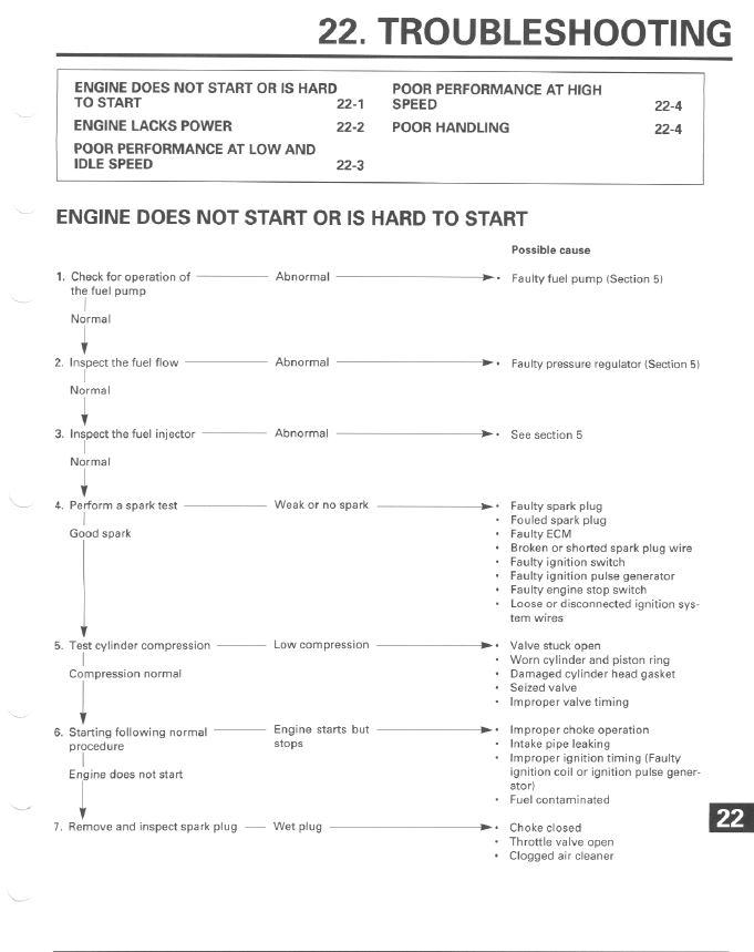

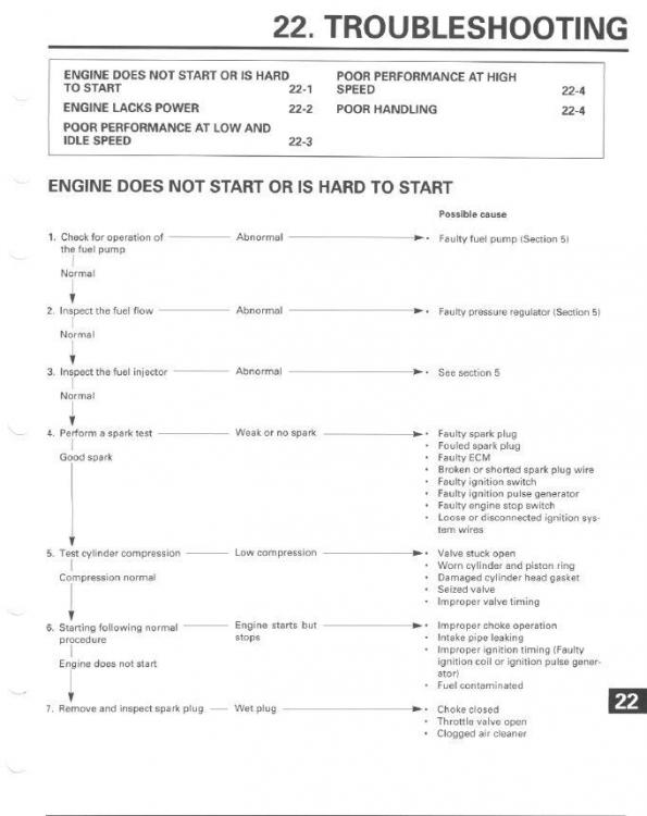

Member Contributer BusyLittleShop Posted September 8, 2019 Member Contributer Posted September 8, 2019 For the Fi system to work as designed on start up the butterflies must be 100% closed... this is because close butterflies equals sufficient vacuum... without sufficient vacuum the fuel cannot be drawn into the combustion chamber to support start up... the result is hard starting... the drill for cold or hot start is 1 100% close throttle for sufficient vacuum 2 Full choke when cold no choke when hot 3 Hit start Eliminate the possibility that the throttle body butterflies are not closing 100%... if any any air is bleeding pass the butterflies then the metered flow of the idle air can not draw sufficient fuel to support combustion... The dead give away of an air leak on a Fi engine is high uncontrolled idle... on a fuel injection system *any* air that gets past the throttle bodies the map just adds the corresponding fuel... the result is high uncontrollable idle... make sure all the rubber hoses are connected and in good shape... make sure all the intake boots are tight and in good flexible shape... if the rubbers are hard and cracked its time for replacement... Allow me to illustrate what is happening when you pull the chock lever on Honda's fuel injection system... note all you are controlling with the knob marked "choke" is the amount of air through the starter valve circuit... the more air the senors see down wind of the injectors more the map automatically increase the fuel... the result is control idle... Quote

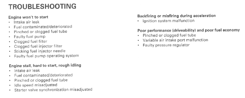

Member Contributer BusyLittleShop Posted September 8, 2019 Member Contributer Posted September 8, 2019 On 9/5/2019 at 2:52 PM, Terry said: Good advice from Greg. Its possible this troubleshooting guide is for carbs not for Fi equipped VFR... below is from the offical Honda VFR800 manual... Quote
Member Contributer Terry Posted September 8, 2019 Member Contributer Posted September 8, 2019 My cut and paste was direct from the 5G manual in the fuel section (chapter 5). Quote

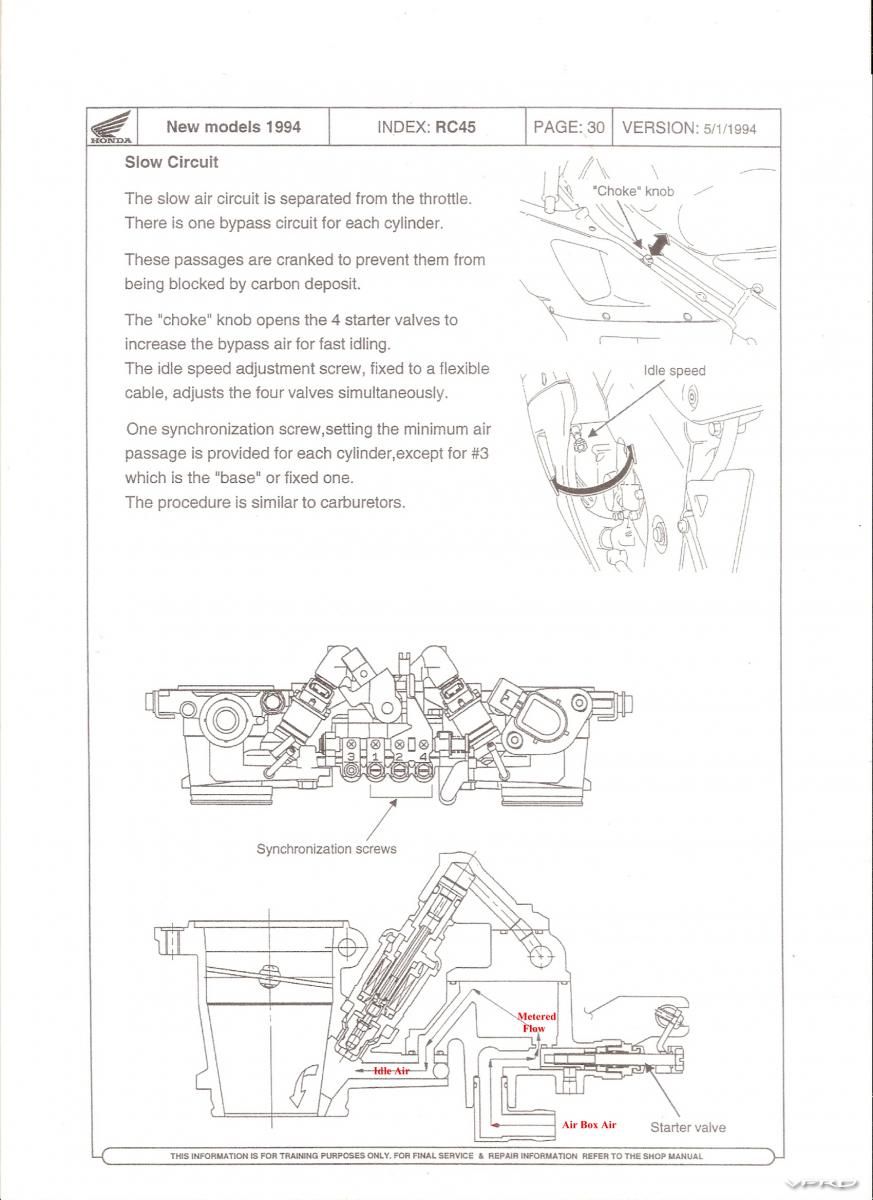

Member Contributer MaxSwell Posted September 9, 2019 Member Contributer Posted September 9, 2019 O the right side of the bike, on the exposed aluminum spar there is a small rubber cap that can be removed to expose an opening; insert a phillips head screwdriver until you feel it mesh with a screw about an inch into the hole. You could raise your idle to 1,300 + or - 100. Turn to change the idle. Turn clock-wise to raise the idle. Engine should be warm. The Owners Manual says: if it is a cold start warm it up with a 10 minute stop-and-go ride. Mc should be on center stand on a firm and lever service. Shift into neutral and adjust. BTW: Phillips head screws were developed by the auto industry to be self-torqueing - the screwdriver will spin off the screw at a predetermined torque. Japanese mc manufactures use a JIS screw and screw driver that will not spin off. I bought a three-piece set as recommended by Consumer Motorcycle News https://www.mcnews.com/ (This is the best of the mc news rags). Check out: https://www.vesseltools.com/handtools/screwdrivers Quote
GreginDenver Posted September 9, 2019 Posted September 9, 2019 1 hour ago, MaxSwell said: O the right side of the bike, on the exposed aluminum spar there is a small rubber cap that can be removed to expose an opening; insert a phillips head screwdriver until you feel it mesh with a screw about an inch into the hole. You could raise your idle to 1,300 + or - 100. Turn to change the idle. Turn clock-wise to raise the idle. Engine should be warm. The Owners Manual says: if it is a cold start warm it up with a 10 minute stop-and-go ride. Mc should be on center stand on a firm and lever service. Shift into neutral and adjust. I don't know if you're doing it on purpose, but you're quoting the California-only VFR800 idle speed setting. Quote

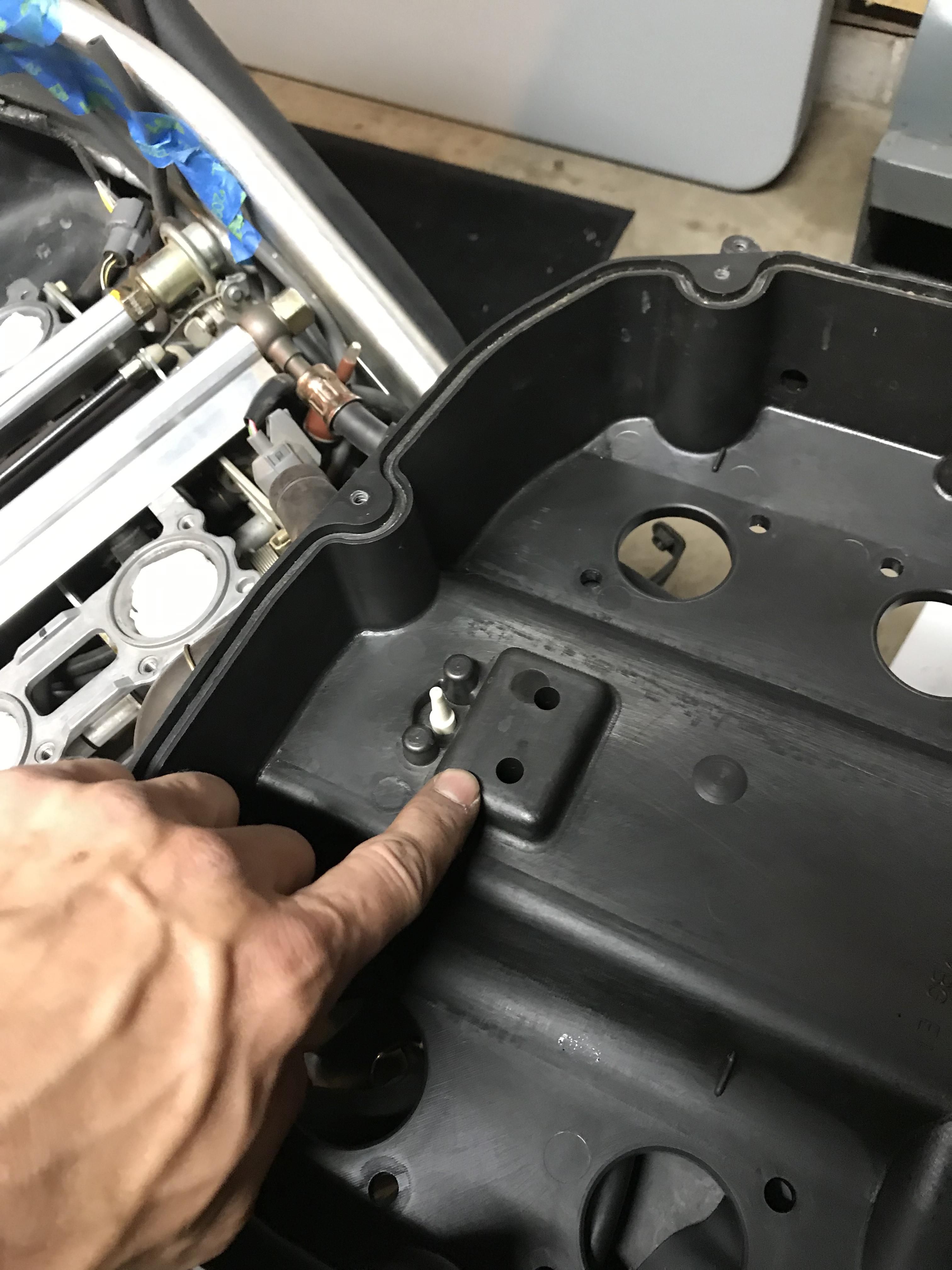

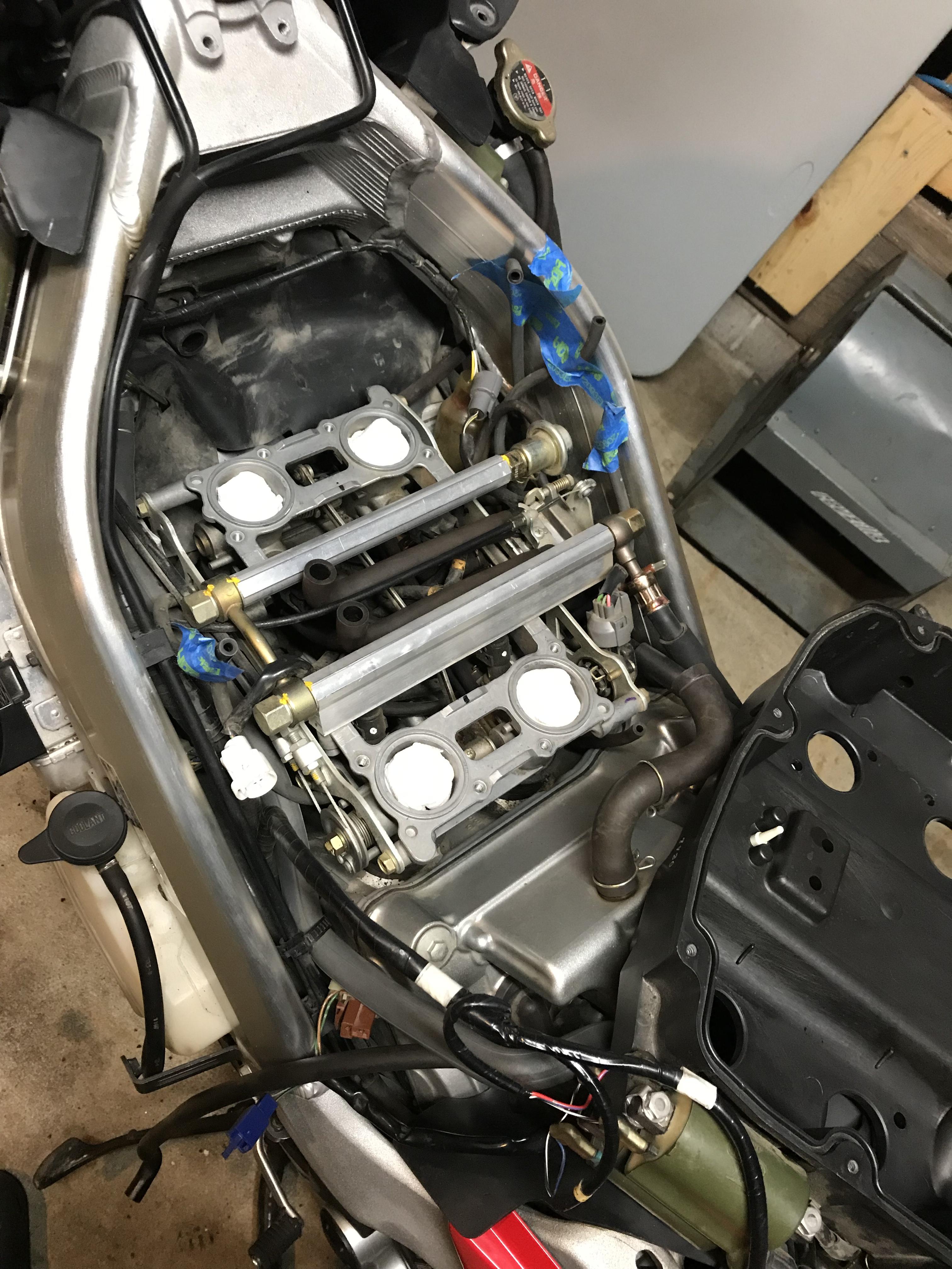

airdog84 Posted September 11, 2019 Author Posted September 11, 2019 Torn into things tonight. Tank needs drying out to clean out the light rust. Cleaned out our the air box. i watched a youtube video of a guy who had a black VFR that he bought to bring back to life. When he twisted the throttle fast the motor would die due to no air movement. He showed the two holes below and when he put his fingers on them it would die immediately. Guy stated in the video that the master air line was dirty. After the guy cleaned it (not sure how he did that??) his throttle response came back. I checked the hoses that were connected to those two holes and mine where clear? Am I missing something.. because my bike would putter when I would twist the throttle fast too. Just want to make I do what is needed with it open before I put the air box back together. Lastly, anything else I should check, remove or replace before I put the air box back together? Hoses look old but no cracking thanks Quote
GreginDenver Posted September 11, 2019 Posted September 11, 2019 Those two holes admit air into the Starter Valve system. Nothing cosmic going on there, just make sure you get them reattached as you're putting the airbox back on. After you get things reassembled you're gonna need to do a Starter Valve Synchronisation, see the Service Manual on page 5-67. That will help to sort out the stumble in your off-idle acceleration. When you're putting the airbox back onto the throttle body you want to be very careful to make sure the MAP sensor is connected properly. Quote
airdog84 Posted September 11, 2019 Author Posted September 11, 2019 3 minutes ago, GreginDenver said: Those two holes admit air into the Starter Valve system. Nothing cosmic going on there, just make sure you get them reattached as you're putting the airbox back on. After you get things reassembled you're gonna need to do a Starter Valve Synchronisation, see the Service Manual on page 5-67. That will help to sort out the stumble in your off-idle acceleration. When you're putting the airbox back onto the throttle body you want to be very careful to make sure the MAP sensor is connected properly. Got it, my Service Manual won’t be here for a week. Also, Is the MAP sensor the grey plug in or the whit one on the bottom of the air box. Thank you!! 😄 Quote
GreginDenver Posted September 11, 2019 Posted September 11, 2019 I didn't know you were without a Service Manual. There's an electronic copy of the Service Manual available here on the forum. The MAP sensor is attached to the bottom right-hand side of the airbox. The white sensor on the bottom of the airbox is the IAT (intake air temperature sensor). 1 Quote
Member Contributer adkfinn Posted September 11, 2019 Member Contributer Posted September 11, 2019 13 hours ago, GreginDenver said: I didn't know you were without a Service Manual. There's an electronic copy of the Service Manual available here on the forum. The MAP sensor is attached to the bottom right-hand side of the airbox. The white sensor on the bottom of the airbox is the IAT (intake air temperature sensor). Here's the link to the service manual, fyi. Also - the hoses you have blue taped in the earlier photo are the hoses you use for the starter valve sync and, if you look closely, they are numbered for each cylinder from the factory. Quote
