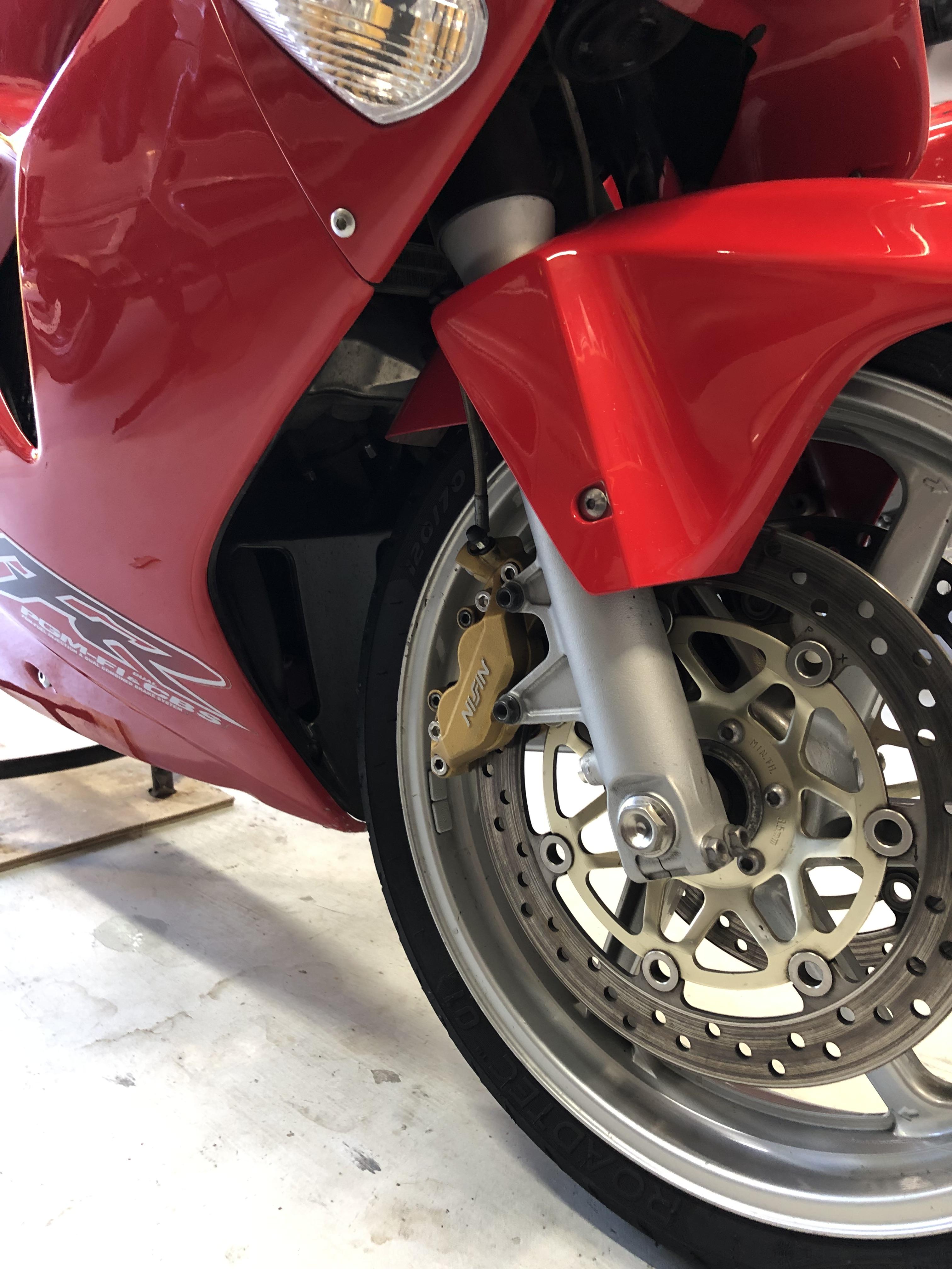

Member Contributer zupatun Posted September 5, 2019 Member Contributer Posted September 5, 2019 No Frankenfork for me. I used 6th gen triples, F4i forks, fender and calipers with my 5th gen wheel. Matt in Haymarket. Quote
Member Contributer Terry Posted September 5, 2019 Member Contributer Posted September 5, 2019 I used F4i forks, 954 calipers, CBR600RR 03 master, 6th gen triples and bars, F4i fender and the 5G wheel/axle/spacers on my 5G, was a great combination that gave me no issues at all. The only bit that did not align perfectly was the steering lock, and I used a couple of washers to lower the mechanism down from the top triple which worked fine. 1 Quote
Member Contributer jkboyd Posted October 10, 2019 Member Contributer Posted October 10, 2019 On my 5th gen I went with Jamie's recommendation and used 6th gen fork tubes with F4i lowers. I really like the setup. Quote

87013sz Posted June 26, 2020 Posted June 26, 2020 I finally recieved my F4i forks complete with axle, calipers and master cylinder. Will take them to a specialist to strip them so I can paint the lowers in satin black and hopefully my Wilbers springs from my 6th gen forks fit in with no problems.Will also be rebuilding the calipers and paint them in gold. Sent from my ONEPLUS A5000 using Tapatalk Quote
