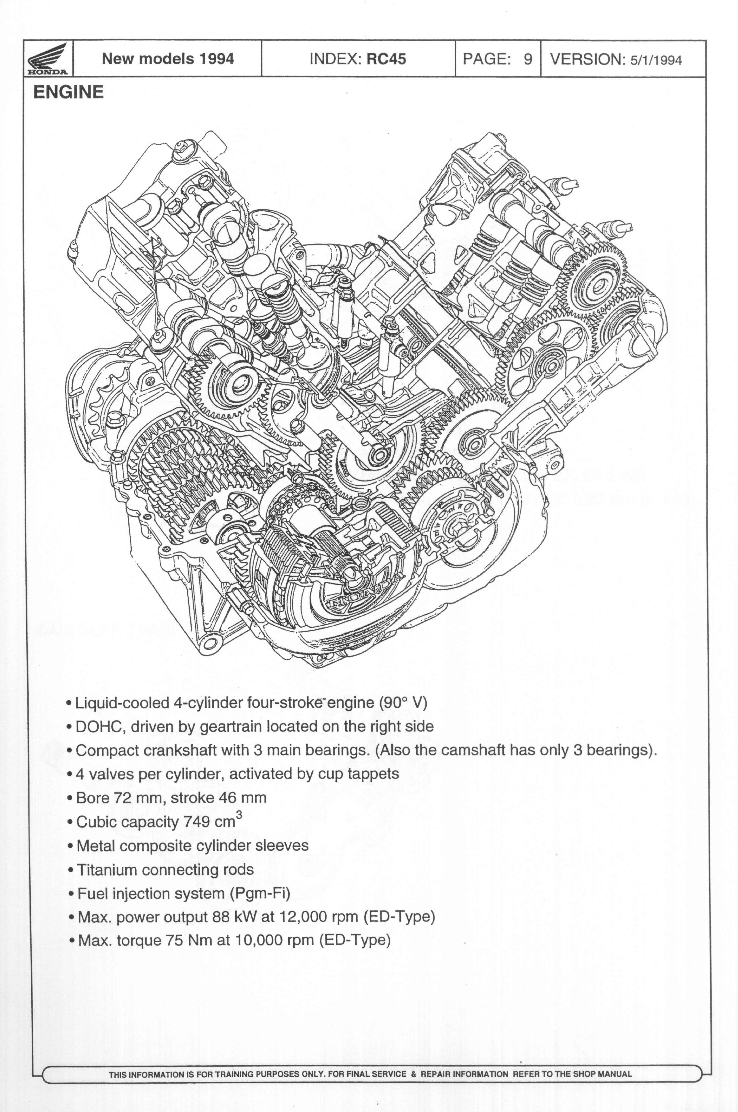

Member Contributer Marvelicious Posted July 30, 2019 Member Contributer Posted July 30, 2019 Absolutely... They could have, and I would be willing to bet that money made the decision, not engine noise. Still, in the end, they didn't... As long as we're way off the OP's topic, did I hear about someone building a hybrid gear driven VTEC from two VFR engines, or did I imagine that? Quote
Member Contributer BusyLittleShop Posted July 30, 2019 Member Contributer Posted July 30, 2019 On 7/29/2019 at 6:16 PM, Terry said: the cams don't care how they are being spun. HRC cams cares... Granted most street 4 strokes use a simple chain to turn the cams whereas Honda's race bred V4s employ gear-driven cams for the simple fact gears provide the most accurate and reliable form of cam operation regardless of RPM... Every time I hear that cam gear whine I know good things are about to happen... Quote
fatshoutybloke Posted August 5, 2019 Posted August 5, 2019 On 7/30/2019 at 5:46 AM, Marvelicious said: Absolutely... They could have, and I would be willing to bet that money made the decision, not engine noise. Still, in the end, they didn't... As long as we're way off the OP's topic, did I hear about someone building a hybrid gear driven VTEC from two VFR engines, or did I imagine that? Mark Harris on the UK VFR forum put a pre-VTEC 800Fi engine into his 6th gen a few years ago, still has the bike. Quote
Member Contributer Marvelicious Posted August 5, 2019 Member Contributer Posted August 5, 2019 2 hours ago, fatshoutybloke said: Mark Harris on the UK VFR forum put a pre-VTEC 800Fi engine into his 6th gen a few years ago, still has the bike. Not what I meant... I think there are a few of those that have been done. I'm talking about driving a VTEC head with gears. Much more difficult and I think I probably imagined it. Quote
