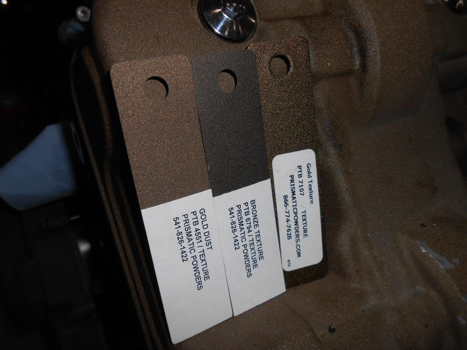

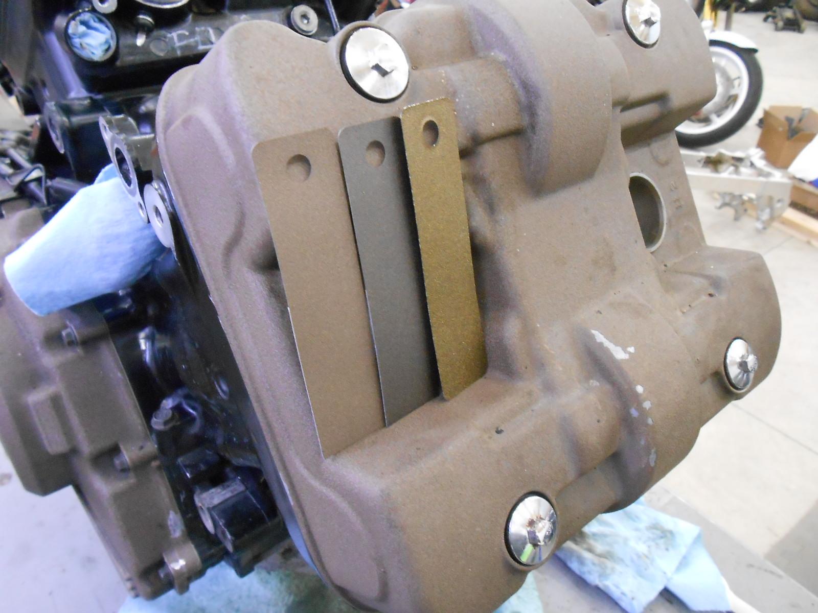

Member Contributer evl_twn Posted March 16, 2019 Member Contributer Posted March 16, 2019 Has anyone had any luck matching the finish on the 86 VFR cases? I've got some blemished on the project bike I picked up and I'm thinking about experimenting a bit with trying to get something that looks close to what these had originally. I've got several samples of texture powder coat finishes coming in several colors. Not sure if any of them will be "close enough" or if I'll have to blend them a bit, but if someone else has already "cracked the code" on this finish that would make it quicker. 🙂 Quote

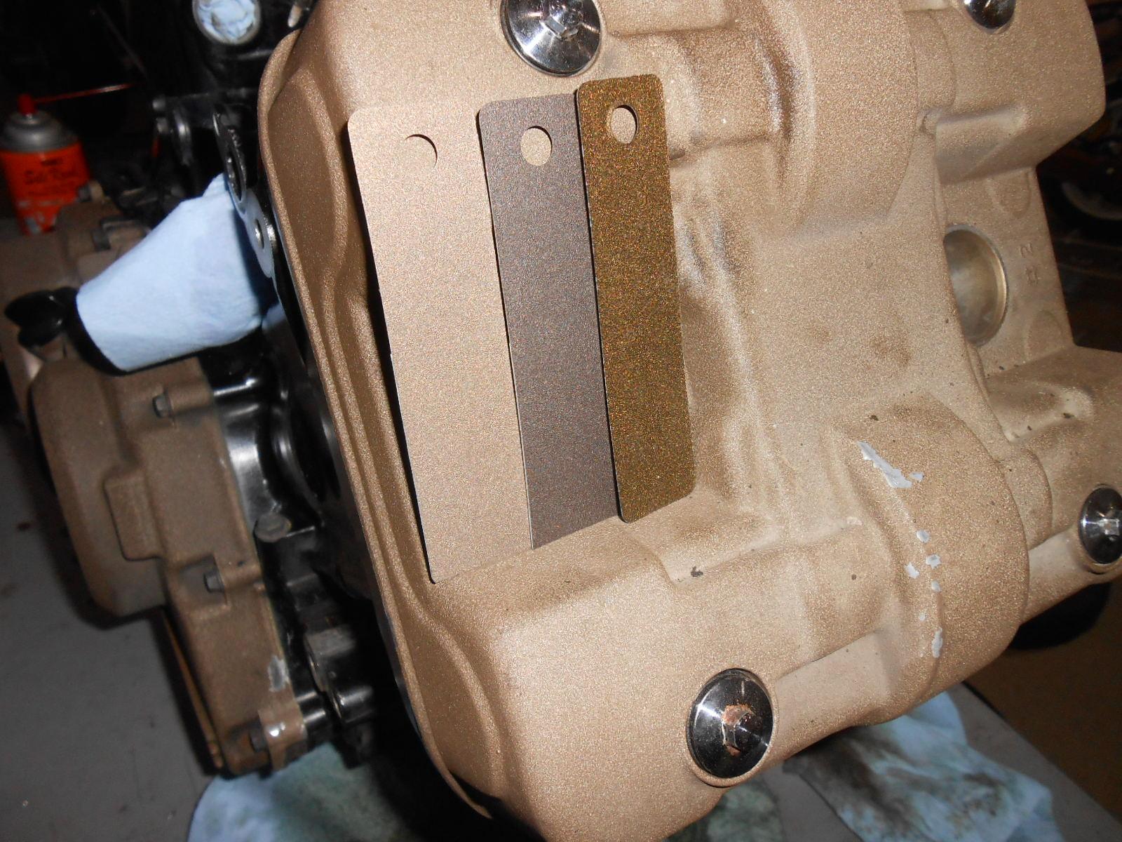

Member Contributer evl_twn Posted March 22, 2019 Author Member Contributer Posted March 22, 2019 Joe sent me a couple of pictures of some covers he had done and they look awesome, the color he used is called "bronze texture". He said he had tried several different swatches before using that one, and it was a good match. I also ordered several swatches, and maybe this is a new one but the "gold dust" texture is just a shade lighter, and possibly closer to the original finish. I've got a few pounds of the powder ordered, we'll see how it goes 🙂 Thanks Joe! Quote
atx Posted March 24, 2019 Posted March 24, 2019 That gold dust sure does look close. Looking forward to results. I still have a spare set of covers i need done... Quote
Member Contributer tomk1960 Posted March 25, 2019 Member Contributer Posted March 25, 2019 I'd say that the gold dust looks the best of the three. I'll check with one my suppliers to see if they have anything similar, but I'd say that Prismatic has come pretty darn close. I'll be powder coating quite a few parts for my VFR750F in the coming months, so if that one comes out nice, I'll have to get a pound for myself. Quote

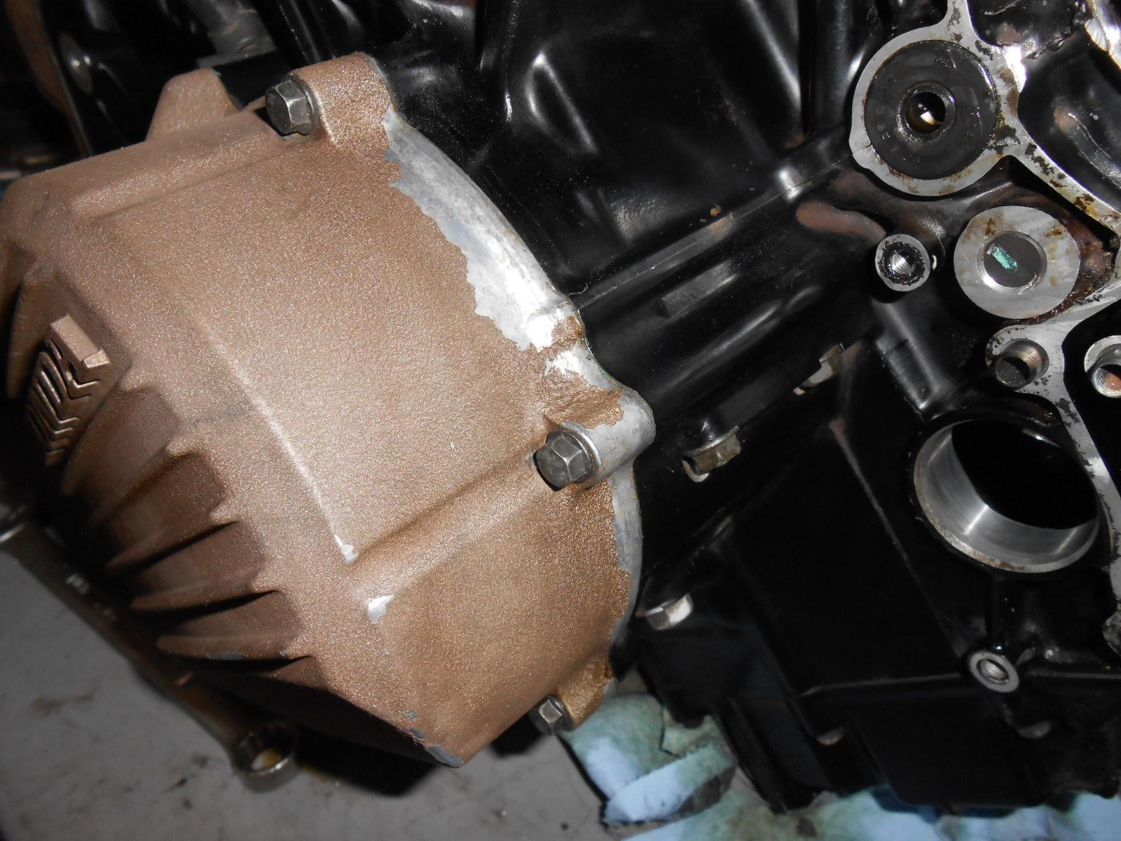

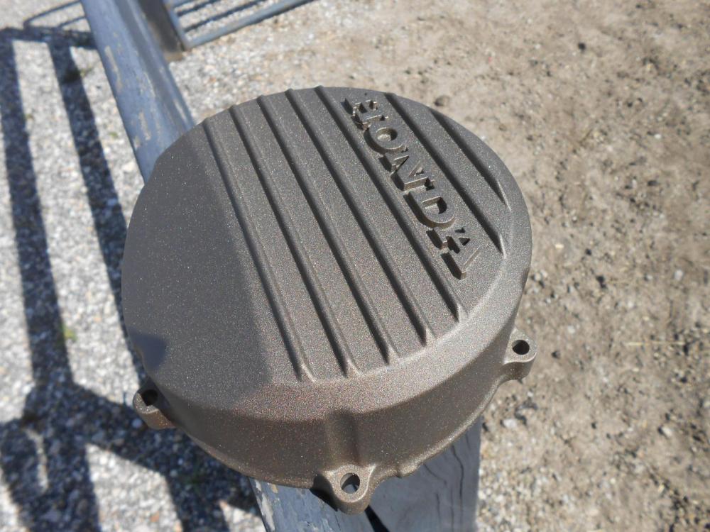

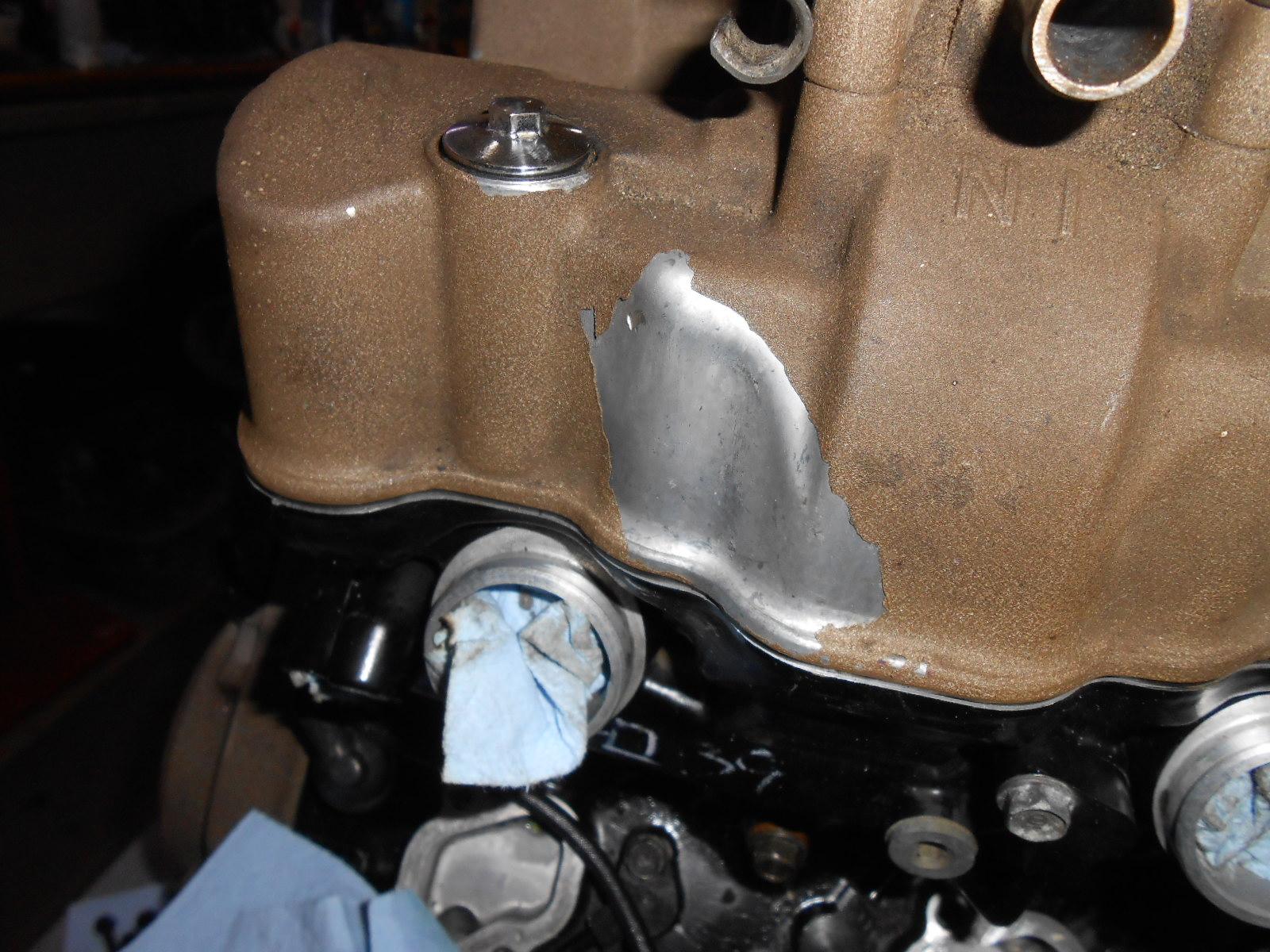

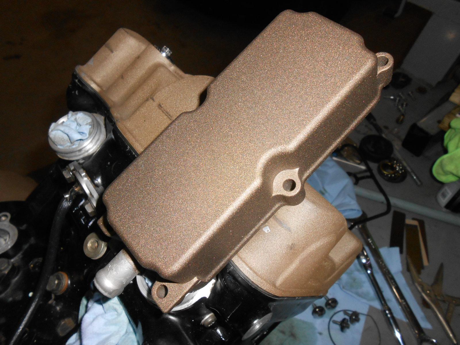

Member Contributer evl_twn Posted March 29, 2019 Author Member Contributer Posted March 29, 2019 I received the "gold dust" powder from Prismatic. It's close, but not an exact match for the 86 engine cover paint. We'll see how well it looks after it's weathered a bit. The downside is removing the original finish, it's taking a long time to remove using a bead blaster. I don't want to get any more aggressive than bead blasting though. I might pick up some aircraft stripper and see if chemical removal works better than mechanical. Quote

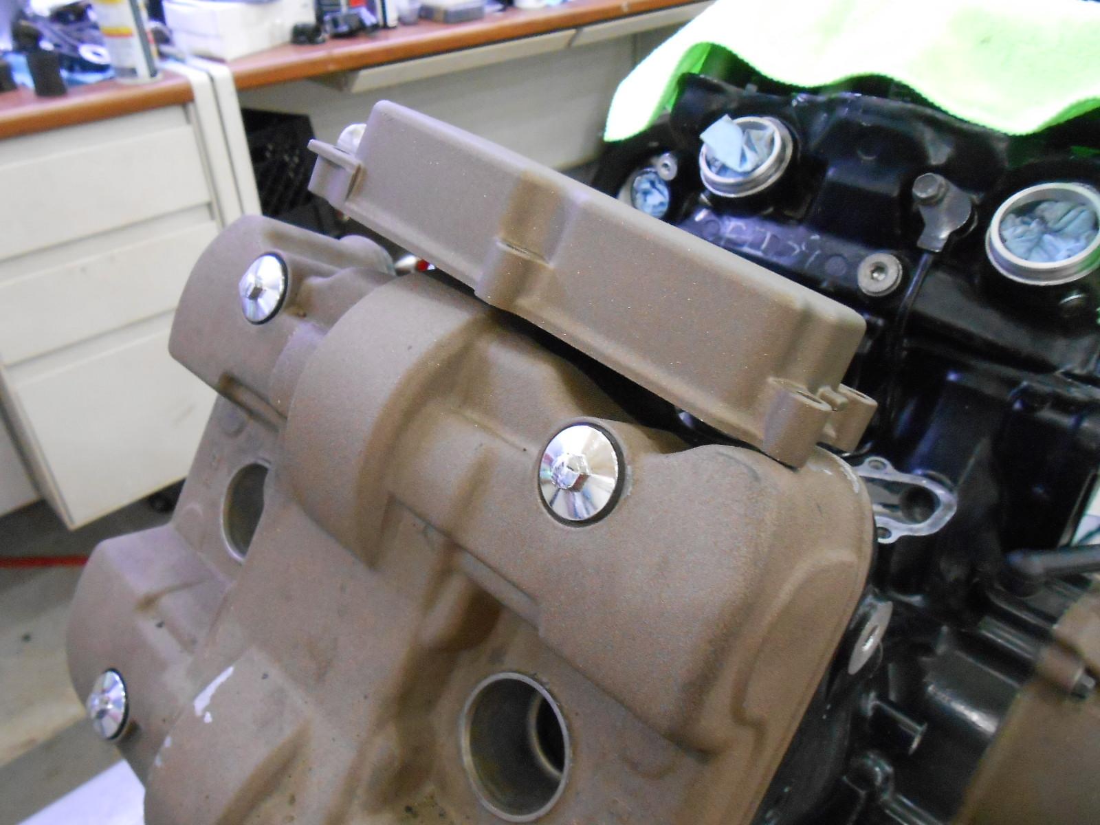

Member Contributer SamW Posted March 30, 2019 Member Contributer Posted March 30, 2019 That looks really close without the flash. Quote

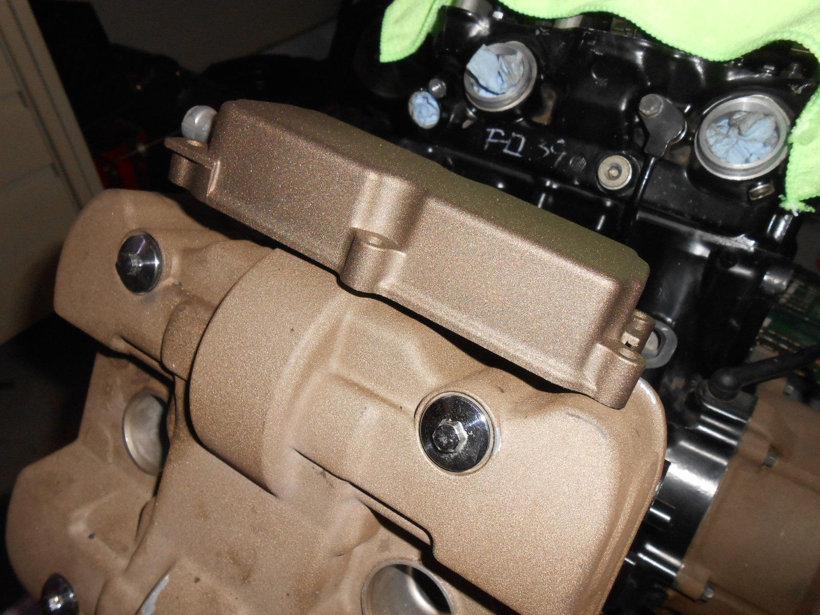

atx Posted April 11, 2019 Posted April 11, 2019 I just got mine back, went with bronze mist. I hate wiping oil off of textured finish, figured this would be easier to clean. Anyone have any hot tips for replacing all the engine covers? Like corners known to leak i should dab some rtv on or something? I bought a full engine seal kit off of ebay, hopefully it does fairly well. Can't wait to finally get this sebspeed clear clutch cover on, dunno what my hold up has been... 1 Quote
Member Contributer Captain 80s Posted April 11, 2019 Member Contributer Posted April 11, 2019 Those turned out cool. If you got all new rubber you shouldn't need any sealant. If you do use any sealant on anything, use Hondabond. Quote
Member Contributer Captain 80s Posted April 11, 2019 Member Contributer Posted April 11, 2019 On 3/29/2019 at 4:47 PM, evl_twn said: I received the "gold dust" powder from Prismatic. It's close, but not an exact match for the 86 engine cover paint. We'll see how well it looks after it's weathered a bit. The downside is removing the original finish, it's taking a long time to remove using a bead blaster. I don't want to get any more aggressive than bead blasting though. I might pick up some aircraft stripper and see if chemical removal works better than mechanical. After standing at my bead blaster for far too long, I busted out the aircraft stripper. That is the way to go. For the most part that finish melts right off. I had to blast a few tough spots, but WAY better. 1 Quote

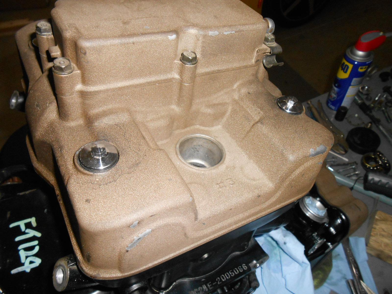

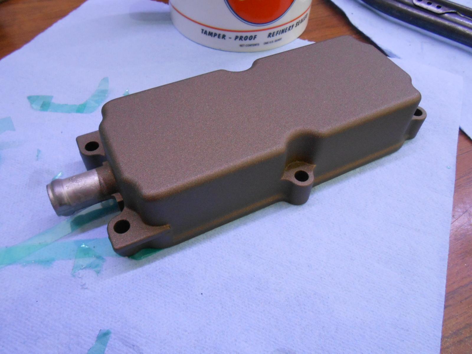

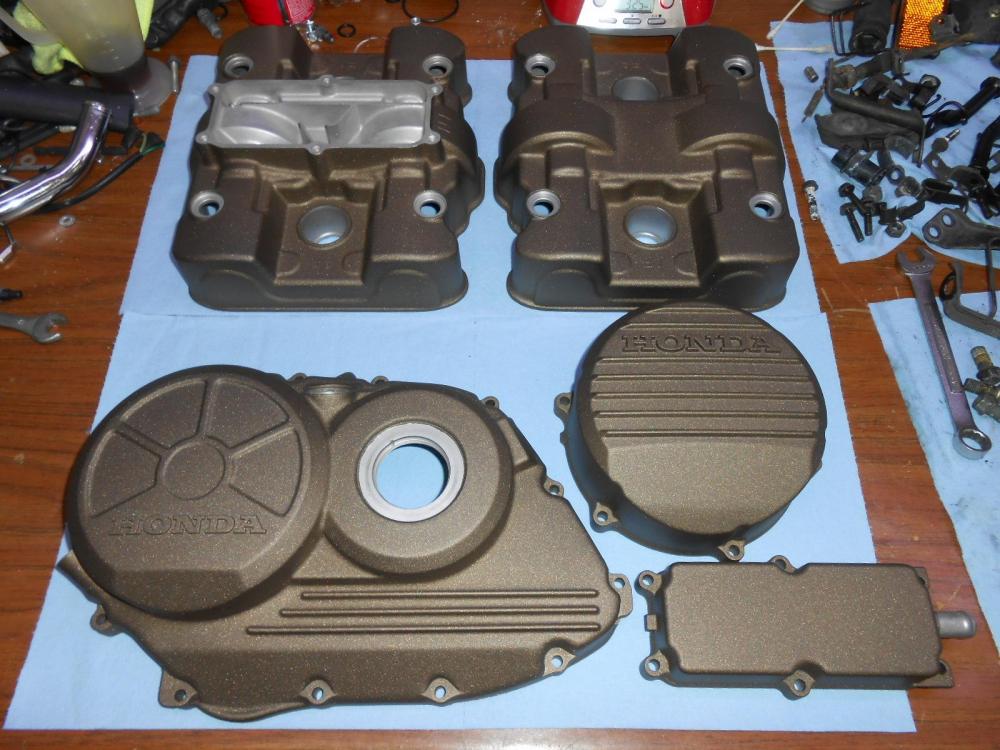

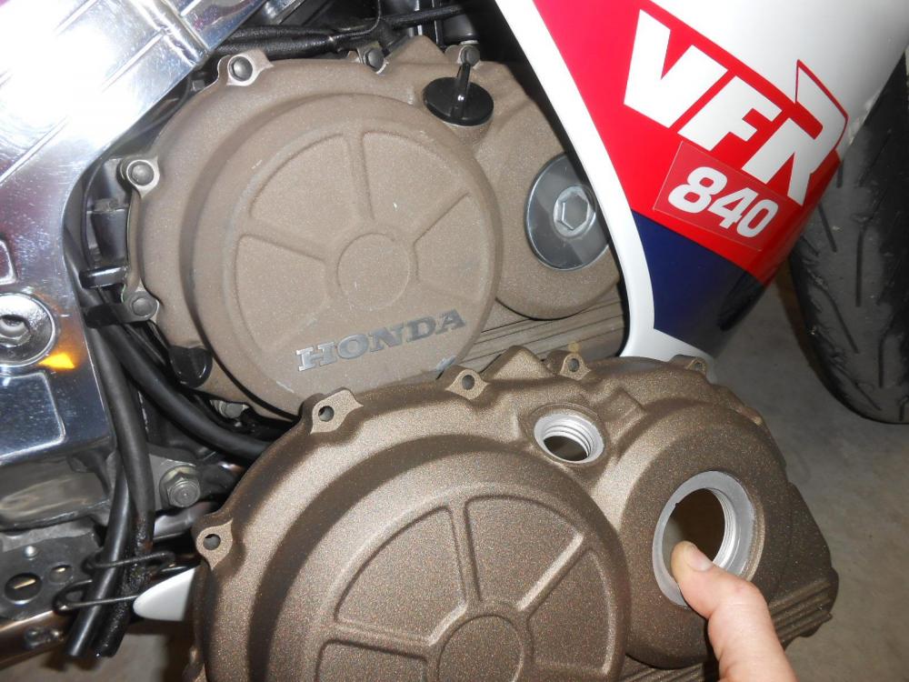

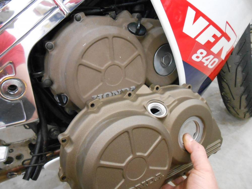

Member Contributer evl_twn Posted April 13, 2019 Author Member Contributer Posted April 13, 2019 Finally got around to coating the rest of the parts. I think the color and finish will be OK, but it's definitely not a "perfect" match. I wish I could find the same shade/texture but without the sparkly bits. Oh well, still better than the finish that was on these when I got the bike. The flash pics show a lot of sparkle, the pic in sunlight is a bit less glittery. 1 Quote
Member Contributer Stray Posted April 14, 2019 Member Contributer Posted April 14, 2019 Is powdercoat up to the task on these valve covers? Mine crinckled up with the high temperature. It looks OK on the side covers but not the valve covers. Quote
Member Contributer tomk1960 Posted April 22, 2019 Member Contributer Posted April 22, 2019 That finish looks great. No big deal that the match isn't perfect - they're going to look awesome on the bike. Powder coatings will hold up fine on engine covers, as long as they're rated to cure in the 375-400 degree range. Once cured, it takes a considerably higher temperature for the finish to soften up. I've powder coated hundreds of various engine covers over the years and have never had an issue. Valve covers probably get the hottest and I've never had a problem with the finish failing. 1 Quote
