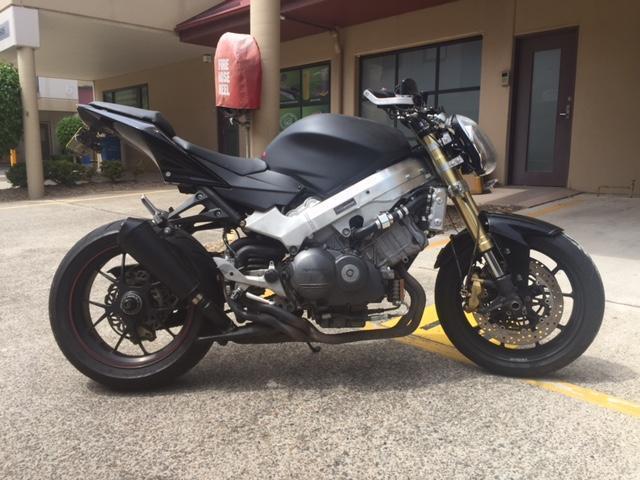

SEBSPEED Posted October 15, 2015 Posted October 15, 2015 If I were keeping my streetfighter, I would consider switching over to Duc rear wheel. Quote

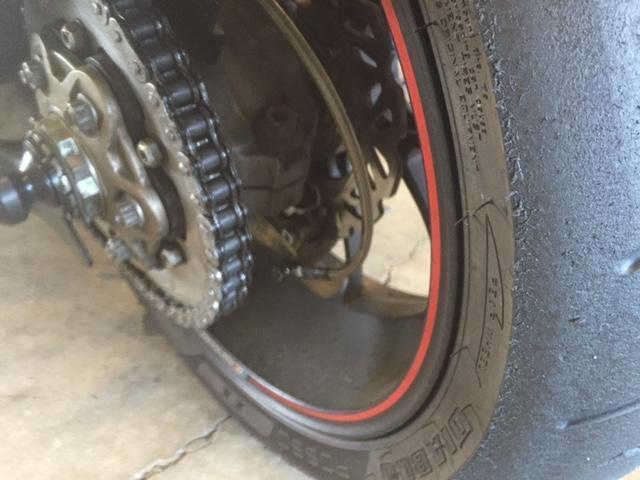

keef Posted October 15, 2015 Author Posted October 15, 2015 If my fighter was as good as yours, Seb, I'd be keeping it. Although I'd feel guilty about bolting a top box to it like mine (I have a mounting plate bolted to a spare pillion seat so I can use a top box for weekend trips.) The 6" rear wheel with a 190 and a seat from a 250cc bike make the rear look like its a 300 section tyre. I love it. Quote
Member Contributer HighSideNZ Posted October 15, 2015 Member Contributer Posted October 15, 2015 Thanks for the qudos Keef but I still feel that anyone who embarks on a project like yours deserves all the praise they can get. As I said earlier, keep up the good work. Cheers Phil Quote

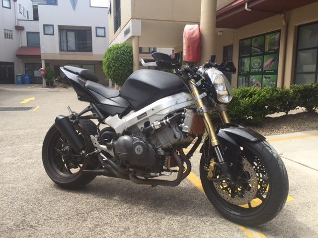

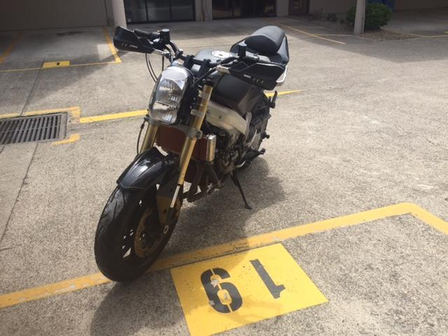

keef Posted October 31, 2015 Author Posted October 31, 2015 My brother wanted to book a trackday, and asked if i wanted to come. I said i couldn't afford it. He said he'd pay. The free trackday has cost me some money, since i had to actually get stuff done. I mounted my new rad, it was touching the front guard under hard braking, so i need to get some proper mounts made to raise it up about 40mm, basically, as high as i could. Also, the brackets made by me/my mates meant the rad was angled a little bit, so air slid off it, instead of going through it. I needed to be going about 110kph before it actually cooled anything. So, off to DMVC in Botany. New mounts (and modding the tabs on the alloy rad) only took a day. Matt took it for a decent ride to test it all out, and freeway speeds it was running at 84 celsius - much better now its angled right. Top mount up under the frame near the oil cooler mounts, but he made new threaded holes, and the bottom mounts are now the rocker cover bolts. all ready for the trackday Monday with my brother. 1 Quote
Member Contributer paladinreed Posted October 31, 2015 Member Contributer Posted October 31, 2015 Hnnngg... Gonna need track day pics as well.. That fender is the clearance problem with the rad brother. That thing looks to stick way off of the profile of the tire. Seems like I have a bit more clearance than you do. So awesome Quote
keef Posted October 31, 2015 Author Posted October 31, 2015 It was never an issue with the TLR rad. The front guard is only a few mm off the front of the tyre, but it's mayvpbe 10-15 of the back of the tyre. It's because it's a 42mm core instead of OEM16mm, it's a hell of a lot thicker. It was touching the front guard when I had 35mm or so of travel left in the forks, even if I gained 15mm from the front guard that would leave 20mm of Crunching. I definately had to raise the rad. Quote
keef Posted November 3, 2015 Author Posted November 3, 2015 brilliant day yesterday, but only did 3 sessions - just as i was gearing up for the 4th session, i noticed that i had lost the bolt from my exhaust. I decided to call it a day, and just use cable ties to get me home. the new rad ran at 93 celsius for the first 2 sessions, and the third one was at about 104 - but it was 30-35 celsius, and humid. That kind of hot and humid you get before a thunderstorm. No clearance issues with it either. I am definitely too heavy for the springs, but it handled pretty well, knees, toes and peg on the deck on the left, and toes and peg on the right. After my broken right leg, body position needs some work. and the pics.. tyres right to the edge. the horsepower trying to burst forth from the tank. Or my legs rubbed through the plastidip and my load bearing cable ties 1 Quote

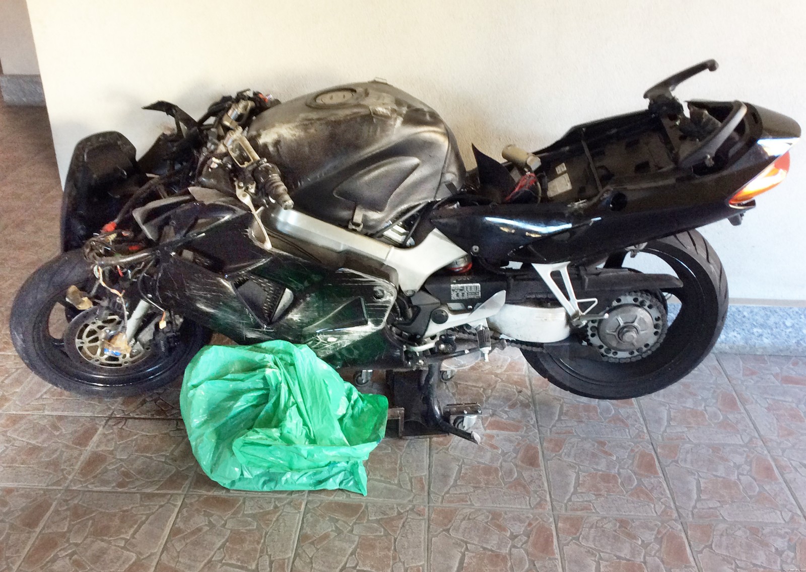

Member Contributer luigi Posted December 19, 2015 Member Contributer Posted December 19, 2015 This work is very similar to my idea to transform my road use VFR in a Streetfighther (one of my million projects). Unfortunately the subject of this idea goes away, and now run in the motorcycle' paradise where goes all bikes that closes their life in an accident. Run your bike for my Black Widowmaker too, Keef. Ciao, Luigi. Quote
keef Posted December 19, 2015 Author Posted December 19, 2015 That's the start of a streetfighter, Luigi. Hope you're ok, mate. Quote
Member Contributer luigi Posted December 19, 2015 Member Contributer Posted December 19, 2015 Thank you Keef. Yes, i'm fine. I was lucky. The bike is destroyed but this is the price that i payed to have let the brain at home before riding. Congrats again for your work. Ciao. Luigi. Quote

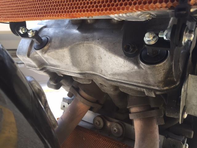

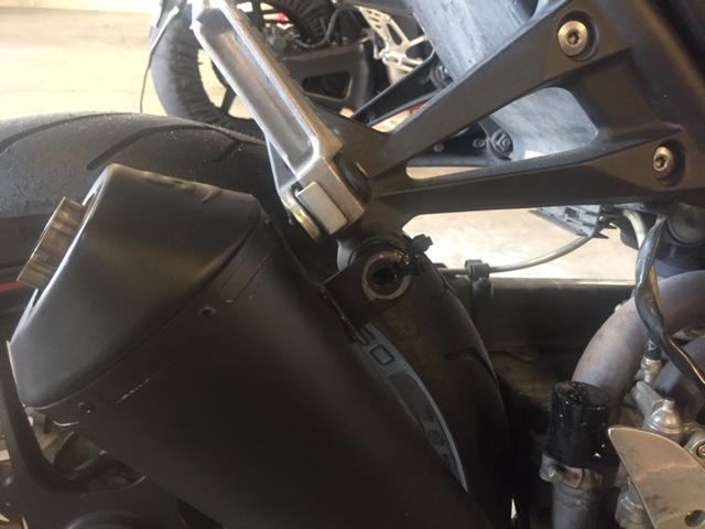

keef Posted January 18, 2016 Author Posted January 18, 2016 Since the scorpion can came loose at the track day, I fitted the Jardine slash cut pipe i had lying around. Ridiculously loud, and incredibly evil sounding. Even with a baffle in the tip.It will stay on until i get the carbon akra MT09 can fitted. I need to get another link pipe made. If anyone wants a scorpion can for a 5th gen, let me know. I also fitted 2x 80mm computer fans to the front mount rad. rated as IP55, so should do the job since i don't ride the vfr in the rain much. And while i was letting the bike get hot to make sure the fans kicked in when they should (they did), i noticed a coolant leak in the V of the engine somewhere. What a pain in the arse. Quote
Member Contributer luigi Posted January 18, 2016 Member Contributer Posted January 18, 2016 ...i noticed a coolant leak in the V of the engine... Stay up keef, a leakage in that engine zone can be just an O-ring or a hose damaged. I don't think something of worst. I know, checking that parts is a very noising job (removing the air box and throttle body... ) but making a special it means have this problems too. Ciao, Luigi. Quote
keef Posted January 18, 2016 Author Posted January 18, 2016 I know, 2 steps forward, one step back. Better to notice it in the garage than on the road, though. I have a small, uv/black light torch (was a kids toy in a party bag). It doesn't light up the space, but it makes the coolant glow in the dark. Great for following the trail of coolant. Looking forward to removing the air box lower and throttle bodies for the first time. Quote
