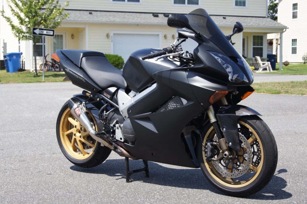

Member Contributer VFR800R Posted August 9, 2011 Author Member Contributer Posted August 9, 2011 As we're getting ready to move again (this time from Groton, CT to Poulsbo, WA), I realized that I never really took "final" photos of the VFR and posted them to my build thread. So, here are a couple: VFR800 Front quarter 9Aug2011 VFR800 Right Side 9Aug2011 Recently, I have only done a couple small things. I have had a carbon fiber hugger sitting around for a year, waiting on the time to build a bracket (because my eBay "steal" didn't come with one, and the British company who made it wouldn't answer any emails), so I finally hacked out an aluminum bracket and trimmed the trailing edge of the hugger with my Dremel to eliminate a crack. It turned out pretty great, with good alignment and more than enough protection for my Ohlins shock. I also added a couple of HRC/Yoshimura stickers (another eBay find from somebody in Thailand), and a Yosh timing plug for the CBR600RR (thanks Honda for all your standardization!). The plug is obviously only visible when the right fairing is off, but I like that I have at least 3 Yosh parts on the bike to tie together the HRC/Yosh theme (the upper triple clamp nut, the timing plug, and the R55 muffler). I also finally completed the Vortex rearset conversion; I needed a few parts from Vortex (worn out shifter lever bearings, which necessitated buying a new shifter lever) and a shifter rod, but now the shifter is fully functional. I keep contemplating a reverse-pattern, but the clearances are pretty tight already and interference would be bad. Finally, I added a lithium iron battery from Shorai which knocks about 6 more pounds off the bike, which brings my rough total to about 60 pounds removed. Not bad, but it could be better... I have more stuff in the garage waiting to go on the bike: Tokico monobloc calipers from a CBR600RR to drop another pound of front unsprung weight, a Superhawk clutch master cylinder, and more parts for the (repeatedly failed) front radiator project. They will have to wait for next winter, because I will be at sea all fall... Next, I think I want to finally do something about the undertail space. There have been a few discussions on VFRD of late about making panels, so it may be time to bite the bullet and do it. Then, I think rideability is next on my list; with the BMC filter, no PAIR valves, and the Yoshimura exhaust, I have a lean flutter just off idle that is pretty annoying. I may buy myself a PCV with Autotune for Christmas. Well, that's it for now. I didn't get to meet any East Coast VFRD folks while I was out here due to the bike being in pieces and my tendency to play with my daughter and hang out with my wife, but hopefully I run into some of you in the Pacific Northwest! Lacy 3 Quote
