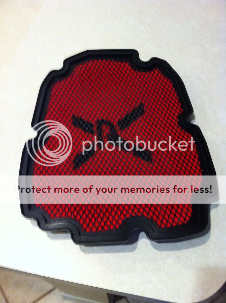

I got my piper cross today. Looks of good quality. It was a little hard to fit, but it went in with some finess. A couple of the pros:
It used all available space.
It weighed almost nothing.
It is curved upwards, giving much more space for the velocity stacks than both kn and BMC, which both sit on the velocity stacks.
The cons:
$93
Difficult fit.
CA5C4283-8C23-4A06-9541-8449DD636E07-129
3909782F-A04D-4076-8F2D-AC56C83E33E8-129
2CC8644F-E949-4A83-89E7-9CCD0E832EC0-129
The red side faces downwards
The back side faces upwards
side notes:
for any of you clean freaks. although the piper cross filter media will out flow both kn and bmc filter media of the same surface area, it will also trap dust particles of smaller size.
holding up the piper cross to the light, you can not see through what so ever.
rebuttal to the diesel truck dusting warranty void claim by gmc:
piper cross has been oem equipment over the past 10 years for triumph.
