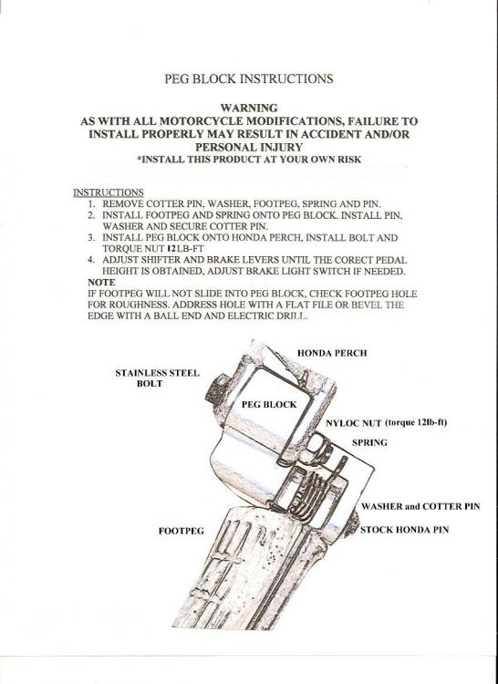

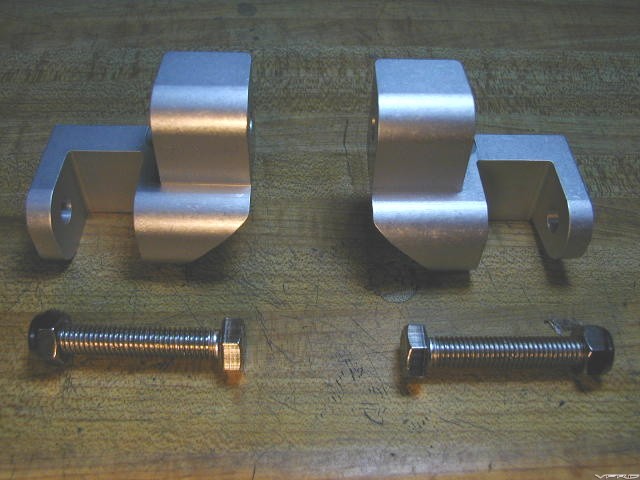

Member Contributer BusyLittleShop Posted June 28, 2013 Member Contributer Posted June 28, 2013 Wow, has it been 6 years??? I haven't taken the BLS blocks off, Still running them, still working great. Pay careful attention to the footpeg feeler mod I did, it's perfect. I would recommend the same. Its hard to believe but Peg Blocks, an exclusive VFRD product; is entering its 6 year of keeping those knees in the breeze... I want to thank Rob for his ingenuity and support that he tirelessly gives to the membership and there's a table at Bubba Gumps reserved in your name Rob anytime you return to Laguna Seca... 1 Quote

Member Contributer BusyLittleShop Posted December 7, 2014 Member Contributer Posted December 7, 2014 Just a friendly reminder that PEG BLOCKS, a VFRD exclusive product; are still available to keep your knees in the breeze... the price + USPS flat rate priority shipping are as follows... as soon as I receive Pay Pal payment the shipping starts... my account: netters2@comcast.net USA Peg Blocks $85.00 + Priority Shipping $8.30 = $93.30 Canada Peg Blocks $85.00 + Priority Shipping $27.90= $112.90 Europe Peg Blocks $85.00 + Priority Shipping $38.60 = $123.60 Australia or Denmark $85.00 + Priority Shipping $39.60 = $124.60 What you see is what you get.. Rob's INSTALLATION GUIDEhttp://www.vfrdiscussion.com/forum/index.php/topic/34097-bls-footpeg-block-install/VFRD site supporthttp://www.vfrdiscussion.com/forum/index.php/topic/77384-peg-lowering-blocks/ 1 Quote

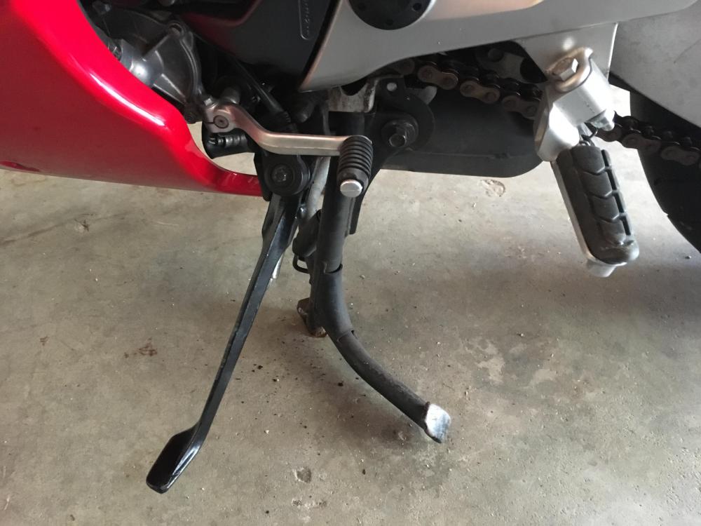

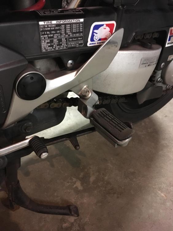

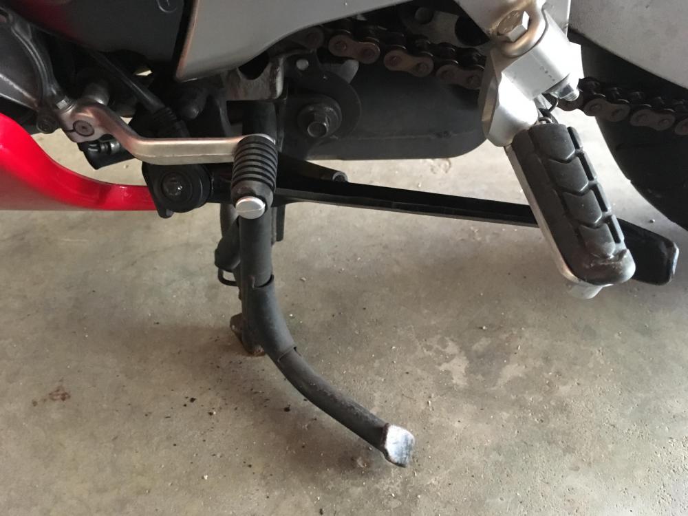

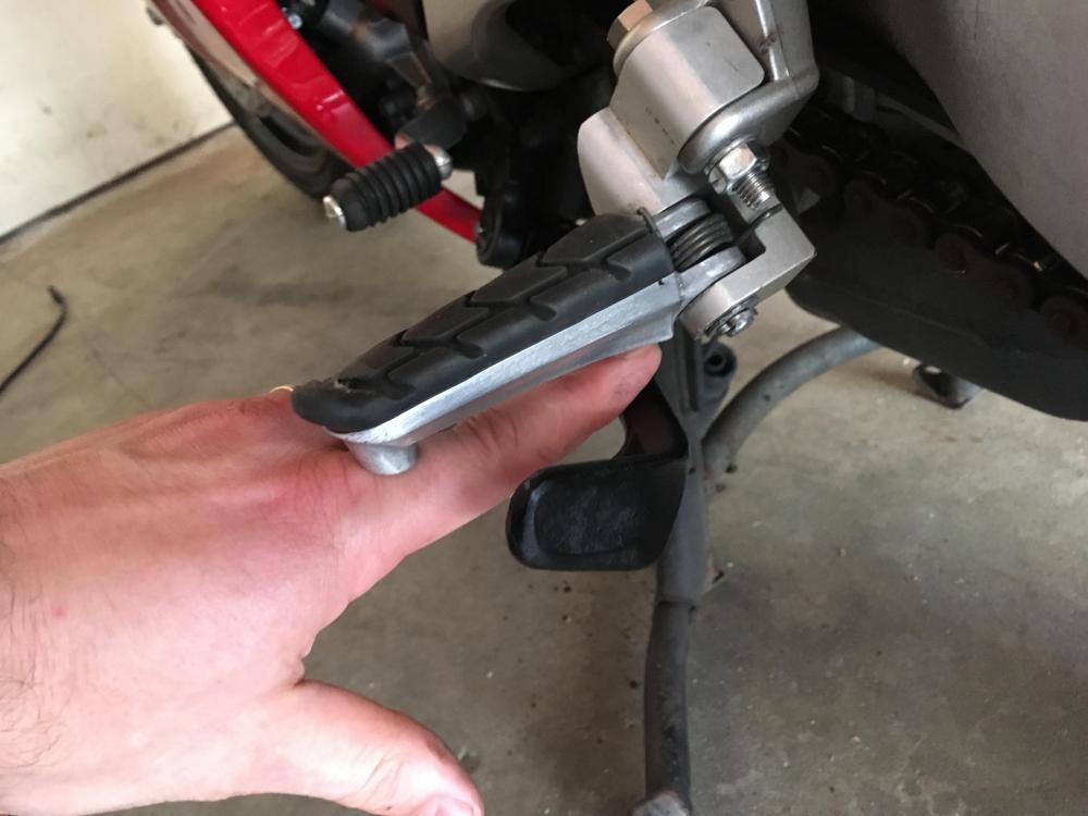

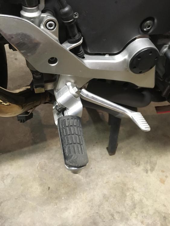

austinaw91 Posted July 31, 2019 Posted July 31, 2019 This thread has become very valuable as I just installed a used set of these blocks on my 01. I am going to put 6th gen pegs on it for more space for the kickstand and modify the kickstand to accomodate as seen here. I maxed out the rear brake adjustment and think it will be alright as it is barely used. Thanks! 1 Quote

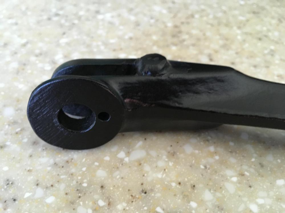

austinaw91 Posted August 1, 2019 Posted August 1, 2019 I have finished the kickstand modifications, as others have. Cut off the little foot and JB Weld-ed a small washer to keep the kickstand from going higher. Also installed 6th gen pegs becuase they are thinner. Right now I have just about 1 finger gap worth of space and it feels and looks good. 2 coats of Rustoleum satin black for finish. Can't wait to see how she rides! 1 Quote
