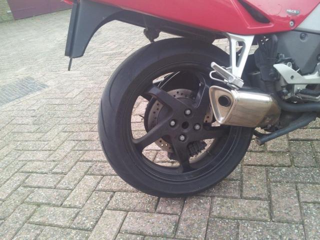

koekeroe Posted February 22, 2014 Share Posted February 22, 2014 made mine from a oem cb600 mufler i like short Quote Link to comment Share on other sites More sharing options...

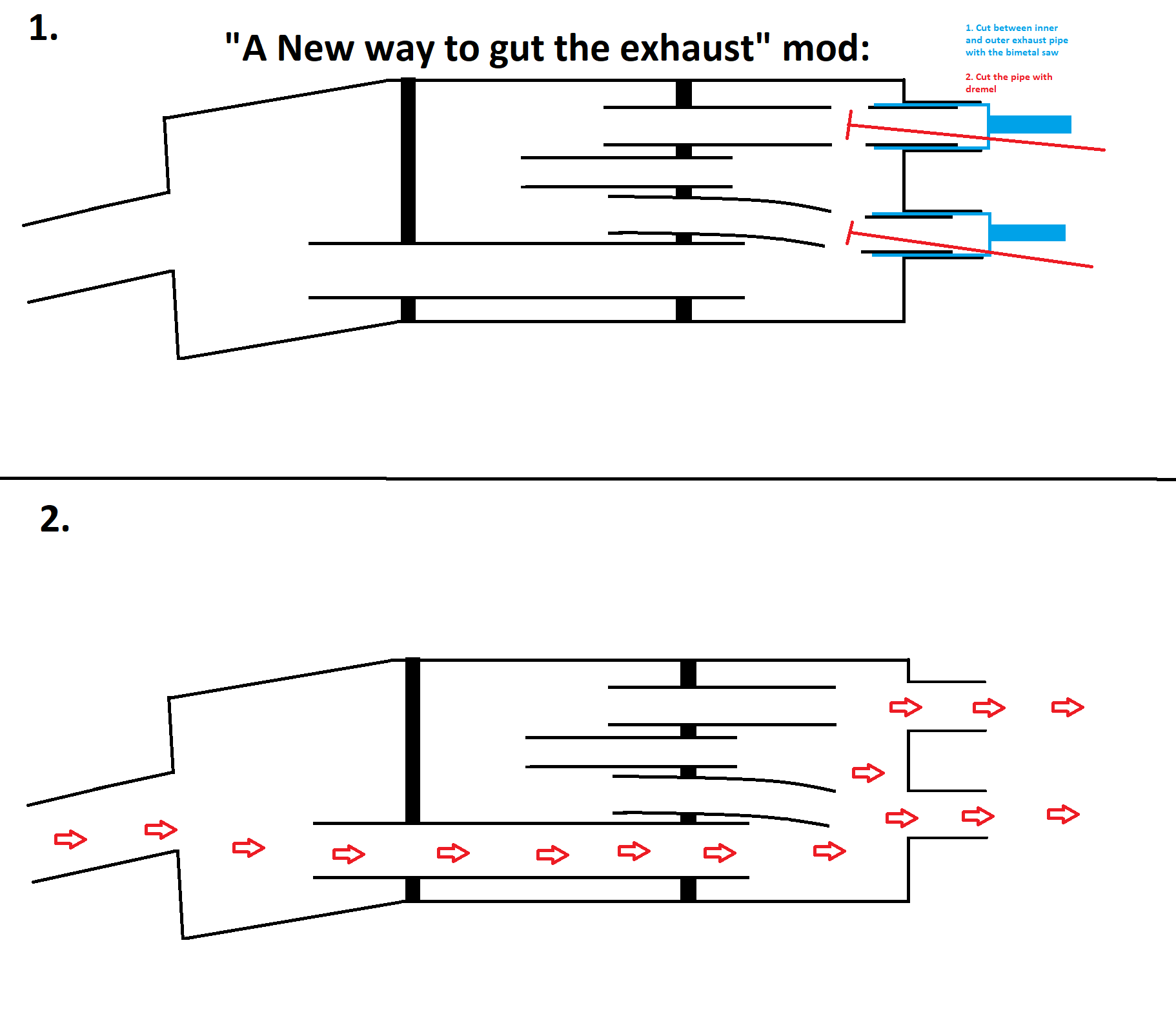

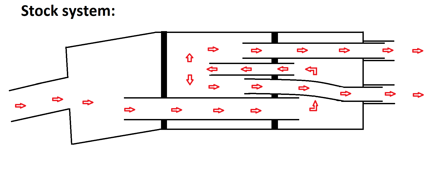

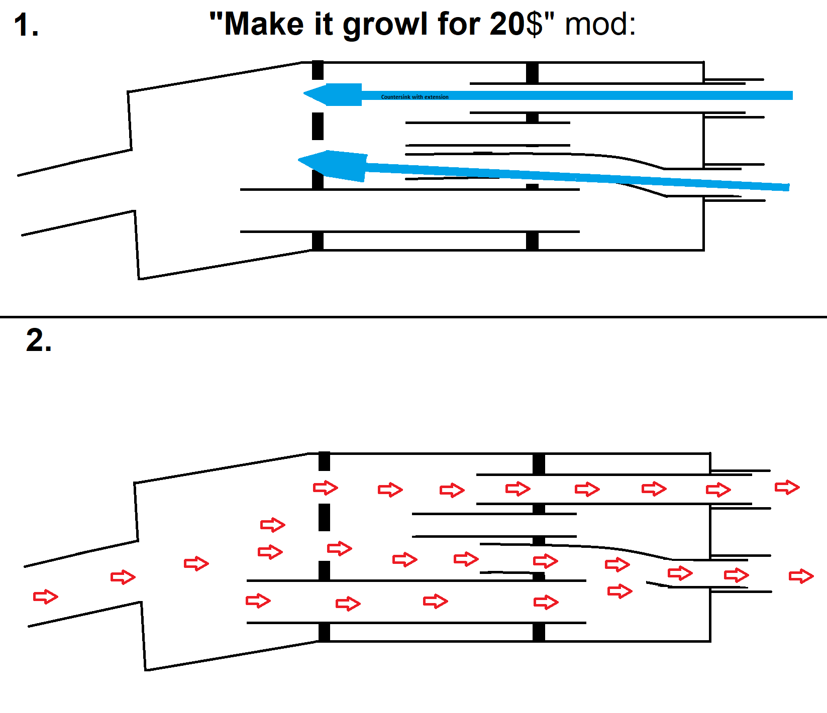

simo5555 Posted October 27, 2019 Share Posted October 27, 2019 I know this thread is super old, but i thought i might help someone. I did the simple drawing (using my sick paint skills, lol) showing both mods: The drilling and gutting. Please bare in mind that i haven´ t mod my exhaust yet so i can´t comment on the results. This is the stock exhaust flow:   If anyone can confirm the make it growl mod - do you drill straight through the bent pipe opening it up to the third chamber and drill the back wall through the hole in the pipe? Or do you force the drill bit to bore the pipe sleightly to make it easier for the bit to follow the bend leaving the pipe walls intact? I will drill mine at some point and try to make a comparison audio clips. The ones on this thread won´t work anymore. If anyone still has them - let us know. Hope they might help someone. Quote Link to comment Share on other sites More sharing options...

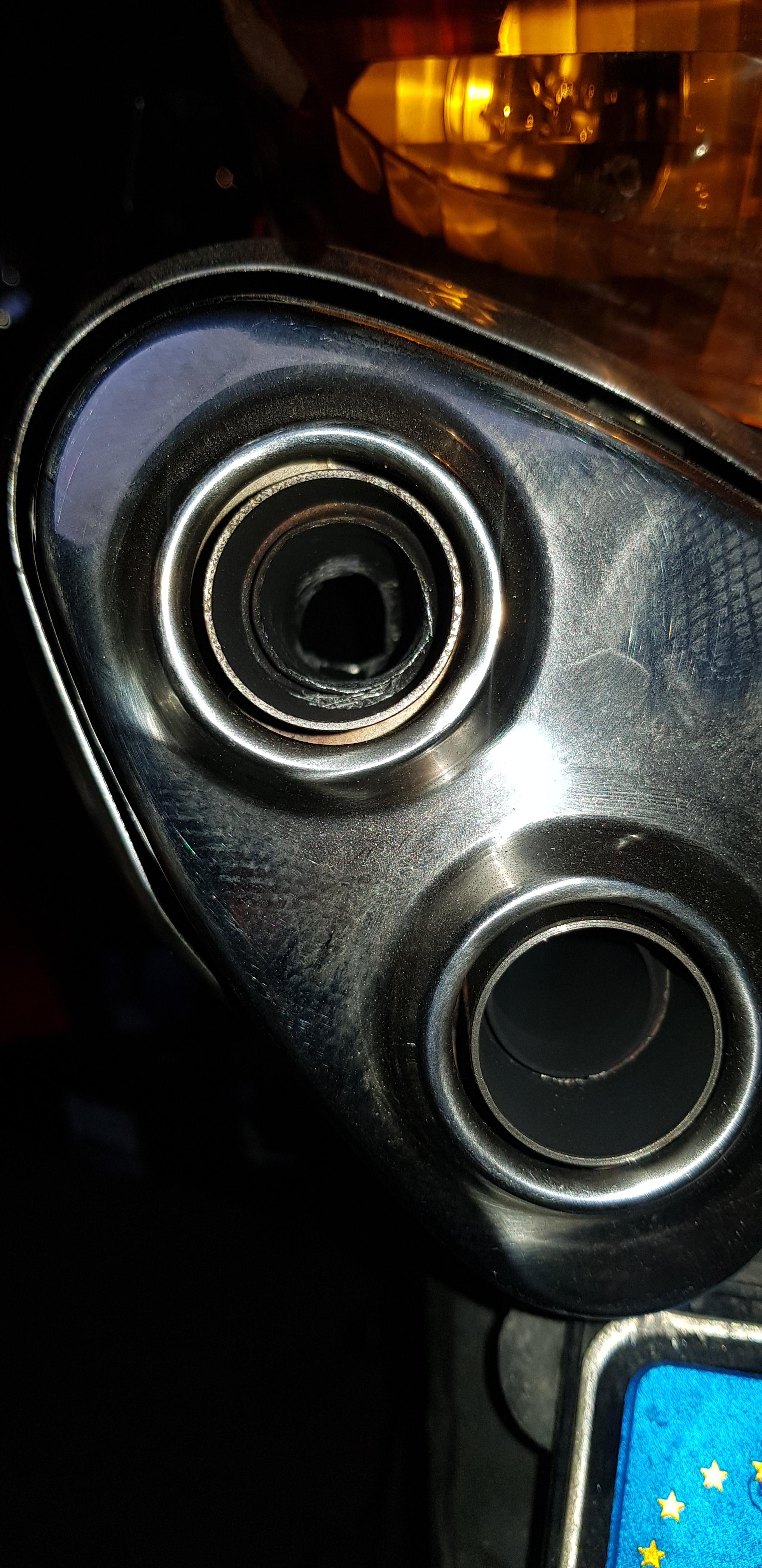

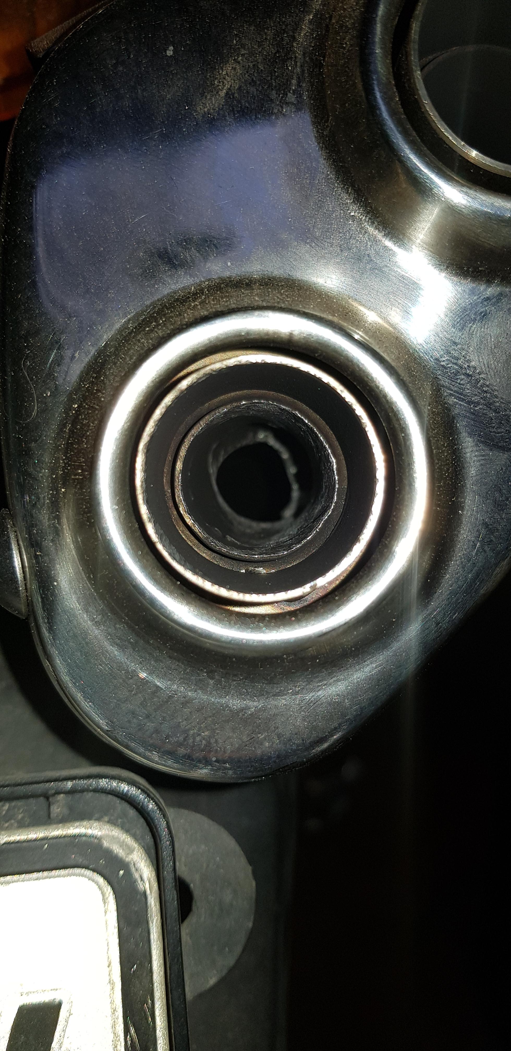

simo5555 Posted January 2, 2020 Share Posted January 2, 2020 So, i drilled out the bent pipes on my bike today. Sure was pretty pain in the a... to do it. I used a 16mm drill bit and heavy-duty drill. It now has a nice mellow growl on idle. Sounds really good. Its not any louder than the stock exhaust. It sounds similar to the arrow exhaust i had before. Im going to use a dremel later on to make the holes a bit cleaner. Just didnt have the time today. I didnt have the countersink so i left the straight pipes alone for now. And here's a video Don't know how well my S8 picks up the sound, but still. Its not a huge difference compared to the stock, but there's definitely a mellow growling on idle which wasn't there before. I didn't want really loud or throaty exhaust, just add some juice to the sound and that's exactly what i got. Firstly i'll clean up the holes and see how it sounds then. I might drill the rest of the pipes too. All in all, i'm really happy. Hope this info might help someone who's considering about doing it. Quote Link to comment Share on other sites More sharing options...
