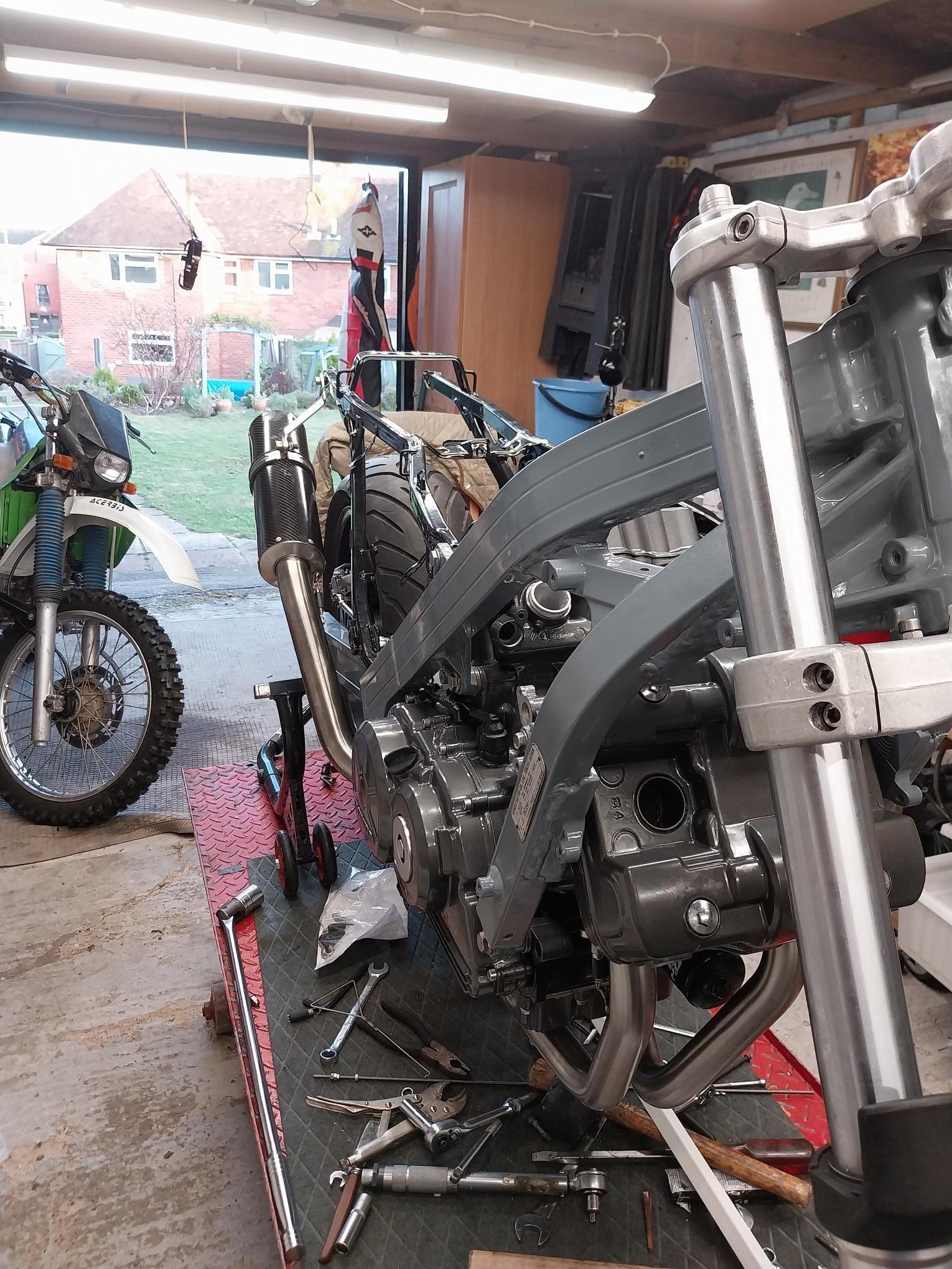

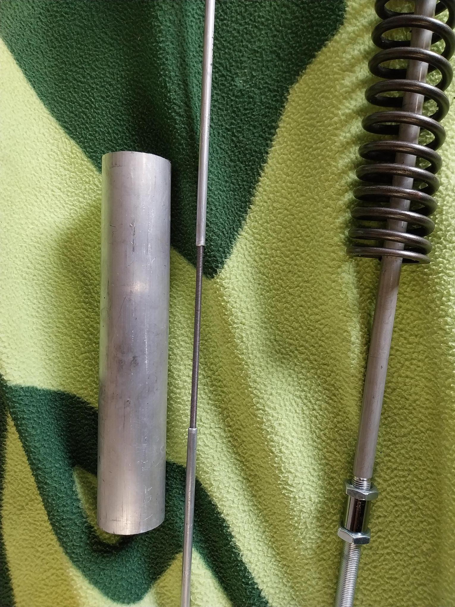

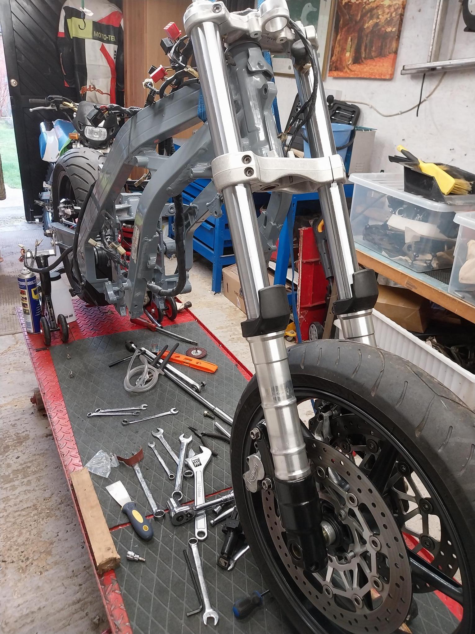

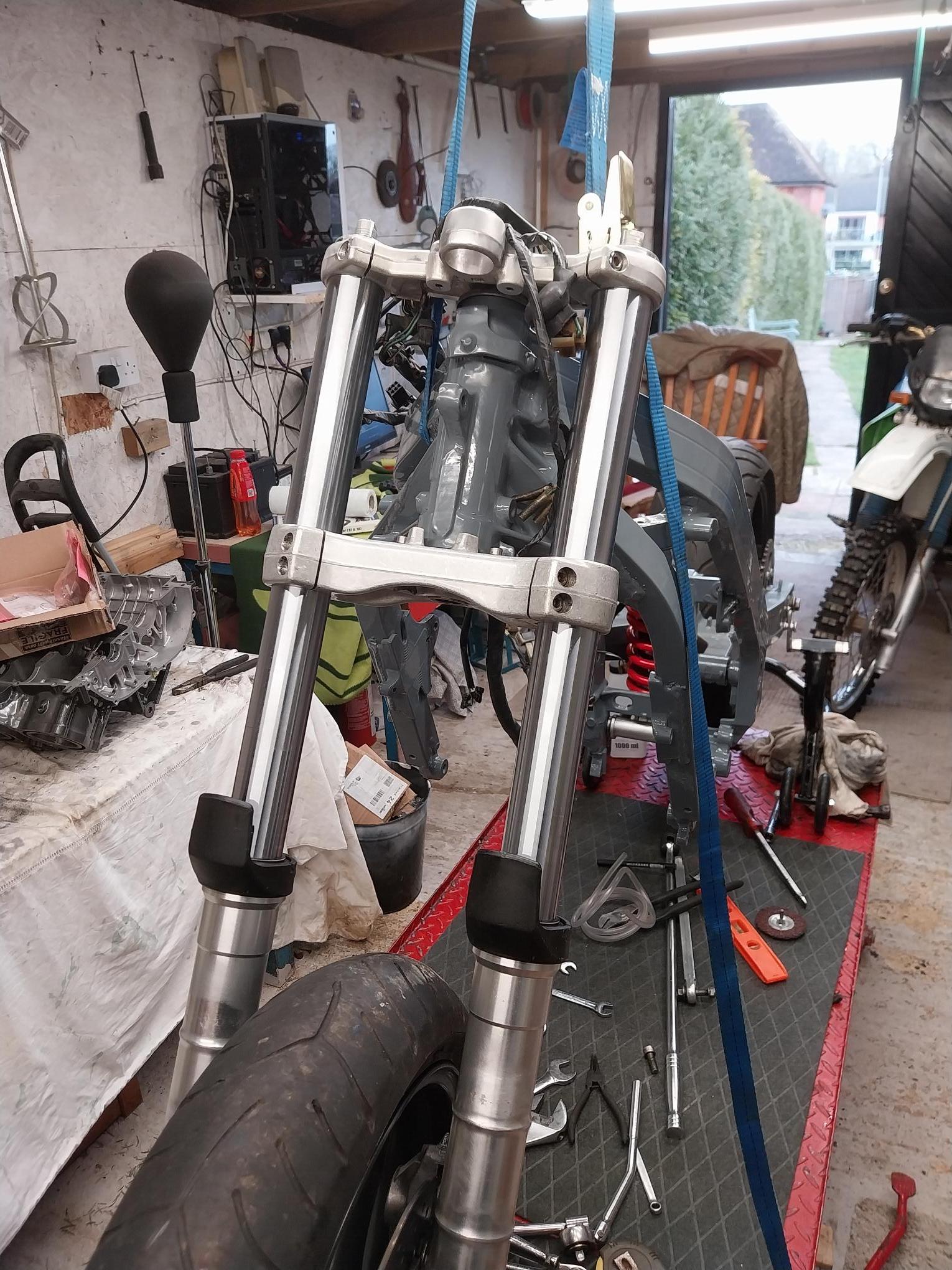

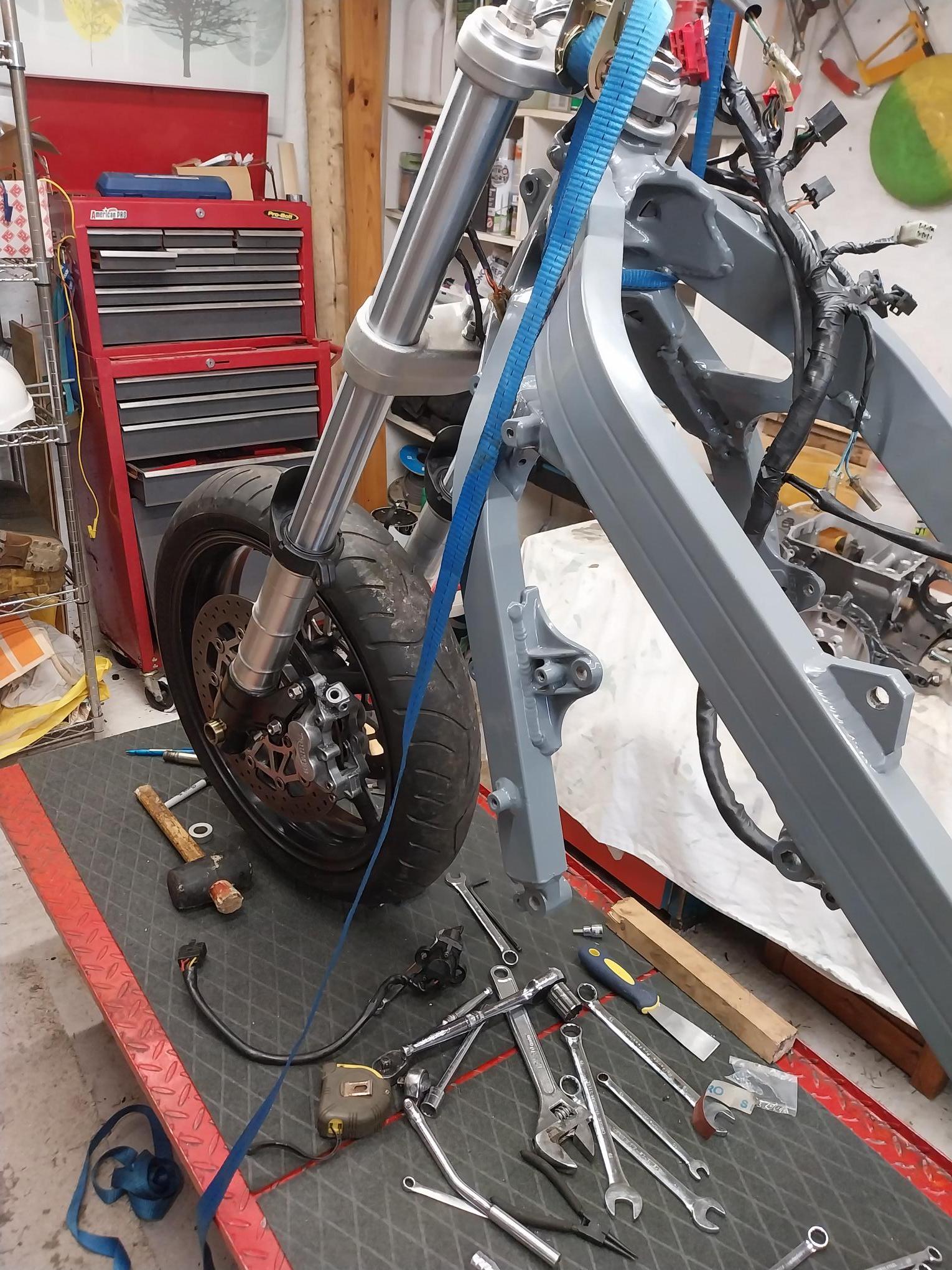

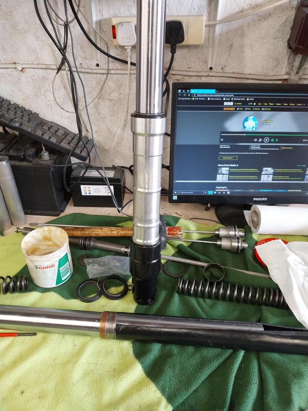

lastfleetadmiral Posted January 27, 2024 Author Posted January 27, 2024 Triumph forks now mounted with custom made tube's and modified internals to suit the extra length. These forks are nice and chunky 45mm with full preload, rebound and damping adjustment. Now if anyone has standard forks on a RC 24 in could do with the measurement from the bottom of the frame were the bottom yoke meets the frame to the center of the wheel spindle as i should have taken this measurement to aid setting up the new front end 5 Quote

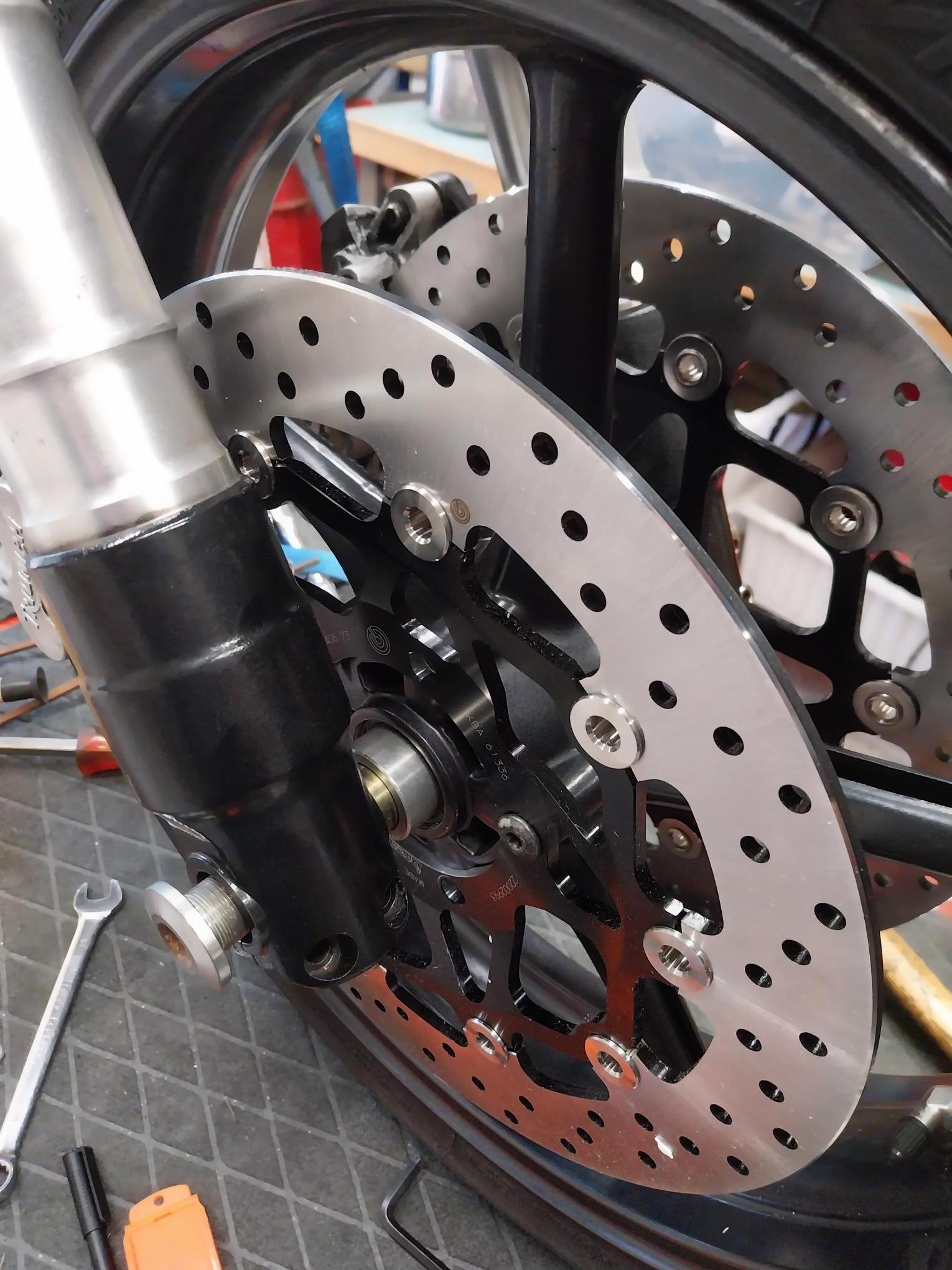

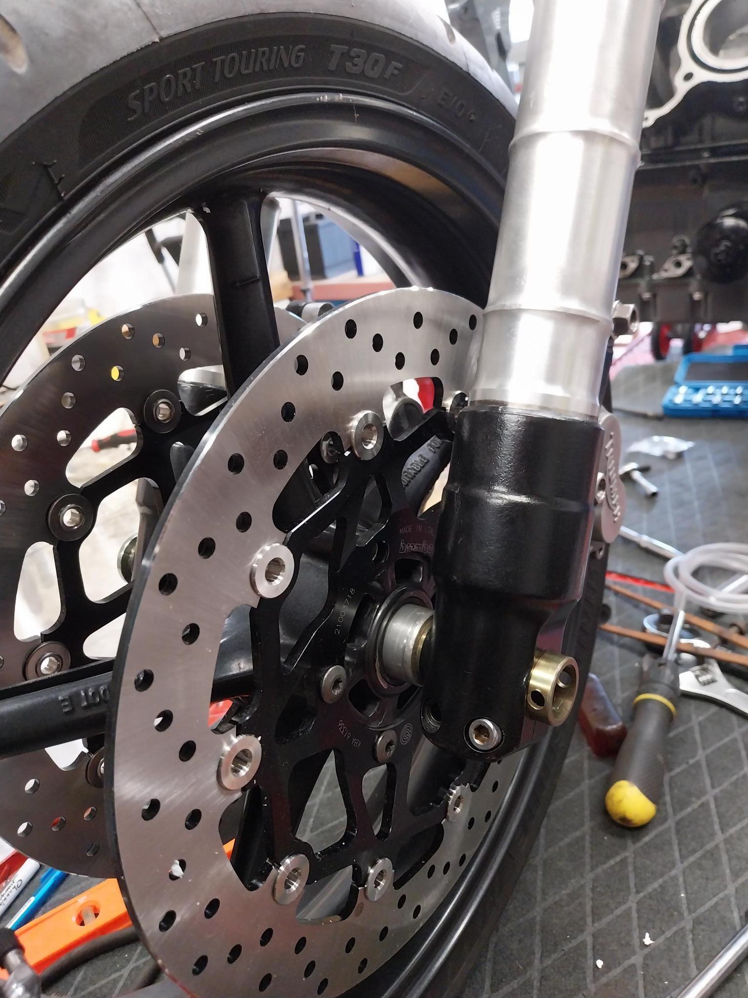

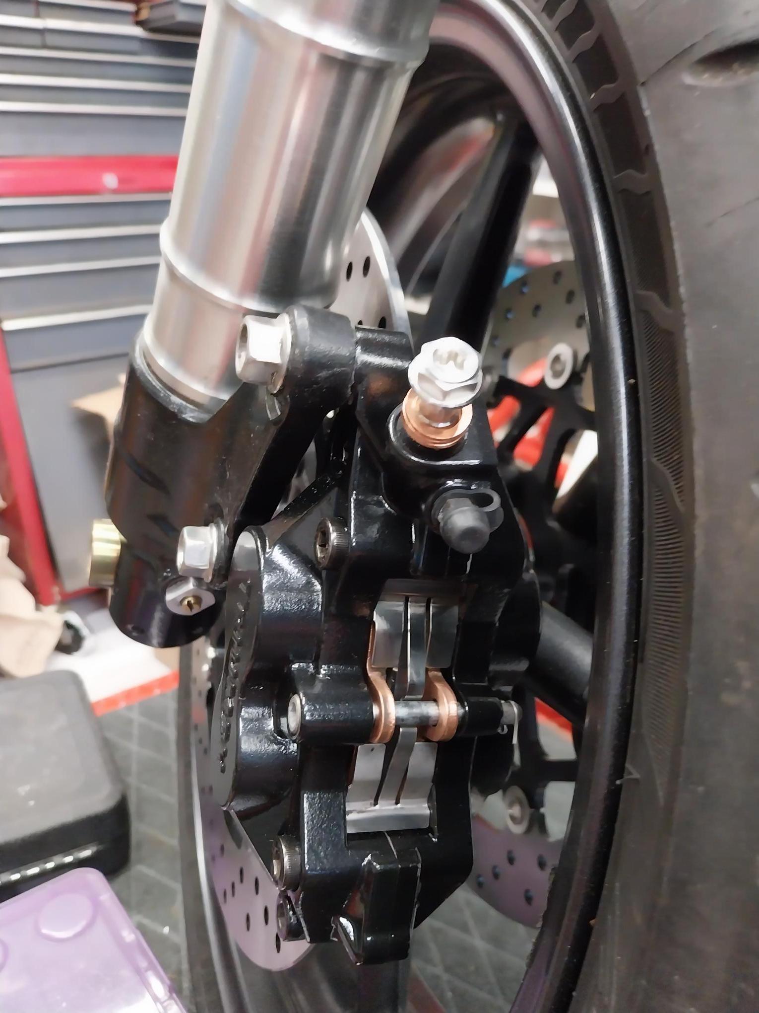

lastfleetadmiral Posted January 27, 2024 Author Posted January 27, 2024 The Triumph 675 wheel brake discs line up nicely with the calipers so no work needed there. I need to make a 28mm long spacer for the RH side of the front wheel (as your sat on the bike) as the T595 uses a speedo worm drive so no spacer this side and the 675 wheel does not. The T595 spacer on the RH side is 21mm long (it uses the spindle shaft to take up the other 7mm so i cant just use two of these (I'm putting on electronic instruments so no need for a speedo worm drive. Everything needs tweaking when putting none standard kit on anything so everything takes time. Quote

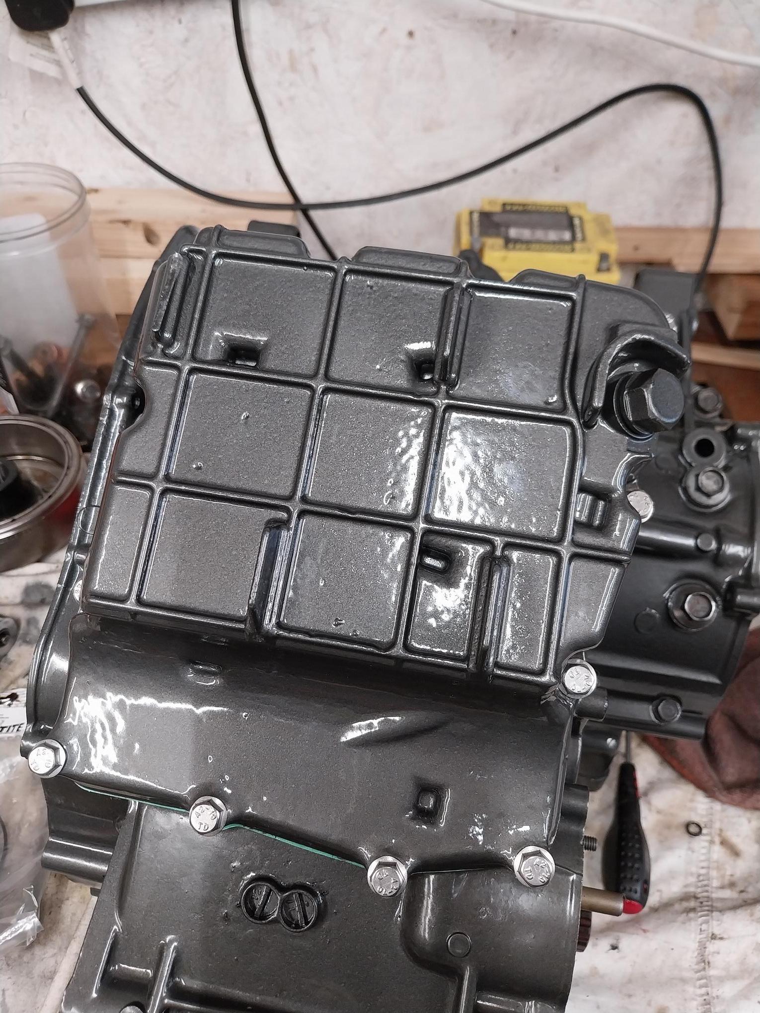

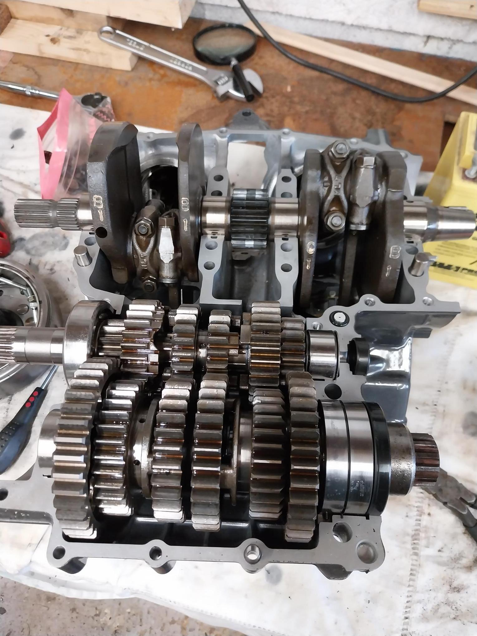

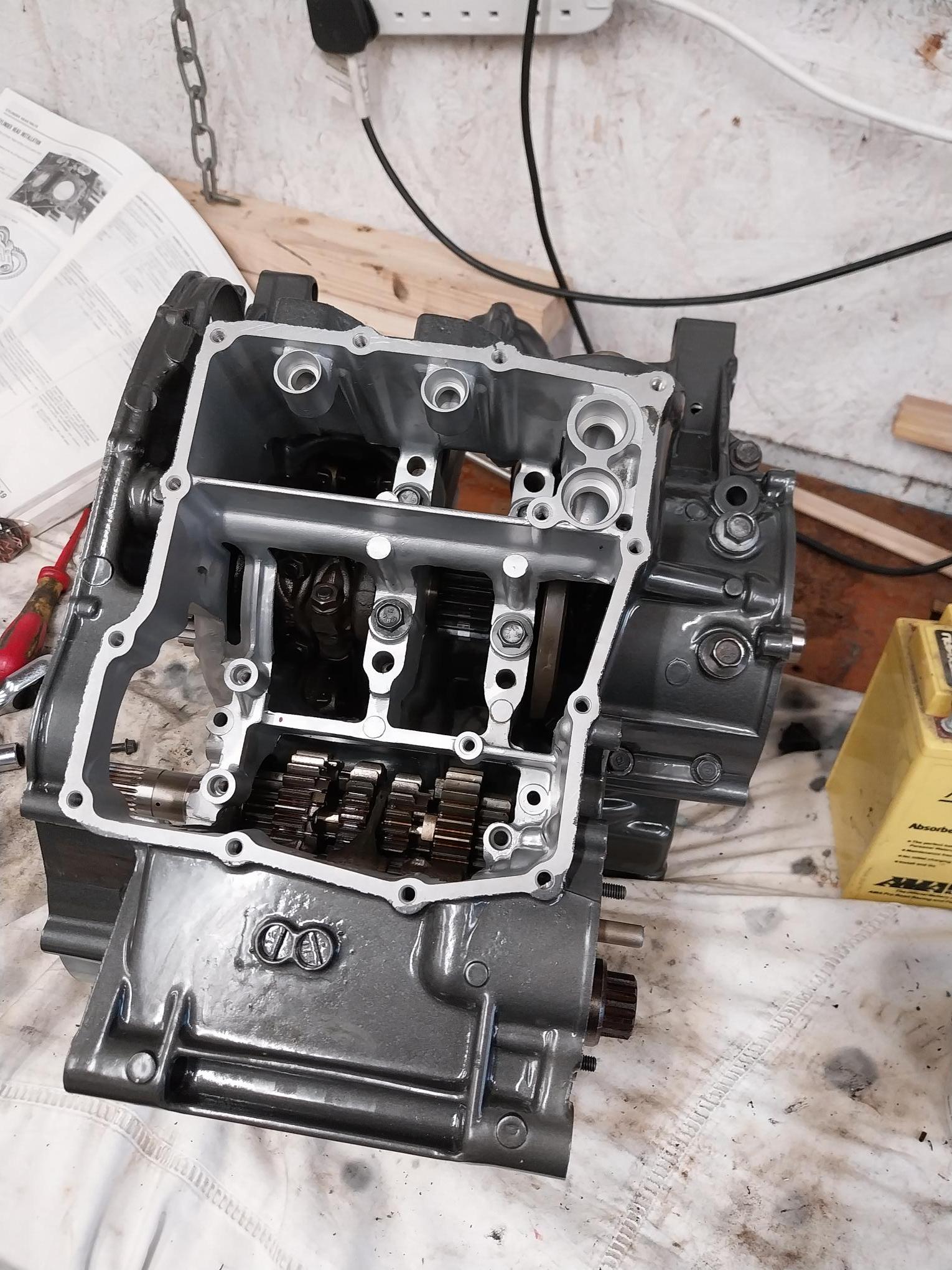

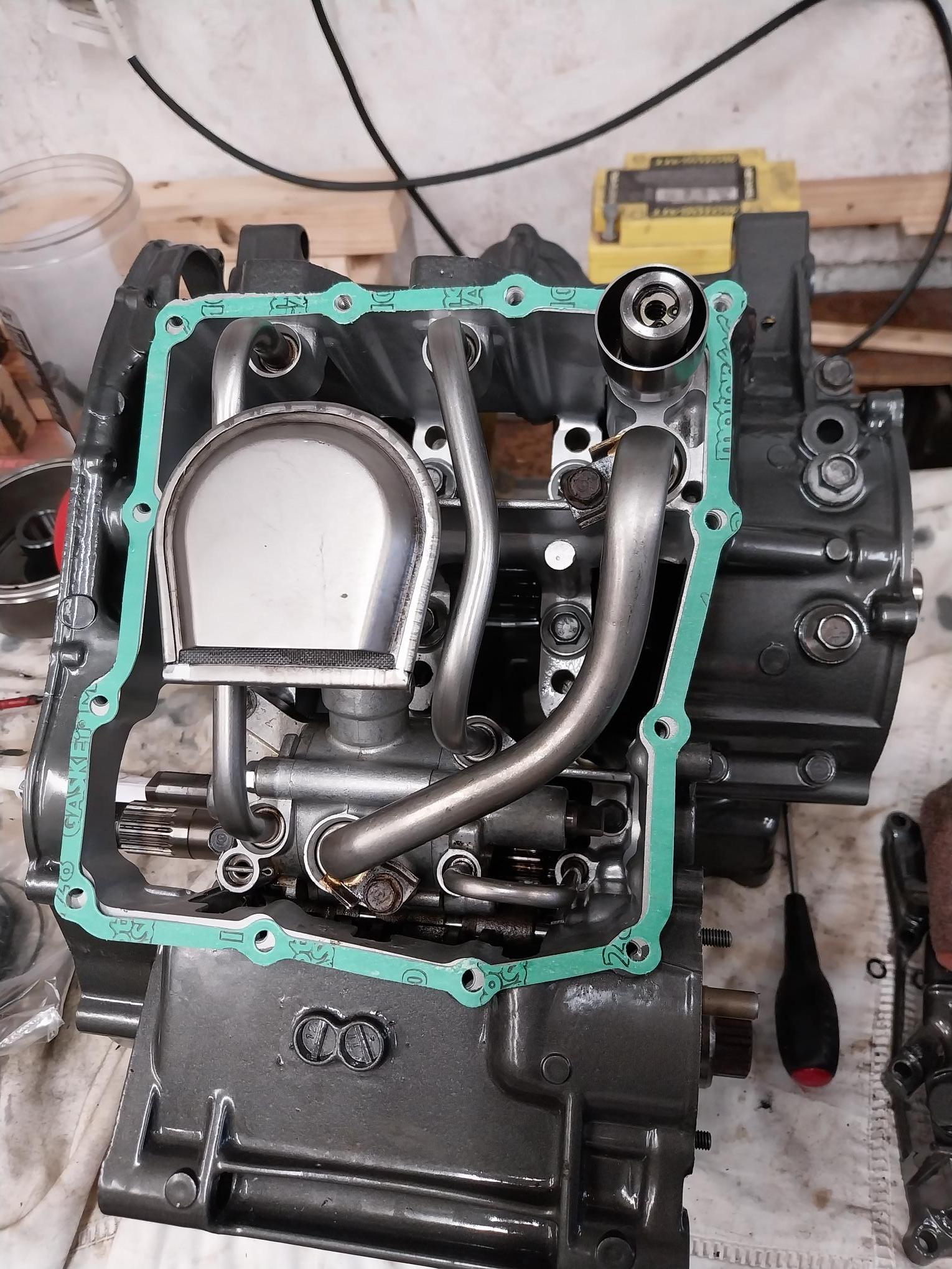

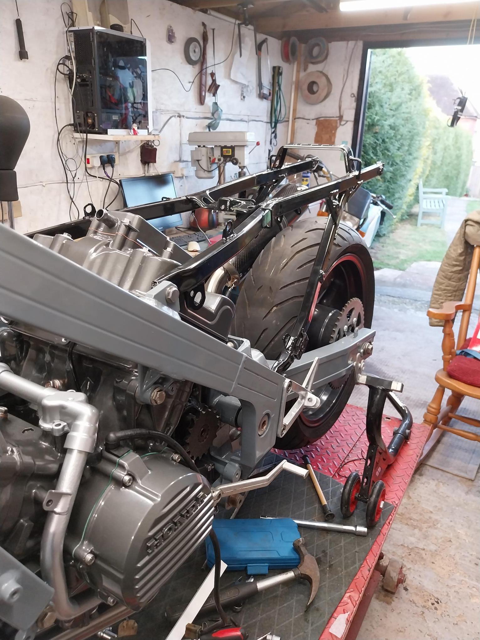

lastfleetadmiral Posted February 3, 2024 Author Posted February 3, 2024 Been busy today. I have built the short engine and mounted in in the frame. The gearchange Mechanism is a POS. and i wasted over 90 minutes trying to get the spring paw together and working all to no avail. Will look at it again tomorrow to see why i cant seem to make it work. Some pictures below showing todays activity 1 Quote

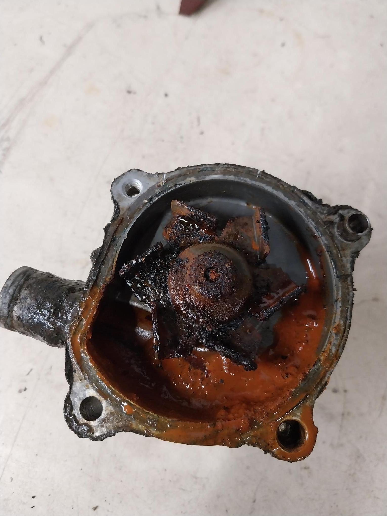

lastfleetadmiral Posted February 11, 2024 Author Posted February 11, 2024 A bit more done yesterday. More of the engine assembled. Water pump is a mess and will take time to clean up. I have had to get new front discs are the 675 ones are 310mm and the T595 320mm. Lucky there is a kit for the 675 to upgrade the discs to 320mm so its a straight forward purchase but a lot of money. Still a couple of Brembo Discs mated to the 4 pot calipers should make it brake with vigor 🙂 2 Quote

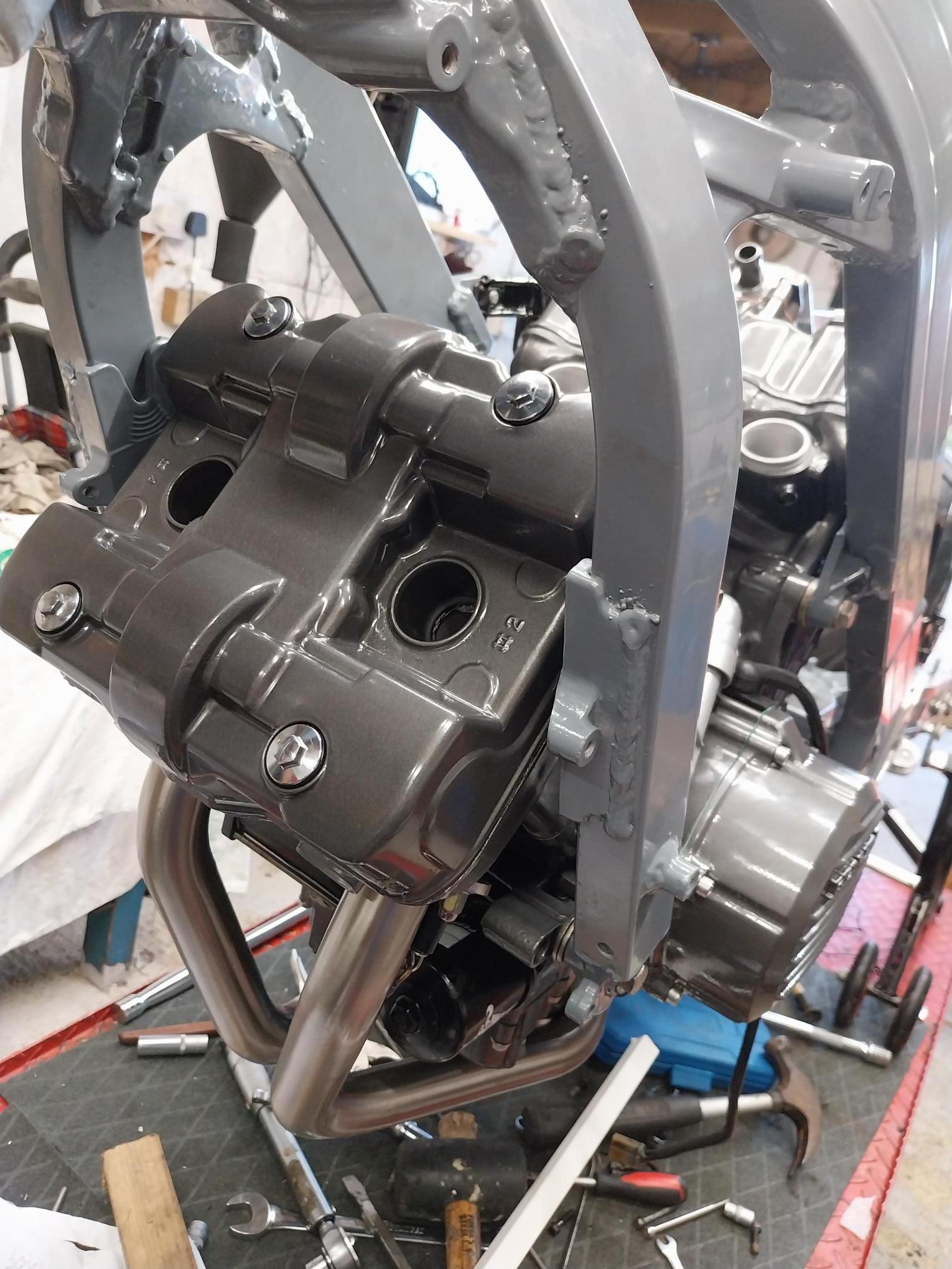

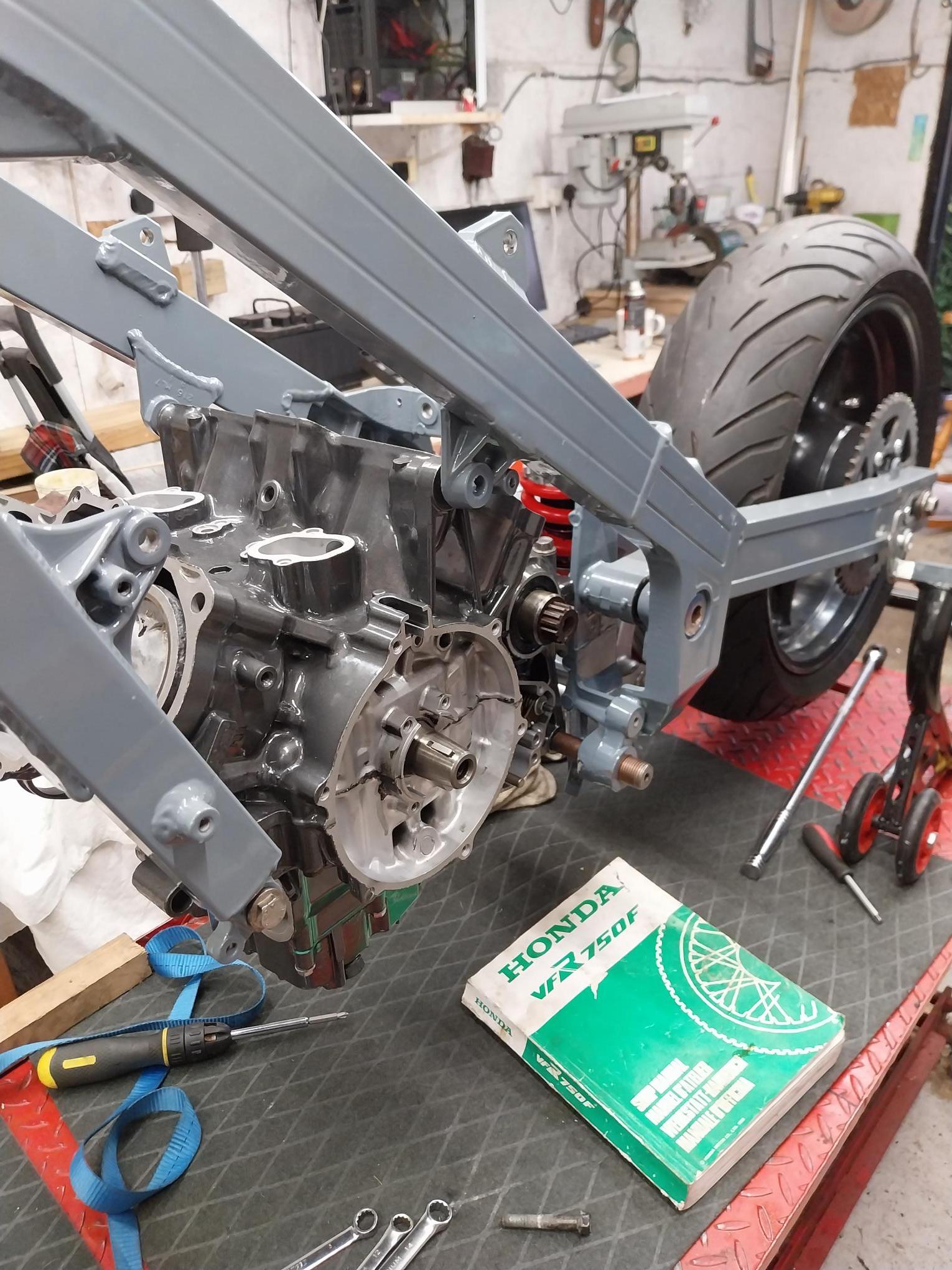

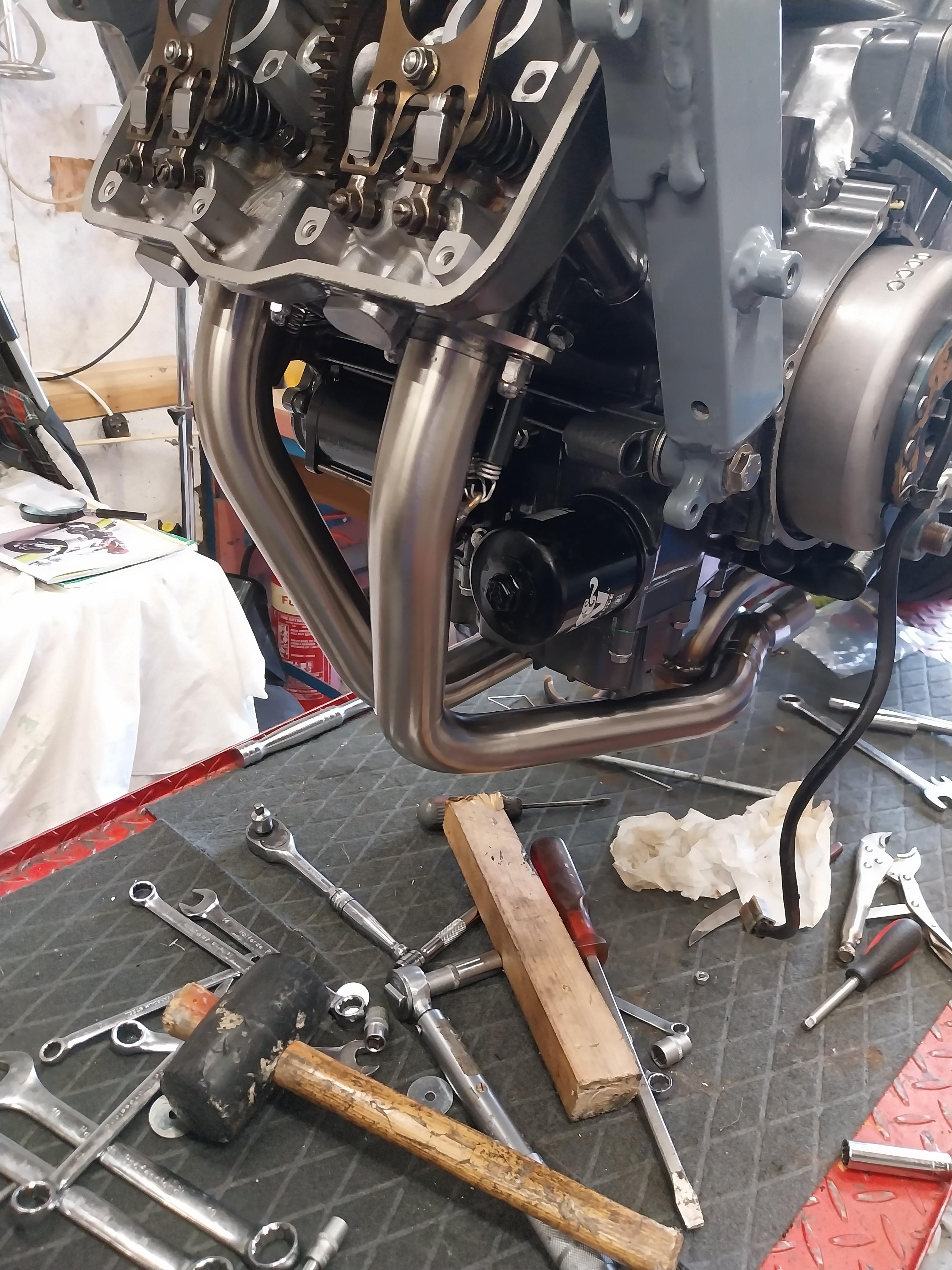

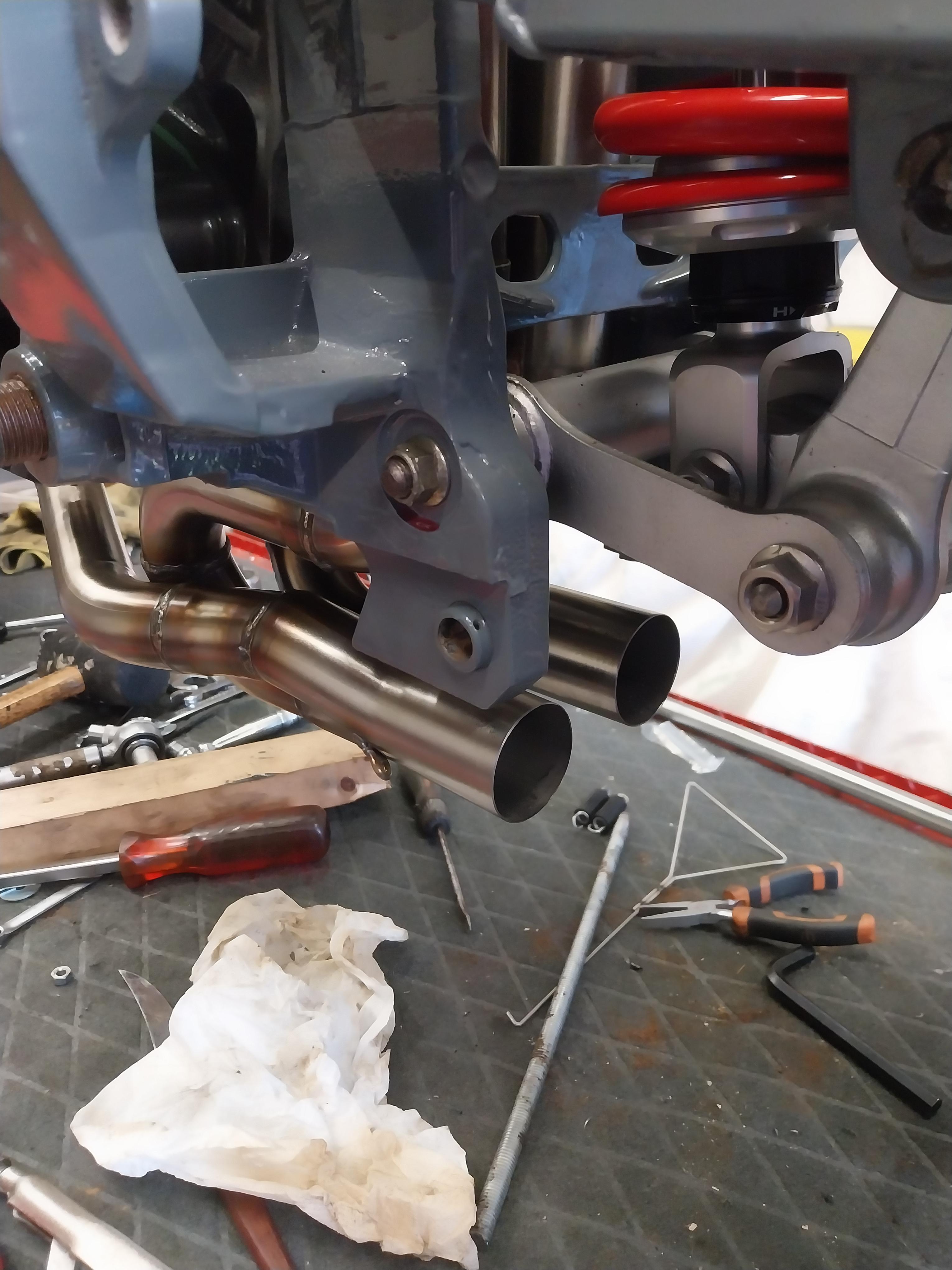

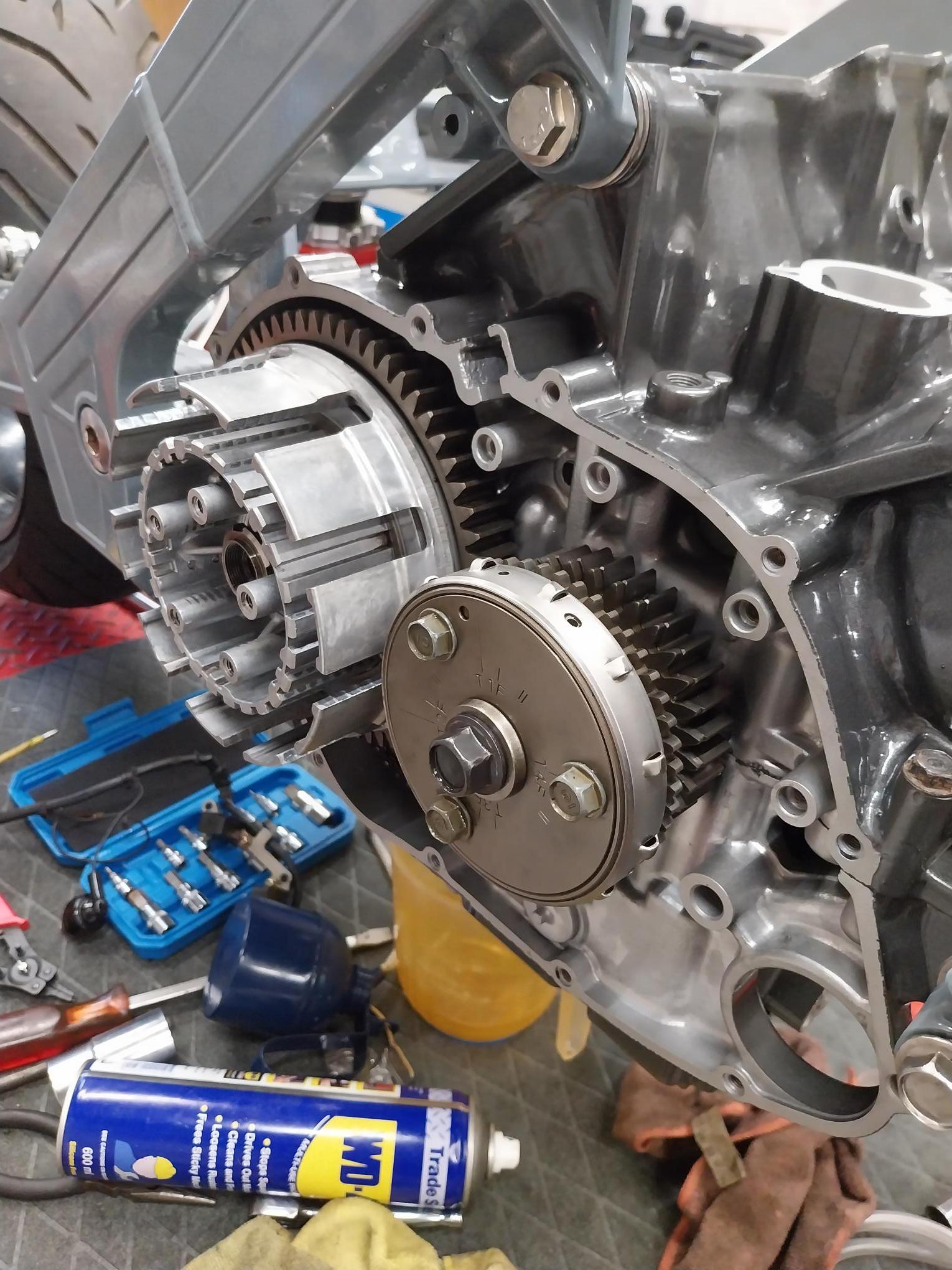

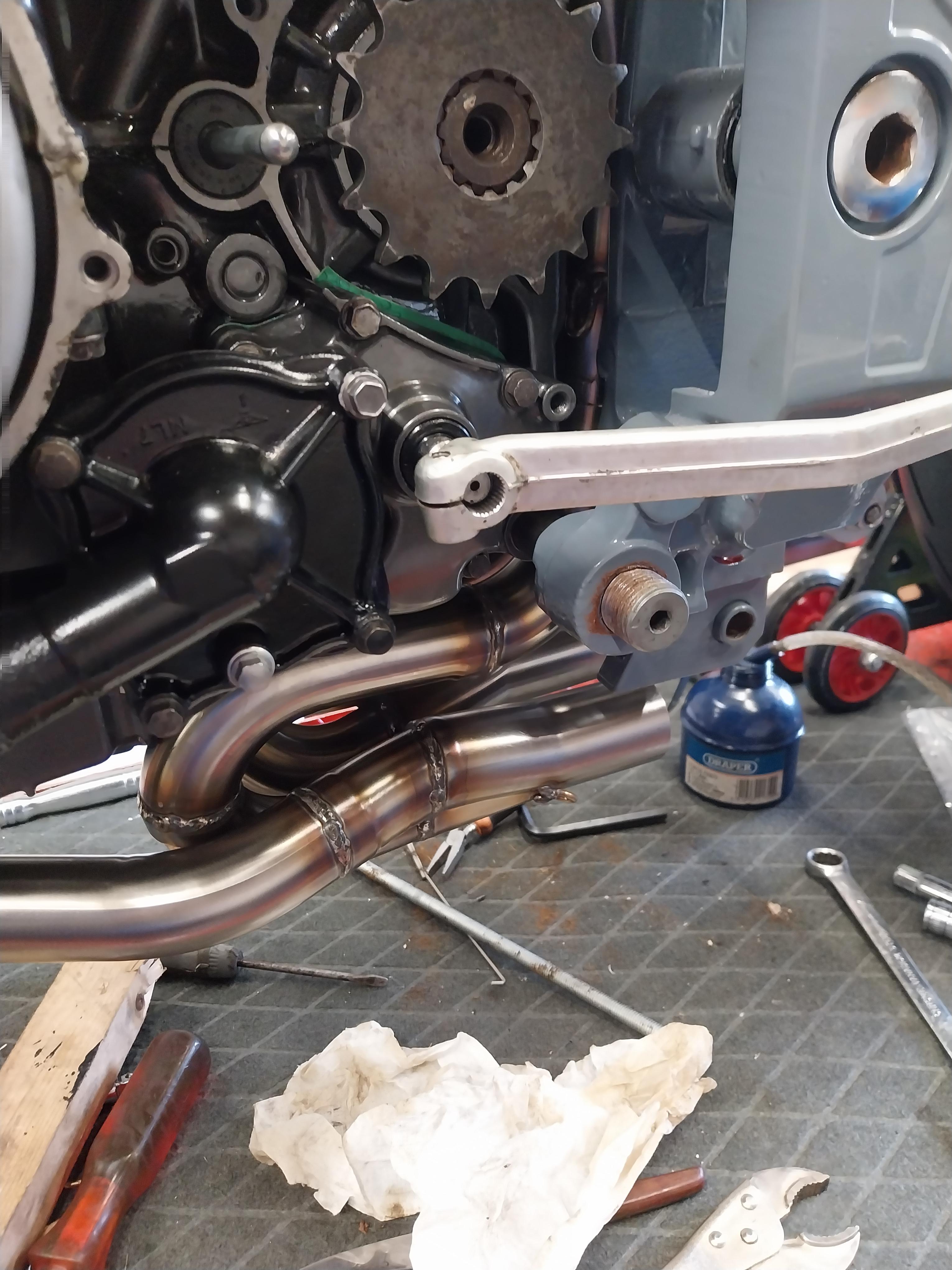

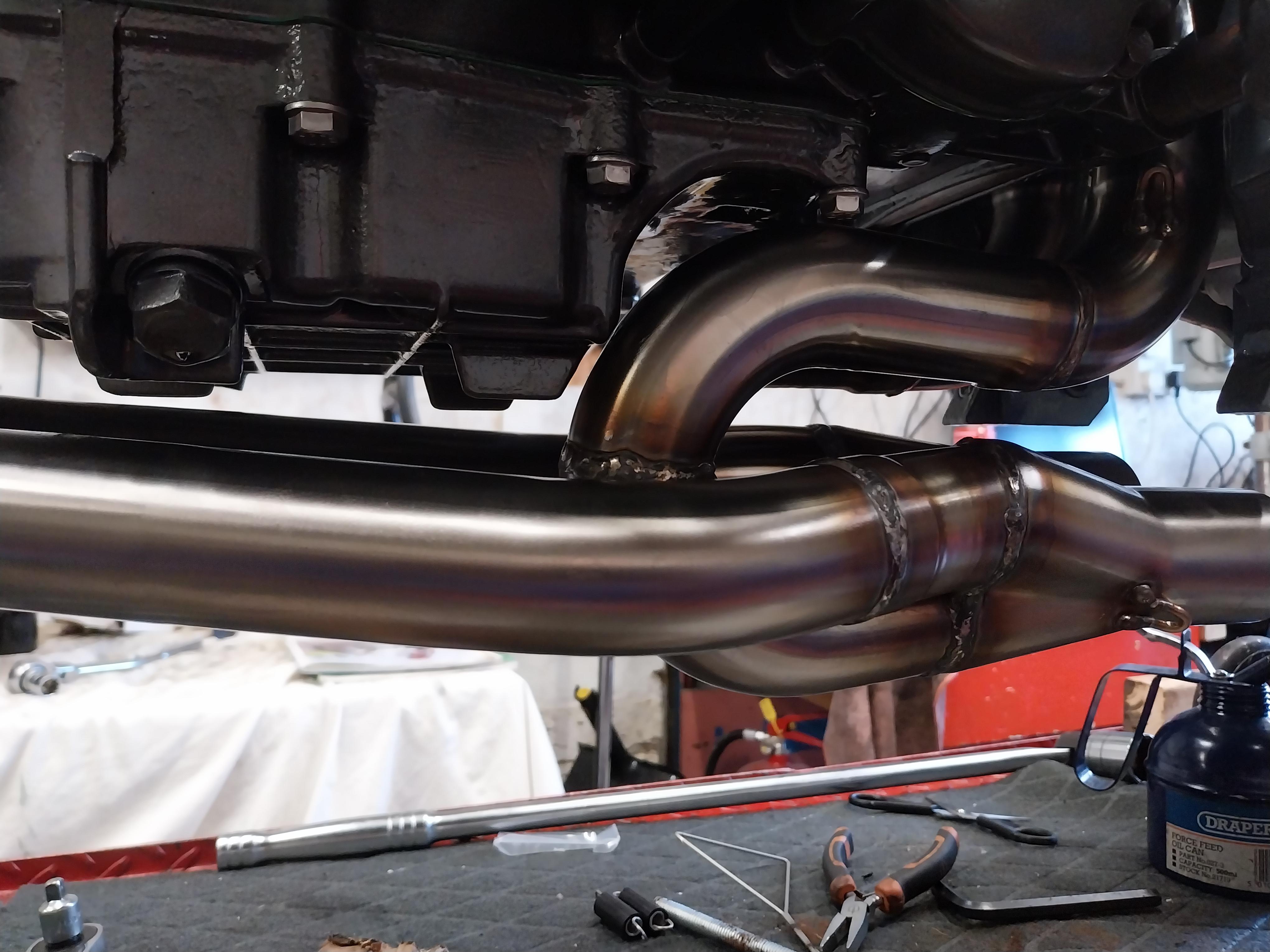

lastfleetadmiral Posted March 3, 2024 Author Posted March 3, 2024 A bit more done today. New clutch plates fitted with heavy duty springs. Cylinder heads fitted and the new exhaust headers attached. Rear headers a bit of a pig to get in, I has to put a jack under the engine and remove the top shock mounting bolt to get enough clearance to get the rear headers in place. one of the original exhaust studs I had to drill out but managed to tap 7mm and put in a 7mm to 6mm stepped stud. Next part of the build will to be attach the cams and get the timing sorted before the clutch cover goes on. At this point i will loop the oil cooler inlet and outlet so i can fill the engine with oil and spinning the starter motor check the oil pressure and gear selection before moving forward. Talking of gear selection the selector detent mechanism is a terrible design, I note changed on the 88/89 models to a better set up but not backward compatible. My detent spring is well past its best, they are only £2 but are obsolete stock so while i do have one on order with Dave Silver Spares I'm not sure i will recive it. Quote

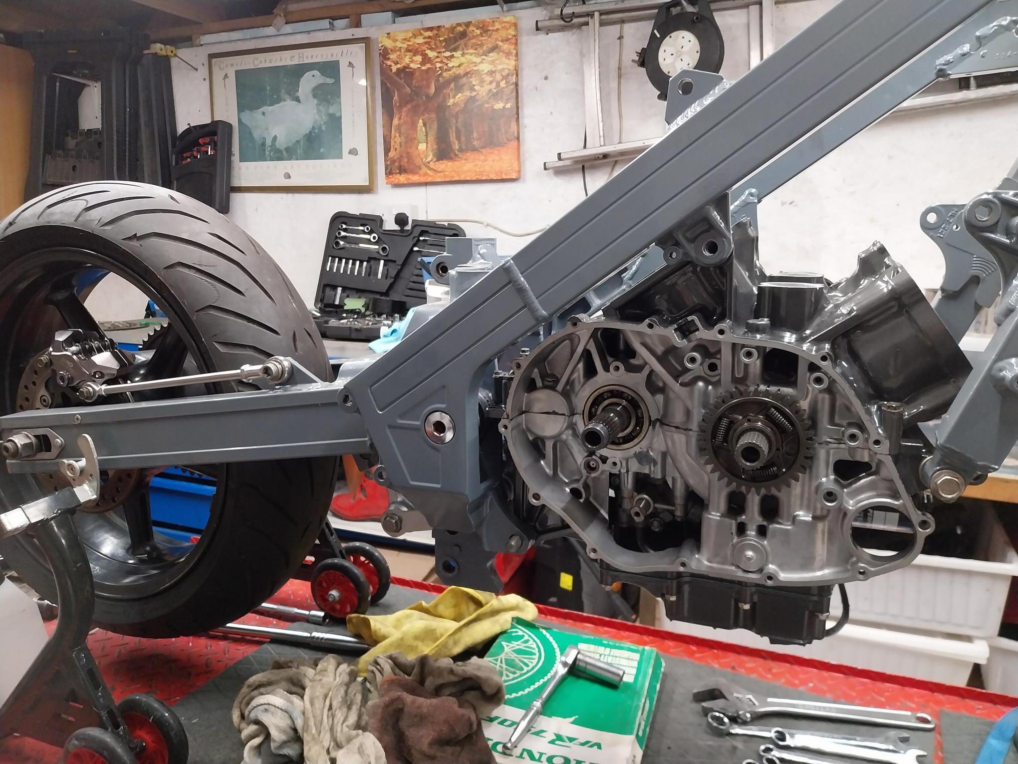

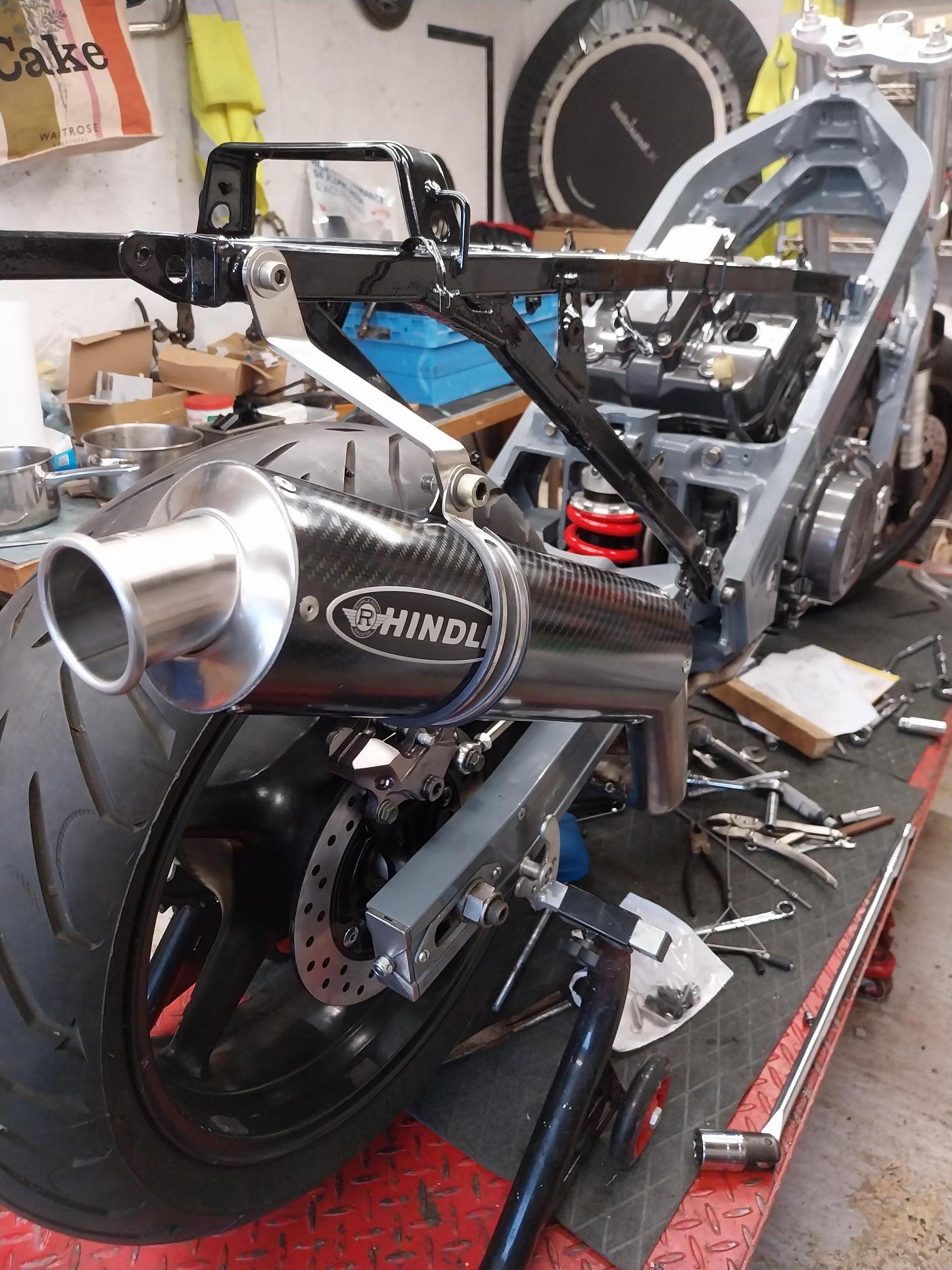

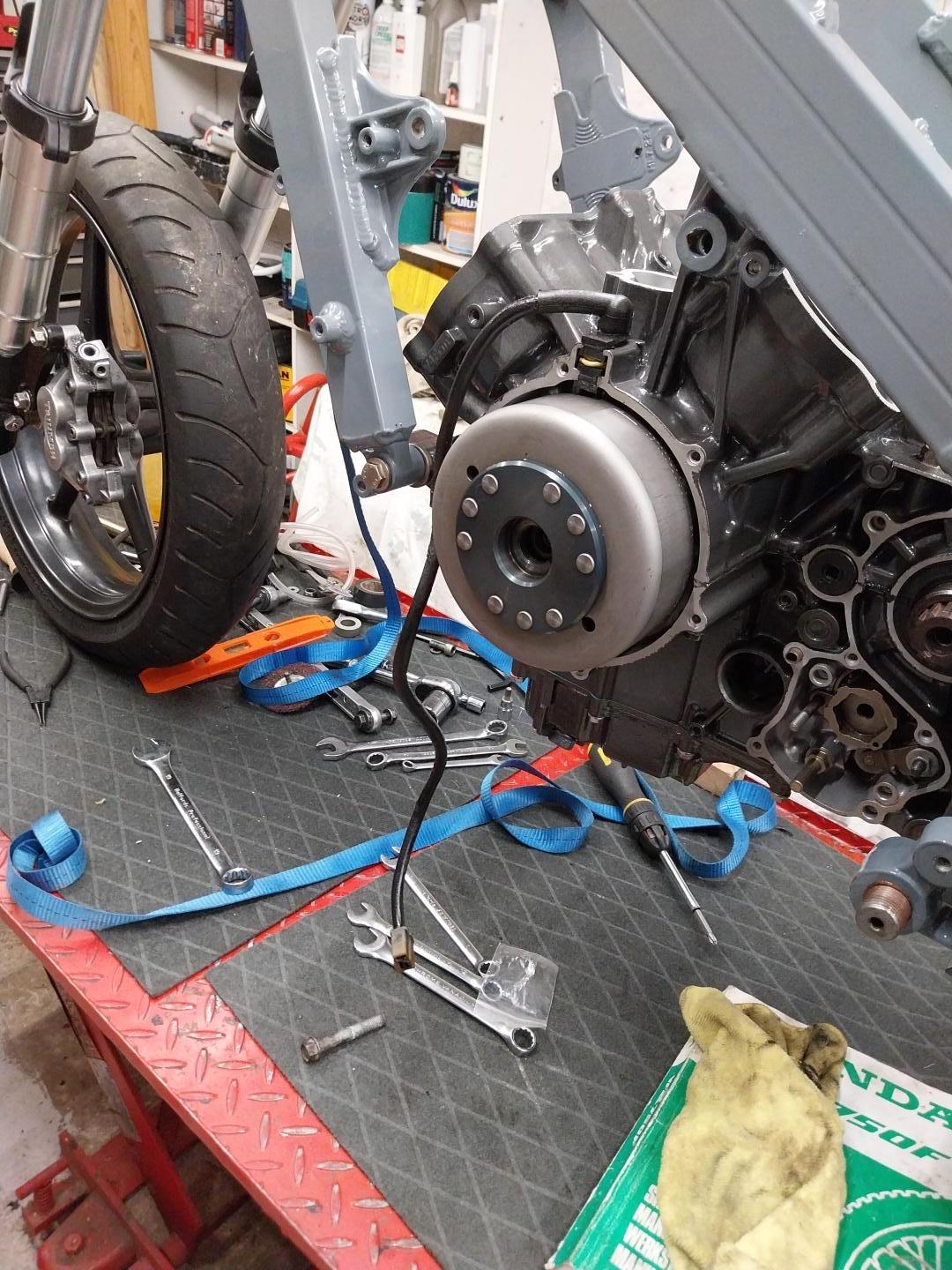

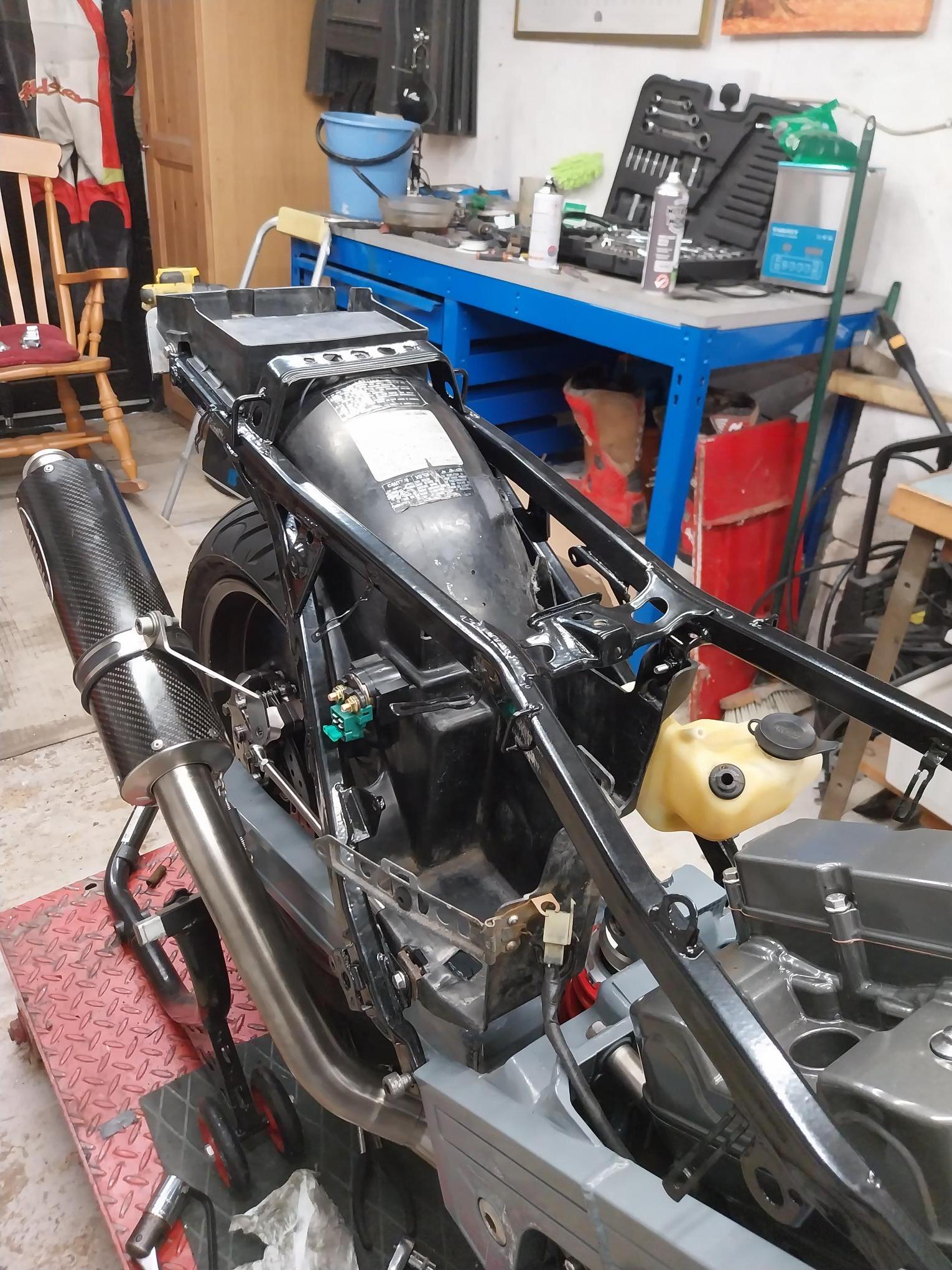

lastfleetadmiral Posted March 24, 2024 Author Posted March 24, 2024 A bit more completed today. The Engine is now fully built and timed up. Just waiting on fitting the oil cooler to spin it over on the starter motor with no spark plugs in to check oil pressure. Rear sub frame has been loosely mounted along with the rest of the exhaust. Big shout out to Gave Silver Spares who accepted an order for the gearchange detent spring an item they did not have in stock and listed as "No Longer Available" that the sourced and got to me in two weeks for £5.00 including postage. This was a show stopper as the old spring was so week that it was failing to push the paws home and so not changing gear smoothly. A Few more pictures of progress 3 Quote

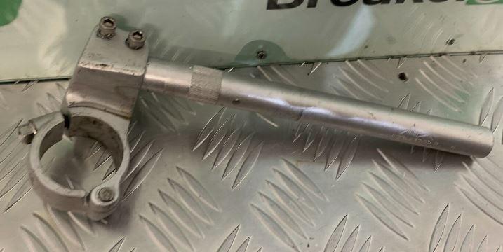

Member Contributer Captain 80s Posted March 24, 2024 Member Contributer Posted March 24, 2024 Whats the plan for handlebars? Quote

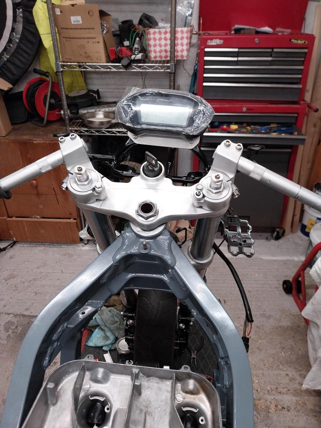

lastfleetadmiral Posted March 24, 2024 Author Posted March 24, 2024 Triumph T595 Handle bars. They mount under the top yoke but then rise above so will sit about 50mm lower than the Honda Bars. You can get a riser kit for the triumph bars that would get them very close to the Honda Height 1 Quote
Member Contributer Captain 80s Posted March 24, 2024 Member Contributer Posted March 24, 2024 Those are cool bars, love the hinge. Quote

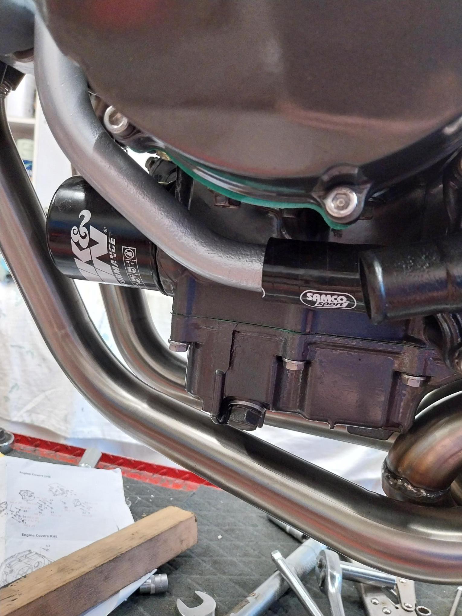

mello dude Posted March 24, 2024 Posted March 24, 2024 Hey looking great! Dude, those K&N filters with the welded nut on the end have a history of metal fatigue at the spot weld and cracking, then leaking. There's plenty of info on the net about it, and I am sure some members here have experienced it first hand. Plz consider an alternate. 1 1 Quote

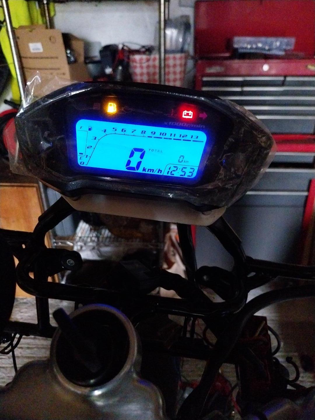

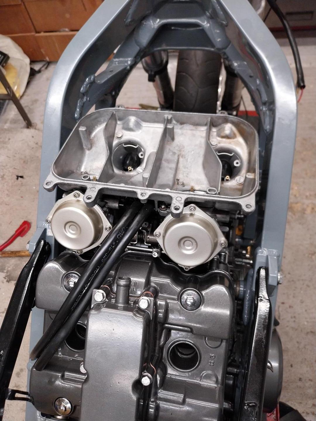

lastfleetadmiral Posted March 31, 2024 Author Posted March 31, 2024 Got the carbs fitted and the new instruments in place along with the rear mudguard assembly. Now comes the hard part of wiring everything up. I need new oil cooler hoses as the ones that came with the bike have numerous pin holes in them that got exposed once the rust was removed. Part of me is thinking of bypassing the oil cooler as for £35 there is a bypass pipe available on line, however my gut tells me to retain the cooler and make new pipes as i very much doubt any 35 year old used hoses will be much better than the ones i have. Getting the carbs back on was simpler than i expected no doubt helped by the fact I replaced the rock hard original runner stubs with new ones. Can any one help with a measurement of the distance from the front wheel spindle to the underside of the bottom yoke. It needs measuring with the front wheel of the ground and no load 1 Quote
lastfleetadmiral Posted April 4, 2024 Author Posted April 4, 2024 Instruments now powered up. Need to mount the magnets into the RH front disc bobbins so the sensor can pick up the rotation but its not going to be difficult. My biggest current pain is the oil cooler pipes that are completely shot. I need to find a solution to this that doesn't cost the earth and replaces with new items as every second hand set i have thus seen are understandably little better than the ones i have currently. Sometimes its easy to forget these bikes are approaching 40 years old. Now for a bit of a plug. I've just finished reading Matt Oxley book "Racing Hitler" If you don't know Matt he's a long Standing Motorcyclist Author. Its a great read about the quest for the Motorcycle speed record between the wars 2 Quote

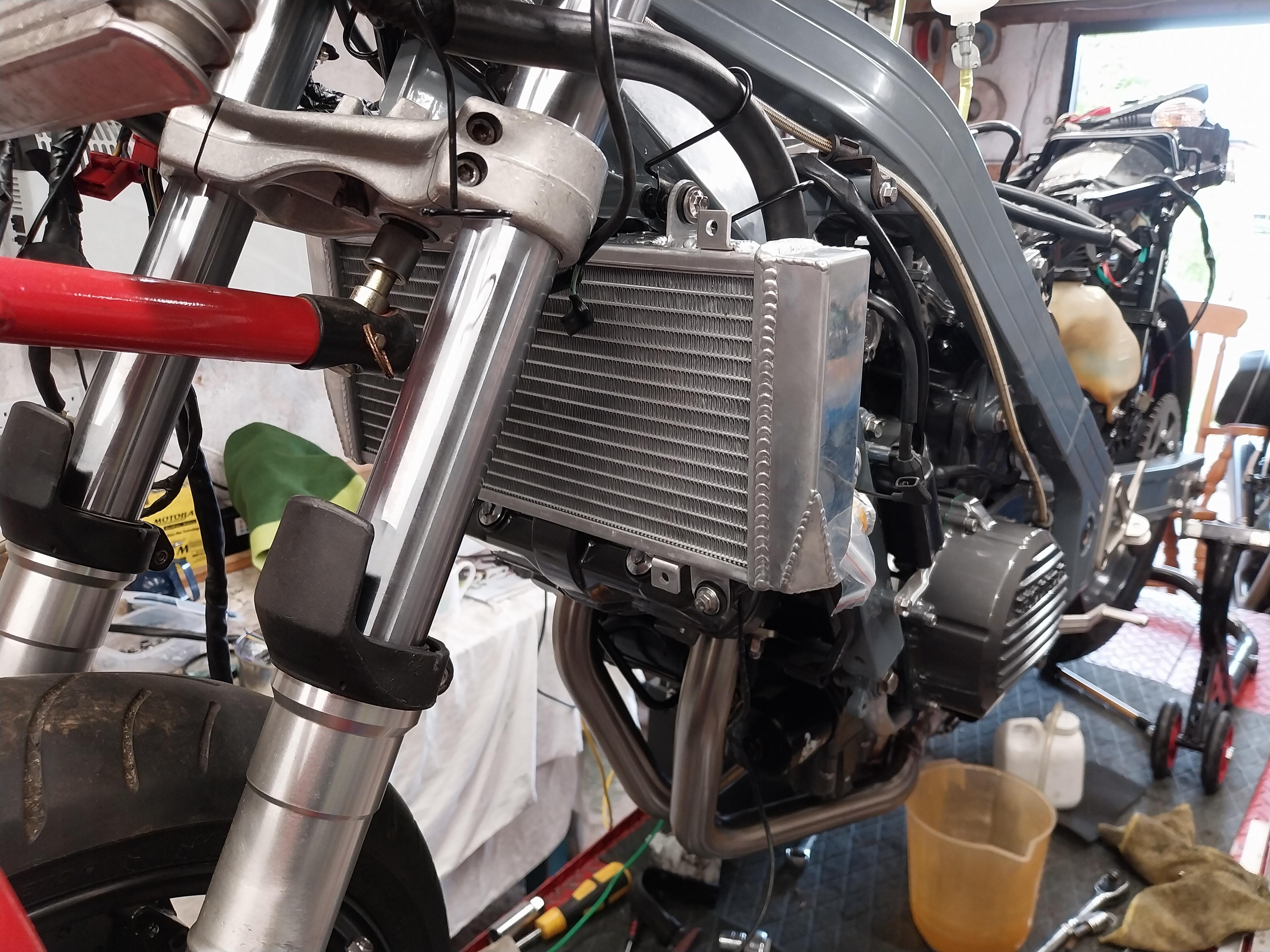

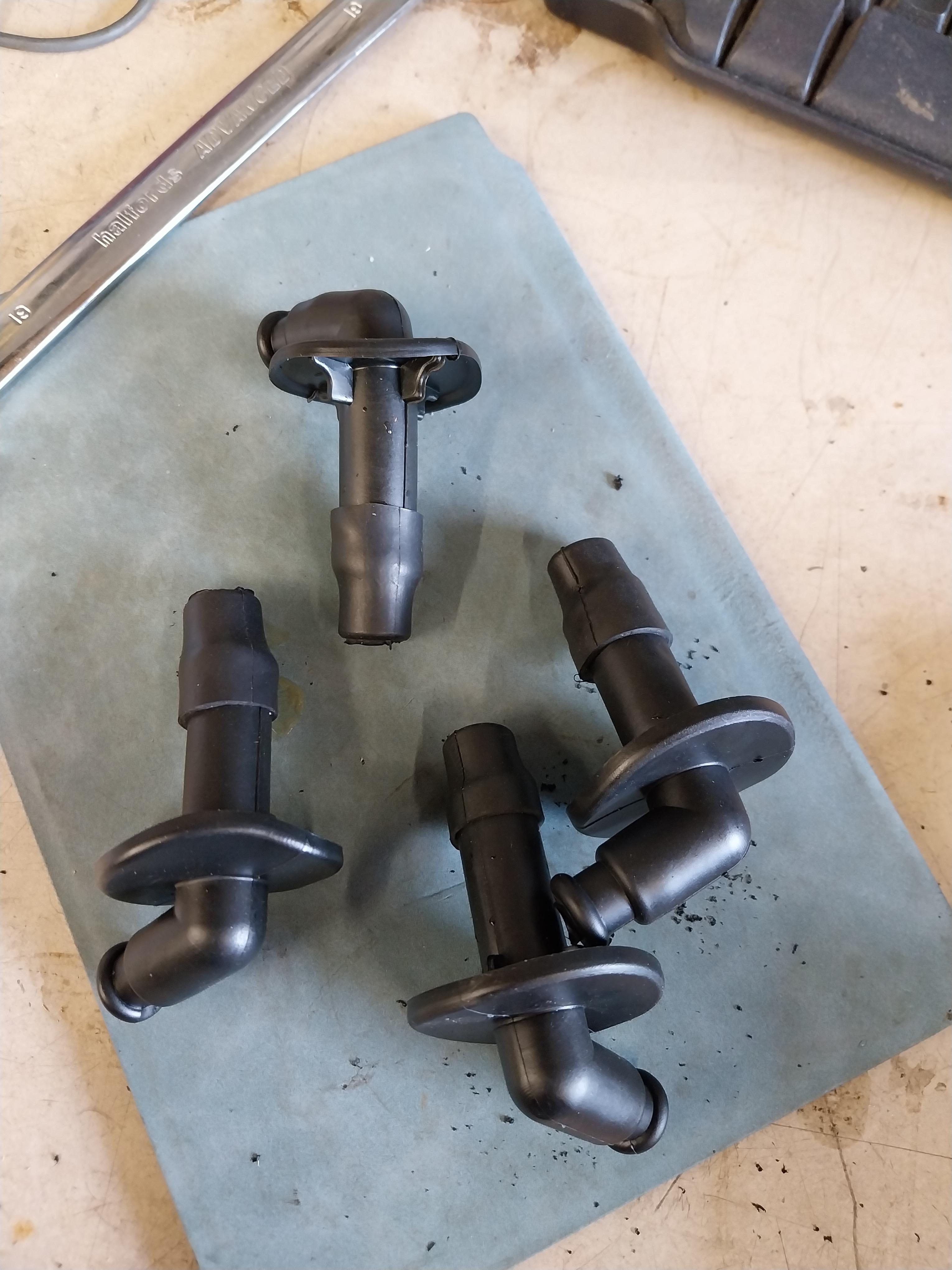

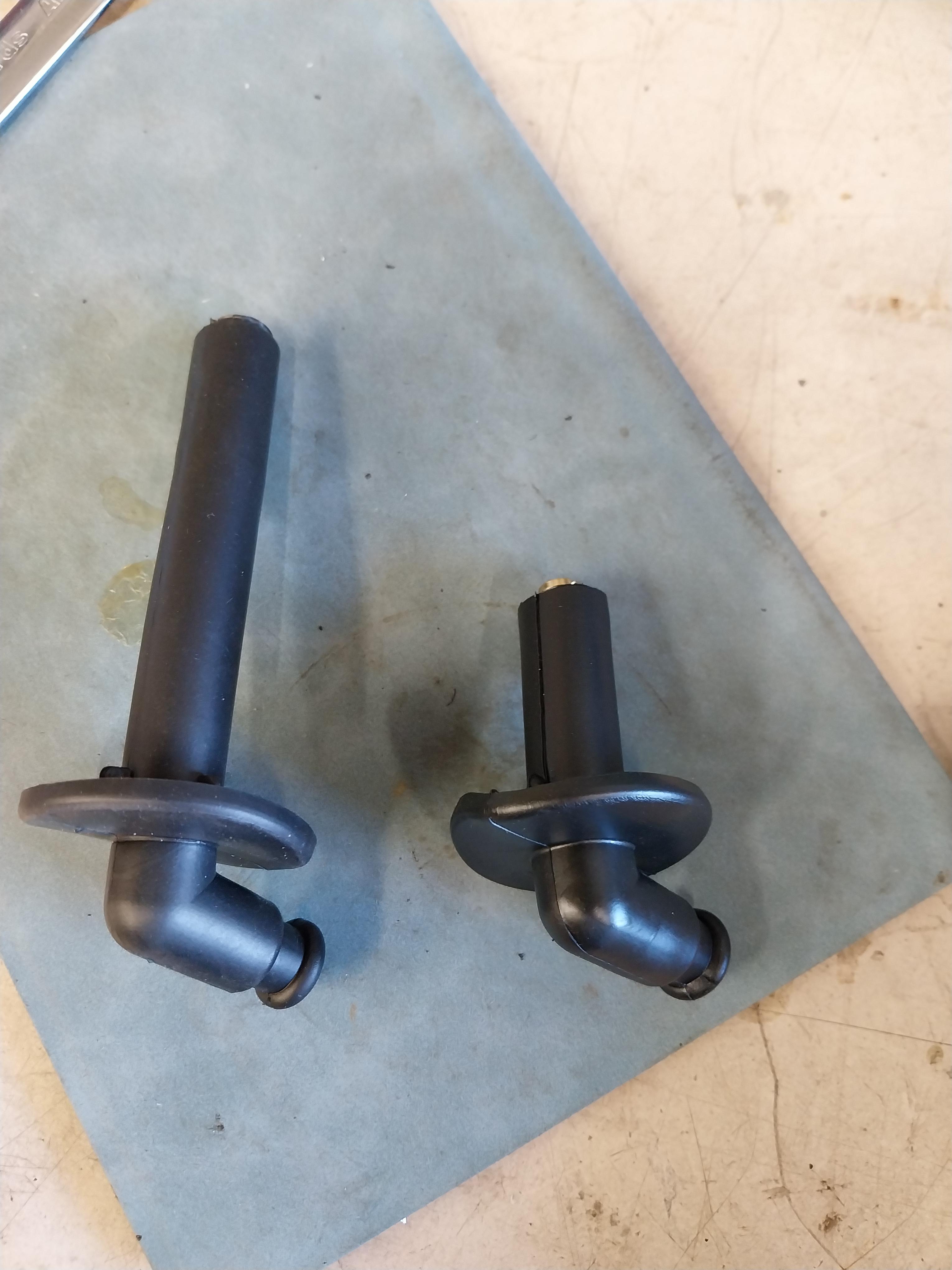

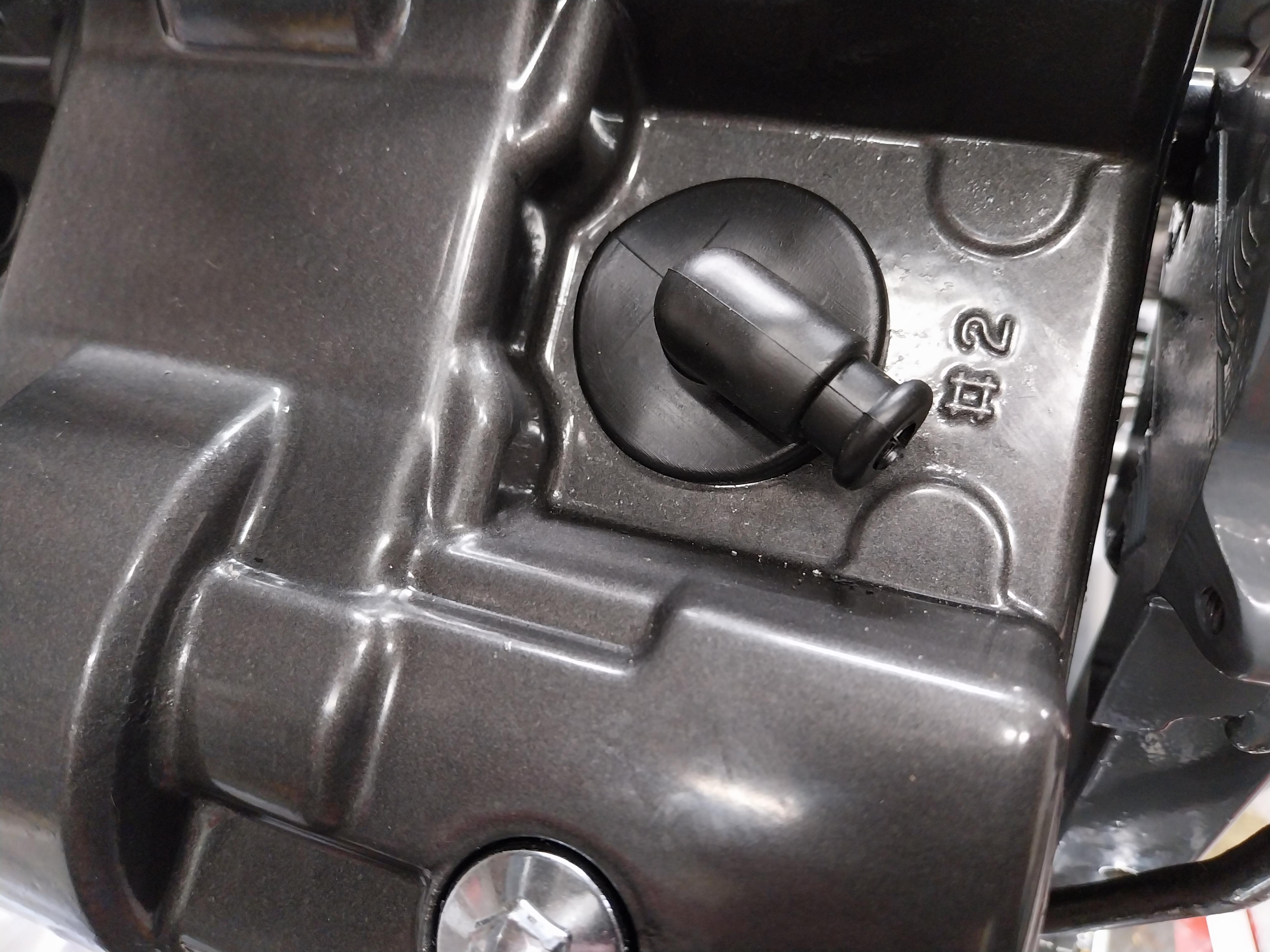

lastfleetadmiral Posted April 28, 2024 Author Posted April 28, 2024 Managed to get quite a lot done. Found a good oil cooler with very good pipes this has allowed me to fill the bike with oil and confirm oil pressure is good. Fitted the new radiator and finished wiring the new switchgear but in the process I think I fried the ECU by sending voltage through the clutch switch. I also modified some plug caps from aliexpress for a cbr600 to fitvthe vfr as you can see in the photos. Clutch slave cylinder is leaking badly so will replace with an aftermarket Oberon one 1 Quote

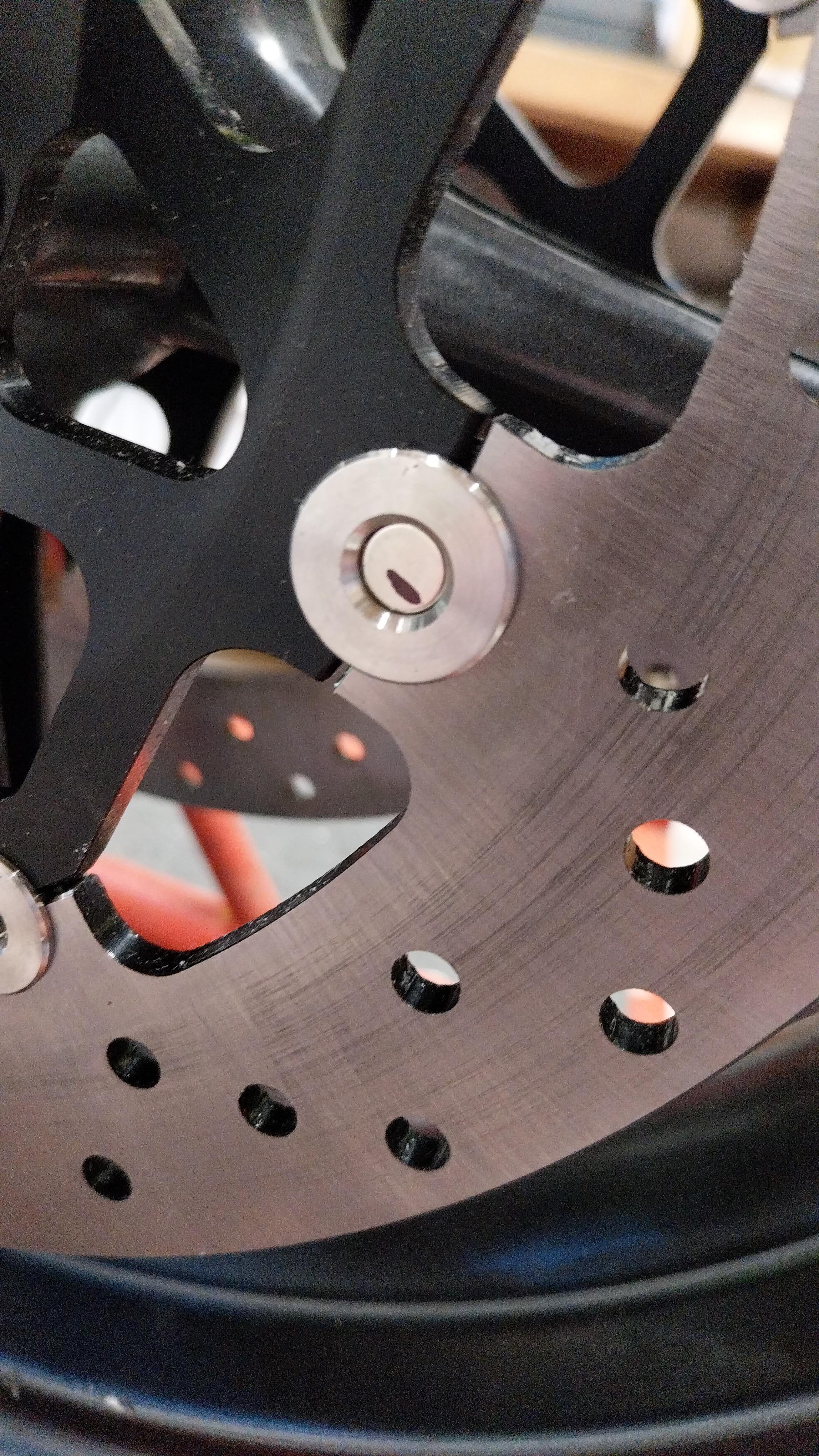

lastfleetadmiral Posted April 28, 2024 Author Posted April 28, 2024 I have also got the speedo magnets into the disc bobbins nicely 2 Quote
