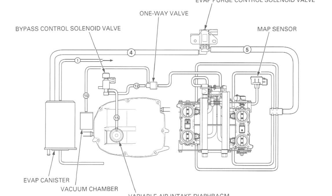

Member Contributer DannoXYZ Posted May 2 Member Contributer Share Posted May 2 Ok, no 5-way joint on your bike. Use this vacuum-gauge to measure vacuum going to MAP sensor. Use T-fitting to tap into hose in-line with MAP sensor. It's primary sensor that ECU uses to calculate air-flow volume to determine how much fuel to inject. https://www.amazon.com/Actron-CP7803-Vacuum-Pressure-Tester/dp/B0006V2BS2 At idle and low-loads, vacuum is high and ECU injects little petrol. At higher-loads and larger throttle-openings, vacuum is low and ECU injects more fuel. What often happens is vacuum hoses develops cracks and leaks, or get disconnected slightly when tank is removed and reinstalled. This vacuum leak lowers vacuum levels going to MAP sensor. It will read lower vacuum than actual and tricks ECU into thinking load is higher than actual. ECU then injects more petrol than required because it thinks load is higher. So you're cruising along with throttle barely open, but ECU thinks you're WOT!! Easier to just measure output voltage of sensor. Don't even have to take tank off. Then if numbers don't line up, you can crawl in there to measure vacuum and inspect for leaks There's possibility that FPR has malfunctioned. Its job is to vary fuel-pressure according to load based on... intake vacuum! At low-loads and low fuel-demands, it lowers fuel-pressure. At high-loads it raises fuel-pressure. Leaks in vacuum hoses would cause it to send too-high pressure to fuel-rail. Only way to know for sure is to measure fuel-pressure in fuel-rail. Quote Link to comment Share on other sites More sharing options...

VicSev93 Posted May 3 Author Share Posted May 3 20 hours ago, DannoXYZ said: Ok, no 5-way joint on your bike. Use this vacuum-gauge to measure vacuum going to MAP sensor. Use T-fitting to tap into hose in-line with MAP sensor. It's primary sensor that ECU uses to calculate air-flow volume to determine how much fuel to inject. https://www.amazon.com/Actron-CP7803-Vacuum-Pressure-Tester/dp/B0006V2BS2 At idle and low-loads, vacuum is high and ECU injects little petrol. At higher-loads and larger throttle-openings, vacuum is low and ECU injects more fuel. What often happens is vacuum hoses develops cracks and leaks, or get disconnected slightly when tank is removed and reinstalled. This vacuum leak lowers vacuum levels going to MAP sensor. It will read lower vacuum than actual and tricks ECU into thinking load is higher than actual. ECU then injects more petrol than required because it thinks load is higher. So you're cruising along with throttle barely open, but ECU thinks you're WOT!! Easier to just measure output voltage of sensor. Don't even have to take tank off. Then if numbers don't line up, you can crawl in there to measure vacuum and inspect for leaks There's possibility that FPR has malfunctioned. Its job is to vary fuel-pressure according to load based on... intake vacuum! At low-loads and low fuel-demands, it lowers fuel-pressure. At high-loads it raises fuel-pressure. Leaks in vacuum hoses would cause it to send too-high pressure to fuel-rail. Only way to know for sure is to measure fuel-pressure in fuel-rail. I have ordered the vaccume pressure gauge to connect to the hose from the map sensor and document the pressure I'm getting there. For the fuel rail...how do I even measure it? I know cars have a valve for a gauge to plug in..but my bike definitely does not... 😂 Quote Link to comment Share on other sites More sharing options...
Member Contributer Terry Posted May 3 Member Contributer Share Posted May 3 32 minutes ago, VicSev93 said: I have ordered the vaccume pressure gauge to connect to the hose from the map sensor and document the pressure I'm getting there. For the fuel rail...how do I even measure it? I know cars have a valve for a gauge to plug in..but my bike definitely does not... 😂 Mr Honda says to do the fuel pressure check at the fuel pump banjo bolt on the underside of the fuel tank. However...that might be worth doing if the fuel flow/pressure was low. Can't see any point if the pressure is suspected to be high. The fuel pump should always kick out more pressure than needed, hence the function of the regulator downstream. 1 Quote Link to comment Share on other sites More sharing options...
