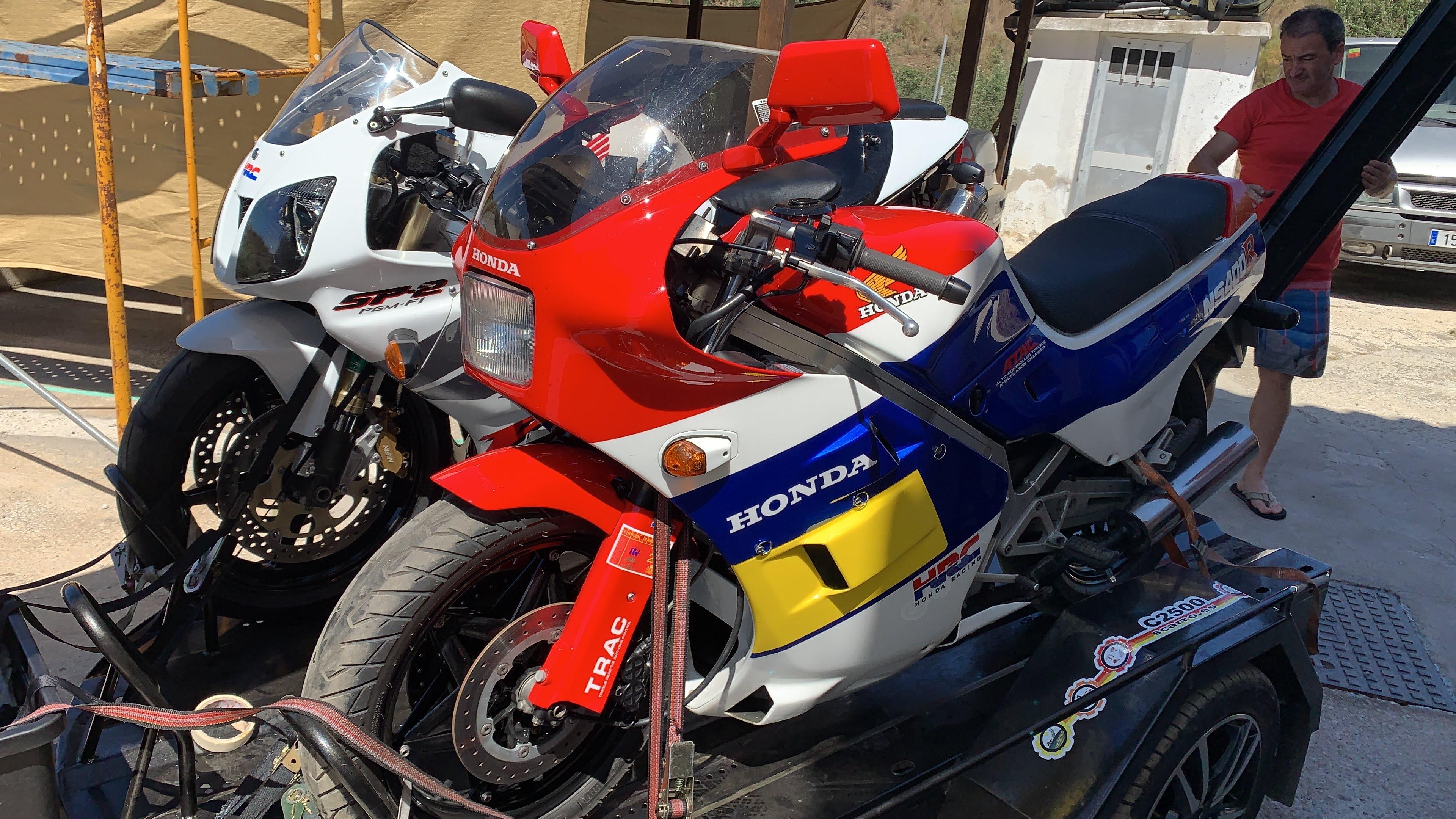

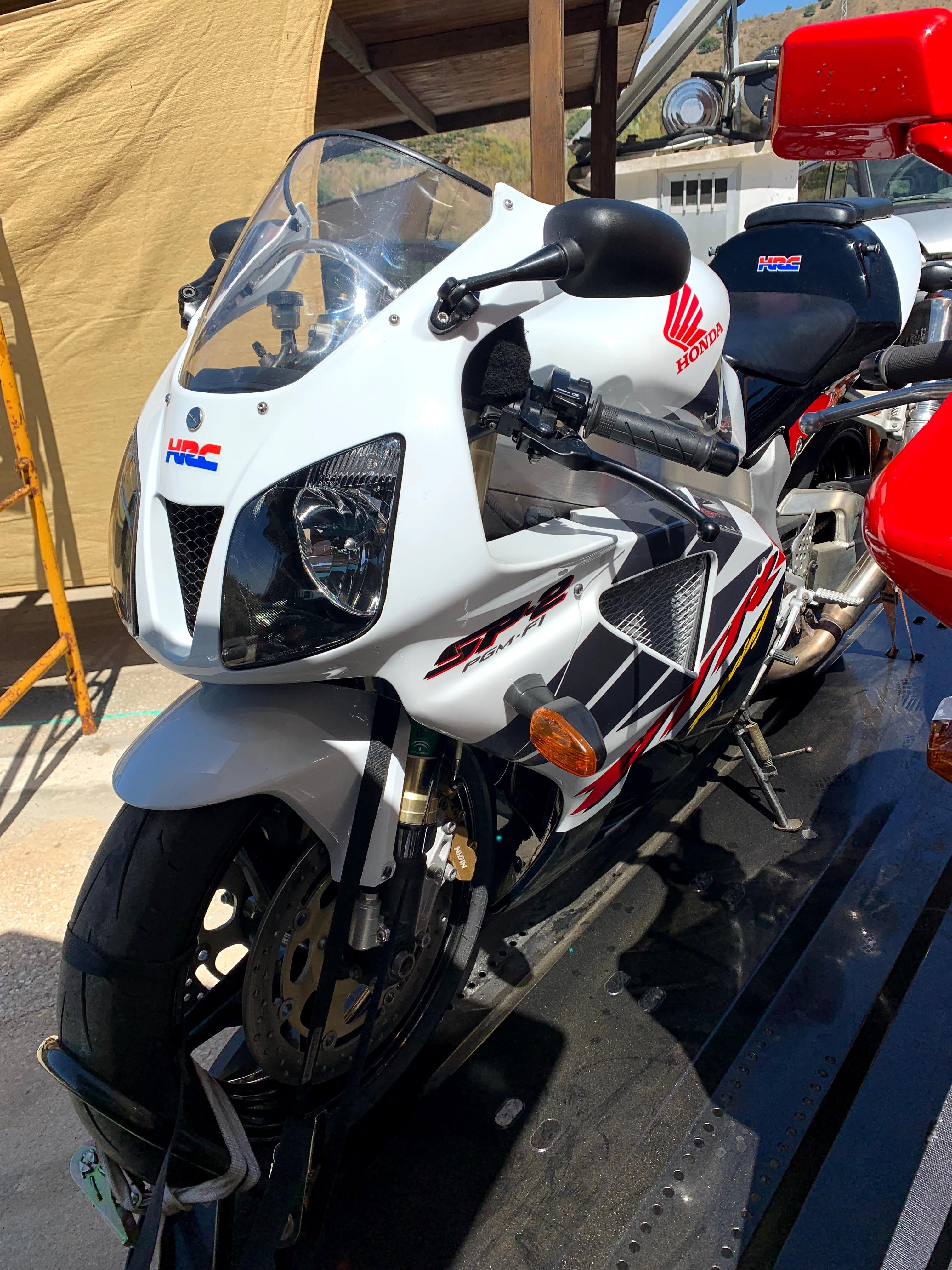

Elchuso Posted July 3, 2021 Author Posted July 3, 2021 Two new for the collection and another on the way to be finished. Happy!!! 💪💪💪💪 2 1 Quote
