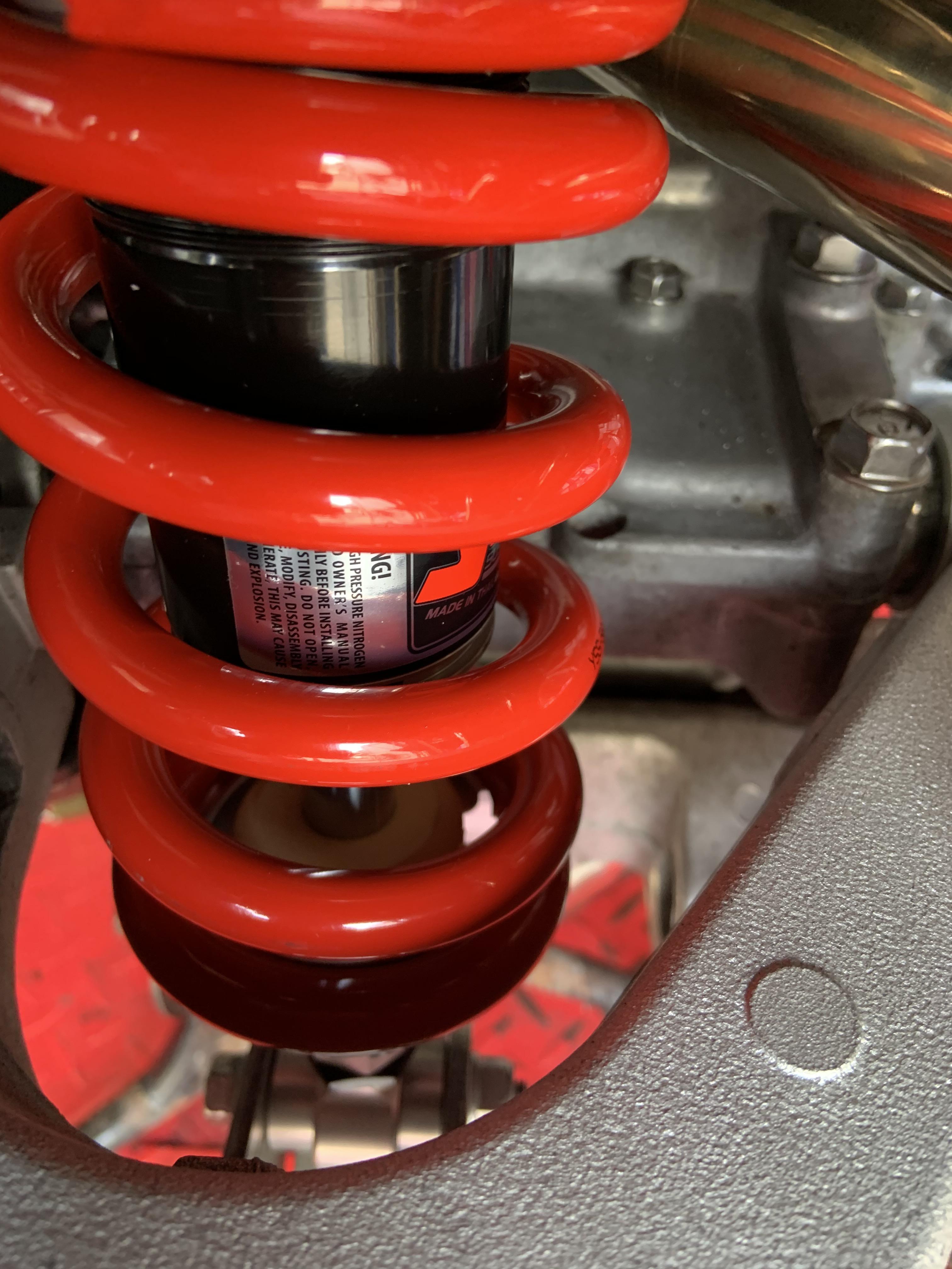

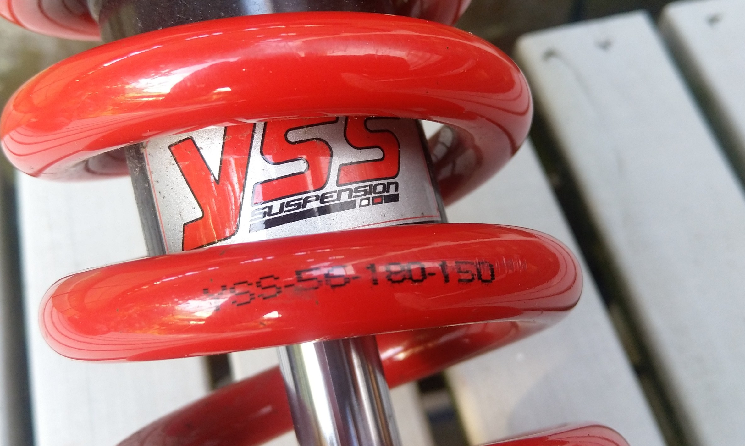

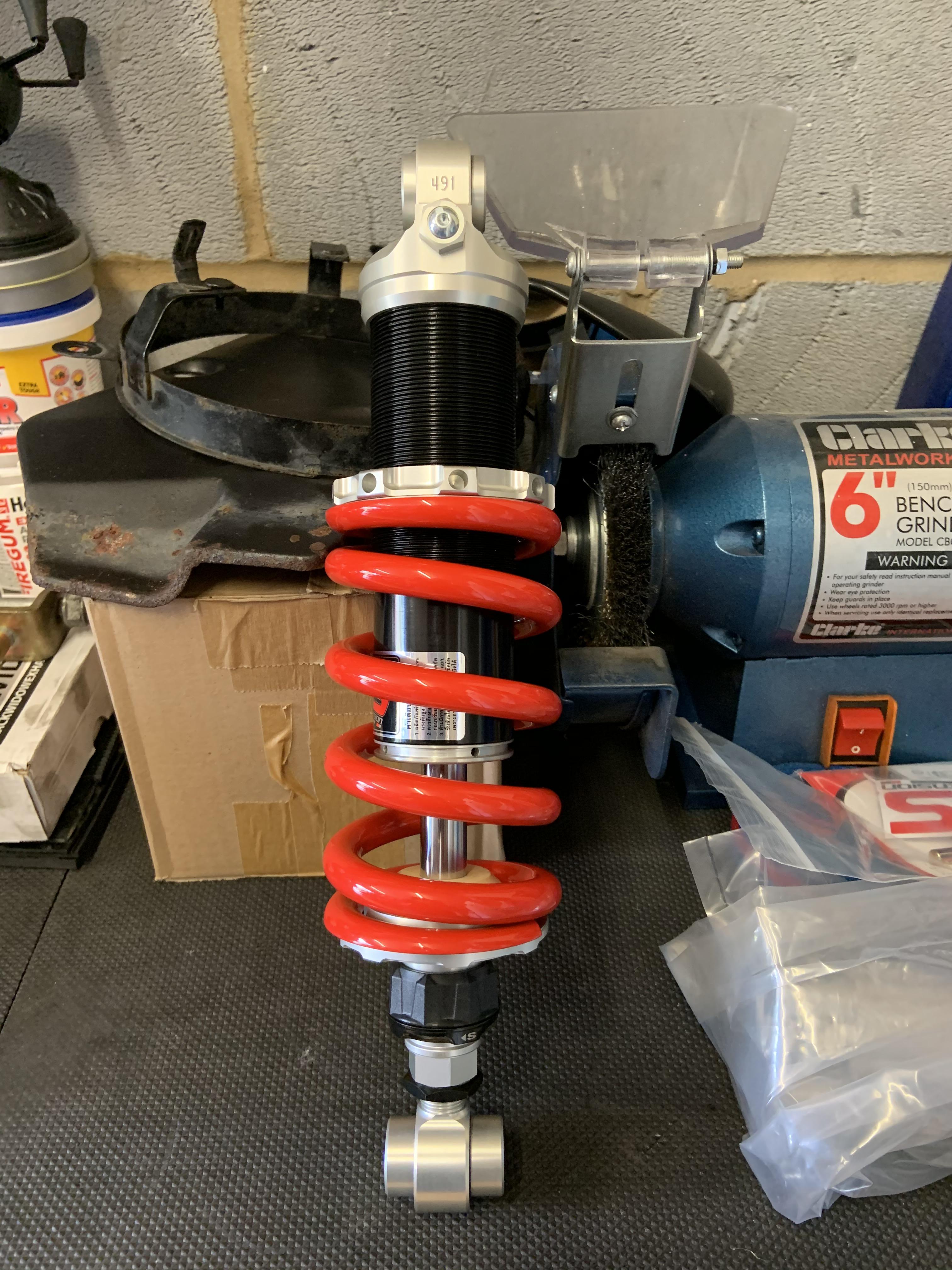

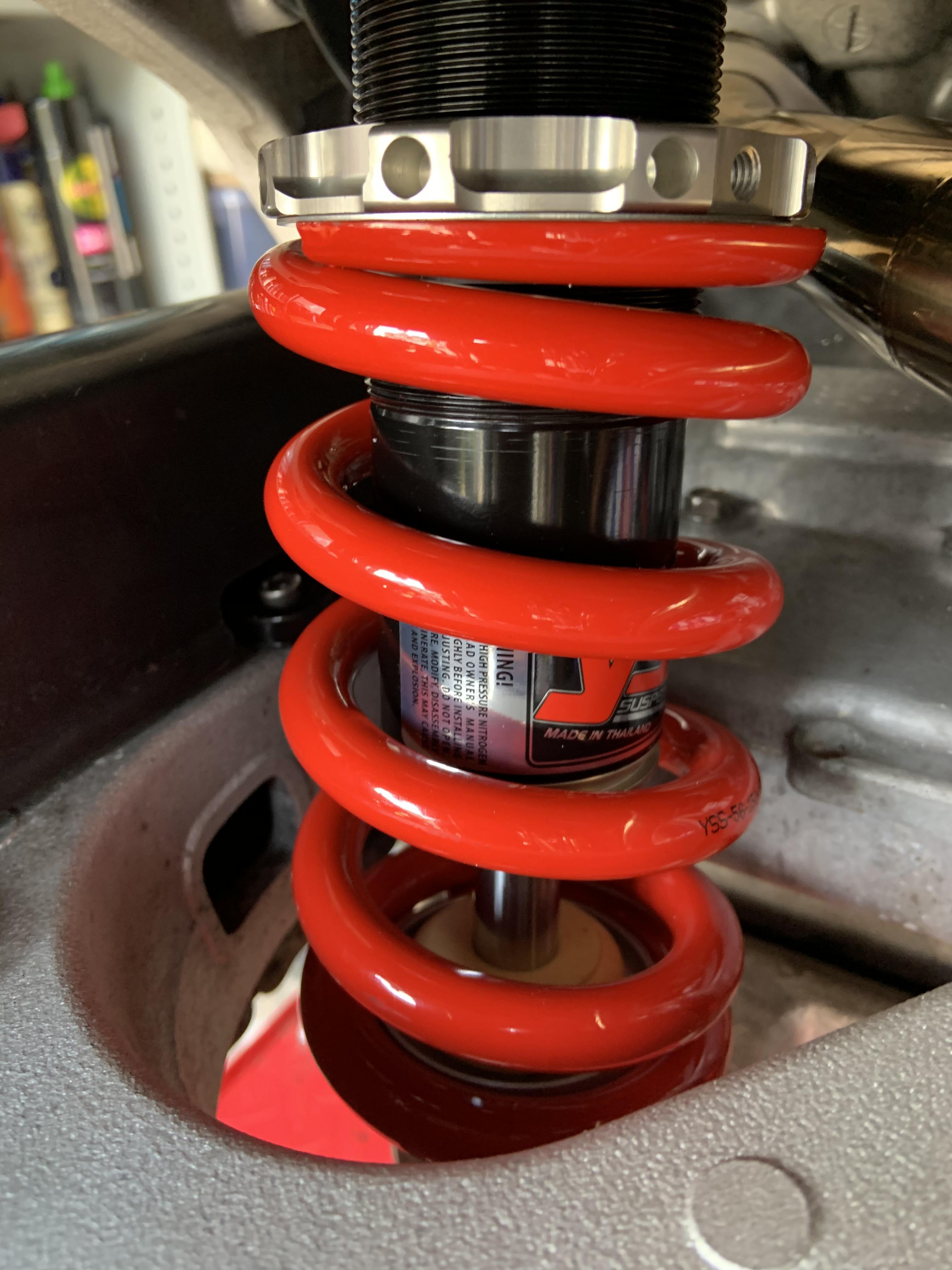

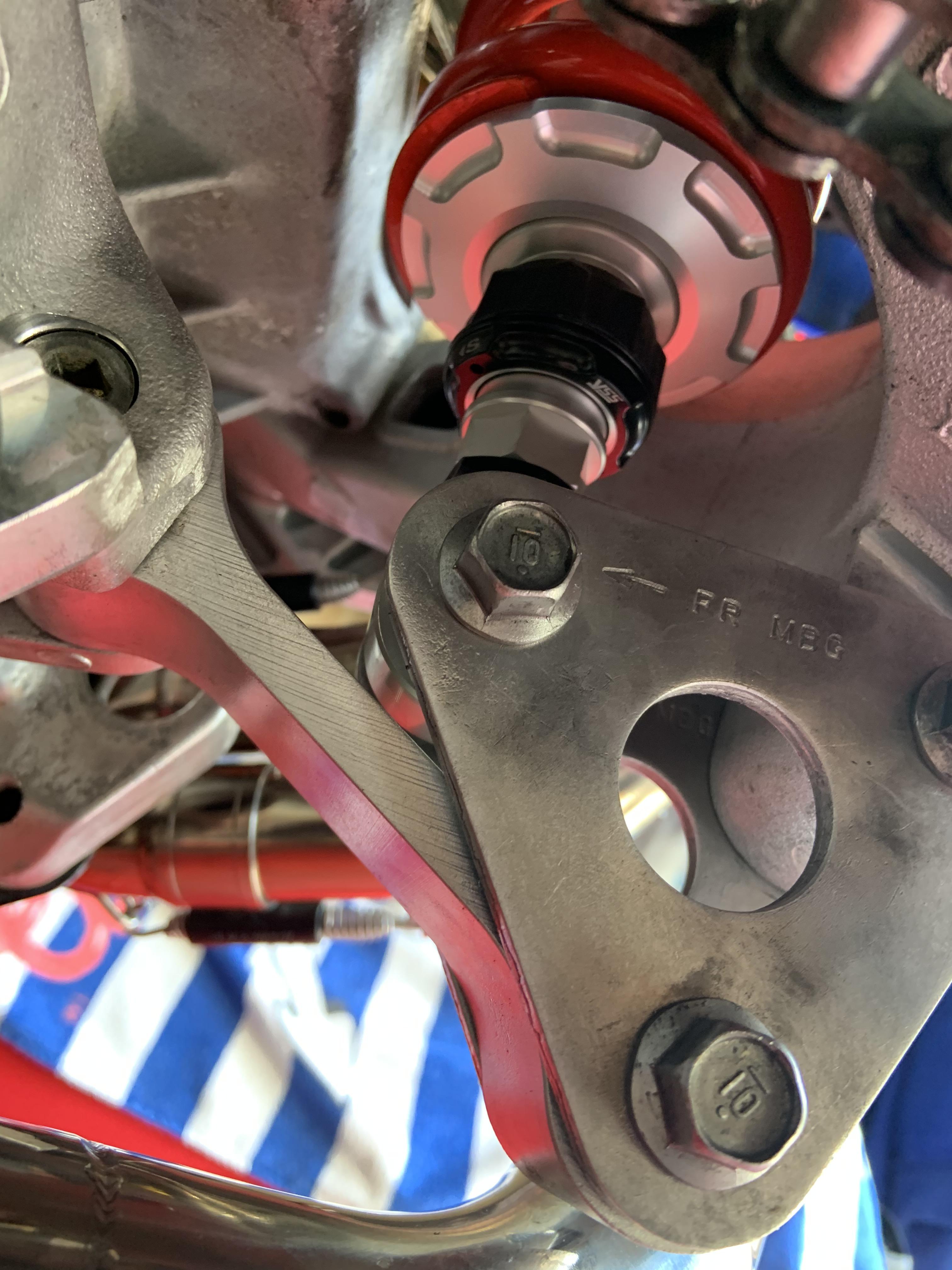

Member Contributer Captain 80s Posted March 9, 2021 Member Contributer Posted March 9, 2021 I have bought and installed 3 YSS shocks now, and I am very happy with them. While I'm sure other "Premium" shocks will ultimately perform better, I find them to be an amazing value. The quality, performance, fitment and supplied spring rates seem to be very good. The main ebay store for them will fit whatever spring rate you want for an additional charge. The last one I bought for a Hawk GT arrived in a timely manner too. On a slightly related note: Although they have a pretty generous separate ride height adjustment, if you do some research with the part numbers, you can sometimes find shocks with the same configuration and spring, but are a little longer (or shorter) than listed in the Application Guide for a model. Very helpful when I was fitting for the VF1000F and R. I went longer of course, especially for the "F", as the stock length is a bit shorter than the "R". Quote

Member Contributer Captain 80s Posted March 9, 2021 Member Contributer Posted March 9, 2021 4 minutes ago, Walker1 said: Thats awesome! How do you find it works when riding two up? Thats an awesome collection you have! Sorry, I can't say, I don't two up on those bikes. I will likely be fitting one to my 98 ST1100 at some point, but it has pretty low miles and the shock isn't screaming at me to be replaced. And thank you! Obligatory picture of a YSS fitted machine: Quote
