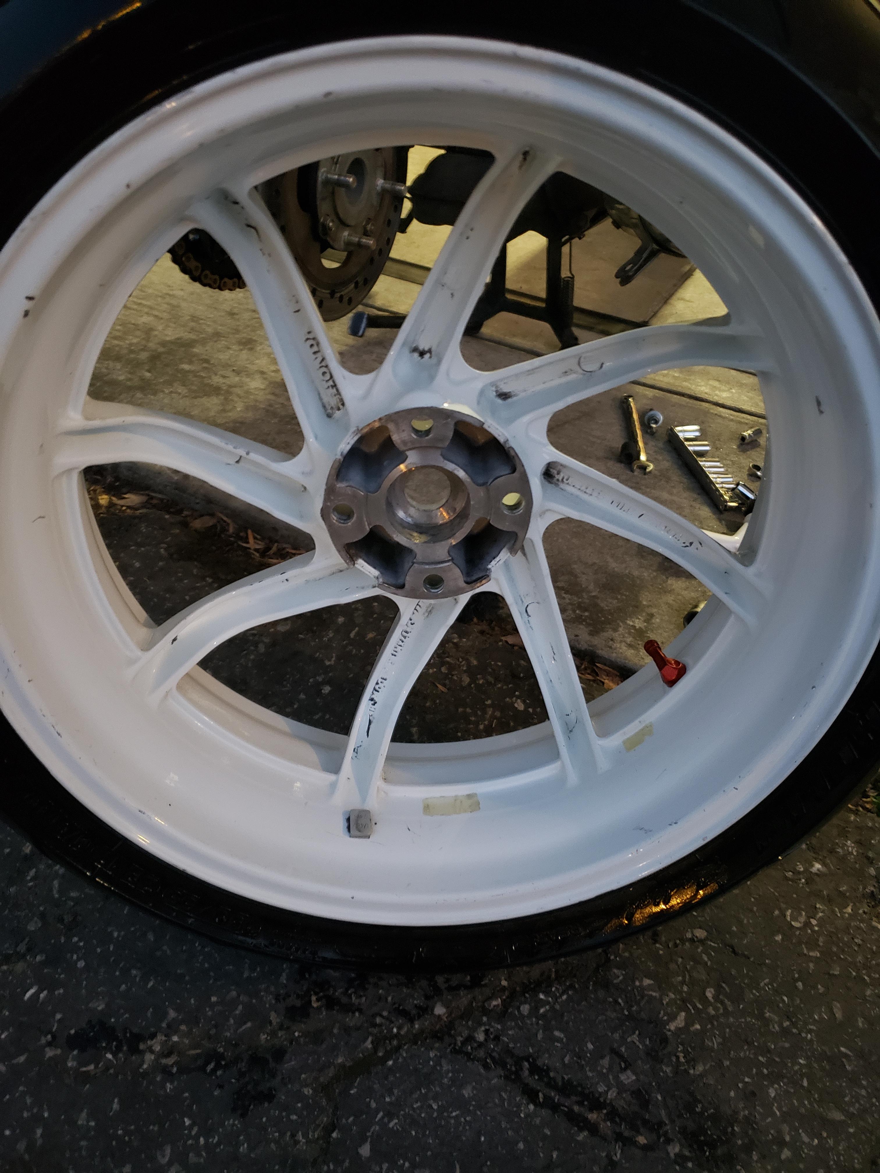

 I did buy a 5th/6th gen rear wheel, and will notch it to fit, then powder coat it gloss black. To me the 3ed gen wheel look is lost a bit on a street fighter, but the square-spoked 5/6 gen looks tough. Also if they ( 3rd gen rear wheels) are not white, they don't POP, and they are hard to come by these days. Actually the neon green one on Brian F's old bike had plenty of POP!

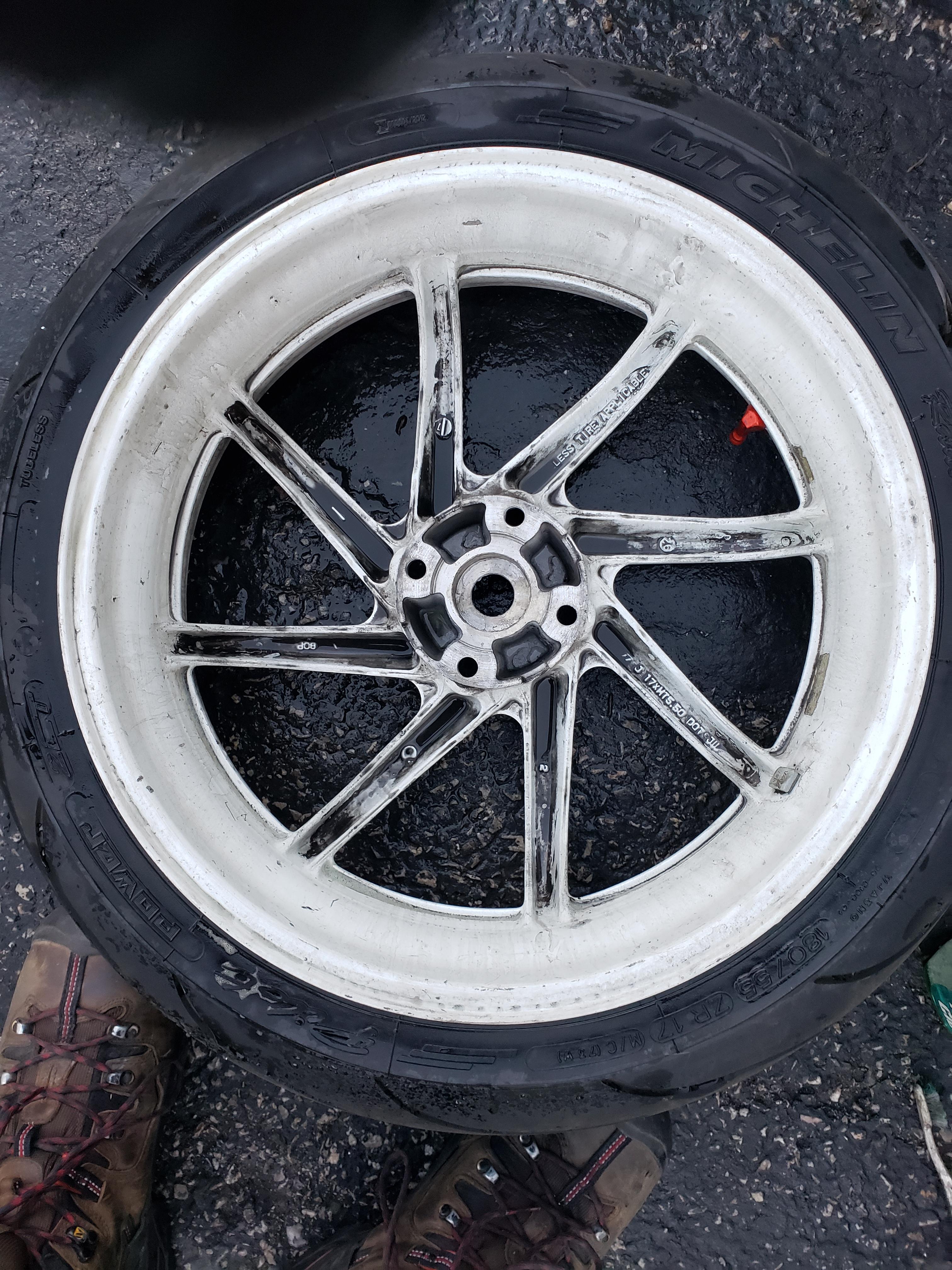

Had a little free time today, so I washed the wheels, as I don't want to get grease and grime in the sandblaster at work. The original and the Ebay wheel had to soak with simple green, as the back sides of the spokes had never been washed. I will post up the wheel mod, as soon as I can get to it.

be careful about soaking any bare metal in Simple Green for too long...
Yep, etches it right up, same as citrus degreaser...
Both bikes wheels' have corrosion, from brake dust, and being left outside for years on end...
Be extremely careful with the stuff. Dilute it lots and never leave on for too long!
Simple Green doesn't just etch, but causes hydrogen-embrittlement and outright dissolves metal. Discovered this about 20-years ago on bicycle-racing forums where chains soaked in Simple Green comes out cracked with pieces missing!!! When I brought this up to Simple Green, they added warning on their website:

Wow, did not know it was that aggressive...any other suggestions for heavy duty cleaning off years worth of stuck-on-crud?
WD-40 is my go to for chain goo. I generally used simple green also for cleaning. I never let it sit on a part as it was spray, scrub, and rinse. I didn't know about how bad it could be either.
One of things learned in my o-chem classes was "like dissolves like". Personally, I think it's futile to make an aqueous (polar) solution try to dissolve non-polar compounds (oil & grease). A polar solvent works much better. Yeah, I like WD-40 also, or kerosene.
