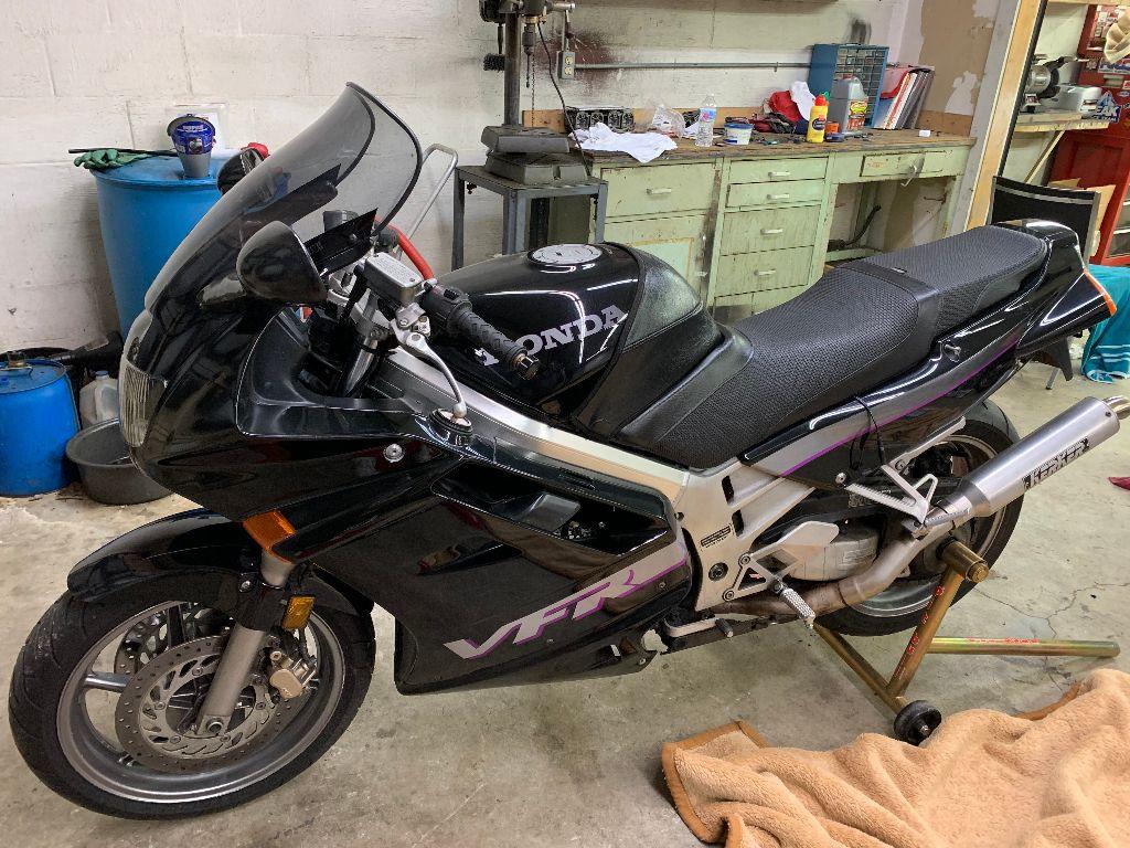

Nice thread and timely too. I recently purchase a 92 VFR and plan on going through it like you did with yours. The first thing I did was ditch the tank bra! Lol 1339549085_92VFR.thumb.jpg.c4699f0ab7612e0c3796f6fd3bb1ccef.jpg
That's beautiful. Any body bras are a mixed bag. I used to run them all on my olf FJs!

Thanks!
The 'ol Kerker left-exit half-system... I bet it's loud!

I love the Kerker on my CB-1. Lovely when I'm going through the mountains and there's a wall of earth on the right! Tunnels sound great too.
