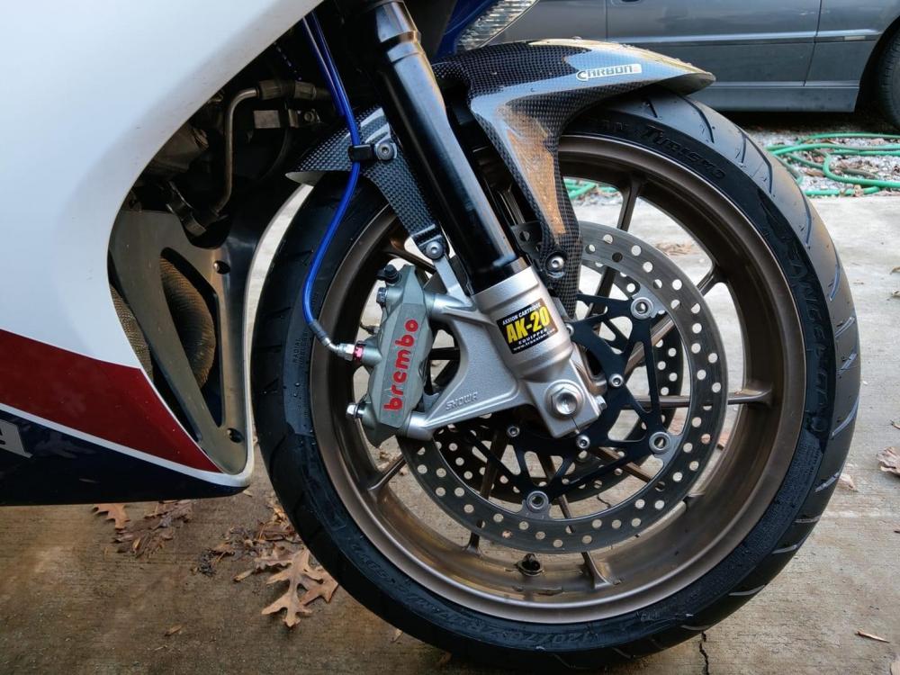

This is his bike, as I couldn’t find him here. One of the baddest VFR’s on the planet, IMO. 5th Gen engine, 6th Gen chassis, 8th Gen running gear, and very well executed with great detailing and aftermarket bits.

Those are not 8th Gen front brakes.
Just sayin'

On 24 April 2020 at 11:51 PM, ducnut said:
Are my eyes playing tricks on me (I am over 60 and wear glasses!! :blink:) or is there something strange about the lower caliper bolt, it's doesn't appear to be fully seated. Or is it the wrong length and is there a spacer under the head of the bolt?
The bolt head looks different to the upper bolt, just doesn't look right to me!:wacko:
Otherwise it's a great looking upgrade.
  • 0
Yeah it does appear to be loose !
  • 0
I think, the owner was doing a trial fitment with this setup, because he had another set of calipers on there, and if I remember correctly this pic was from that trial. He had 1000RR calipers on there, before these.
