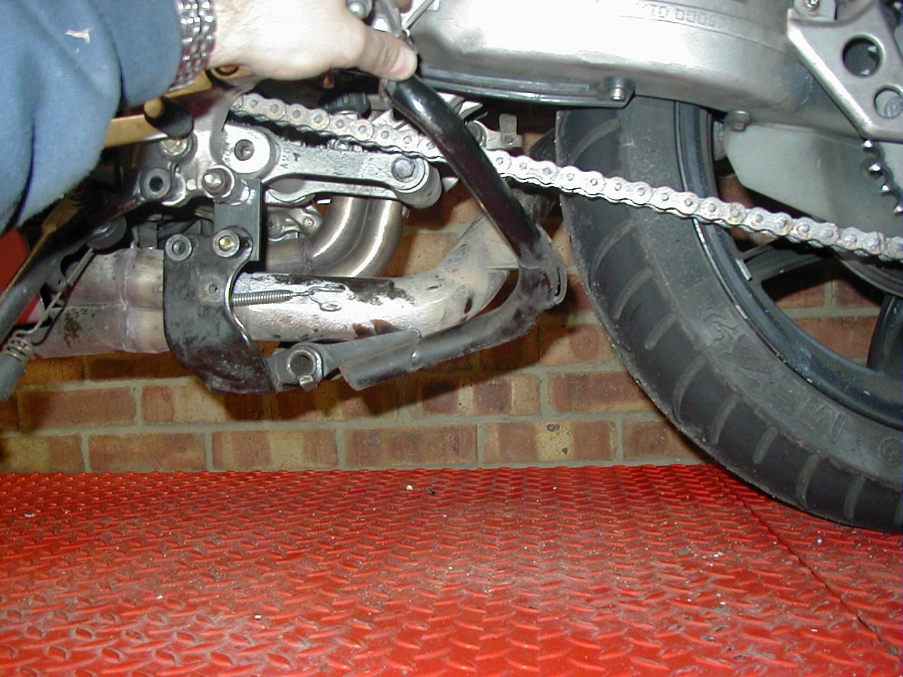

Member Contributer JZH Posted December 16, 2019 Member Contributer Posted December 16, 2019 There's nothing much to do if the 3rd gen doesn't have a center stand. The TBR on my 3rd gen was designed for a 4th gen. If you insist on having an aftermarket header on a 3rd gen and retaining the centre stand, it's still possible, but it gets complicated... This pic shows why the 3rd gen main stand is kinda in the way: I don't remember if the temporary bracket in the picture above was 35mm or 40mm, but I think I settled on 40mm for the final design, which gave me enough clearance for the header outlet. However, in order to get the ground clearance back I had to raise the rear of the bike by flipping the eccentric from the top to the bottom. And in order for that to work I had to countersink one of the rear brake bracket bolts. Then my side stand was too short, so I had to lengthen it to keep the bike from falling over... I ran the bike that way for years, but in the bike's current (stalled!) project phase I've actually removed the center stand. Ciao, JZH Quote
davfr Posted December 18, 2019 Posted December 18, 2019 On 12/16/2019 at 4:16 PM, JZH said: There's nothing much to do if the 3rd gen doesn't have a center stand. The TBR on my 3rd gen was designed for a 4th gen. If you insist on having an aftermarket header on a 3rd gen and retaining the centre stand, it's still possible, but it gets complicated... This pic shows why the 3rd gen main stand is kinda in the way: I don't remember if the temporary bracket in the picture above was 35mm or 40mm, but I think I settled on 40mm for the final design, which gave me enough clearance for the header outlet. However, in order to get the ground clearance back I had to raise the rear of the bike by flipping the eccentric from the top to the bottom. And in order for that to work I had to countersink one of the rear brake bracket bolts. Then my side stand was too short, so I had to lengthen it to keep the bike from falling over... I ran the bike that way for years, but in the bike's current (stalled!) project phase I've actually removed the center stand. Ciao, JZH That is good to know! I ditched my center stand long ago so no issues there. I guess I just have to keep saving up for the tyga. Quote
