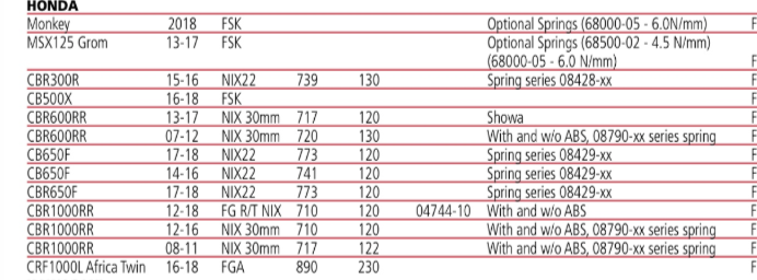

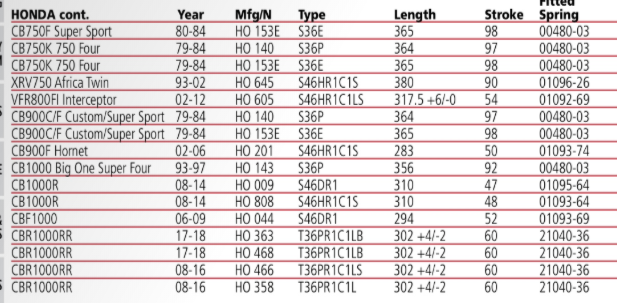

MOTOPILOT Posted August 29, 2019 Posted August 29, 2019 Hello Fellow VFR Lovers. I do bike builds on youtube and I'm gearing up to start a new build on my 2004 VFR (6th generation), converting it into a full blown Street Fighter. A fancy term for an aggressive naked bike - lol. You can find my youtube channel by just searching MOTO PILOT on google or youtube. Leading up to the build which starts in the next few weeks, I have been doing a lot of research on here and online in general for certain complicated (and simple) mods. Most of my plans are fairly straight forward. Strip the body work. New subframe build and seat. Modify the current Leo Vince dual upsweep exhaust. Mount up an Ohlins shock. Lots of other little mods that are just straight bolt on such as levers, calipers, knobby tires, etc... My biggest head spin is swapping the front end to Upside Down Forks. A lot of info out there going in a lot of directions. But I think I narrowed it down to going with a 2007 or older CBR1000RR front end assembly. What sucks is I get my parts sponsored by TUCKER.com and their Ohlins for that year bike start at 2008+. Just my luck. I'd love to be able to put a fresh new set of Ohlins on this build so if anybody knows of a more current model than 2007 that would work, please hit me up at motopilot6@gmail.com. THE ATTACHED IMAGE WITHOUT A VFR APPLICATION IS FOR OHLINS FORKS I also saw info about using 50mm RC51 forks with a 929 top clamp since its gull wing. I imagine so you can drop them to the proper length?OHLINS SHOCKS I'd also love to upgrade the shock to one with a reservoir. I saw online that a CBR954 shock would work using a longer upper mount (since the shock is shorter than the VFR) . Problem is TUCKER does not carry an Ohlins for this bike but they do carry plenty of others for CBR's more current. THE ATTACHED IMAGE WITH A VFR APPLICATION IS FOR OHLINS SHOCKS I also saw online that rearsets for a 04-07 CBR1000RR can be adapted to the VFR. I plan to get a set from Vortex. Anybody done this? Anyway, I pretty much have amateur knowledge of this VFR machine so if anybody wants to chime in on idea's I'd love to hear them. And be sure to check with my youtube channel MOTO PILOT if you care to watch this build take shape over multiple episodes. it will be learning process as I go so bear with me Cheers. MP Quote

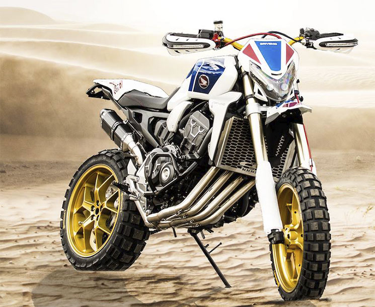

Member Contributer Lorne Posted August 30, 2019 Member Contributer Posted August 30, 2019 (edited) Knobby tires and UD forks, eh? Brings to mind this creation from Brivemo Motos. Sadly, not a V4 but an impressive piece nonetheless. Edited August 30, 2019 by Lorne add one line Quote

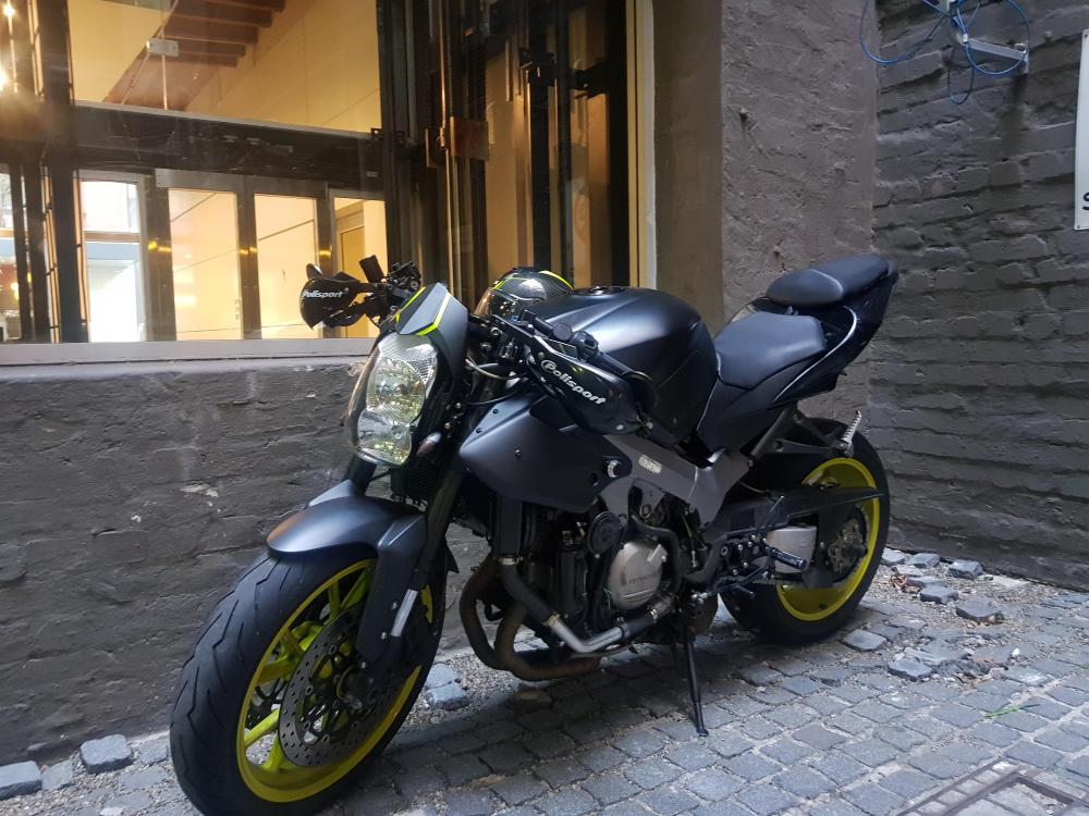

keef Posted August 30, 2019 Posted August 30, 2019 Someone say streetfighter? I like a good fighter 1 Quote

Halfrider Posted August 31, 2019 Posted August 31, 2019 20 hours ago, keef said: Someone say streetfighter? I like a good fighter fresh paint keef? 1 Quote

keef Posted August 31, 2019 Posted August 31, 2019 3 hours ago, Halfrider said: fresh paint keef? Yeah, but only matte black on the rad shrouds. I put some bar end indicators into the shrouds, so thought i should finally spray them. Quote
