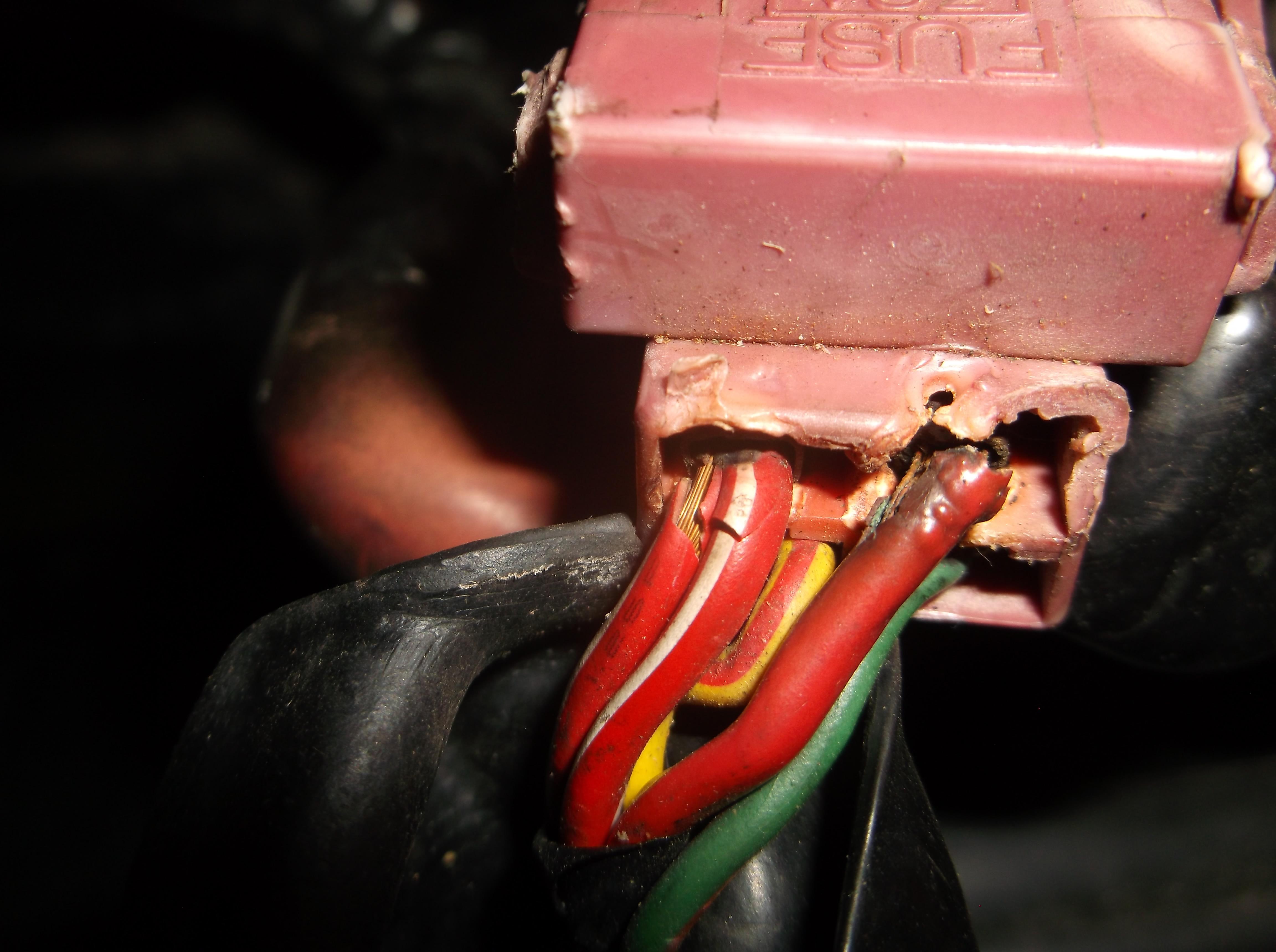

GreenOnion84 Posted June 13, 2019 Posted June 13, 2019 Okay, so here goes. I have charging issues when the bike is warmed up. I replaced the stator as well as the R/R. I also replaced the connector going into the R/R due to one burnt connector. Amps coming out of the stator are good. When the bike is cold and the battery is full, it charges above 14 at 5k rpm. However, after the bike gets to running temps, the voltage drops and charges around 12.8-13k and slowly drops. Could this be a ground issue? At this point I'm exhausted and getting angry at spending a lot of money just to not have the issue fixed. Quote
Member Contributer Grum Posted June 13, 2019 Member Contributer Posted June 13, 2019 Have a very close inspection of the 30a main fuse within your starter relay for any sign of heat stress, it can suffer from hi resistance contacts. Make sure the R/R ground measures rock solid back to the battery negative terminal. Are you also sure your battery is healthy? Make sure it's connections are clean and tight. Quote
GreenOnion84 Posted June 13, 2019 Author Posted June 13, 2019 31 minutes ago, Grum said: Have a very close inspection of the 30a main fuse within your starter relay for any sign of heat stress, it can suffer from hi resistance contacts. Make sure the R/R ground measures rock solid back to the battery negative terminal. Are you also sure your battery is healthy? Make sure it's connections are clean and tight. I forgot to mention I also shelled out money for a new battery. I'm going to take it to have it tested again today just to make sure nothing has happened in the meantime. Am I able to take the ground off the starter relay and wire it directly to the negative terminal of the battery? What about the positive, can I wire that directly to the battery as well and just bypass the starter relay all together? I understand I'd have to have an in-line fuse, but I'm afraid of bypassing the starter relay with the positive and ground. Quote
Member Contributer Grum Posted June 13, 2019 Member Contributer Posted June 13, 2019 46 minutes ago, GreenOnion84 said: Am I able to take the ground off the starter relay and wire it directly to the negative terminal of the battery? What about the positive, can I wire that directly to the battery as well and just bypass the starter relay all together? I understand I'd have to have an in-line fuse, but I'm afraid of bypassing the starter relay with the positive and ground. No need to be doing bypass. You can't bypass the starter relay all together! You wouldn't be able to start your bike! You don't have any starting issues anyway! Unplug the R/R connector and just make sure the Green ground wire measure zero ohms back to the Negative terminal, you could also confirm the same for the Red/white wire to the battery Positive terminal. Have a very close look at your main fuse and its connections in the starter relay as mentioned. Also when you have the fault active back probe the three stator wires coming into your R/R and confirm the AC voltage is not lost. Good luck. Quote
GreenOnion84 Posted June 13, 2019 Author Posted June 13, 2019 54 minutes ago, Grum said: No need to be doing bypass. You can't bypass the starter relay all together! You wouldn't be able to start your bike! You don't have any starting issues anyway! Unplug the R/R connector and just make sure the Green ground wire measure zero ohms back to the Negative terminal, you could also confirm the same for the Red/white wire to the battery Positive terminal. Have a very close look at your main fuse and its connections in the starter relay as mentioned. Also when you have the fault active back probe the three stator wires coming into your R/R and confirm the AC voltage is not lost. Good luck. Okay, I wasn't sure if that was the main wire powering it or if it was just an additional plug into it. I'll have to recheck all of it. I checked it all before and everything seemed to be in working order. I've also tried multiple regulators just in case and they're all reading the same. I'm at work now, but I'll recheck the connections tonight. Quote

squirrelman Posted June 15, 2019 Posted June 15, 2019 unsolvable charging problems can sometimes be traced to the plug atop the starter solenoid, where signs of heat-distress often appear. Quote

GreenOnion84 Posted June 29, 2019 Author Posted June 29, 2019 On 6/15/2019 at 9:26 PM, Grum said: Yeah me to, that's why I mentioned three times for the OP to check the main fuse and starter relay area. He claims all is good there to! I took the main fuse out and even replaced it even though it looked good, just to be sure. I also took apart the starter relay ground and checked it. I unplugged it and checked the plug as well. I sprayed the connector with electrical connector cleaner just to be safe. All looks great over there. Quote
