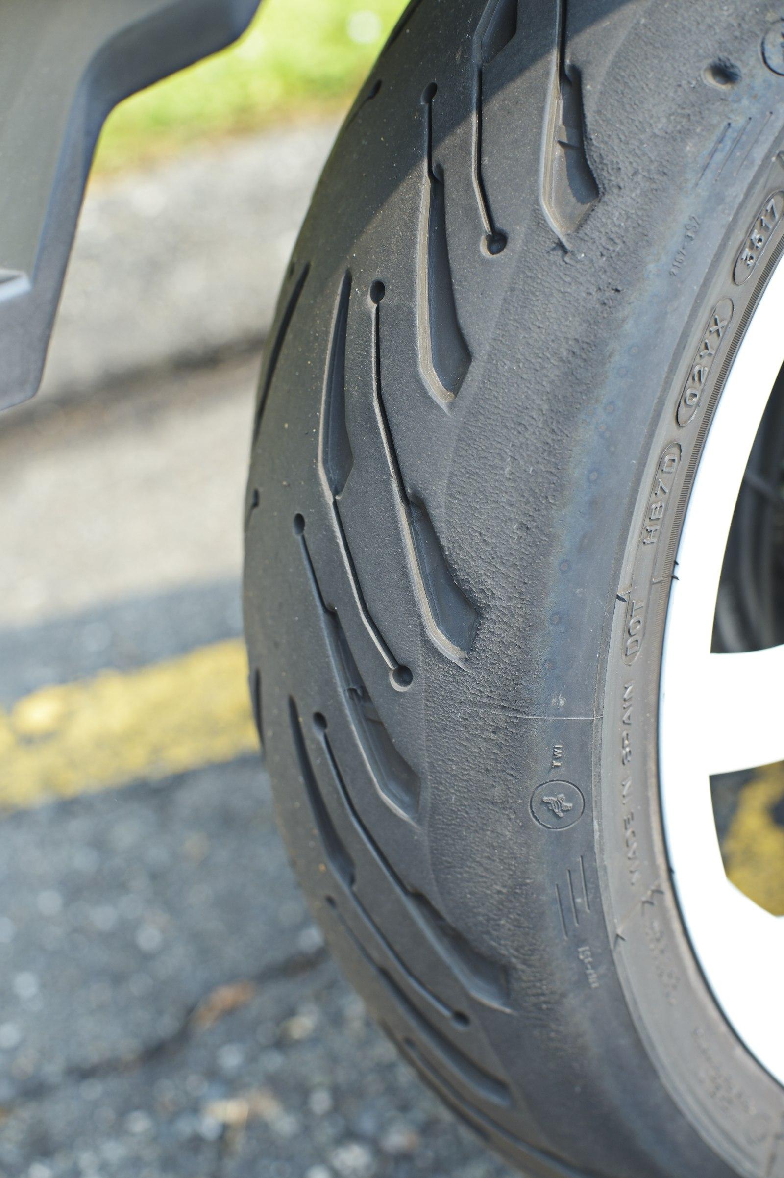

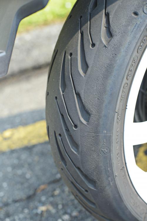

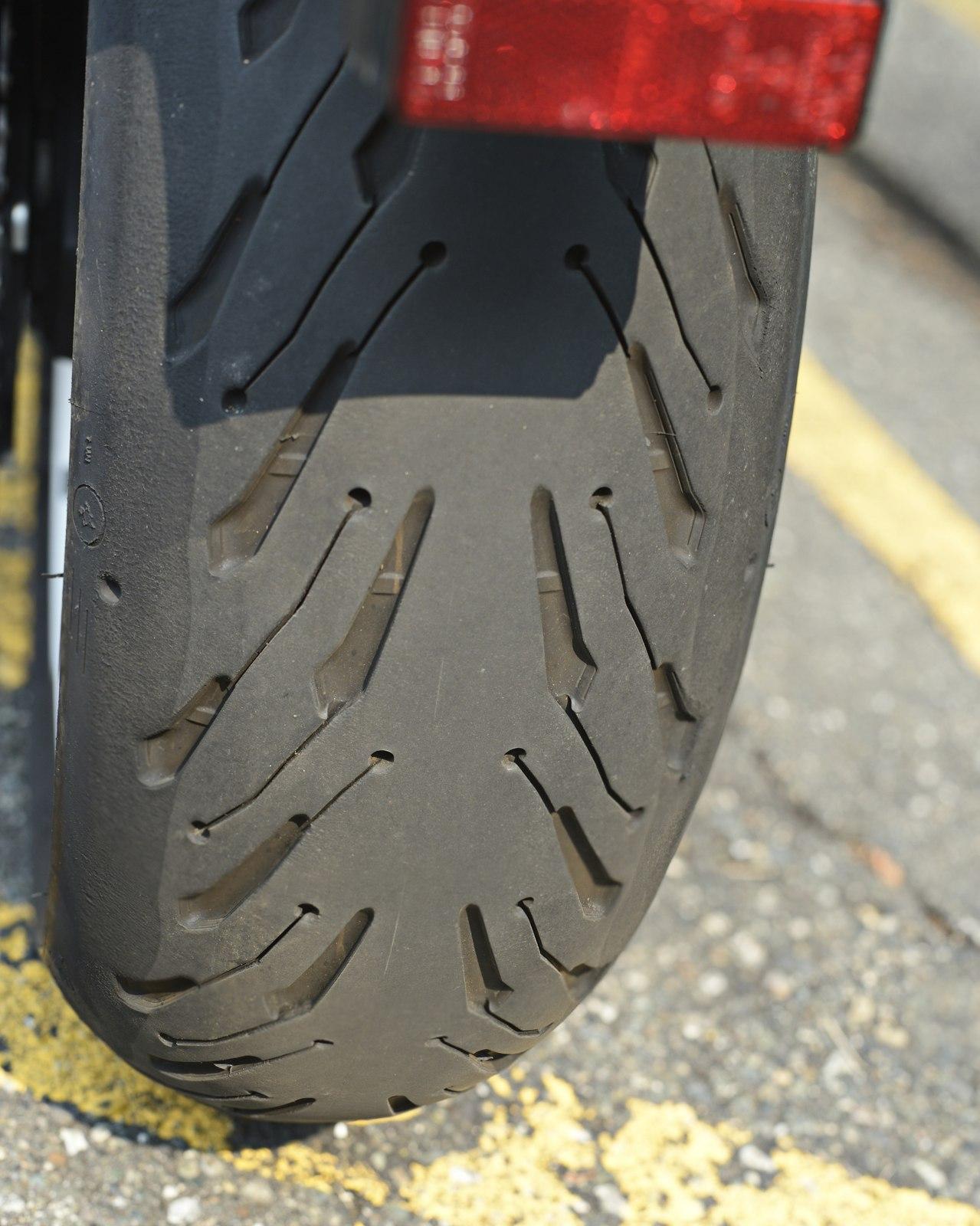

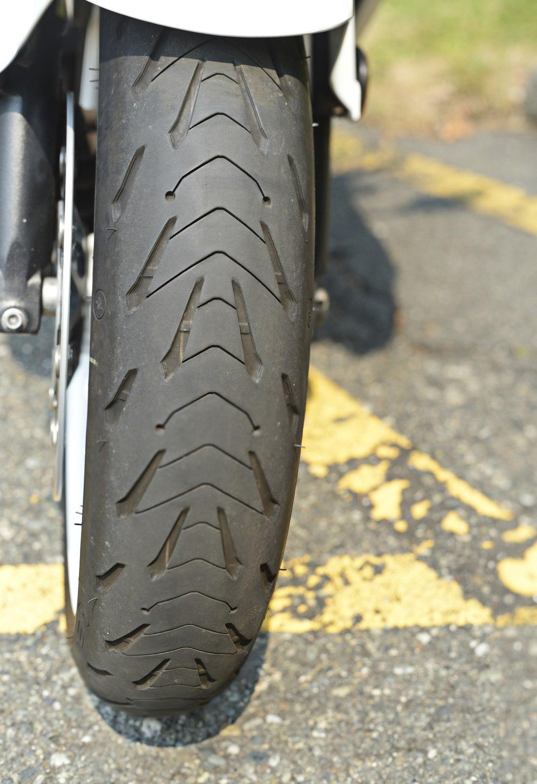

Member Contributer Lorne Posted August 15, 2018 Member Contributer Posted August 15, 2018 I'm a long-time Michelin user: firstly a set of Michelin Pilot Sport on my '99 VFR800 back in March 2000, and since then I've mostly times chosen Michelin. So, in May I opted for PR5 on my VTec prior to my summer trip to California. After ~5500 km / 3500 miles: - My seat of the pants impression is that there is a strong family resemblance with the other Michelins. - There seems to be no cupping yet on the front, and both seem as true as ever - no headshake. - Still have a neutral feel, especially at low speed. As they wear some tires feel positively truck-ish, especially when loaded with luggage. - I am a lousy predictor of tire life but these PR5 look good for several thousand more miles. - Fwiw, I use 36/42 psi, hadn't noticed much loss over the miles. - temps ranged from 2 to 35 ℃, about 35 to 95 ℉, and only a few damp roads. These pics show they look now: Quote
