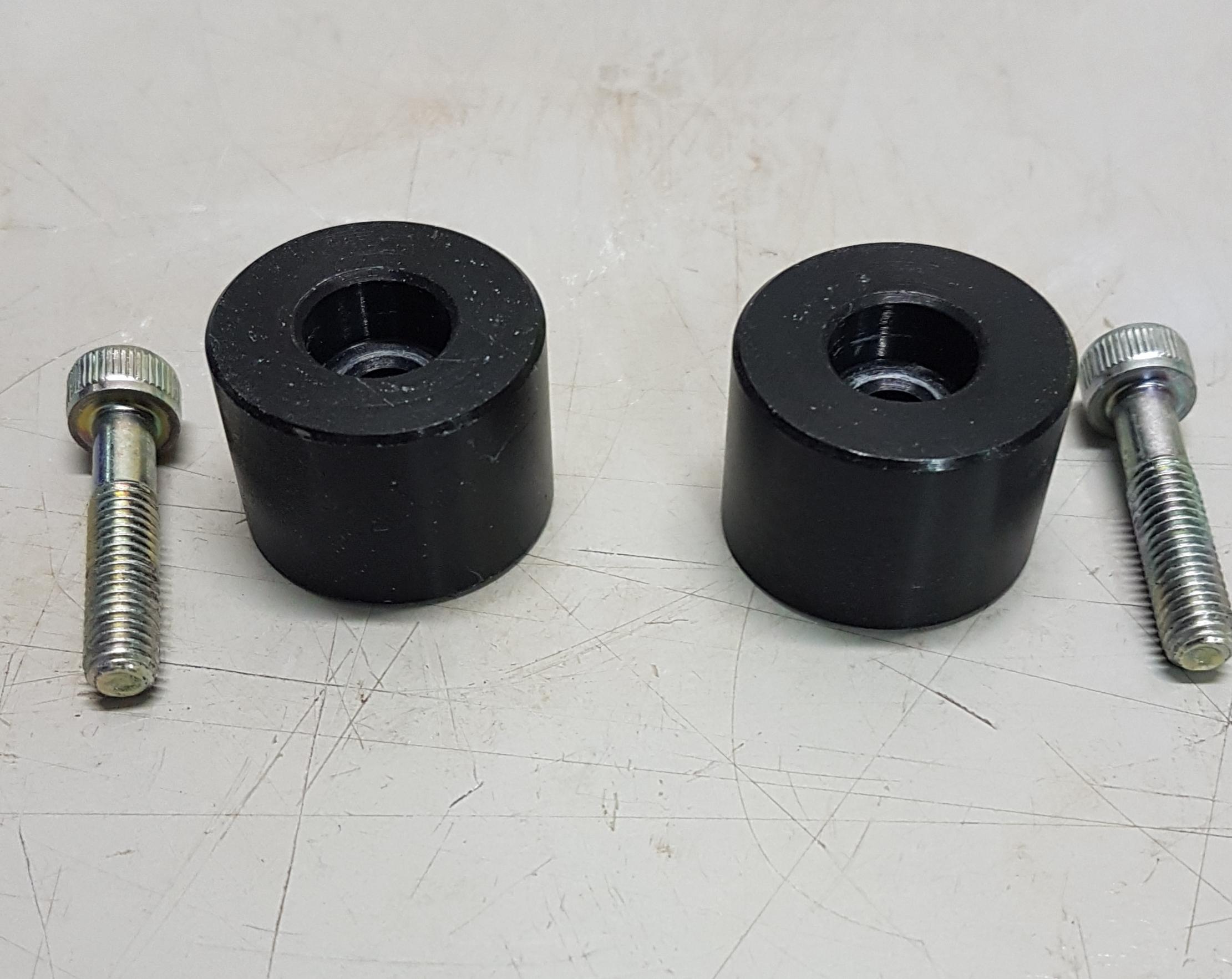

Bluehawk Posted August 7, 2021 Posted August 7, 2021 6 minutes ago, Grum said: Hi Bluehawk. Good news you have your 8gen. My bike has the seat in the LOW position so the collars are removed, so if your seat is currently in the HI position they would be installed. Here's a picture of what they look like. Enjoy your bike. Thnx. Yeah, i can tell i'm going to enjoy this beastie (not as much as my 'bird' but in a different useable way around the scottish twisties). Hmmm? Brilliant pic Grum. But these beauties are in the spares box! so maybe its not up in a High position like i thought. I will check over weekend.... Quote
Member Contributer Grum Posted August 7, 2021 Member Contributer Posted August 7, 2021 2 minutes ago, Bluehawk said: Thnx. Yeah, i can tell i'm going to enjoy this beastie (not as much as my 'bird' but in a different useable way around the scottish twisties). Hmmm? Brilliant pic Grum. But these beauties are in the spares box! so maybe its not up in a High position like i thought. I will check over weekend.... You bet, it won't be in the hi position, and where the seat meets the tank you will be seeing the clear plastic protection strip on the tank. 1 Quote

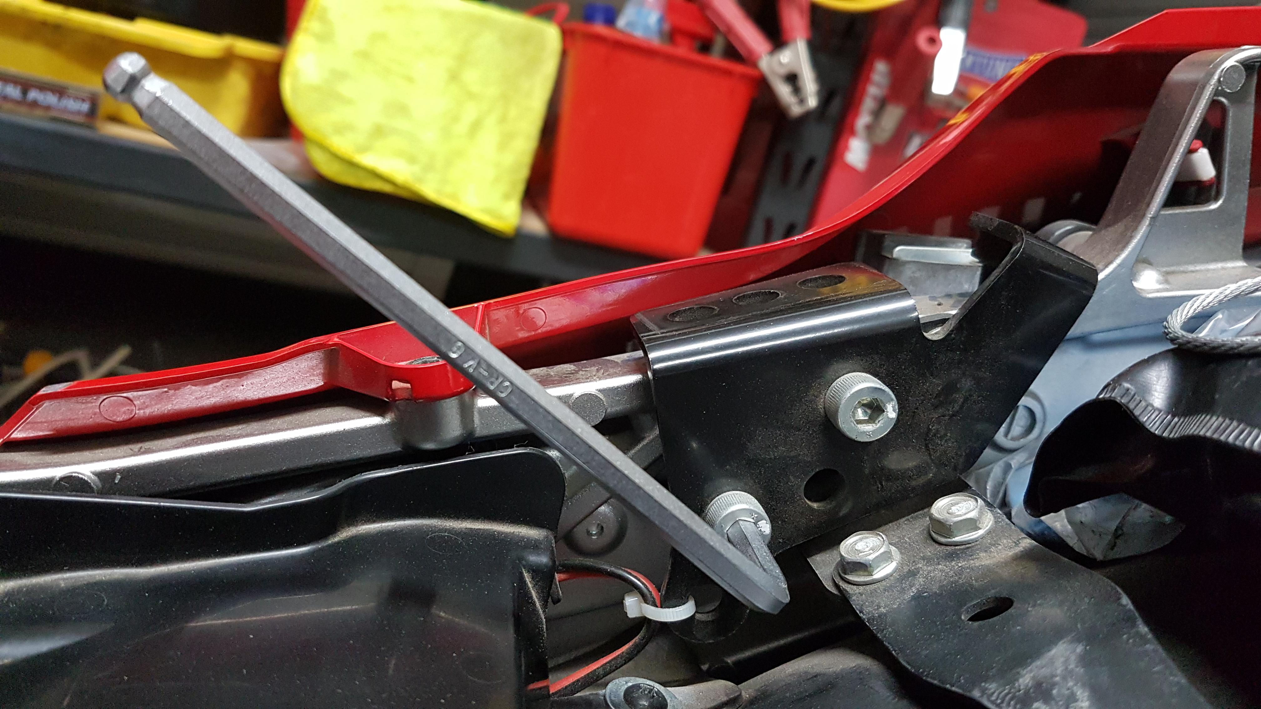

Member Contributer Grum Posted August 11, 2021 Member Contributer Posted August 11, 2021 33 minutes ago, thestumper said: Note: Is it just me getting older and being feeble, or are those screws that hold the adjustable bracket hard to get out? They seem super tight, and getting the right leverage on them is tough even with extenders and good quality bits. Surprised to hear you say that. Access to the Adjustment Plate bolts is extremely good, even if they were excessively tight there shouldn't be any issue at all, easy to add an extension to the 6mm Allen key if needed. Quote
thestumper Posted August 11, 2021 Posted August 11, 2021 2 minutes ago, Grum said: Surprised to hear you say that. Access to the Adjustment Plate bolts is extremely good, even if they were excessively tight there shouldn't be any issue at all, easy to add an extension to the 6mm Allen key shouldn't be an issue if needed. That's what I did - added an extension (piece of left-over pipe) to break it. Just seemed oddly tight. Access is indeed good but I don't have a key like that - I had to use a hex bit and a socket wrench, which was really tight. Did that come in the tool kit, per chance? Might be good to pick one up on the cheap... Quote
Member Contributer Grum Posted August 11, 2021 Member Contributer Posted August 11, 2021 13 minutes ago, thestumper said: That's what I did - added an extension (piece of left-over pipe) to break it. Just seemed oddly tight. Access is indeed good but I don't have a key like that - I had to use a hex bit and a socket wrench, which was really tight. Did that come in the tool kit, per chance? Might be good to pick one up on the cheap... Just a standard good quality set of Allen keys! No not in the kit. It only has a small length 5mm key in the toolkit. No need to torque these bolts, or have Hercules tighten them, just nice and firm by hand will be more than adequate. YMMV. Quote

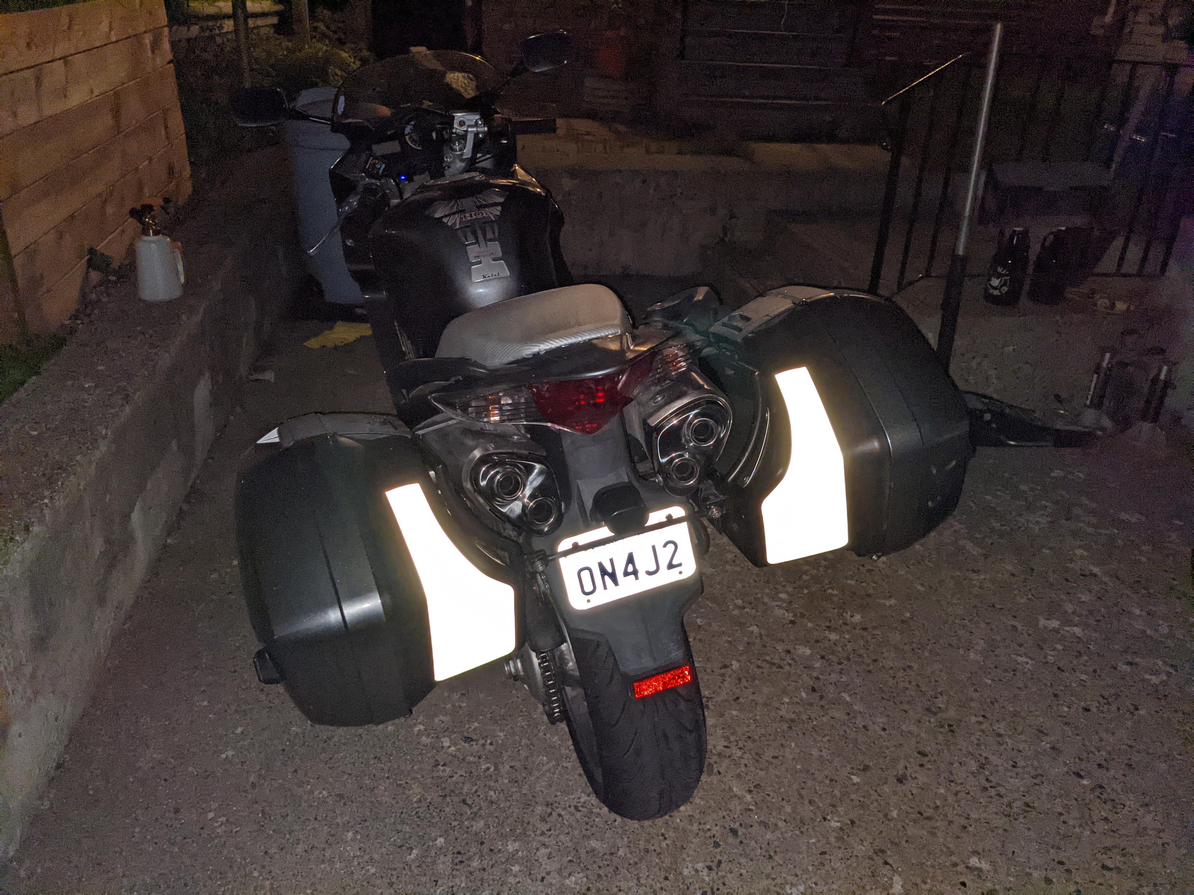

Boosh63 Posted August 11, 2021 Posted August 11, 2021 I added a stylized Honda wing in black reflective vinyl. In addition to the huge reflector panels I applied to my side cases, the machine sure lights up at night. I can make these things in any colour, if you're interested. 4 Quote
Member Contributer Philois1984 Posted August 11, 2021 Member Contributer Posted August 11, 2021 I did a similar thing to my panniers, love the gold coloured Honda Wing decal. 3 Quote
TimC Posted August 11, 2021 Posted August 11, 2021 16 minutes ago, Philois1984 said: I did a similar thing to my panniers, love the gold coloured Honda Wing decal. I was going to add DOT reflective tape to my old 6th gen's OEM hard bags years ago, but never got around to it. I still have the tape in my tool chest. 😕 Quote
Bluehawk Posted August 12, 2021 Posted August 12, 2021 On 8/7/2021 at 1:48 AM, Grum said: Hi Bluehawk. Good news you have your 8gen. My bike has the seat in the LOW position so the collars are removed, so if your seat is currently in the HI position they would be installed. Here's a picture of what they look like. Enjoy your bike. interestingly it's in the high position not low as expected! i shall check and see why the (silver in case) bobbins/spacers are out?? Hmm.. Quote

Bluehawk Posted August 12, 2021 Posted August 12, 2021 23 hours ago, thestumper said: Note: Is it just me getting older and being feeble, or are those screws that hold the adjustable bracket hard to get out? They seem super tight, and getting the right leverage on them is tough even with extenders and good quality bits. cant see why you should be having bother? There is plenty of access with the seat gone. and as mentioned, a good allen key, or any allen will do it. I have just acquired one and for the first time tried the bolts. easy-peasy...(sorry). Maybe your previous owner was a grease gorilla, rather than a grease monkey. lol. Quote

thestumper Posted August 12, 2021 Posted August 12, 2021 11 hours ago, Bluehawk said: cant see why you should be having bother? There is plenty of access with the seat gone. and as mentioned, a good allen key, or any allen will do it. I have just acquired one and for the first time tried the bolts. easy-peasy...(sorry). Maybe your previous owner was a grease gorilla, rather than a grease monkey. lol. There is anecdotal evidence to suggest he/she was a large person..... 🙂 As is the key in all thing mechanical, it's usually down to having the right tools. Sometimes I sucks at that.... Quote

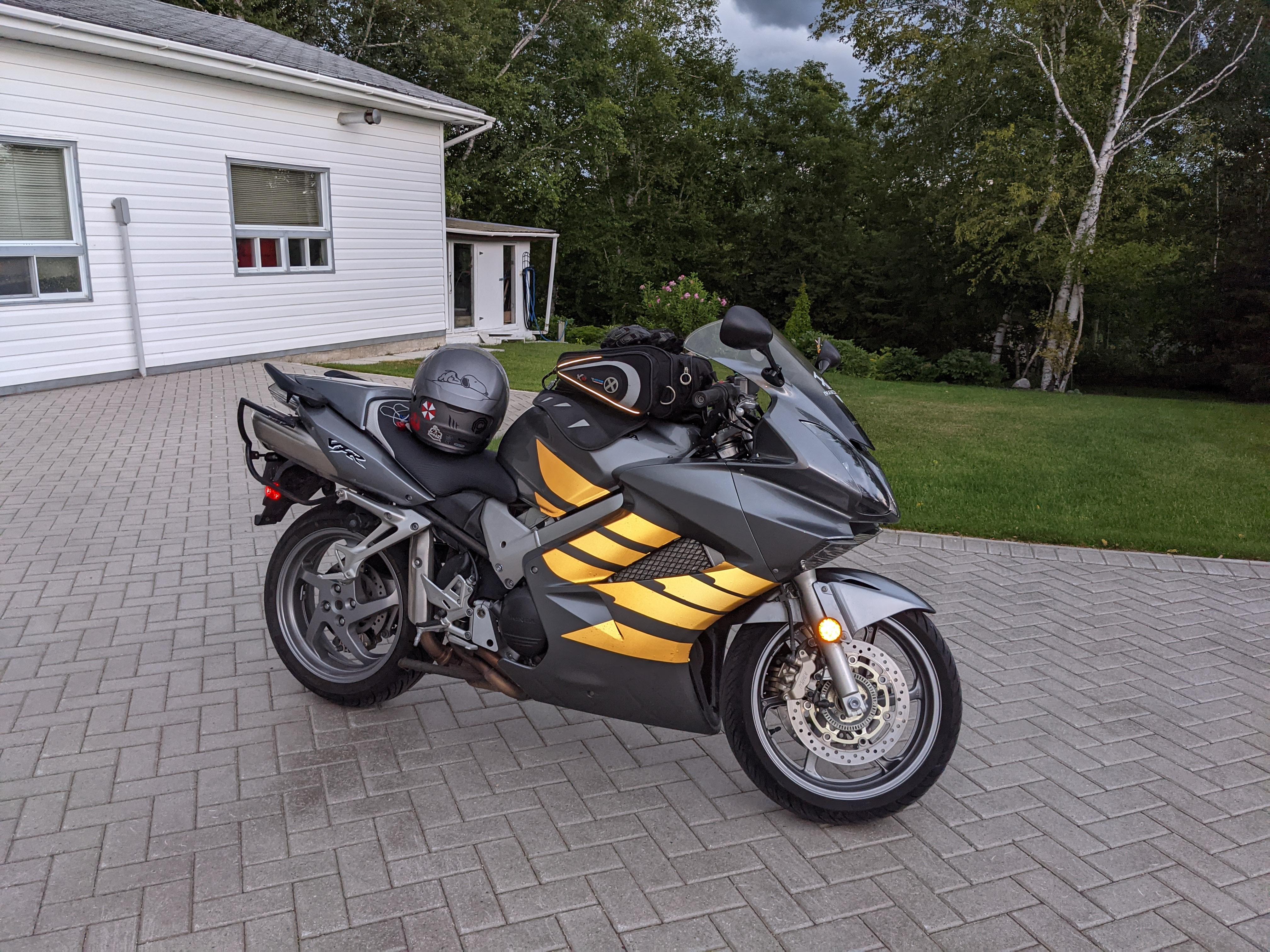

thestumper Posted August 24, 2021 Posted August 24, 2021 Put Tank Slapper film on the tank for some paint protection. A complete PITA. I've applied them before and never had any issue, but I'm not convinced the cut outs were specific to the 2014 model year. In the past, I just used a credit card and my fingers for smoothing - this time after a couple of failed attempts I had to break down and get one of those detailer squeegees. It worked for the back part of the tank, but doesn't look as glass-smooth as previous installations. I don't know if I will even attempt the side tank panels - they don't seem to line up with anything without going under trim pieces or overlapping the rear tank piece. The rear is the important one - at I least that's on and hopefully it sticks. Quote
