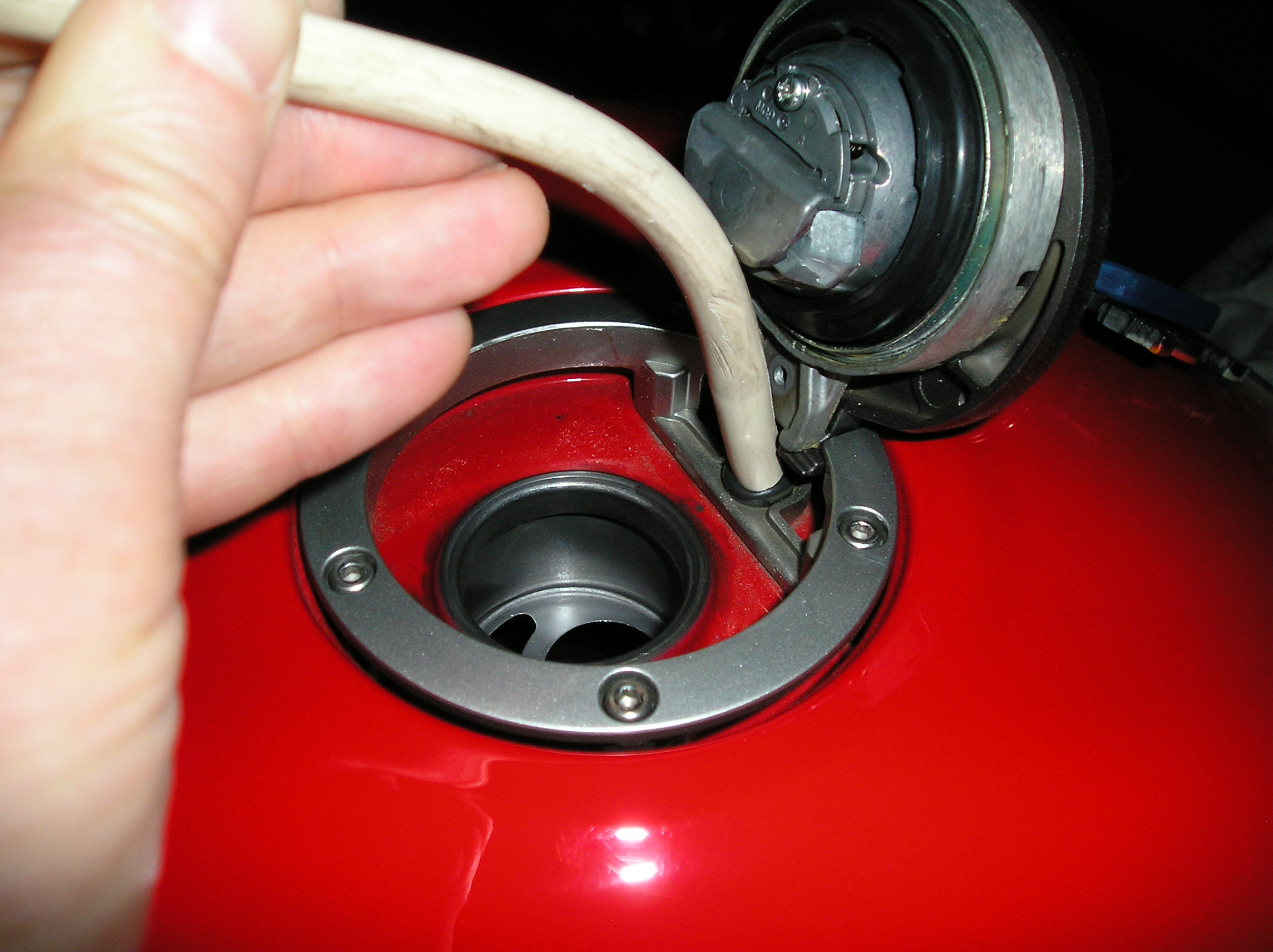

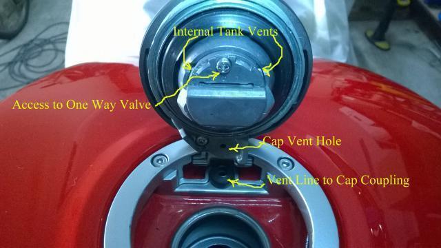

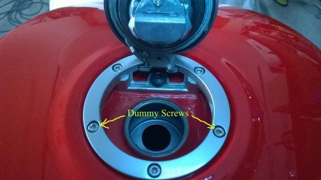

Member Contributer Grum Posted October 4, 2017 Member Contributer Posted October 4, 2017 Hi Skids. I've had the high vacuum issue with my tank once, the vacuum was so strong I thought I was going to break my key in trying to open the filler cap. You will either have a pinched breather hose (one of the three hoses that ends up at the bottom of your bike) ,OR as I did, a suspected jammed small one way valve thats inside your filler cap. The valve allows for positive pressure to build in your tank but never negative (unless its jammed). Have a very good look for a pinched tank vent hose, this can easily happen after raising and lowering the tank from the maintenance position. Failing that, remove your filler cap from the tank, there are 5 allen head screws, open your filler cap and you will see only 3 of these screws hold the filler cap in position just remove these 3 the other 2 are dummies. With the filler cap removed undo the centre Phillips head screw to access the one way valve and spring, give the valve and seat a squirt of WD40 then reassemble. While the filler cap is removed have a good look at the vent line for any obstructions, you should also be able to freely blow air through the tank vent hole and feel the air exiting from one of the bottom three hoses under your bike. Its an easy thing to do, I've had no further reoccurrence of the problem since doing this almost 2 years ago. Cheers. Grum Quote

Member Contributer Grum Posted October 5, 2017 Member Contributer Posted October 5, 2017 7 hours ago, Skids said: I've linked to Grum's post so they can find this place. It's up to them if they want to join. Hi Skids. Further to my posting above. This is the method I used to confirm my Breather Hose was not blocked. Simply holding this hose to the breather coupling and blowing I was able to feel air exiting from the other end of the breather hose underneath the bike. Hope this helps. Cheers Grum. Quote

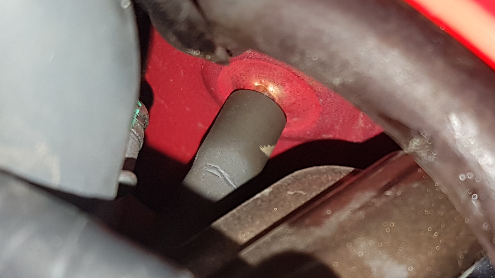

jangermann Posted October 6, 2017 Posted October 6, 2017 I got a new tank on mine. My tank got vacuum dents and was totally out of shape because the breather hose was bend. The breather hose was bend where it attach to the tank. If tank has been rised for service, it is ekstreamly important to check that the breather hose is not bend. It bend very easy. Quote

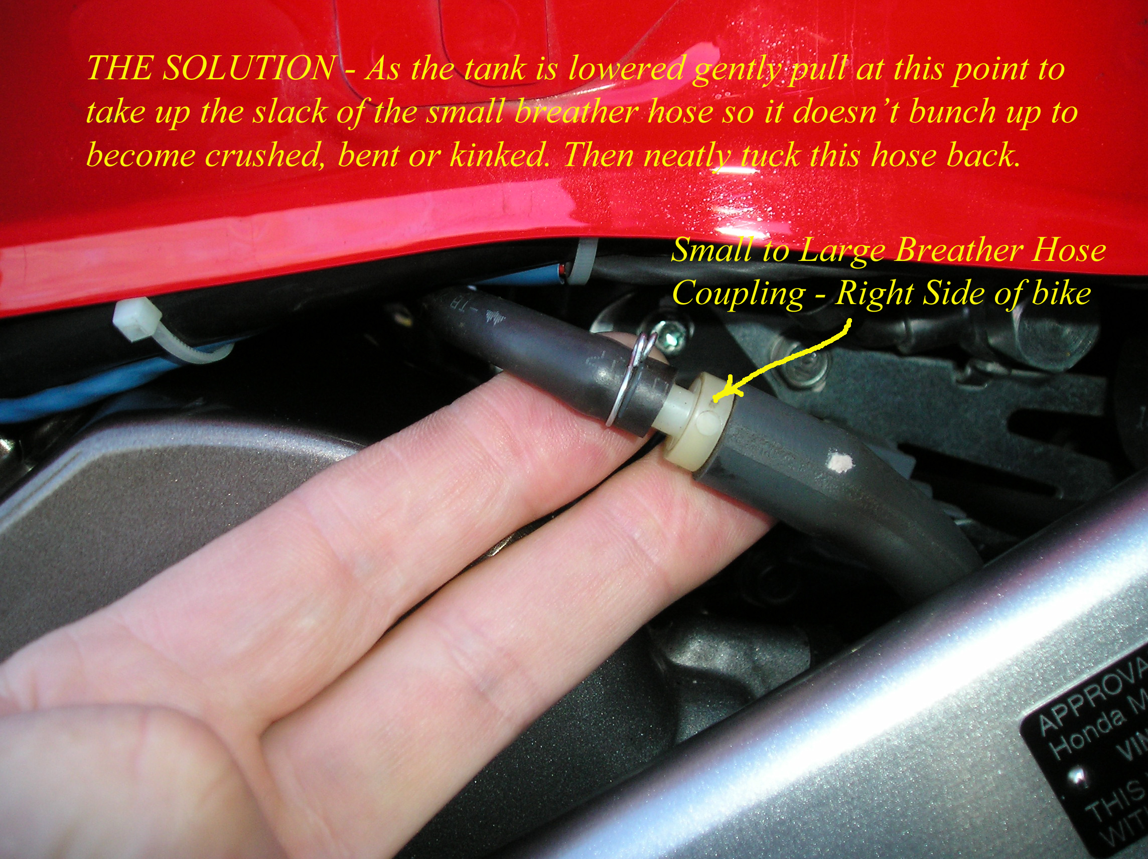

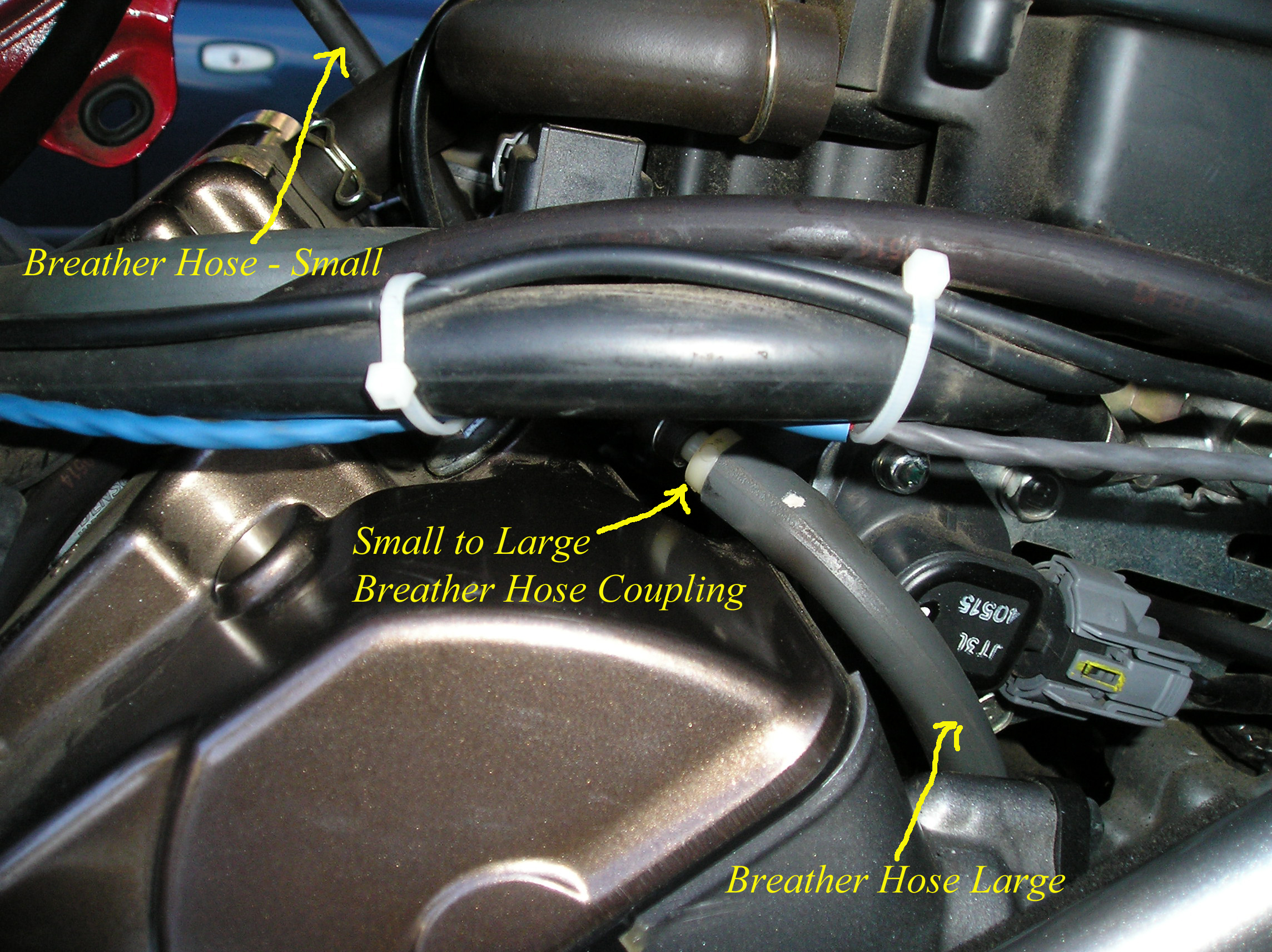

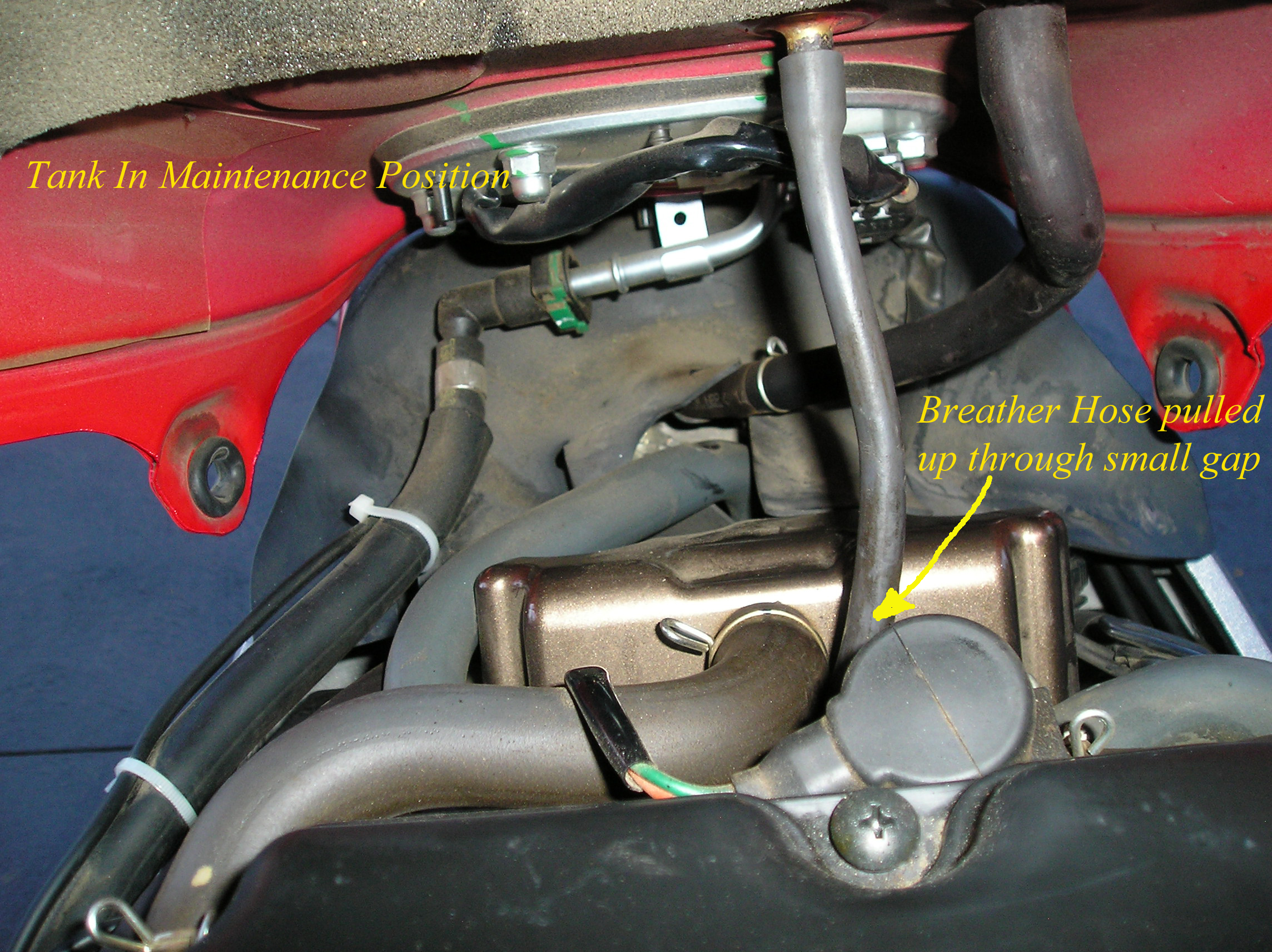

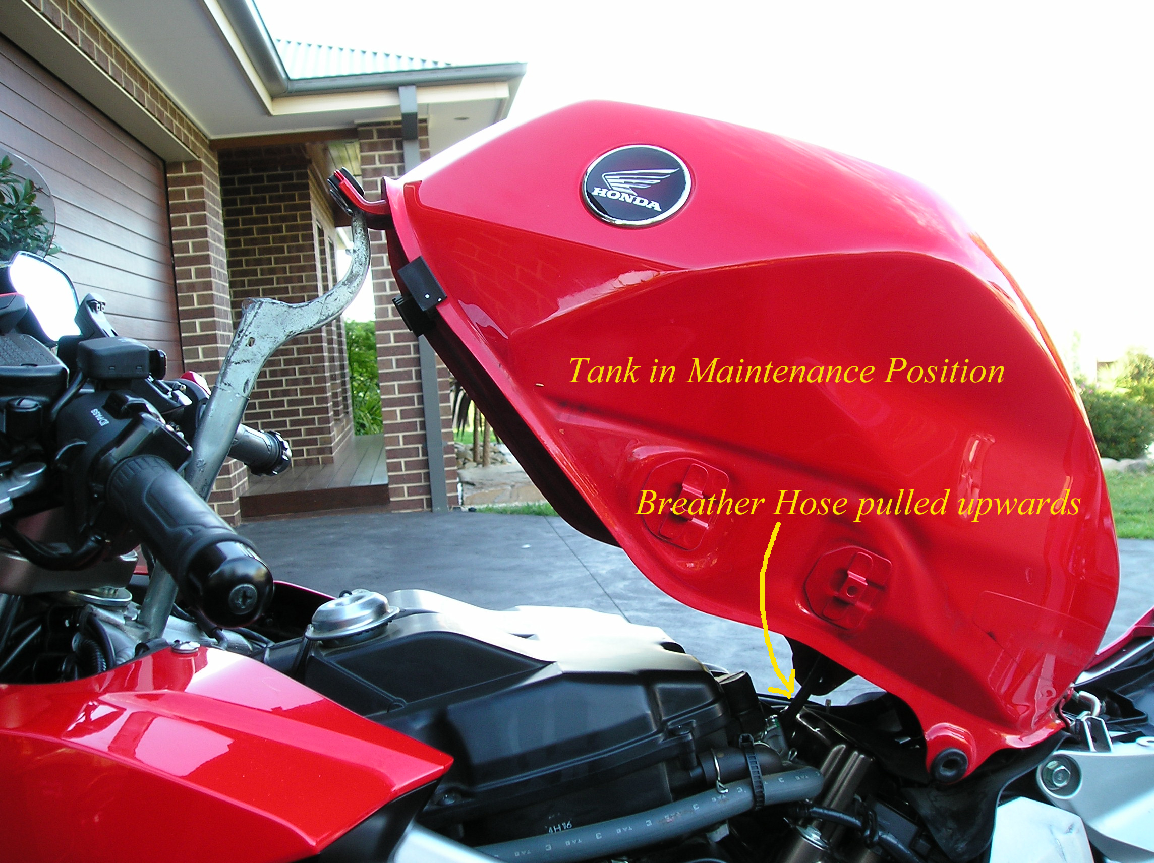

Member Contributer Grum Posted October 6, 2017 Member Contributer Posted October 6, 2017 Hi All. After hearing the bad news that this issue could destroy your tank!!! Decided to have a very close look at this problem and think I have discovered why this is happening, and, as reported, this is a SERIOUS situation the vacuum created can be so strong it can seriously DAMAGE your tank!!!! It seems there are a few people that have had this happen after any servicing has been done around the airbox (air filter replacement etc.) requiring the tank to be extended in maintenance position. When the tank is placed in the Maintenance position the small breather hose is pulled up by a few inches through a whole lot of clutter. The problem is, when the tank is lowered back to normal position the hose doesn't naturally go back from where it came and bunches up and gets crushed and kinked against all the other clutter so close to the breather inlet to the tank. See attached photos. The solution is to simply pull at the small to large hose coupling area to take up the slack while lowering the tank. (see photos). You should always be able to blow air from either end and feel air being expelled at the opposite end (fuel cap open of course). Hope this helps. Cheers. Grum. Post Edit - Some clarification here, there is a difference in being able to Blow air through the breather hose (positive pressure) than able to Suck air through it (negative pressure). A kinked partially blocked hose will allow blowing air to flow, However suction could further help to collapse the hose causing a complete blockage. Quote

Member Contributer Thumbs Posted October 7, 2017 Member Contributer Posted October 7, 2017 Thanks again Grum .... This should be the first 8th gen sticky Quote
Member Contributer fink Posted October 7, 2017 Member Contributer Posted October 7, 2017 Good write up there Grum. Should also maybe include the signs that it occurring. ie Difficulty in trying to open the fuel cap followed by a hissing sound as the pressure is released, as well as the aforementioned tank deformation in some cases. Quote

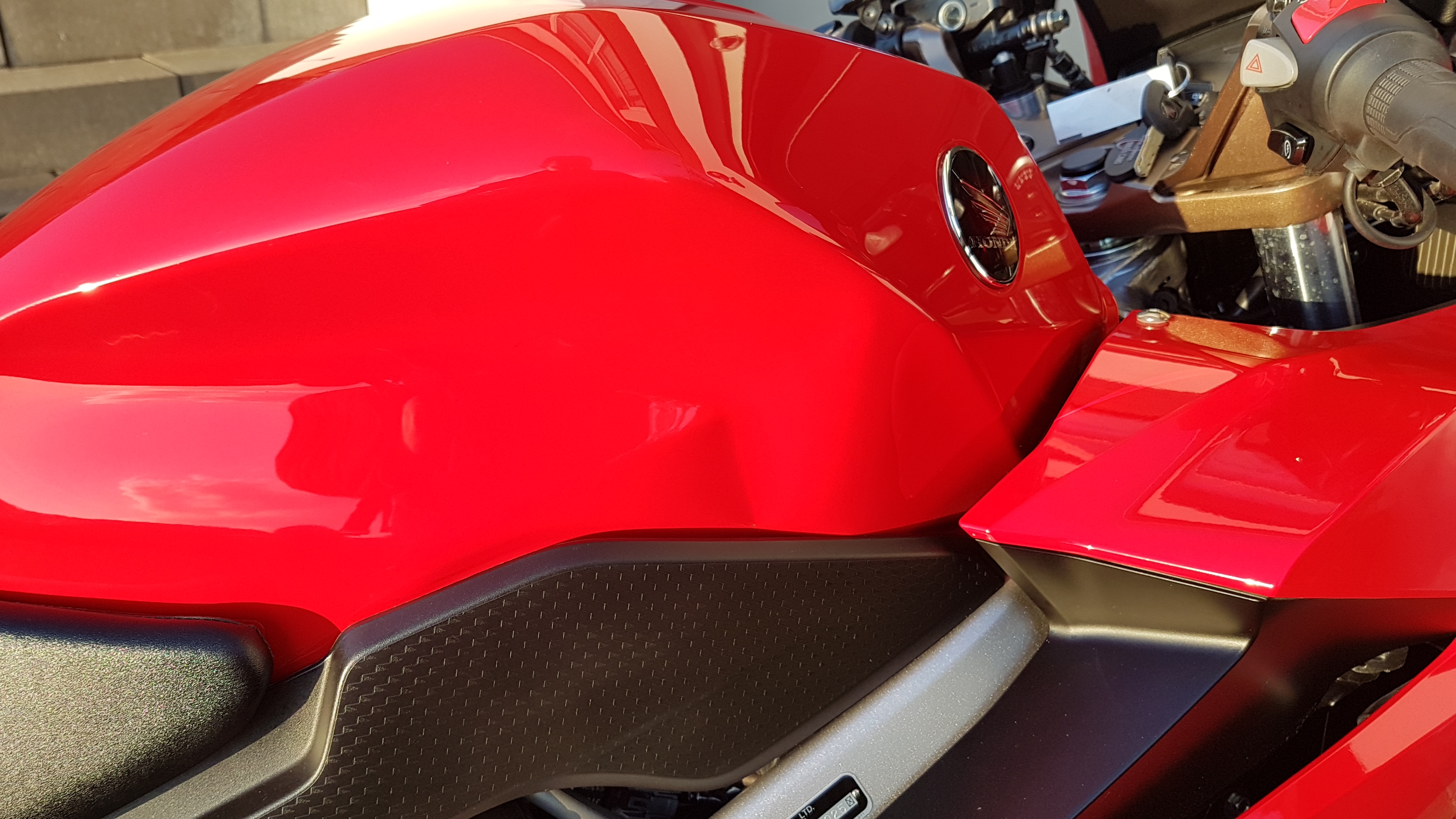

jangermann Posted October 7, 2017 Posted October 7, 2017 Just some pictures what vacuum can do to your tank. Pictures show the marks on the breather hose where it was bend. And the dent and deform tank. The dealer replaced my tank under warranty. Your tank will for sure deform and get dents before first fillup if vacuum hose is bend, the fuel pump will do the job. As Grum already tells, first thing to check after service is the vacuum hose, it's very important. Quote
Samuelx Posted October 7, 2017 Posted October 7, 2017 Hey All, Thanks for the heads up and follow up info! Quick question (sorry if it's been answered already, I didn't see/remember it) - at what point (how much fuel used) will the tank start visibly deforming? I like topping off as often as possible - I think the most I've used before refueling is about a little more than half tank (fuel gauge reads under half full)... Quote
jangermann Posted October 7, 2017 Posted October 7, 2017 24 minutes ago, Samuelx said: Hey All, Thanks for the heads up and follow up info! Quick question (sorry if it's been answered already, I didn't see/remember it) - at what point (how much fuel used) will the tank start visibly deforming? I like topping off as often as possible - I think the most I've used before refueling is about a little more than half tank (fuel gauge reads under half full)... Don't know. I did not notice when i happend. But the dents will come on each lower side of the tank and will be identical. You can see it on my picture just above the black plastic. Also the black plastic attached to the tank will fit very bad if the tank has vacuum damage. It will fit even worse when the tank is under vacuum. Quote
